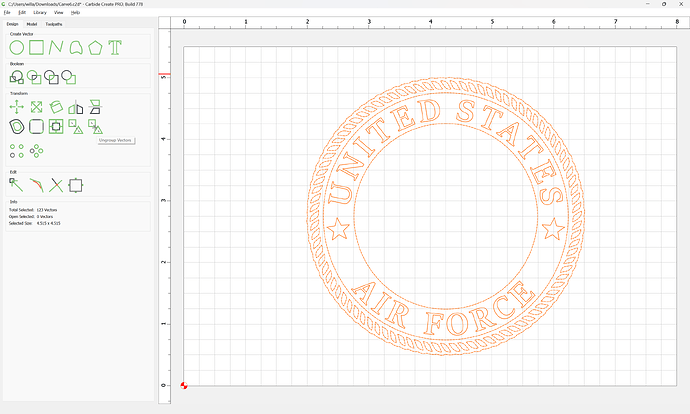

Wondering why there is a carve in the middle of this file when I have nothing in it?
Thanks Kerry
Carve6.c2d (2.7 MB)

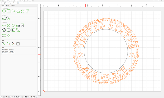

To start, you have a bunch of geometry associated with a toolpath which isn’t in the Stock area:
For the toolpath in question, you have an extra bit of geometry associated with the toolpath:
If you go back to Design and Ungroup:
and then remove the inner circle:
you will have a selection which matches what you wish to cut:
“Change Vectors”
OK
If you use v8, then the V carve toolpath will more closely match the selection making this sort of difficulty obvious.
Thank you Will! I did what you said and it worked. Wondering if you know of a good sealer for poplar that will stop colored epoxy bleed through?
