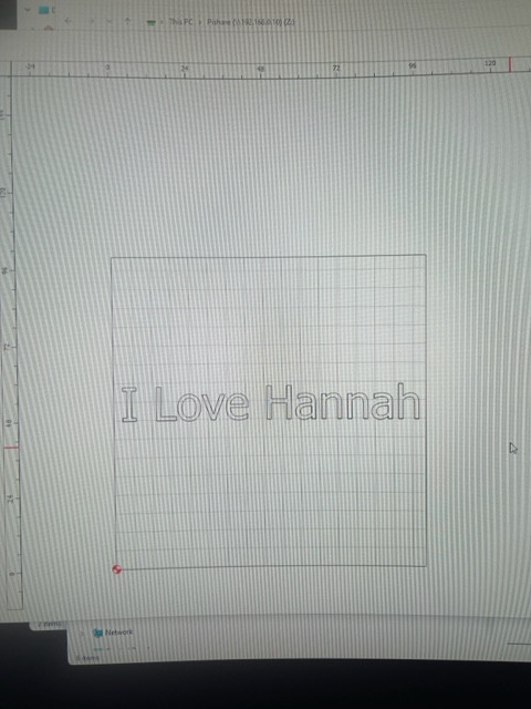

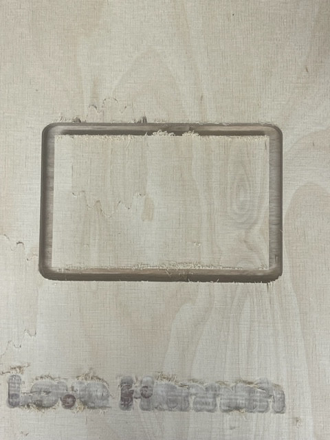

Hi,
After having been in storage for 3 years (or so) I have finally setup my Shapeoko 3 and attempted my first cut. I designed a simple 100mm x 100m square in Carbide Create 756 and put a couple of words on it. I managed to get the Shapeoko to run the file but the text on the wood is roughly 50% bigger than I would have expected (about 160 - 170mm across). Any ideas what I am doing wrong?
The machine seems to home perfectly, move perfectly (N/S/E/W) and the bitsetter works nicely.
Many Thanks

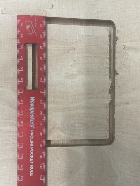

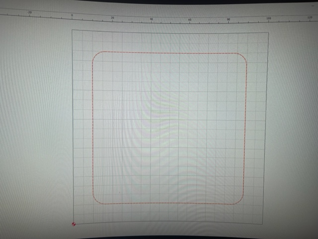

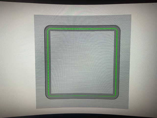

Well here are the results and as I thought its not a toolpath issue.
I designed an 80mm square with rounded corners and set the bit toolpath to be on the inside.
The Y axis cut is 100% perfect (80mm) but the X-axis is 122mm (scaled by a tiny bit over 1.5 times).
As a reminder the gantry homes perfectly and can find the bitsetter perfectly everytime.
The clear motor photo is the Y axis, the blurry one is the X but I am pretty sure it is identical (other than its an L not an S on the end I think).
Any more ideas?
Thanks
Chris

Just for fun I tried jogging 100mm on the X axis and measuring - sure enough it moves just over 150mm
This would I guess suggest a steps / mm issue? But why?
