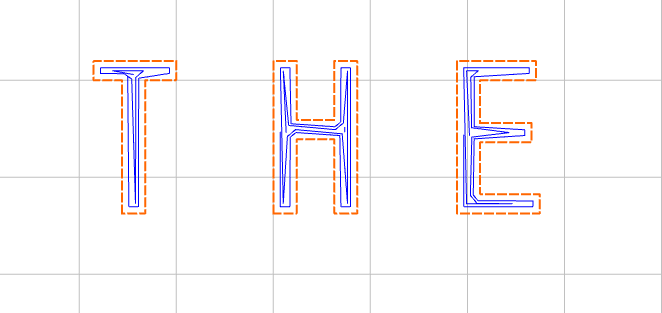

It looks like your text ranges from 0.015" - 0.020" wide, and you want to engrave about 0.003" deep. If you put a 1/32 tool in a 0.020 x 0.003 pocket, the effective diameter of the tool is 0.018"
So I tried creating a 0.018 diameter tool & doing a pocket. I then discovered the smaller areas were as small as 0.015, so I changed the tool diameter to 0.014" & programmed a pocket with 0.003" stepover and 0.003 depth
And simulates it like an end mill ???
That looks much better than I came up with. So just to confirm, I should create a new v bit/engraver in the library that’s 1/32” with the tool diameter .014” diameter and use the pocket tool set to .003” step over and my standard .003” depth but still use my same ball mill?
I’ve been able to toy around with CC this morning and if I put in .014” for the tool diameter with the angle at 5.1* the cut seems to miss some areas:
I noticed the smallest area diameter on my end is the “T” and it looks to be at .006”. So if I adjusted the tool diameter to .008:
And it produces this:
Which seems to be much better, does that seem right to you? And if so, what does that mean about the mill I need to use? Thanks again.
With these settings, the curved areas don’t appear to be very crisp (more of small straight lines as opposed to curved), is that able to be corrected by manipulating the stepover? Or is that a mill diameter size issue?
It looks like if I run the pocket tool path then run the contour tool path it will satisfy the choppy edges, any problems you see in doing this?
I used a Ball Mill at 0.014" diameter. The simulation will look just a bit narrower than the actual cut if it simulates a ball mill. (Mine looked more like an end mill??).
But the toolpath will be in the right place.
