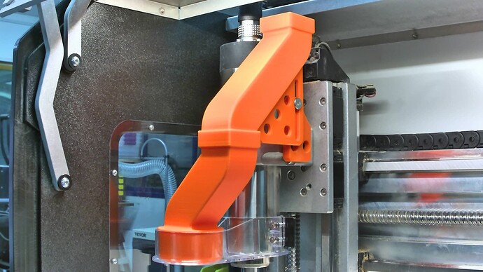

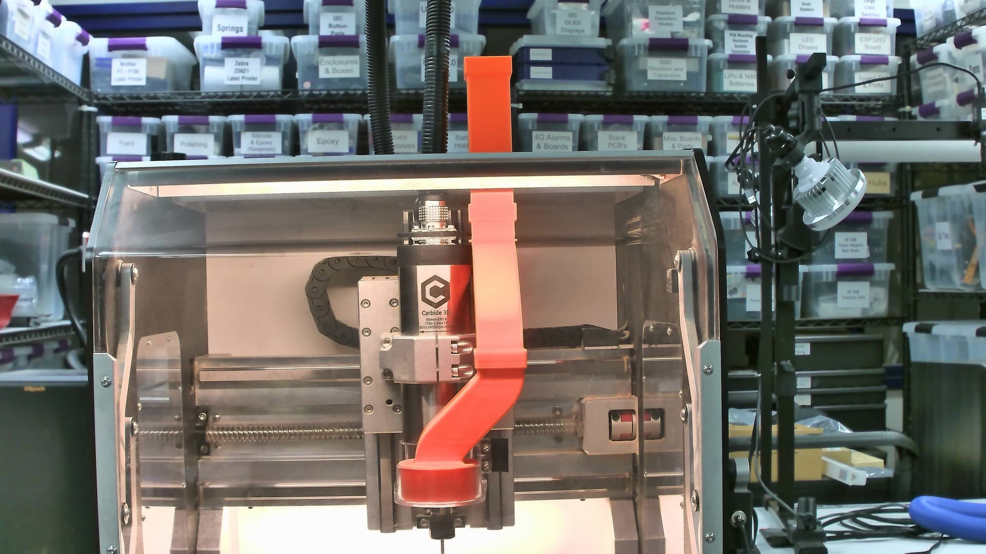

I have been working up several generations of ducting to mate with the Sweepy V2.0 that provide full functionality (spindle travel) with the Nomad 4 (see link above). The challenge here is that there really is very little clearance to work with in passing hoses through “the slot” - particularly with such little clearance on either side of the spindle when it is at full travel. To make things worse, the spindle is needlessly centered in the slot using up precious space in front of the spindle (the slot could have been moved forward for an additional 20mm of space up front). Essentially there is less than 40mm of free clearance between the spindle and the side of the enclosure (with about 75mm front-back). To complicate matters further, if you fix your left side end stops so you can use the BitZero on the left edge of your worktable (see link above for details), then there is actually a little less clearance on the left side of the spindle vs the right.
I wanted to make a duct which basically maintained the same cross sectional area as the popular Rockler vacuum hose (super flexible) and another relatively inexpensive hose (41mm OD Hose) which has a more traditional “stiffness”. I did not want to introduce any unnecessary restriction in the vacuum path. I decided to use a square profile as I could fit I the same cross sectional area in a narrower profile vs a circle.

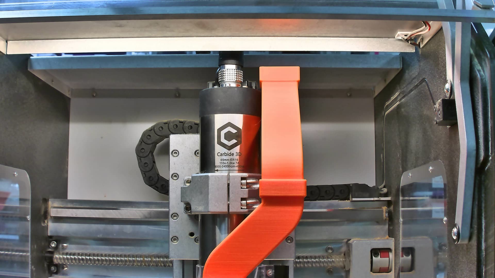

After much tweaking and test printing, the fitment is extremely close. Its essentially just up to the right side window without crashing during initialization or at full end stop allowance. The duct is also right up against the spindle with the upper cuff just hanging over.
The duct comes in three parts and is fully 3D printable. For printability (without supports) the ducting was designed such that no horizontal transitions were done at an angle less than 45 degrees.
There is a lower section which mates directly with the Sweepy V2 and transitions left to right.

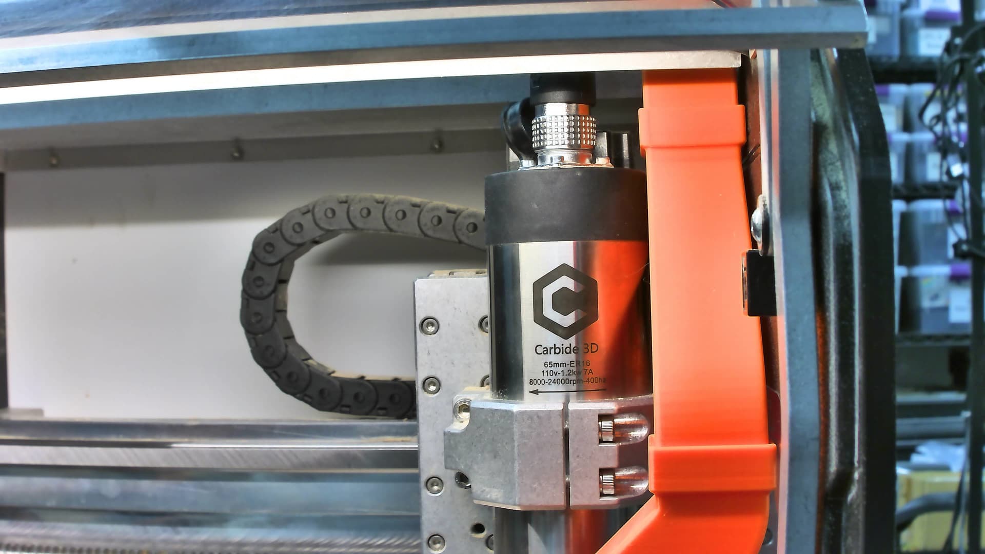

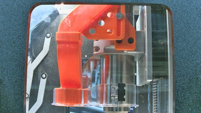

There is a upper section which travels front to back and clamps to the spindle clamp using existing M5 threaded holes (using a 3D printed mounting bracket). The mounting bracket provides stability for the entire assembled duct and provides a slot so the duct can move up/down if the Sweepy itself needs to be adjusted. The upper duct was also designed such that the flange which mates with the mounting bracket also serves as a support during printing.
There is also an option extension section which will provide a mount point above the enclosure with the spindle in full downward travel. Generally this would only be required if you had to make a mating attachment which could not operate/fit/pass within the limited clearance provided by the slot itself (or had a really big hose). Hopefully, you will not need this.

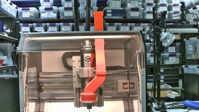

The main duct completely assembled:
Right up against the spindle. Not a mm is wasted:
Yeah, its that close! (on the end stop):
Mounting bracket as seen through the side window:

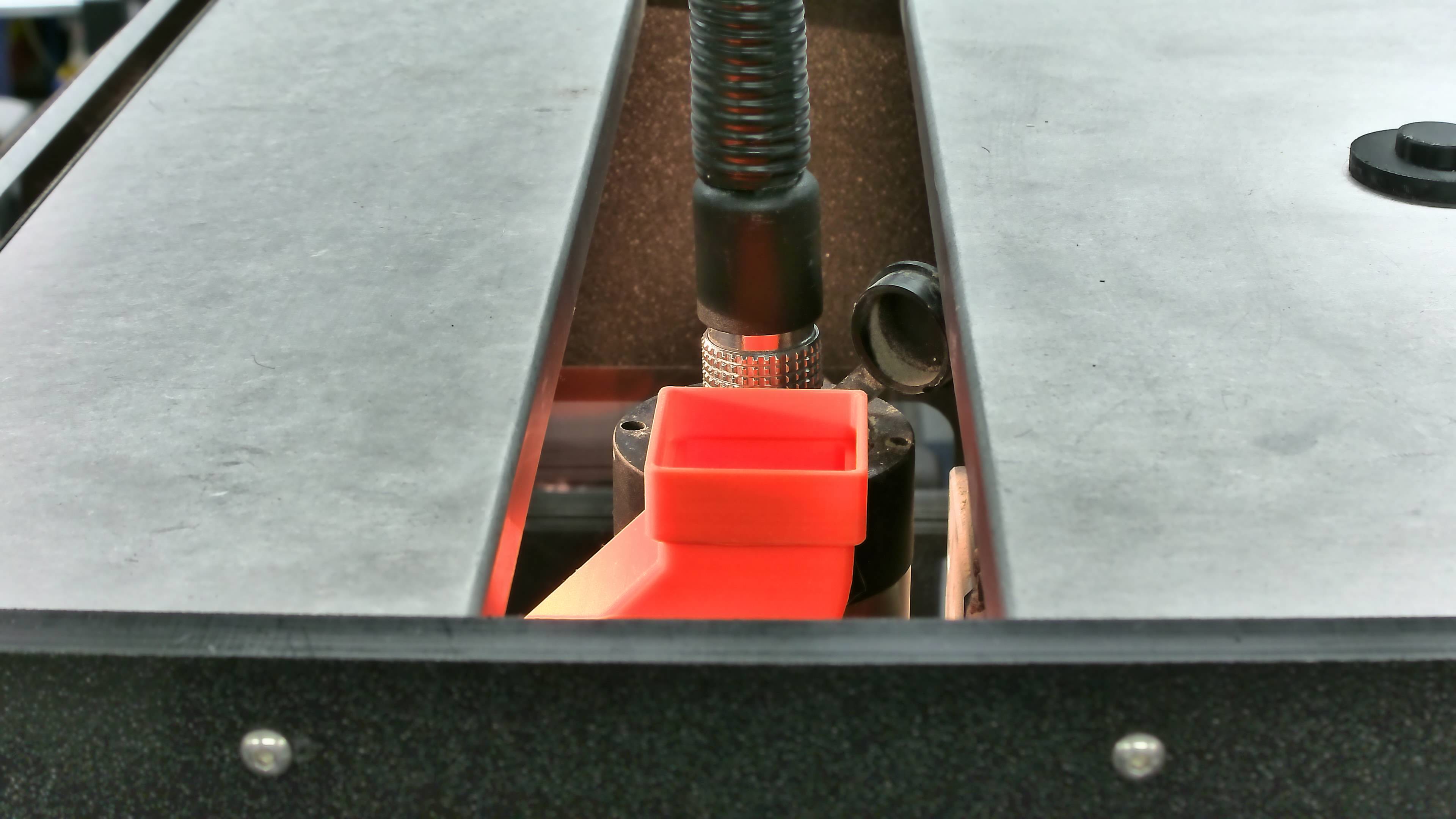

View through the slot:
Includes an extension for vertical clearance (travel allowance):

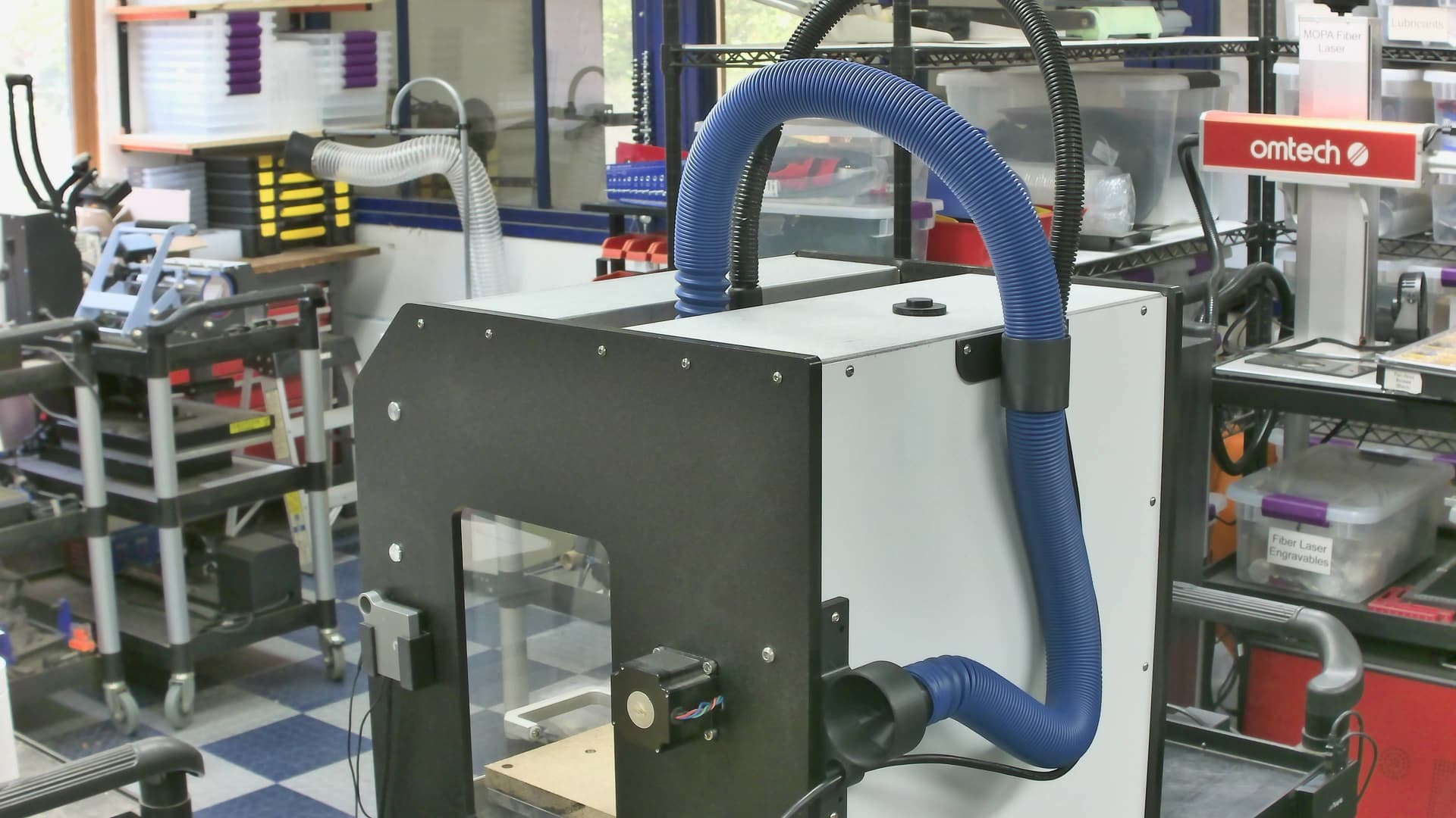

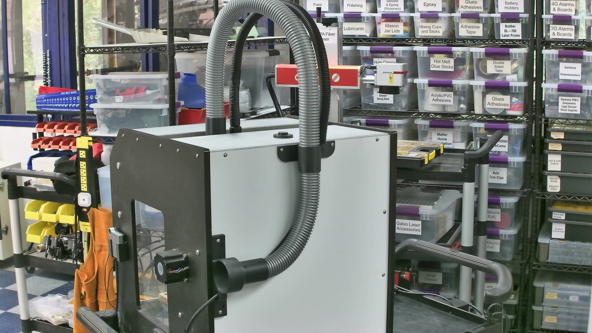

I also designed a full set of adapters and connectors to use the Sweepy Duct with both the Rockler and the “41mm” hoses I have been testing with. This includes not only adapters to mate with the ducting but also hose guides (clamps) and 2-1/4" Shop Vac female ports which mount on the back of the N4 using the existing screws.
The “Shop Vac Ports” (female) for both the Rockler and the 41mm hoses can be mounted on the top or side edges of the rear panel. You can skip the middle brackets if you want to mount on the top edge.
The “middle clamps” have been designed as more of a cylinder than a narrow clip. This was done to help hold the hoses in a vertical position rather than having them lean from side to side as the spindle moves.

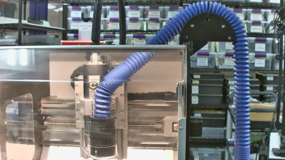

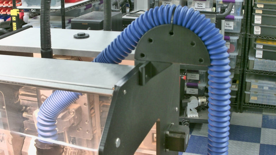

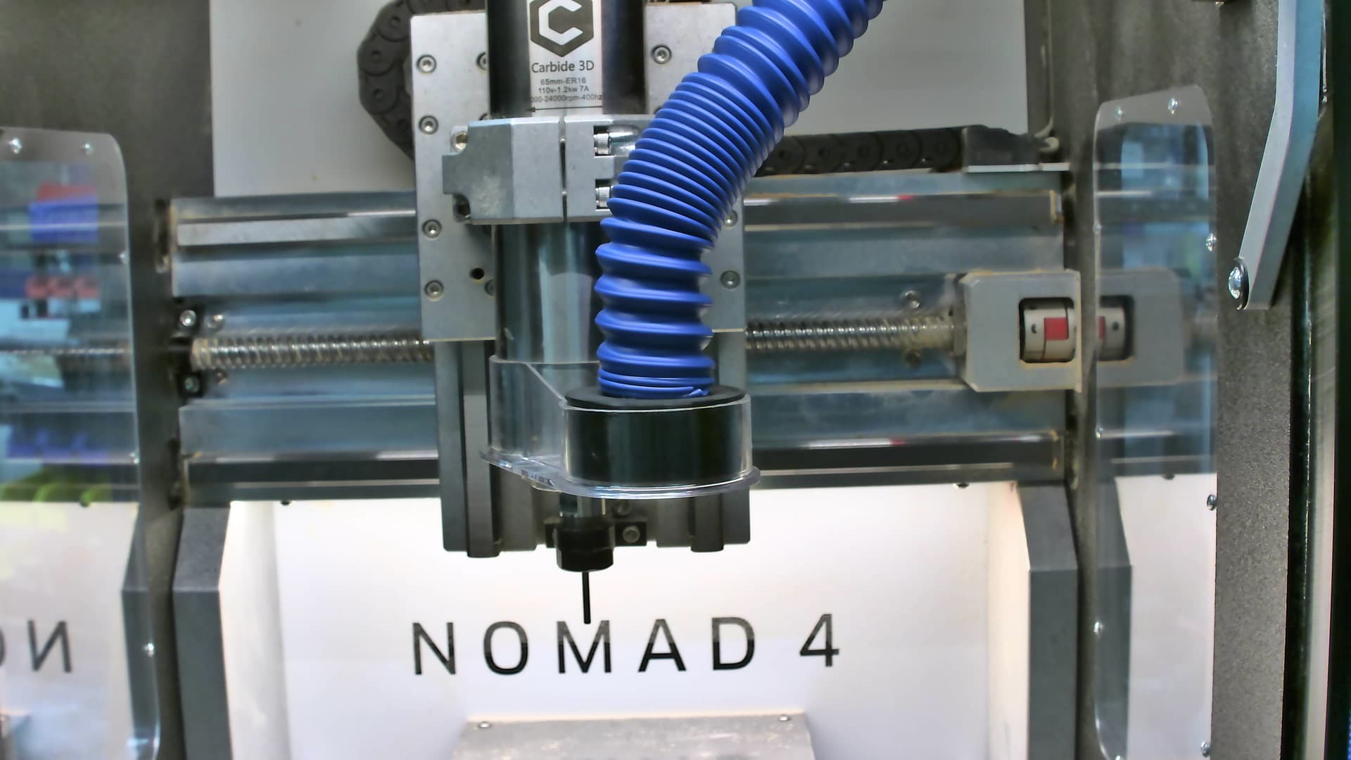

OK, Here is my Nomad 4 vacuum solution for use with the Rockler Dust Hose:

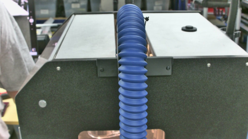

I tested this with my Rockler hose and it works pretty well I think. The hose guide ensures a gradual bend so as not to kink or pinch the Rockler hose. I tested it to easily function for the full travel of the spindle (left/right & up/down inclusive). I suggest moving the gantry all the way to the left, lower the spindle completely, and stretch the hose to its “comfortable” extent. Then lock its position on the hose guide using a zip tie. That way, when the gantry moves all the way to the right and the spindle moves up, the hose will simply collapse to its minimal length. I also have my Sweepy rotated slightly off center - just enough so it doesn’t touch the window when the gantry is up against the right side end stops.
The hose guide is 3D printable without supports as it is in 2 pieces. The holes which join the two pieces (bracket and guide) are sized for #8 screws which should be 30-45mm long. (I’m using #8 x 1-1/2" pan head wood screws)
The hose mount bracket is not symmetrical as the hose favors being all the way forward in the slot for best clearance with the spindle. (The screw mounting holes on either side of the slot are also not symmetrically placed). If someone would prefer to have a hose mount bracket to use on the left side, the bracket can easily be “mirrored” in your 3D Slicer software… The hose guide (curved part) will work on either side.
While coming in from the side actually works best for me, it also provides a relatively straight and unobstructed path to the spindle/sweepy. Coming in from the back might want to drag the soft Rockler hose back and forth and up and down across the back of the opening. If you want to come in from the back, a stiffer hose might be a better option to help maintain clearance. Coming in from the side is the best option I think for very flexible hoses like the Rockler.
The assembly screws onto the enclosure frame using existing screw holes. However you will need slightly longer M4 screws as the support bracket adds an additional 5mm (25mm work fine). Don’t screw down on those side screws too tight as they are only going into threaded sheet metal. If you want to have a “torque fest”, you will want to add some backing nuts.
Hose Guide.zip (629.2 KB)

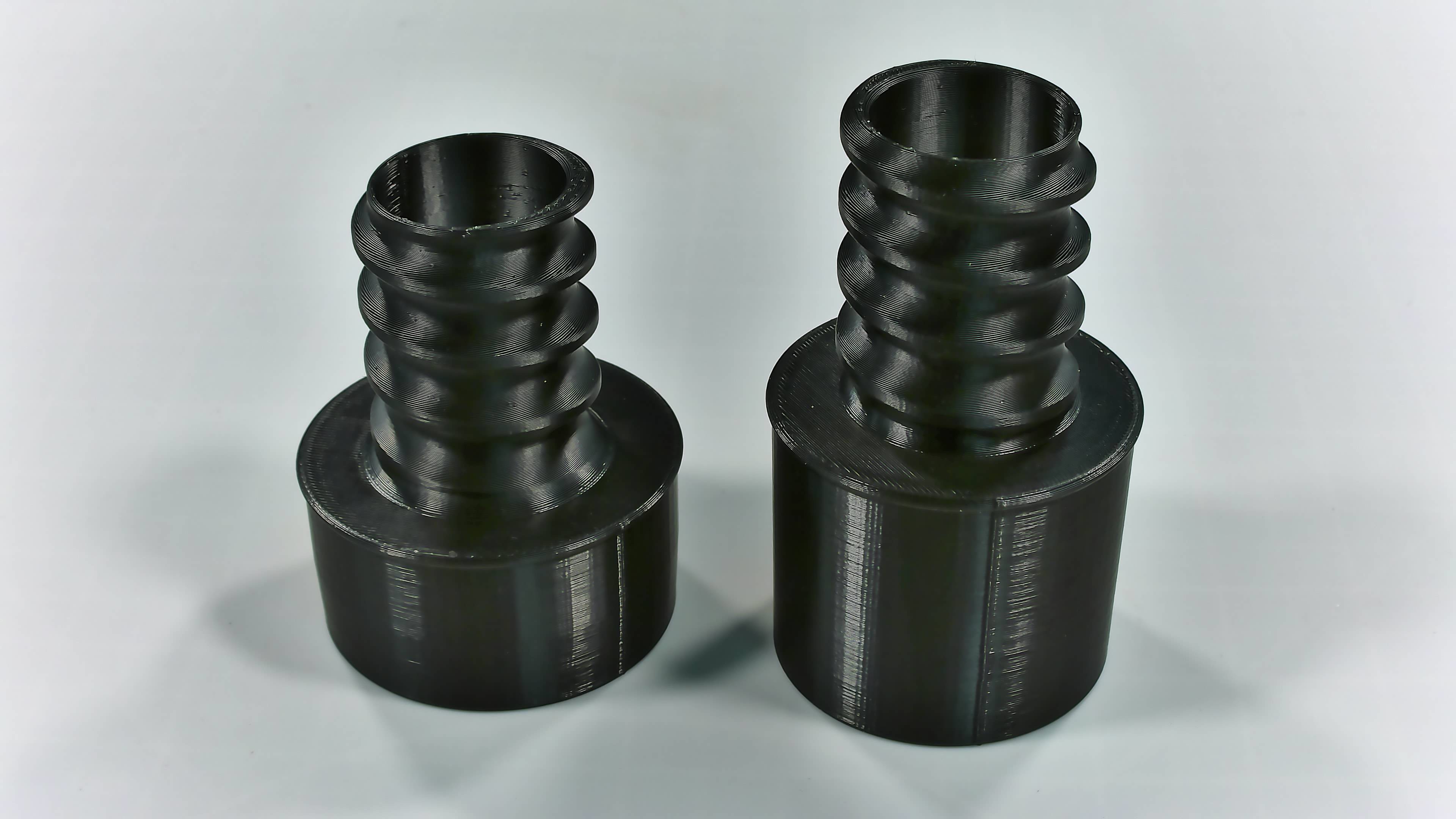

These fit pretty well I think. The one on the left slides right into the Sweepy (without requiring any secondary adapters). The one on the right fits a standard 2-1/4" shop vac port (like the one on my dust collector). They are threaded just like the OEM Rockler fittings so they will screw right into the hose itself.
I sliced these using the Prusa Slicer and printed them using Hatchbox ABS so a tiny amount of shrinkage was expected (0.5%). The fitments need to be pretty close. If you are printing these using a different material (or slicer), you may need to scale up/down a bit as required (1.005, 0.995, etc).
