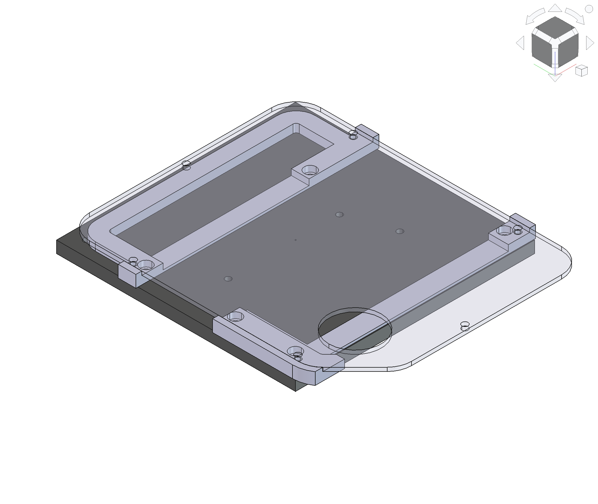

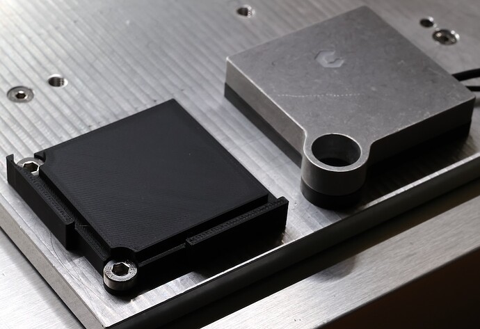

I cut a new side window for the Nomad3 on the Nomad3 from 12"x12" acrylic stock.
The window (7.7" x 9.7") is larger than the Nomad3 working area of ~8x8. This requires extra consideration with respect to work holding.
Process:
Rough cut 12x12 stock to ~8x10
Cut the first 8" length of the window

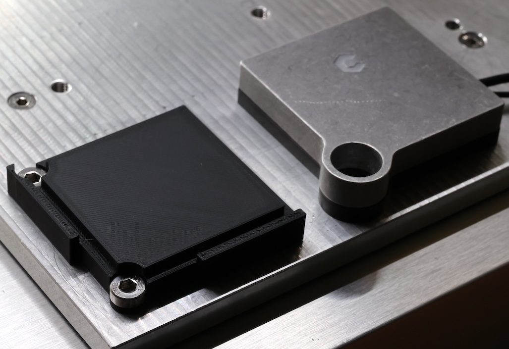

Create a jig for the bit zero over the SW table mounting hole. This becomes CAM origin

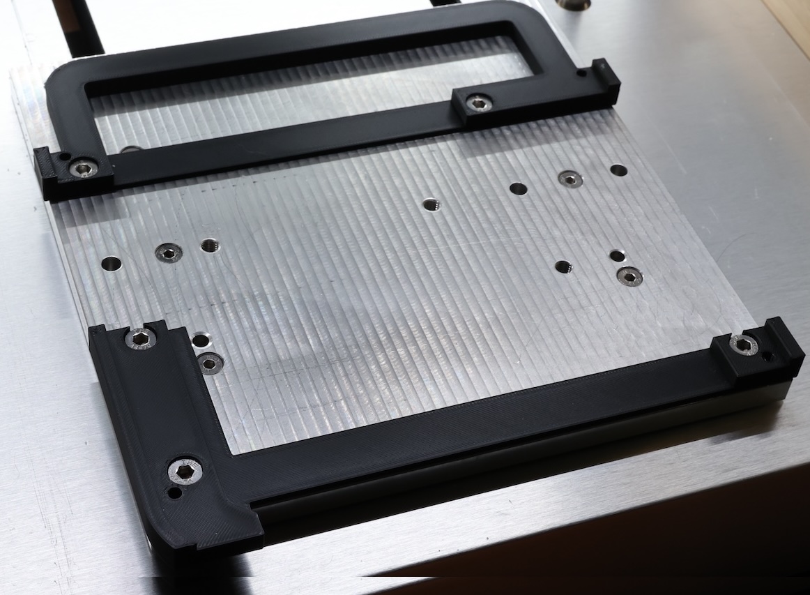

Create a jig to hold the window for remainder of operations
Perform final cut
The error introduced by flipping is on the order of 0.5mm. I believe this could be improved with two changes:
Use tapered head screws for better alignment with the window jig, instead of stock machine screws
Remove the acrylic protective sheet prior to final cut
VIDEO

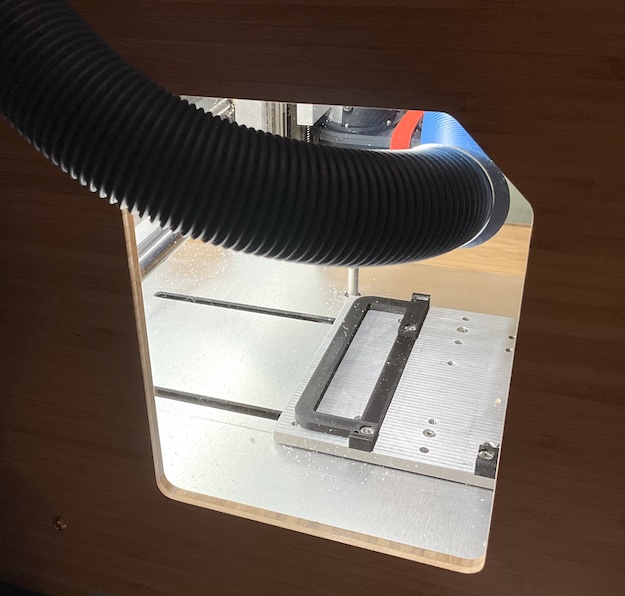

Nice work and fixturing, @andres (I am thinking the tooling is 3D printed?) but please forgive this question–is there a reason you didn’t remove the OEM window, tape a plastic bag over the opening, and mod it? (I don’t have access to YouTube and you might have explained this there…)
andres
(Andrew)
June 17, 2026, 4:25pm
5
@Randy that is the great question.
All things considered, I committed to the more precise/repeatable approach at the expense of time. I will take learnings forward into my next project.
The video is silent, and shows the cuts with active dust collection

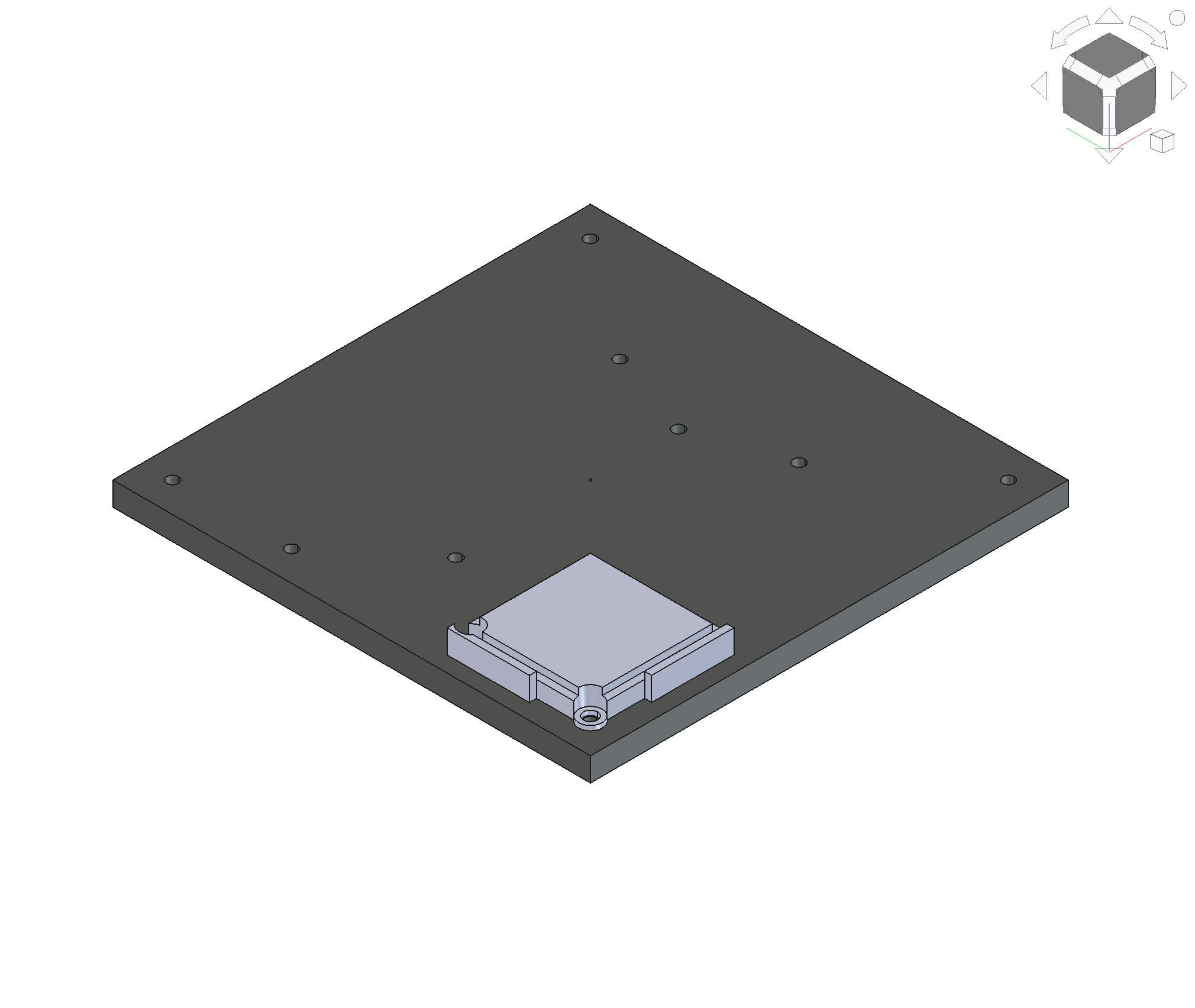

Adding drawing of bitzero jig

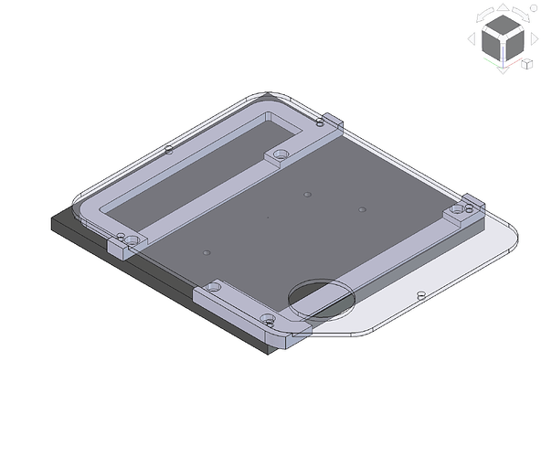

photo realistic render of previously posted CAD drawing
