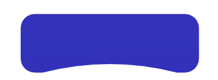

I have been asked to bid on a project for a customer to make three 57 3/4" square frames that will be added to a hallway with many more identical frames. They reached out to all the local frame shops and were told that this style has been discontinued by everyone so they are seeking a place to have them custom created. The sent a couple of photos that are not great so I went to the facility with calipers in hand and took a few measurements.
They are looking to have these in mahogany which I think I actually have enough of on hand. The big question is whether I can create the curved profile.
I think if I can create the curve then the rest is pretty easy and I need to cut a rabbet on the back for a plywood backer to be fastened in there.
The only idea I have so far is using one of these bits in the router table: Fingernail / Convex Edge Router bit-0604 – FindBuyTool.
They come in 2" and 2.5" but not 2.25". Even with the others, the radius they claim looks to be too small.
I have Vectric Vcarve and have been playing with the molding toolpath for another project but it would take about 17 years to cut the pieces for this one using that technology.
I have access to a shaper but haven’t found any shaper bits that would work either.
Ideas anyone?
