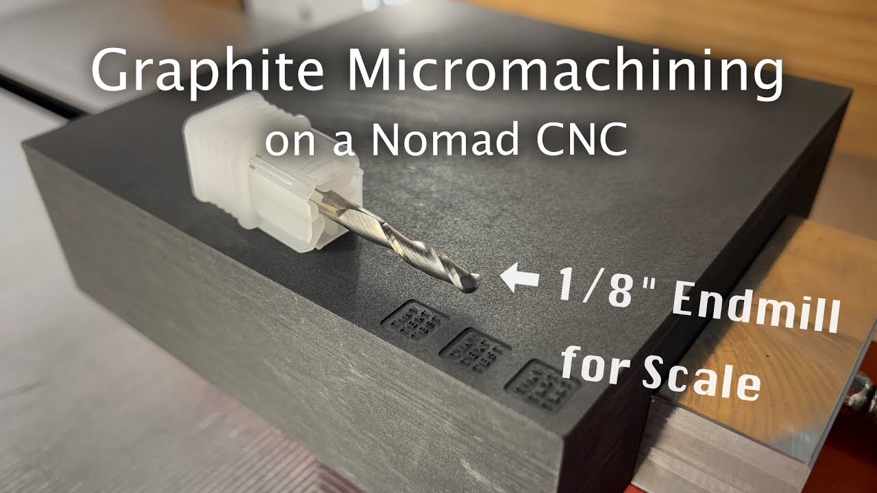

So you must have seen all of @wmoy’s videos ?
Here’s the one I think exemplifies the Nomad3’s accuracy for tiny parts,
I think (but have no evidence) that the Pro would struggle to achieve this.
That said if I consider ALL your usecases, then I would say “go for a Pro” because of 1 and 3.
The Nomad3 is a great machine but it does have a limited work area, so depending on the size of the brackets/plates you will need to make, you may find yourself limited. Same for knive shapes (if you make Rambo-style knives :slight_smile: ).
You also won’t be able to hog lots of aluminium at large material removal rates on a Nomad (that’s not the point of that machine), but this relates to the time you have for your machining / the productivity you are after.
#2 might be the case that’s better suited for a Nomad, depending on the gear size and precision required.
