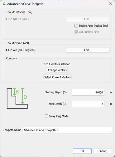

You are still using V carving toolpaths:
Delete them:
Select everything:
Choose “Advanced VCarve”
“Use Current Selection”
make appropriate selections:
including setting the Max Depth:
Concerns include:
- tool selection — the 30 degree Amana is defined as an Engraver, not a V tool
- setting Max Depth and other parameters
- overlapping geometry — see: Merging Script Fonts in Carbide Create V6
- figure ground reversal: Figure ground reversal and Figure-ground reversal and toolpath considerations
which previews as:
