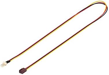

It has been a long time since I wired a molex connector. I seem to remember it took special tools. Can you get the connector neilferreri referenced pre-wired ?
Bill
for most connector types you can find extension cables, like;

I visited a friend who has been repairing computers as a hobby / business for years. He has a cupboard full of miscellaneous components that may never see the light of day let alone usage. When I asked if he might have a fan header cable he cautiously opened the cupboard door and felt around in the dark interior and pulled out a … CPU fan / heatsink for a 266 MHZ CPU. The cable and connector was just what I need.
The cost was I had to dispose of the unused fan and heatsink.
