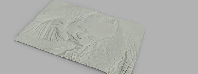

Here is my attempt. I used Fusion to convert the image to STL.
Use a gray scale version of the image to get a feel for how a conversion may work.
These programs use contract ( black to white ) to determine heights.
Here is a render of the conversion.
I put a STL file on Google drive.
Please let me know when you are done with the link or have issues getting access.

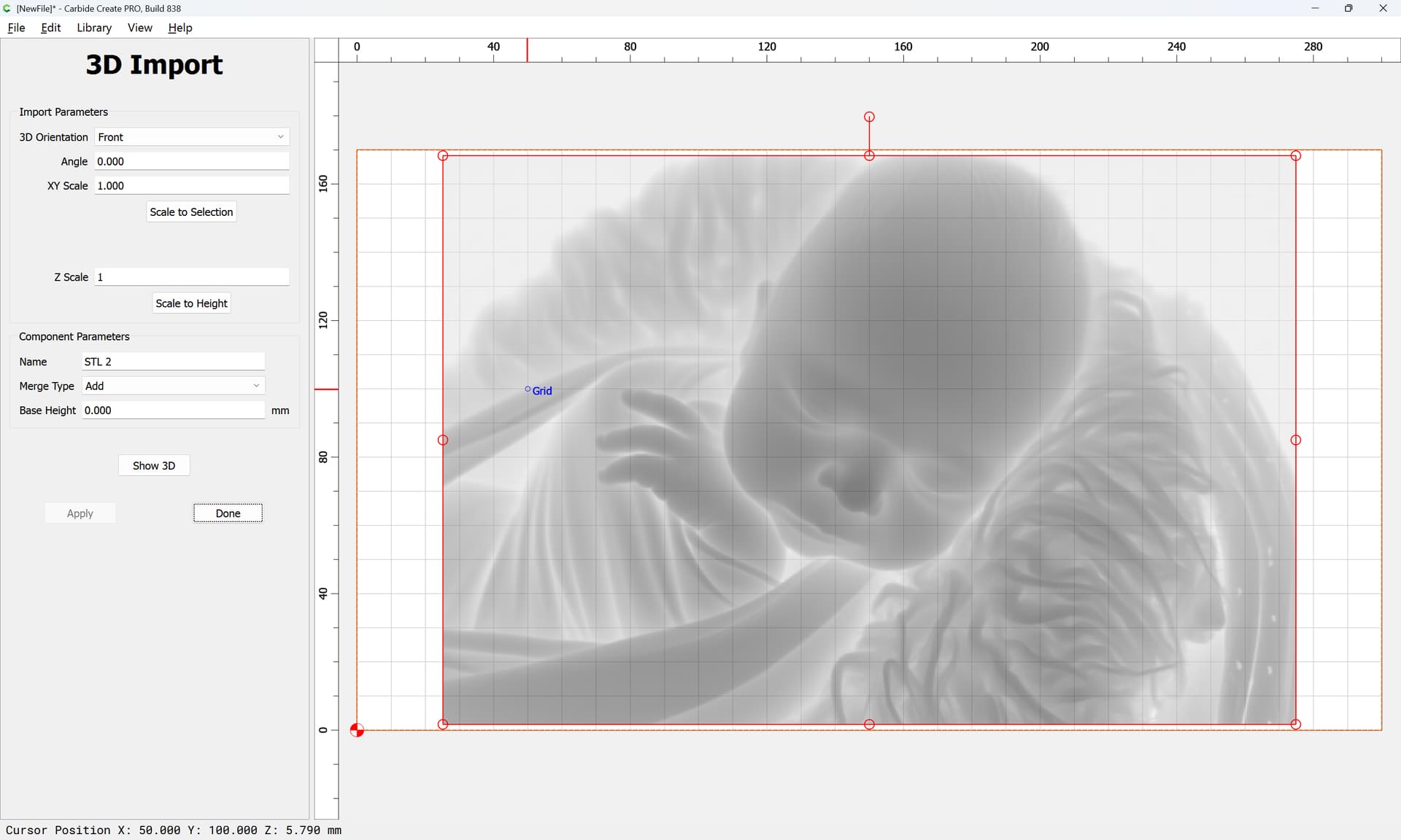

https://carbide3d.com/hub/courses/create-pro/3d-tool-import-stl/
and then import the file:
adjusting the settings to arrive at:
which previews as:

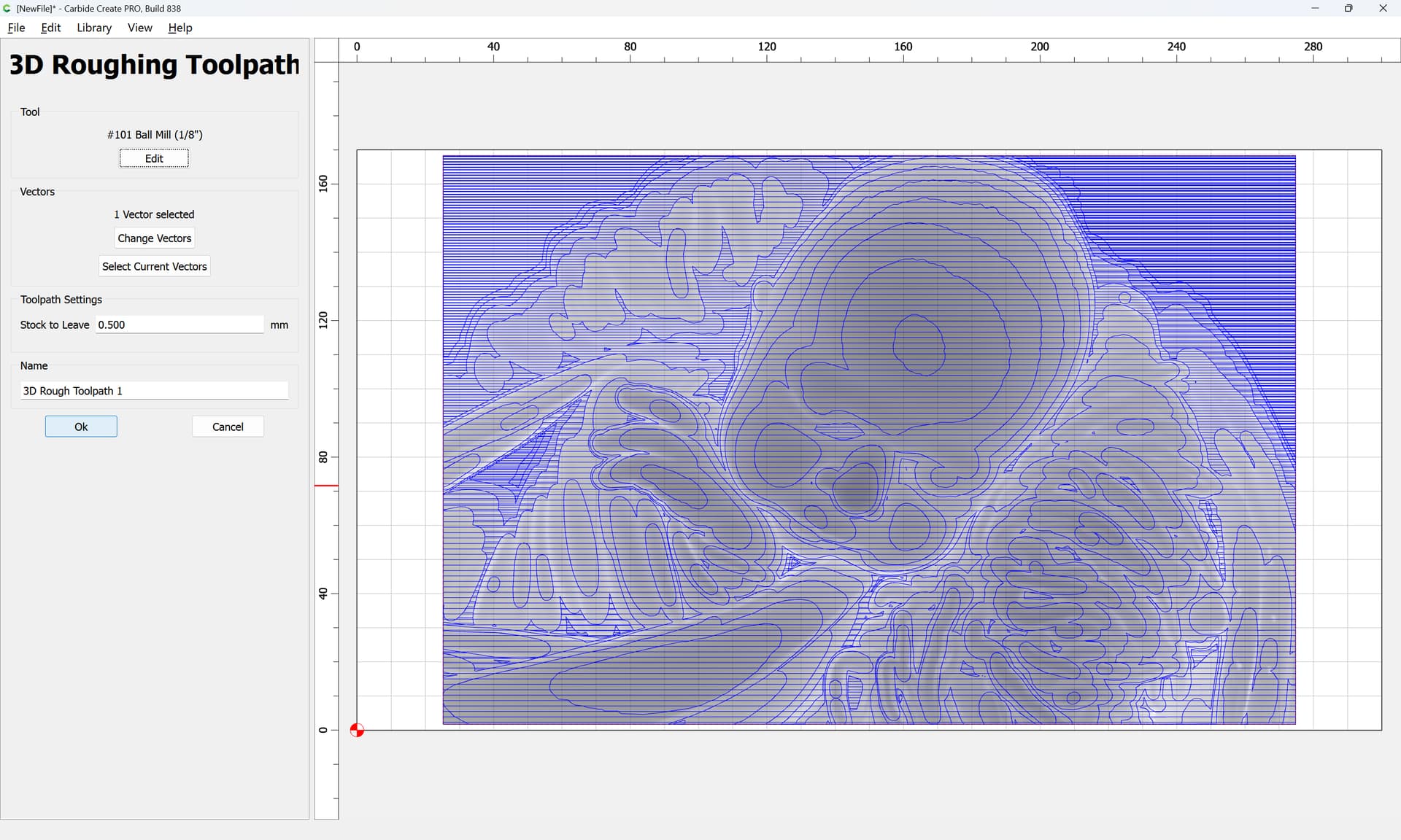

and if one sets up toolpaths:
adjusting the Stepover:
Previews as:
