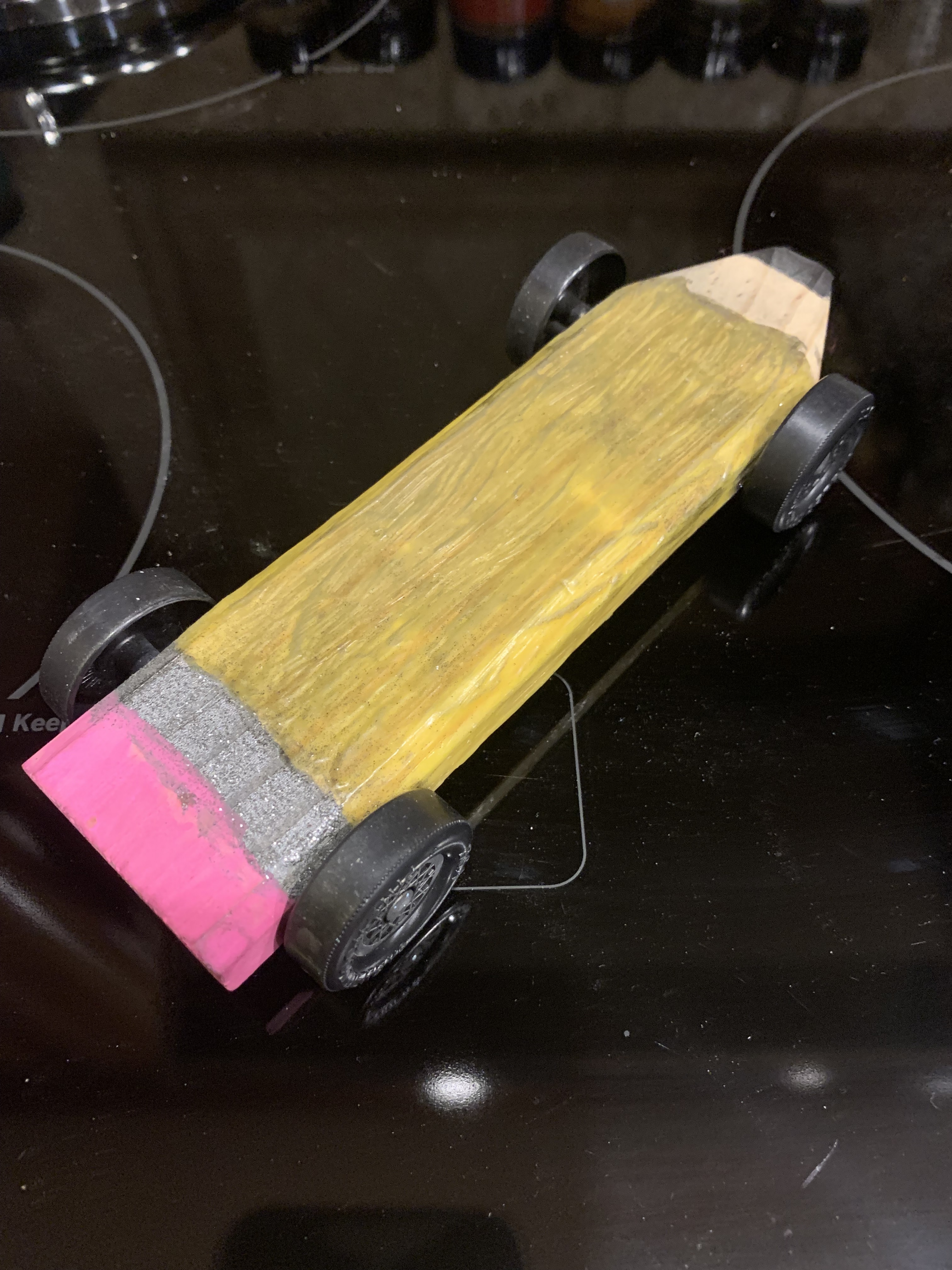

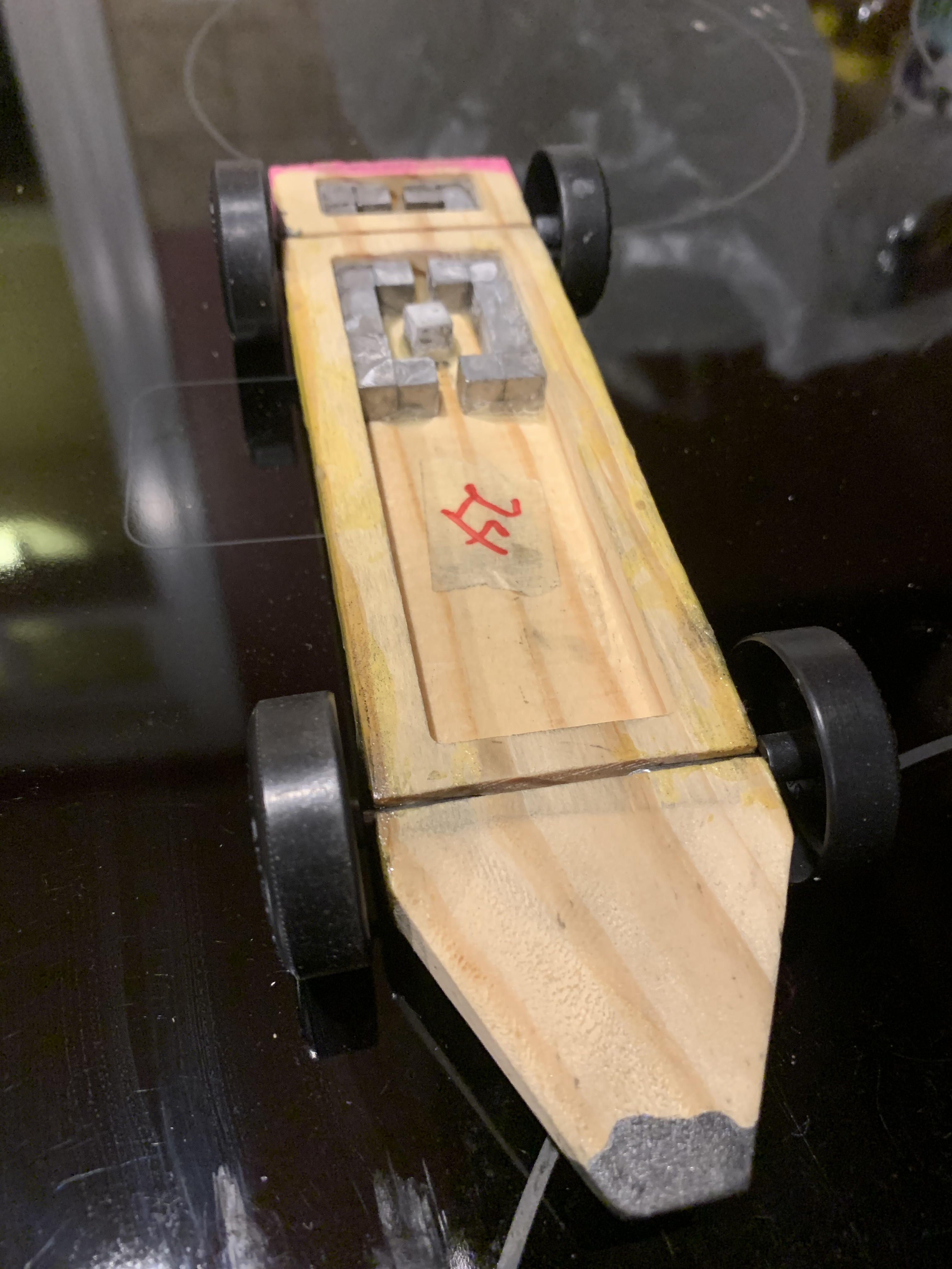

My son’s design, cut at home. Absolutely the fastest car he ever built. It beat the winner of the race for the next 3 years as the car can only be used for one race season.

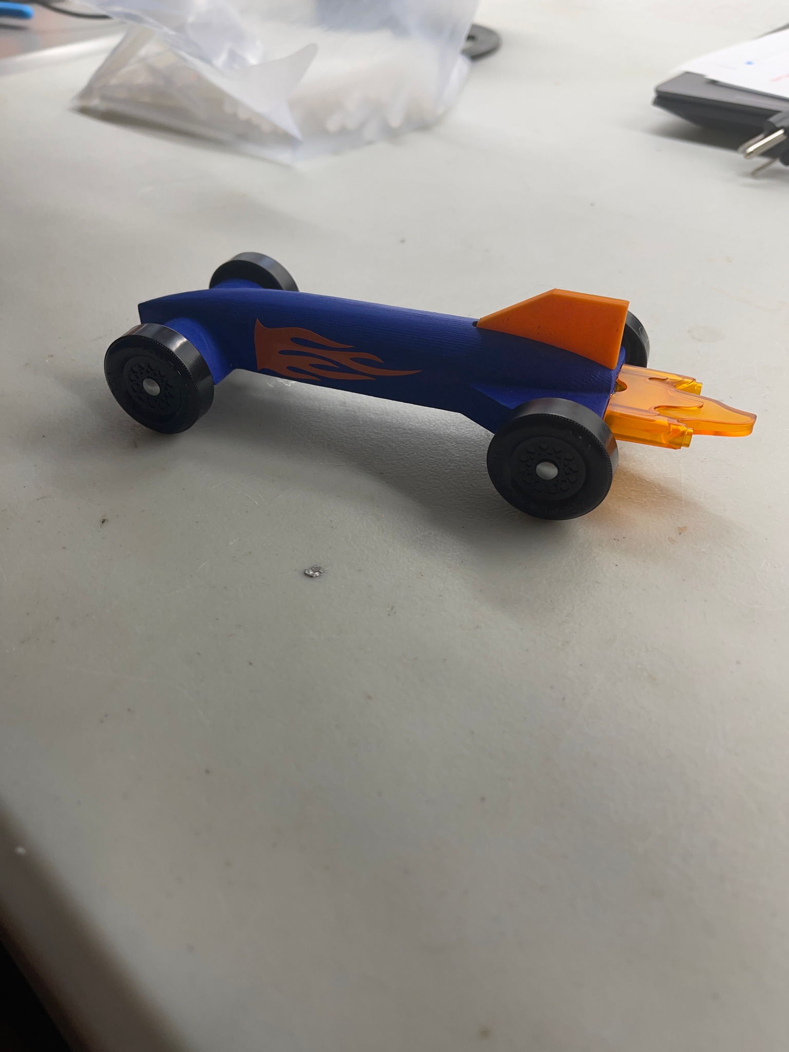

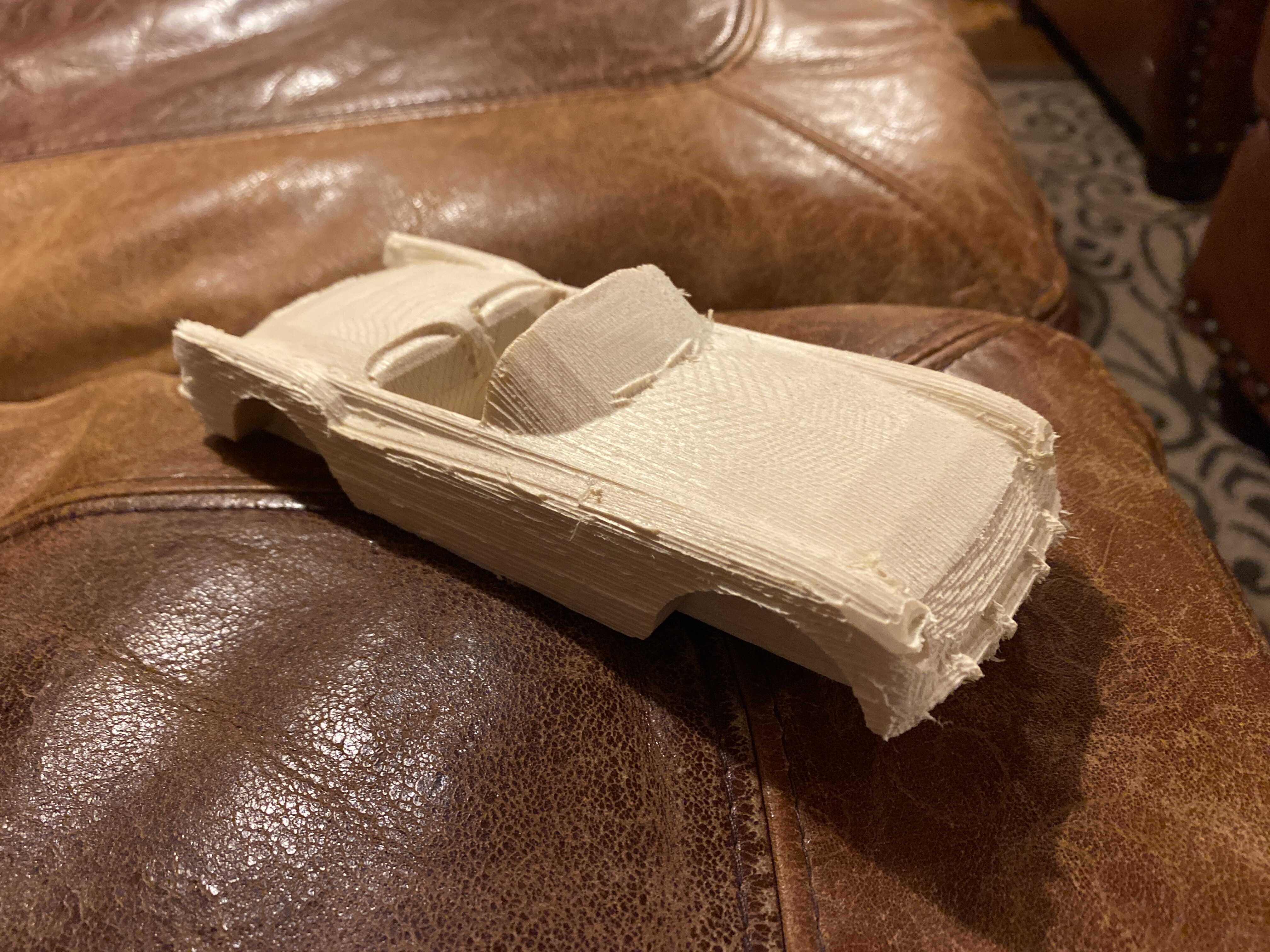

The body is machined. Fin is 3D printed. Flame is lego.

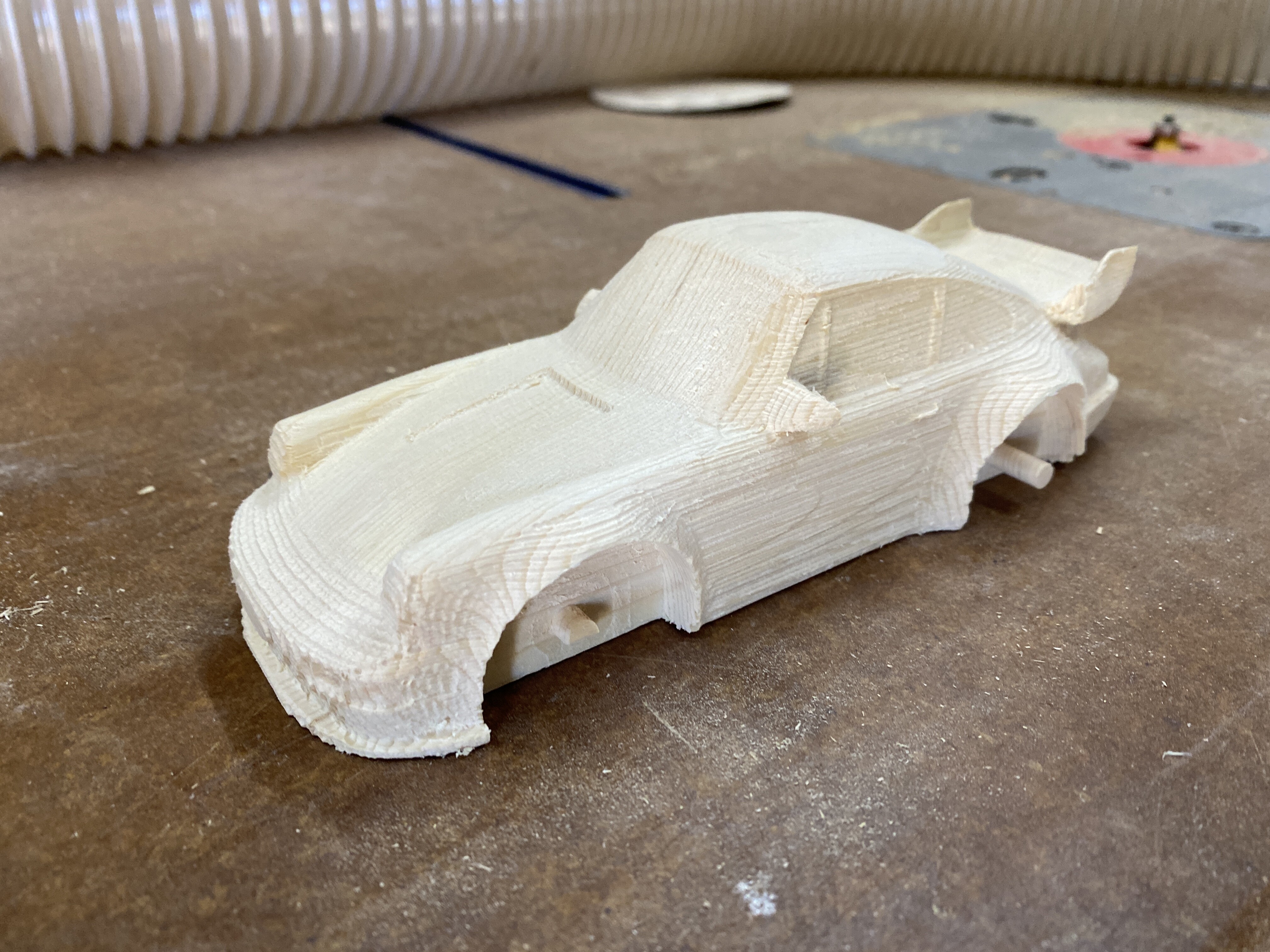

Very nice. Milling every face of the block I assume?

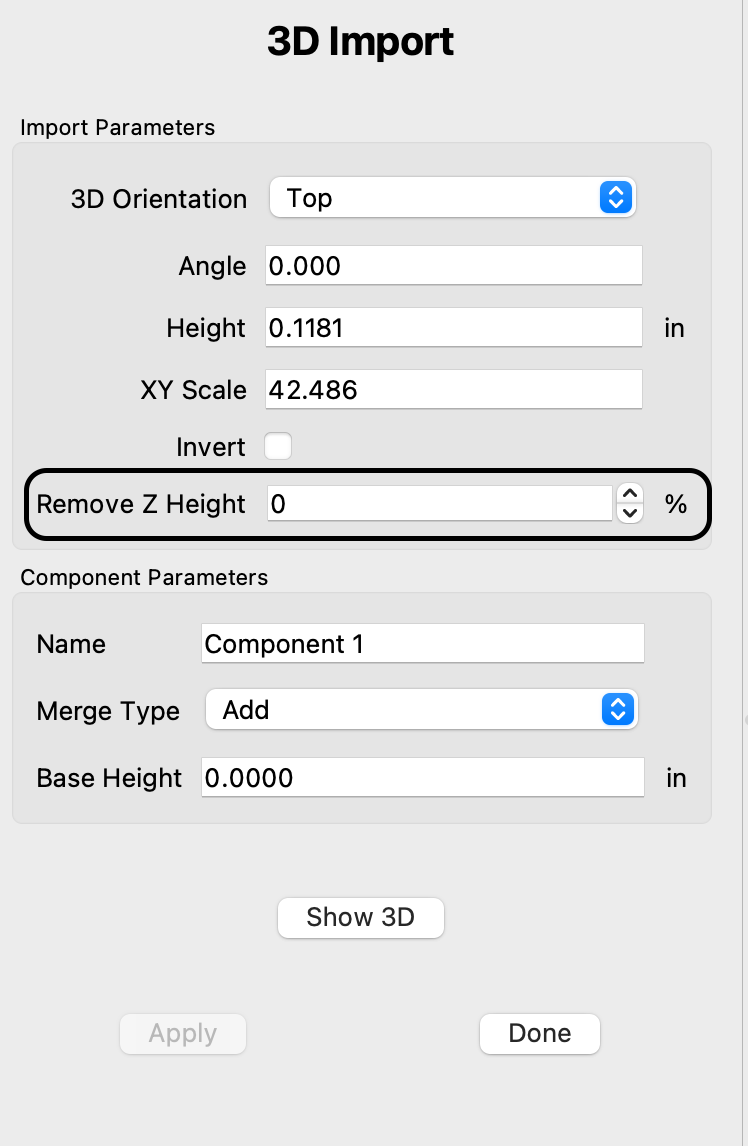

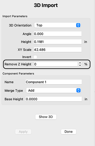

Yes, in Carbide create pro you can pull an stl in from sites like thingiverse. I used a block of pine (not from the kit). If the rules require using the kit you’ll have to glue pieces on. You want the exact outside dimensions to be 2.75 x 7, height depends on the car, probably between 1.75-2.75 (Rules say “The overall length of the car shall not exceed 7 inches. The overall width of the car shall not exceed 2 ¾ inches. The car must have 1 ¾” clearance between the wheels.”) Set the dimensions in carbide to match and the check to see that the stl fills the space. It may require distorting the proportions a bit.
There is an option in pro to Remove z height.
Use this or draw a line just inside the image, I found it works best if you don’t let the machine try to carve the steep sides. Carve top and two side separately. I carved the front and back if I wanted a lot of detail. Make your own pockets for the wheel wells, as the stock wheels won’t match the proportions of the stl. Make the pockets 1/2 inch deep. It might be easier to cut the axle groves before the carve, take the measurements of the CC design (they won’t line up with the stock groves). If speed is a concern you’ll want to hollow as much of the inside as you can and add weight to the back. Last tip, use a practice block before you throw the real thing in there.
Hope this helps

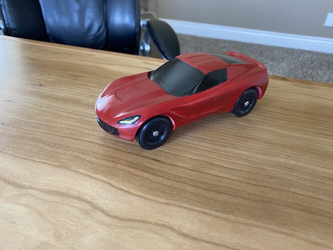

My dad was an accomplished carver and I had (still have) some cars 45 years ago that were pretty nice. I helped on them of course. Some were fast and some won for design.
My boys were too young for much of the tool work this year but if I make a concept car for them maybe I can get them really into it next year. I am hoping having them assist with the design and machining and then doing the sanding and finishing meets expectations these days. I don’t think the rules restrict you to the traditional tool set.

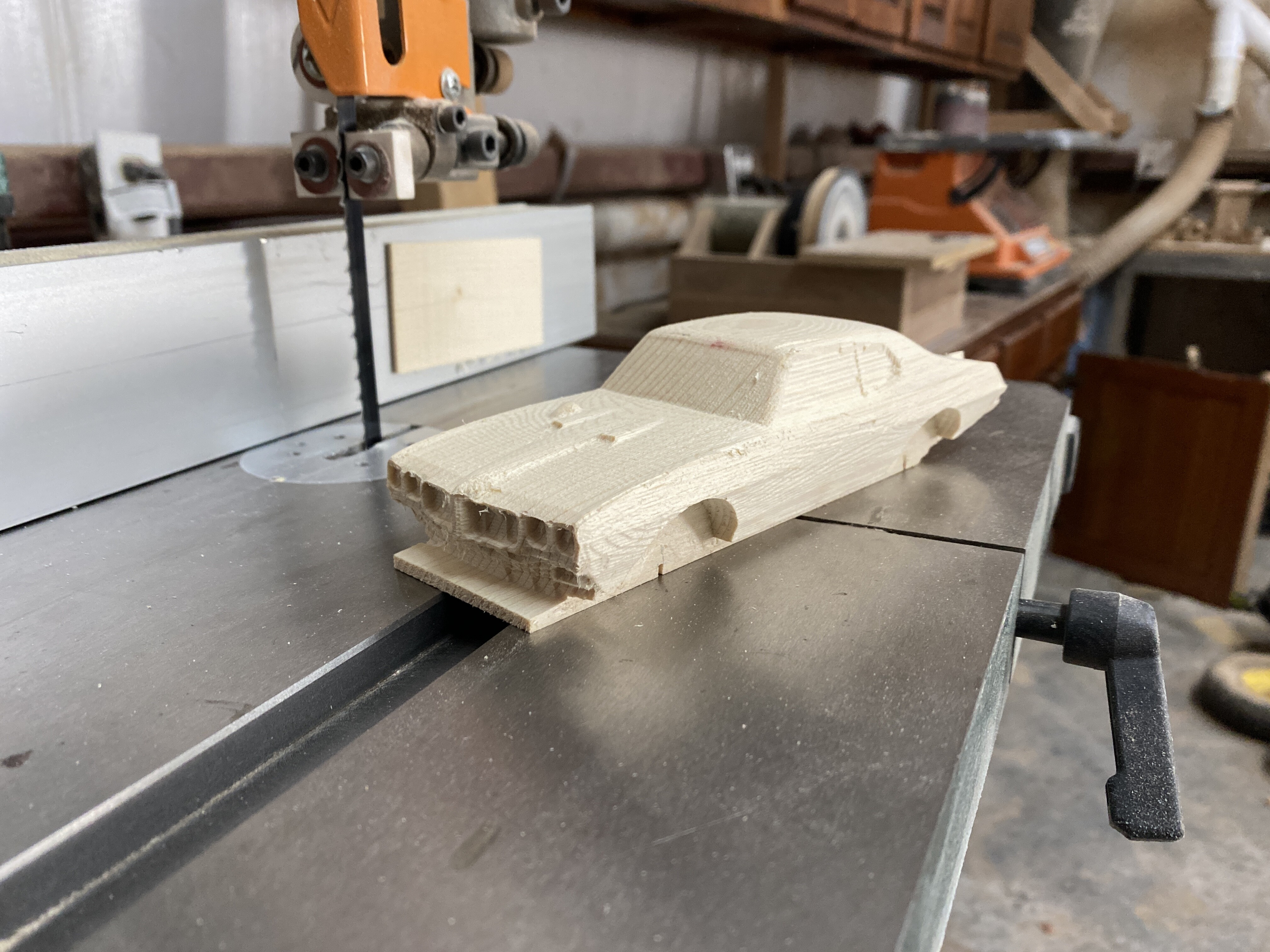

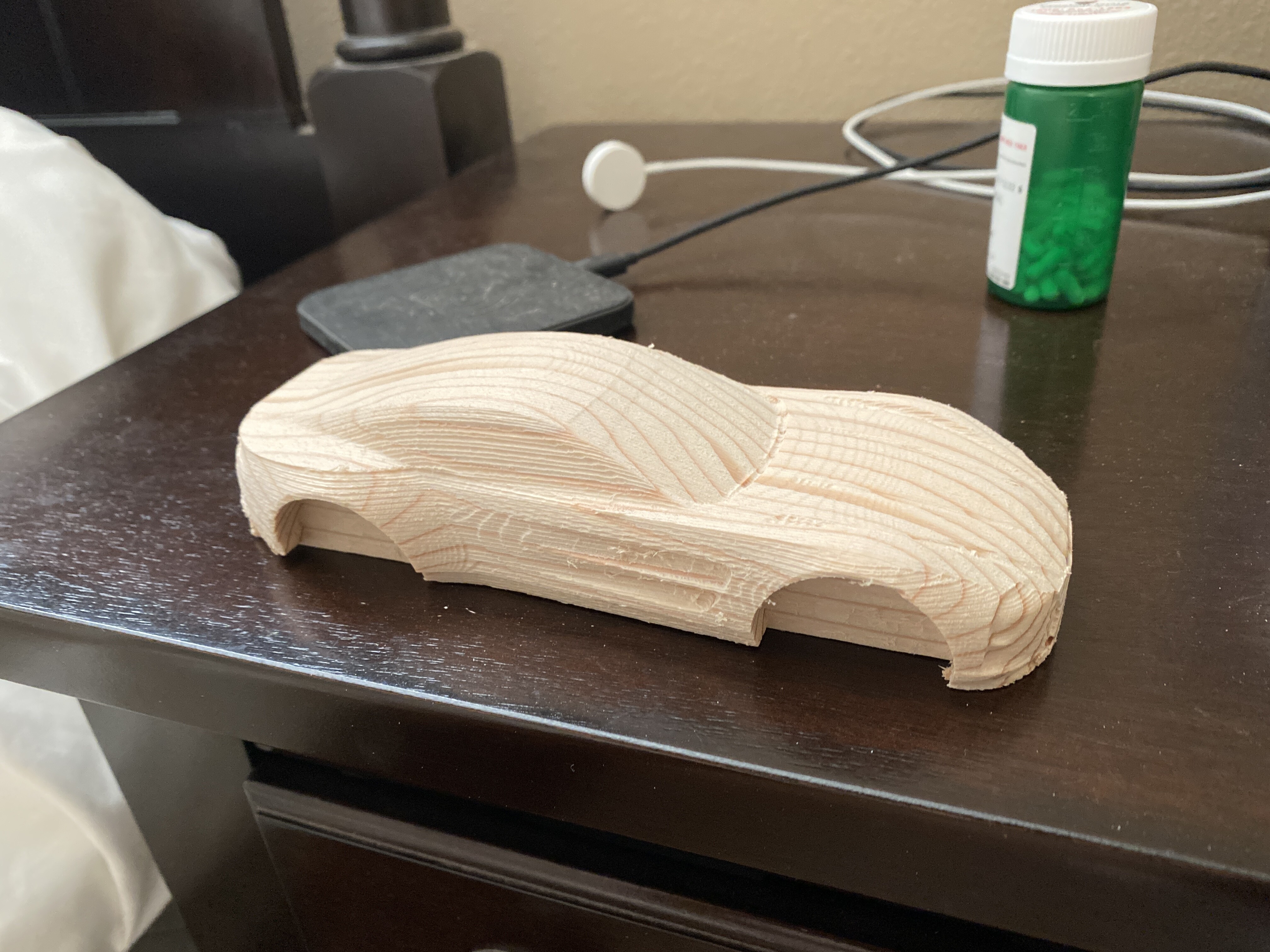

I carved cars for all the adults involved in the Derby. Hosted about 50 kids in my wood shop to cut their cars out. lots of fun
