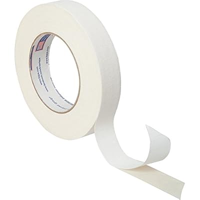

I’d get a roll of double sided paper tape such as
