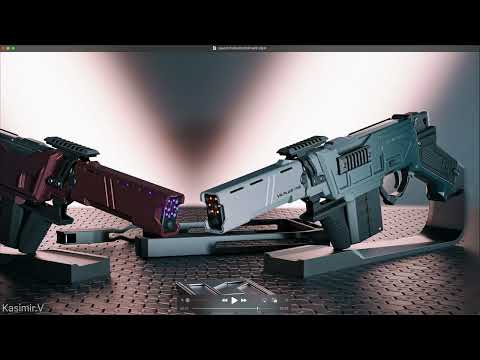

Plasticity 3D recently announced
Uses the same CAD kernel as SolidWorks, Siemens NX, and a number of other tools.
Described as “CAD for artists” and seems to be a competitor to Moment of Inspiration and Shapr3D.
Perpetual licensing ($99 and $299), but locked to specific computers (up to 8 transfers w/o contacting support)
The application itself is opensource under the LGPL:
