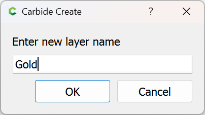

For now, we make a new Layer:
and move the geometry in question to it:

Duplicate the circle:
and move it and the original to the Gold layer:
