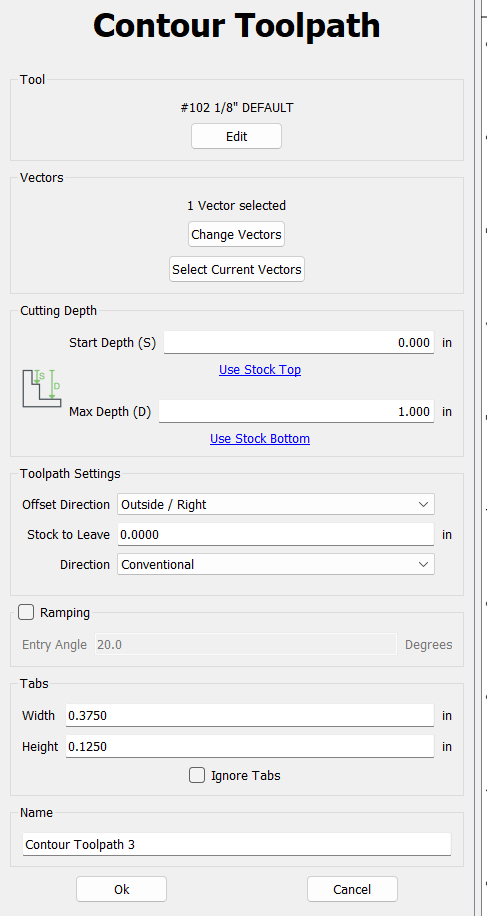

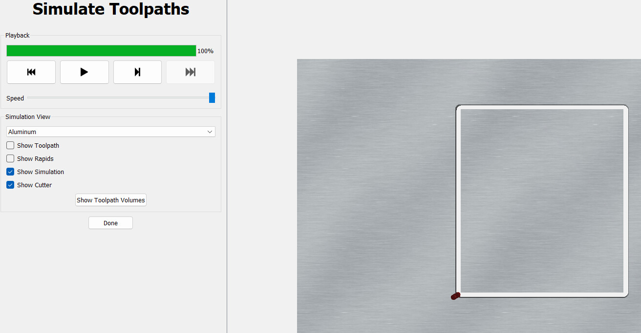

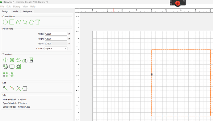

I’m noticing that if I create a box and then try to add tabs later, like after I finish defining my toolpath details for example, they continually disappear. I have to delete the box and recreate it.
Using create pro v764
Please check and see if this happens in v8:
What is the Max Depth for the toolpath? Greater than Stock Thickness + Tab height?
Upload the .c2d file and step-by-step instructions for causing it?
In my experience this bug occurs if you create a shape, then add tabs, and then resize it. The tabs disappear when you resize, which is normal, but trying to re-add tabs will fail. You can recreate the shape from scratch, or save the file, quit CC, and then relaunch and reopen the file.
I tried to recreate this on the Mac version of CC 810, I couldn’t. The tabs never disappeared and seemed to keep their size and depth specifications after scaling the shape.
