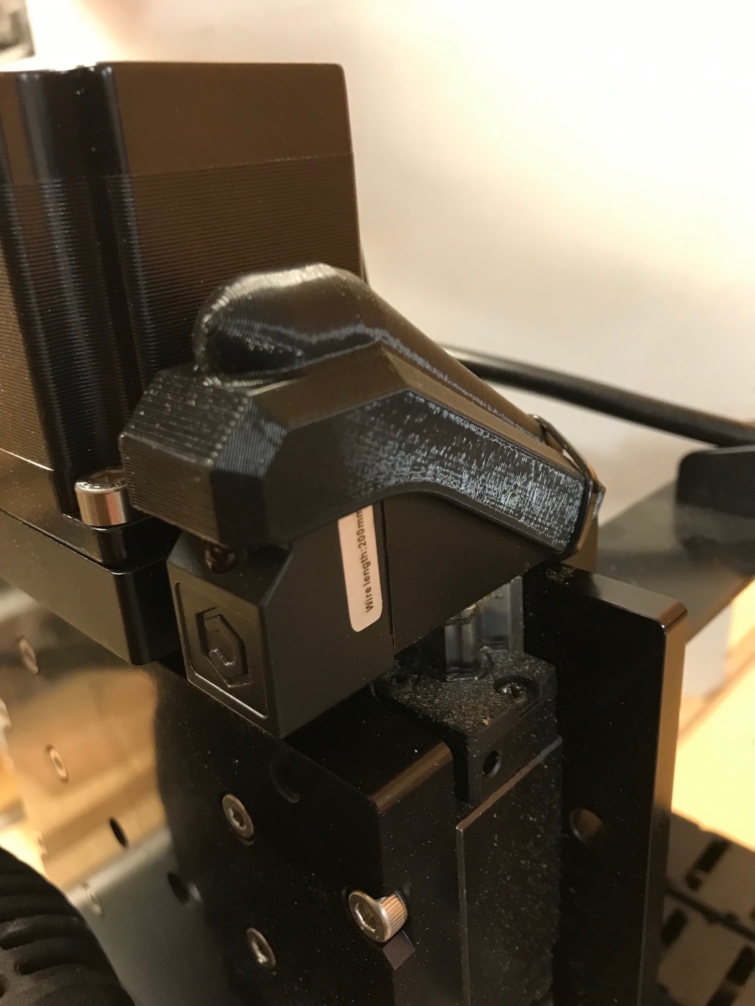

Thank you so much. I printed the first 2 and I was very impressed, Nice work :+1:
I hope you do mind I extruded the clip higher and printed it with 100% fill. Removed the tab in the cover. I then just drilled and taped into the solid clip with a self tap screw for plastic. I might still print the magnet one, I just didn’t have a magnet at this time :slight_smile:

I added the cover for the Z sensor and the right and left cover. Looks great.
I then ran a couple of jobs. I think the machine runs better now, more aerodynamic :slight_smile:
Looks Great Thanks. I took some pics and will send them later.
Here are the pics as requested :slight_smile:
I did a slight mod. I made the clip taller and printed them with 100% fill. I removed the tabs inside the cover. Drilled and tapped it with a self tapping plastic screw. :slight_smile:
I didn’t have any magnets :slight_smile:

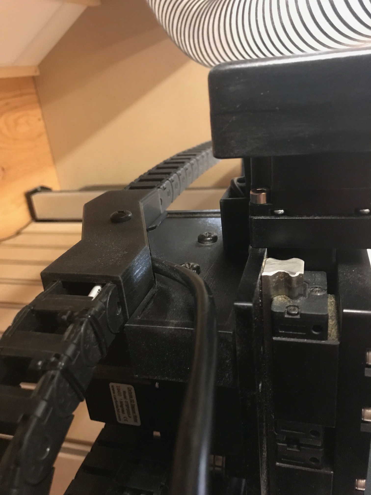

Note how the router power cable is ran. I added a thin cable clamp and mounted it under the side mounting bolt. then it runs underneath and straight into the Cable Chain. Much better and out of the way On a side note, I replaced the side mounting bolts with longer ones. After adding the Cable Chain brackets, there was only 2.5 thread holding them in the aluminum. That is not enough IMHO.
I should do that also, I appreciate the heads up.
