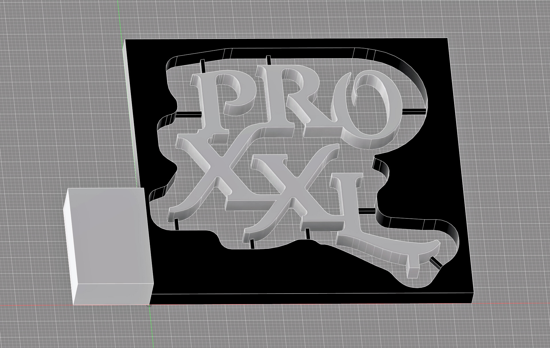

Here is the Fusion file, with tool paths.
PRO XXL Fusion File

Pro XXL insignia, is designed to be cut out of 1/2" Aluminum 8" tall by 8.5" Wide, using a 123 block to probe from. Make sure to remove the block after probing!
It has a lower right tab that is meant to lock into a base, that I have yet to design. I will link the base models and tool path files to this page asap.
4 Toolpaths start with a #201 for a top surfacing, a #278 1/4" single flute to do the heavy carving, then step down to the #274 1/8" bit for the tight corners and shave off a little of the stock I left on the sides, then I finish shaving off the rest of my stock to leave, with an Amana #46292.
