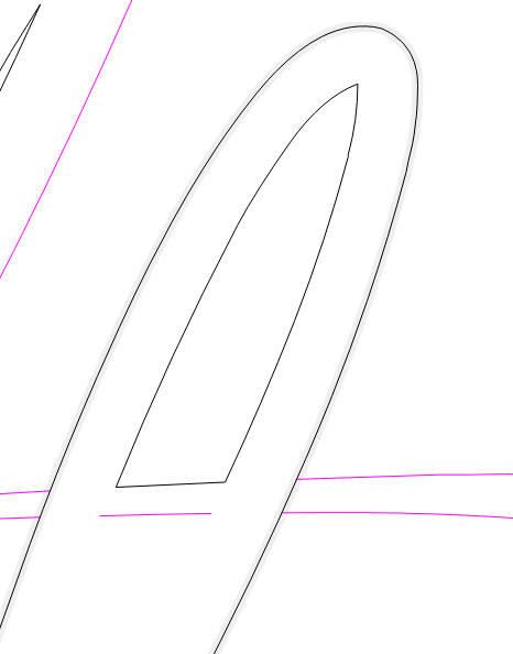

One additional question. Is there a way to make the pocket in the h two separate pockets?
No matter what I try the toolpath cuts the part of the letter t that goes thru the h
TheSign.c2d (238.5 KB)
- First, make a copy of the interior vector of the ‘h’
- Zoom in, see that the lower divider line doesn’t touch the interior vector. Select the lower line, use ‘Node Edit’, and drag the left most node so it cross over the vector:

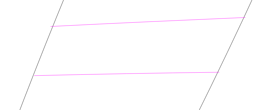

- Select the interior vector and one of the two lines, use ‘Trim Vector’, then select the part of the interior you DON’T want to get rid of it.
- You still have two unclosed vectors at this point. You can EITHER
- Delete the horizontal line, select the vector, and use ‘Join Vector’
- OR, selectboth parts, use ‘Node Edit’, and move the end nodes of the horizontal line to match the end nodes of the vector, then ‘Join Vector’ with both selected.
Either one works because you just want a line. If the ‘horizontal line’ wasn’t a straight line, use the second method to preserve it as part of the vector.
Now drag the copy of the interior vector back into place, and repeat for the other line.
