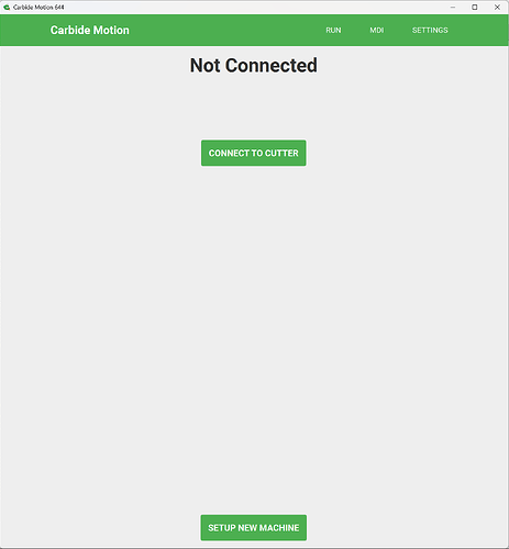

Connect the USB cable, power up your machine and launch Carbide Motion:

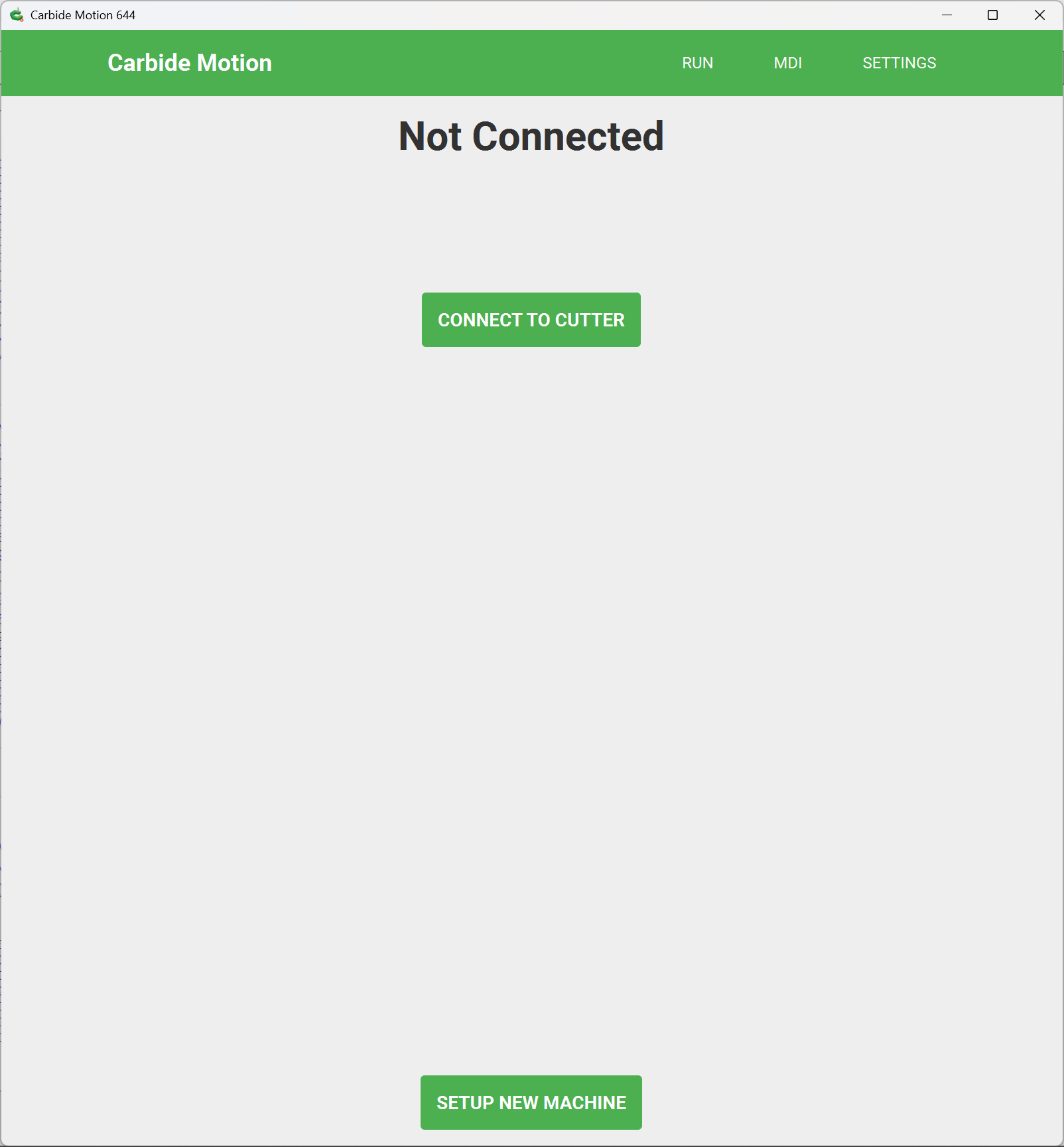

click “Connect to Cutter” to connect to the machine:

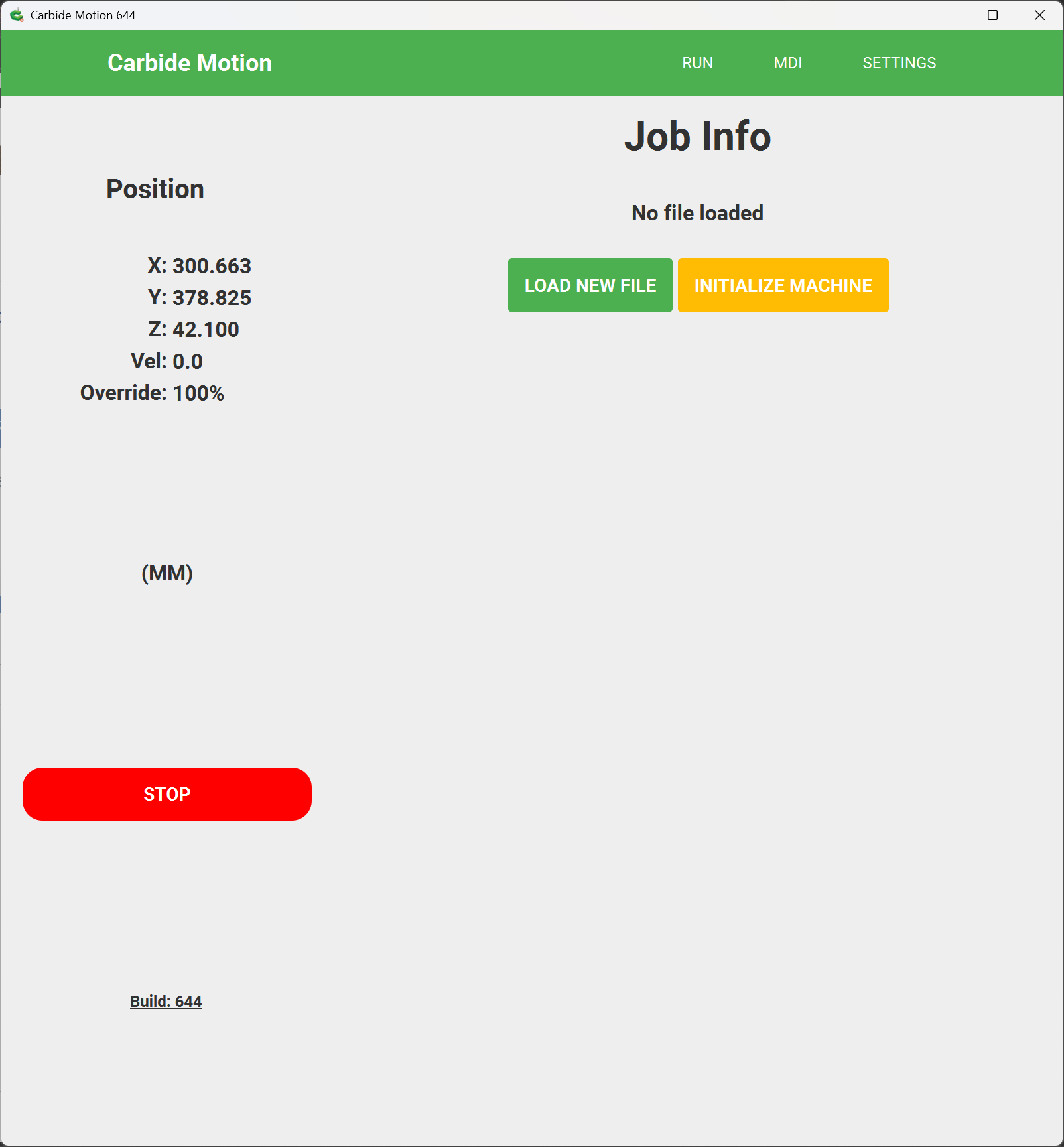

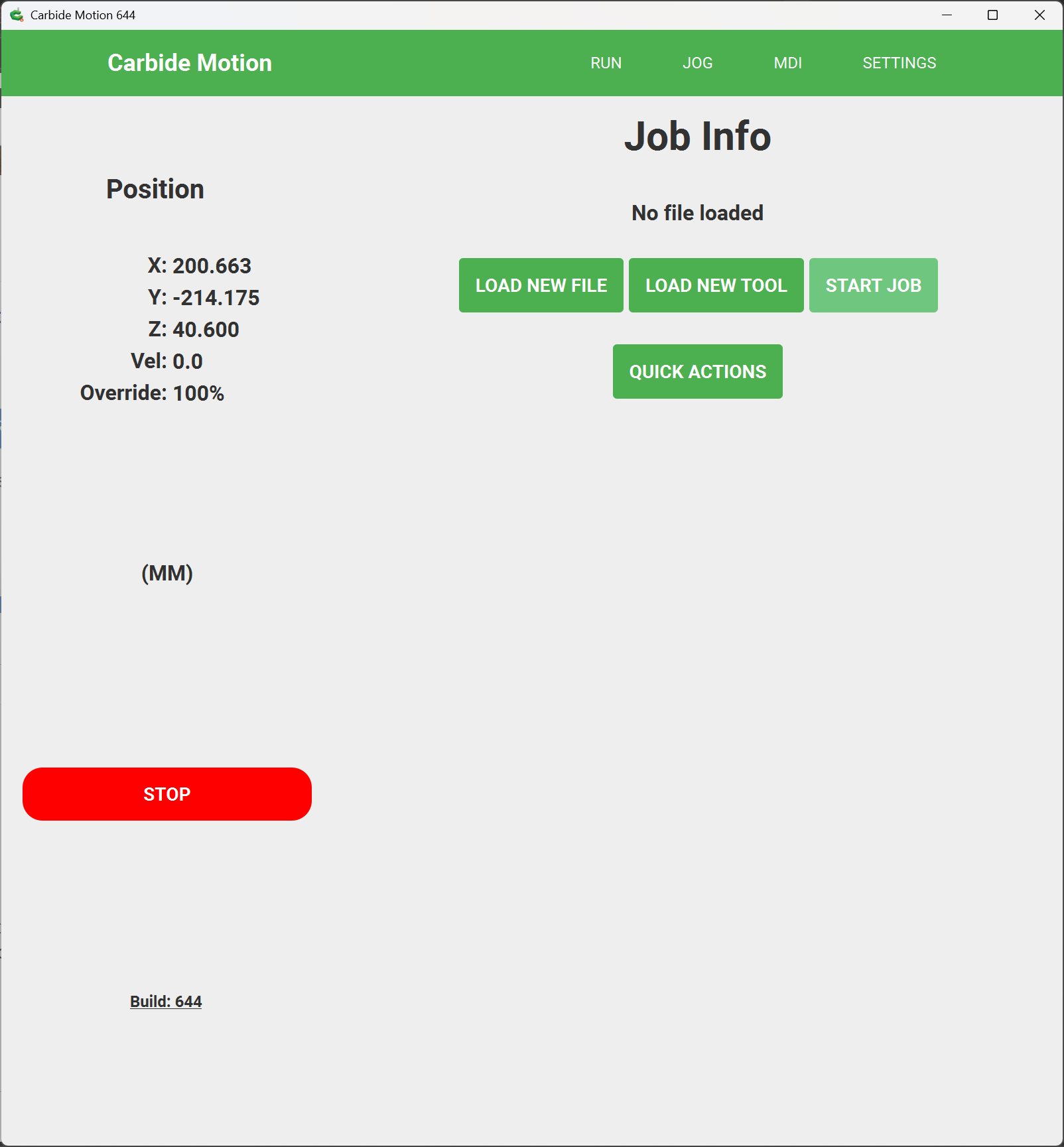

click “Initialize Machine” to initialize the machine — the machine will move to the back right corner, set the machine origin there, and then move to the tool change position:

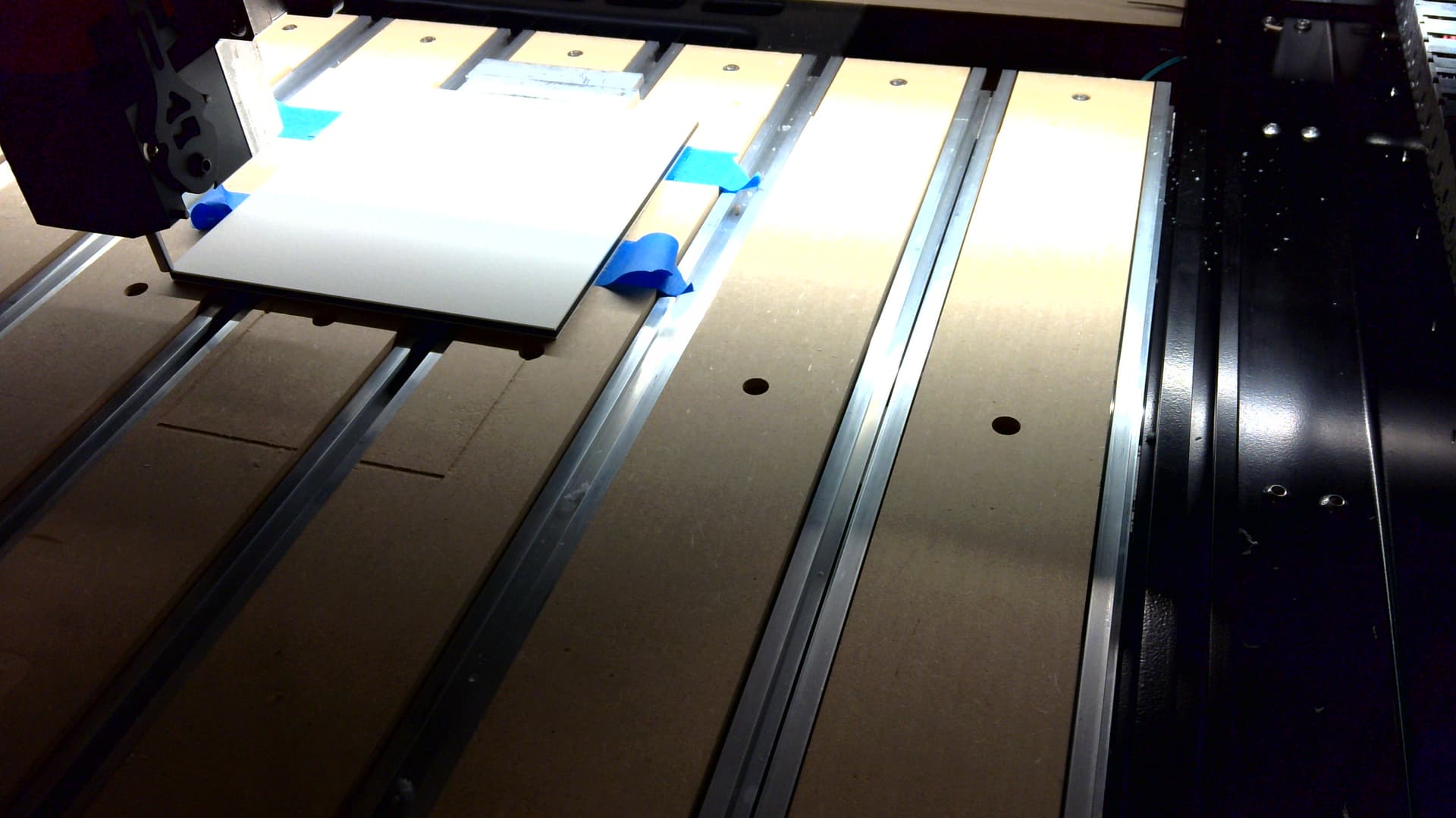

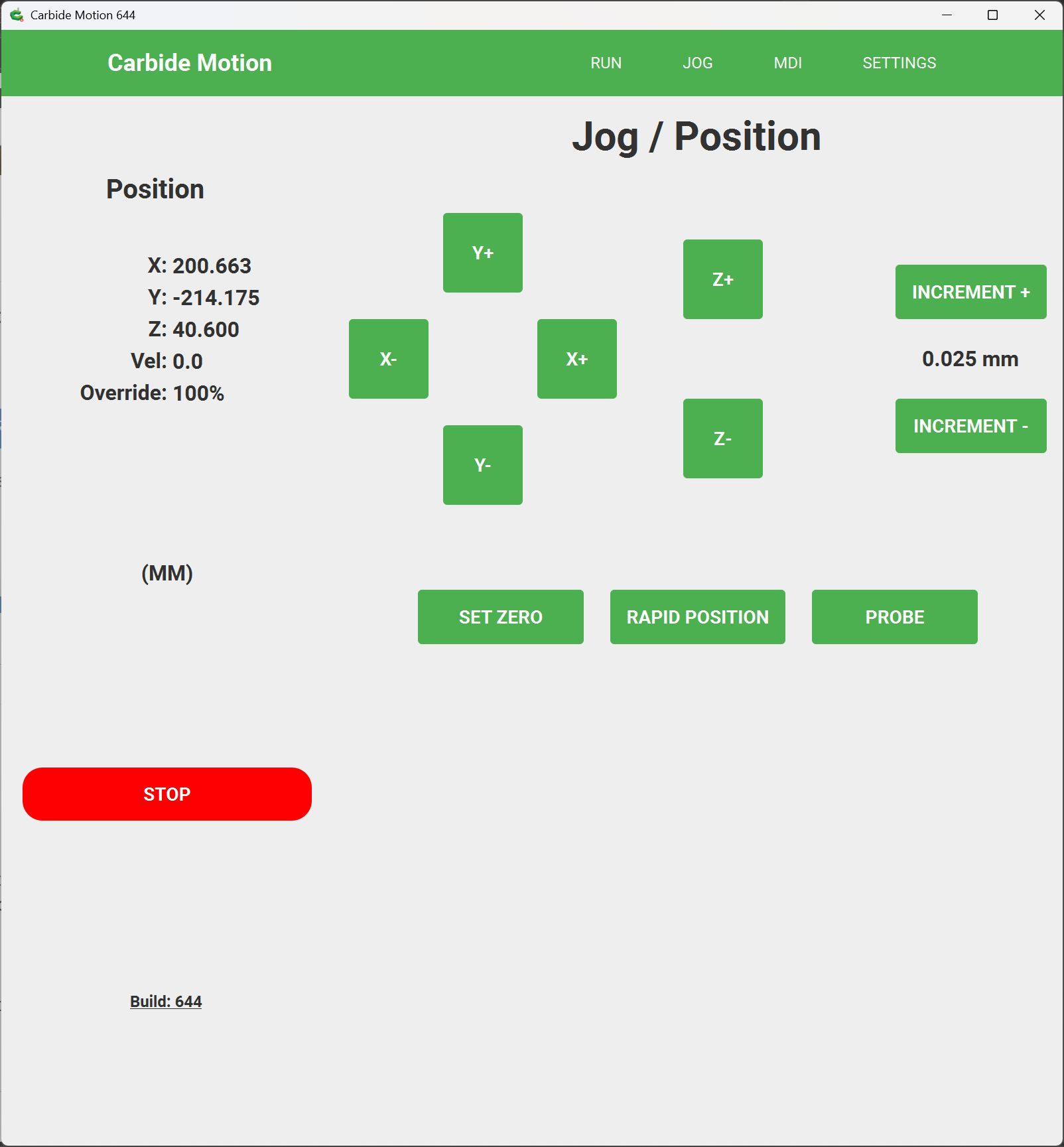

Load a tool or a probing pin and jog to the stock so as to set zero there to match how the origin is defined in Job Setup in the file:

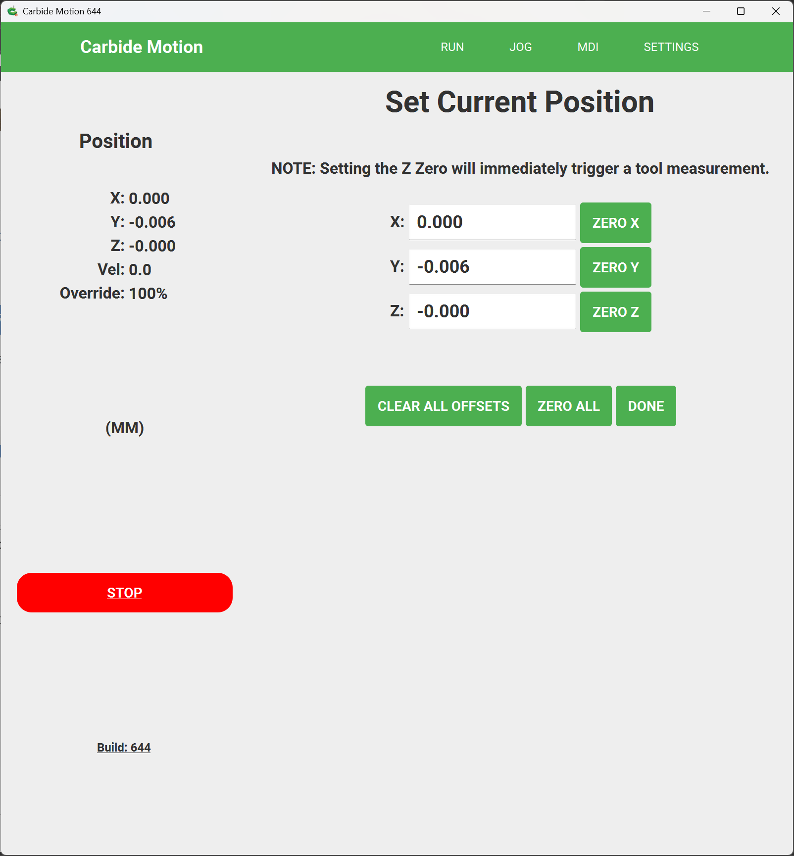

click on “Set Zero”
and set the Zero relative to the stock using the buttons for this purpose — or use a BitZero to probe for the corner as shown at:
