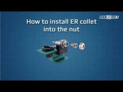

That’s a eccentric extractor ring. It’s made to fit into the slot in the collet so that the the collet is extracted when you unscrew the nut.
Related to your runout if you are not “snapping” the collet into the nut before use the collet will sit in or on the extractor ring which can have very bad effects on the collet and runout. Are you snapping in the collet to the nut?
That’s how a collet nut should look. The off-center hole is how it catches the groove in the collet and makes sure it gets pulled out when you loosen the nut.
i would say no. i typically put the collet into the nut loosely, and then slide the collet into the spindle and make sure the nut threads engage correctly.
my newbness is showing :man_facepalming:
That might be part of the reason for your runout.
Before you do anything else take the collet and look at the end with the short taper on it to check for damage. If there is none than take the collet and push it into the nut (you may find it easier to tilt the collet at an angle while pressing down and rotating it). It should snap into the nut and seat in the ground angle. Then when it’s assembled screw it into the spindle.
i definitely have not snapped the collet into the nut.
ill check my collet and after i take my foolish hat off.
a picture of my collets. not sure if that ring would be considered damage.
Yeah, I wouldn’t use those. That groove ground into the taper will smear into the nut. That will then offset and transfer/damage any other collet that’s used in those nuts.
The main idea with these types of collets is that you are centering them between two precision ground tapers (nut and spindle). When instead they get trapped in the extractor ring that will almost always skew them giving you runout. So that’s probably at least part of the issue you are having with runout.

This should help.
