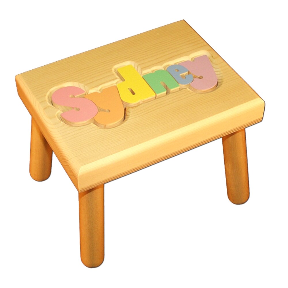

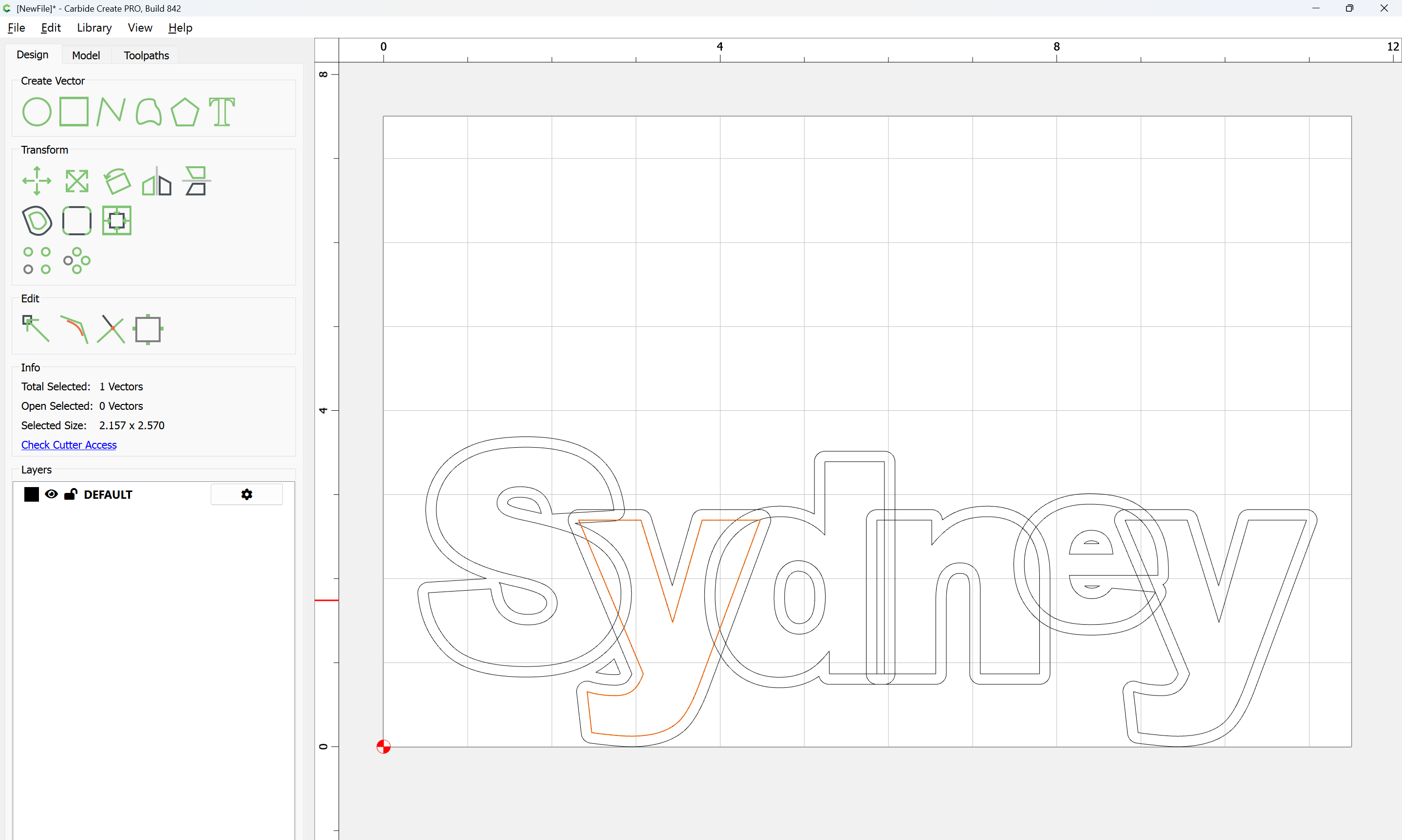

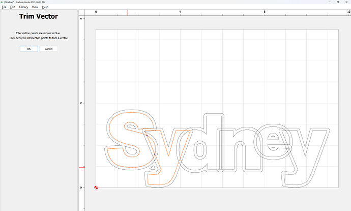

Looking to make a Damhorst style kids puzzle name step stool where the letters run together as in this example. I’d love to find a source for a file I can edit to change the name. It doesn’t need to be free. I didn’t find such a thing on Etsy or the other file sources I checked, only ones with separated letters. Anyone know of a source? (Hoping for a quick project without having to do a lot of design work)
Thanks!

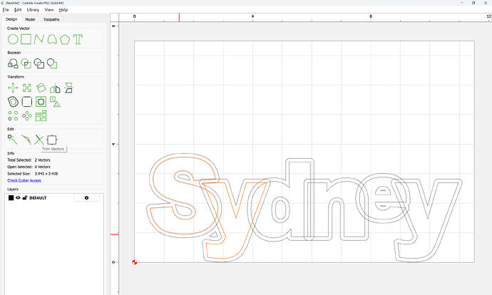

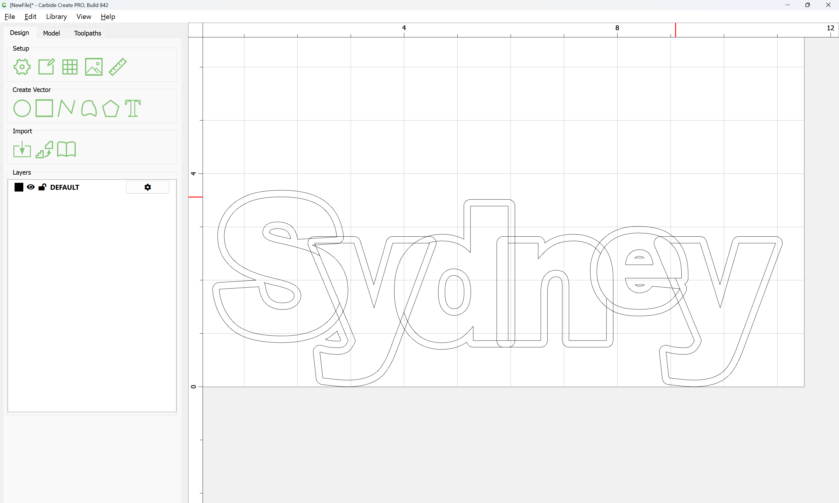

The lettering looks to have been done by mixing/matching fonts and overlapping characters and then using Trim Vectors or some similar feature to offset one letter from another and remove the offset overlap from the other — the sort of thing which Glenn Reid’s nifty TouchType.app made quite easy to do.
Doing this sort of thing in Carbide Create would be a multi-step process:
  • set the text for the name — if using different fonts for different letters, use one text object for each different font one wishes to use
  • convert all text to paths, grouping any letters with counters (holes in them such as the d and e in the above)
  • arrange and re-size the letters as desired

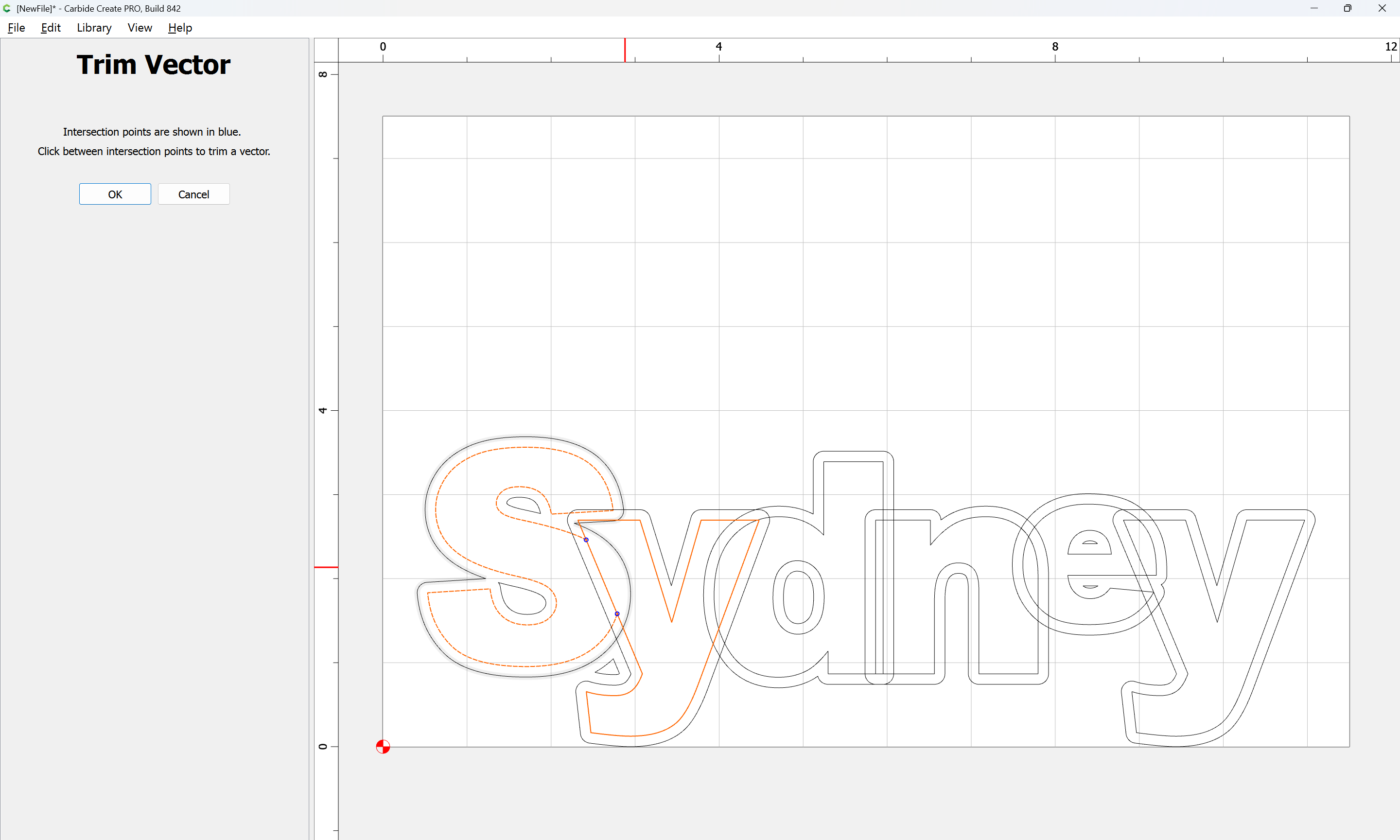

  • offset the overlapping letters thrice, once by the desired separation distance, once half that, and by the desired surround
  • use Trim Vectors to isolate elements and create the appearance where desired of one letter being in front of another, c.f.,
(for the raison d’être for the halved overlap)
  • Join Vectors

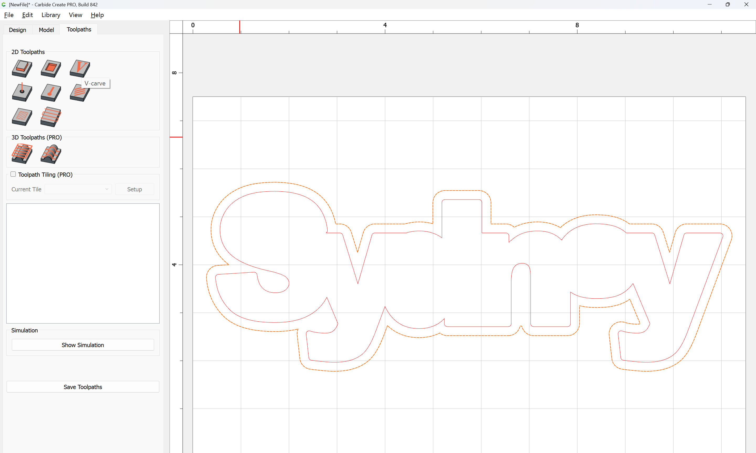

  • assign toolpaths:
    • centerline gets a shallow pass with an acute V endmill to allow for painting as described above
    • letter outlines and desired surround get a V carving (after the painting)
It might be that one could make a spiffy OpenType font which would do this sort of thing automagically, but I don’t know of one.
hang on for a step-by-step…

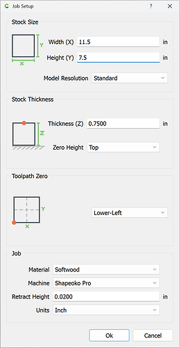

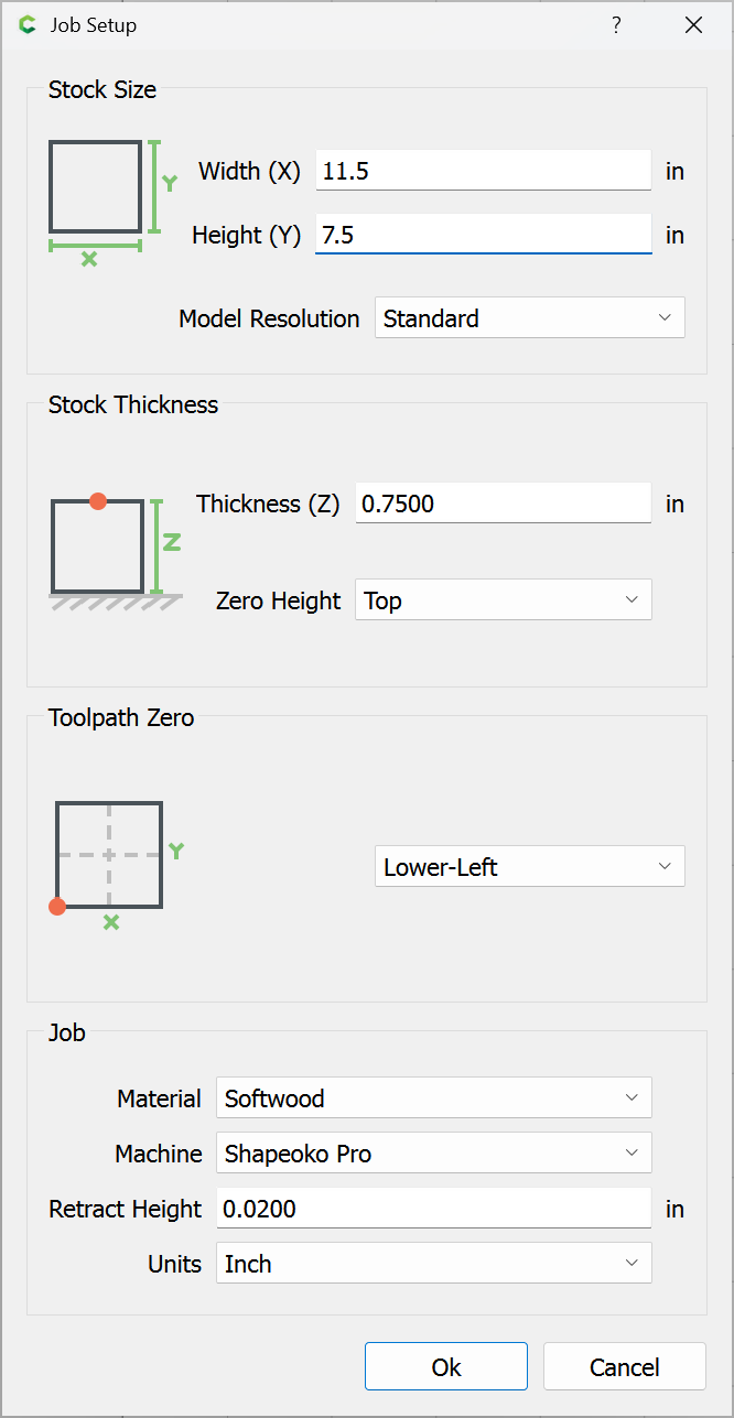

First, work up the dimensions — 11.5" x 7.5" is the size of a similar design which my wife had when she was young:
Ok

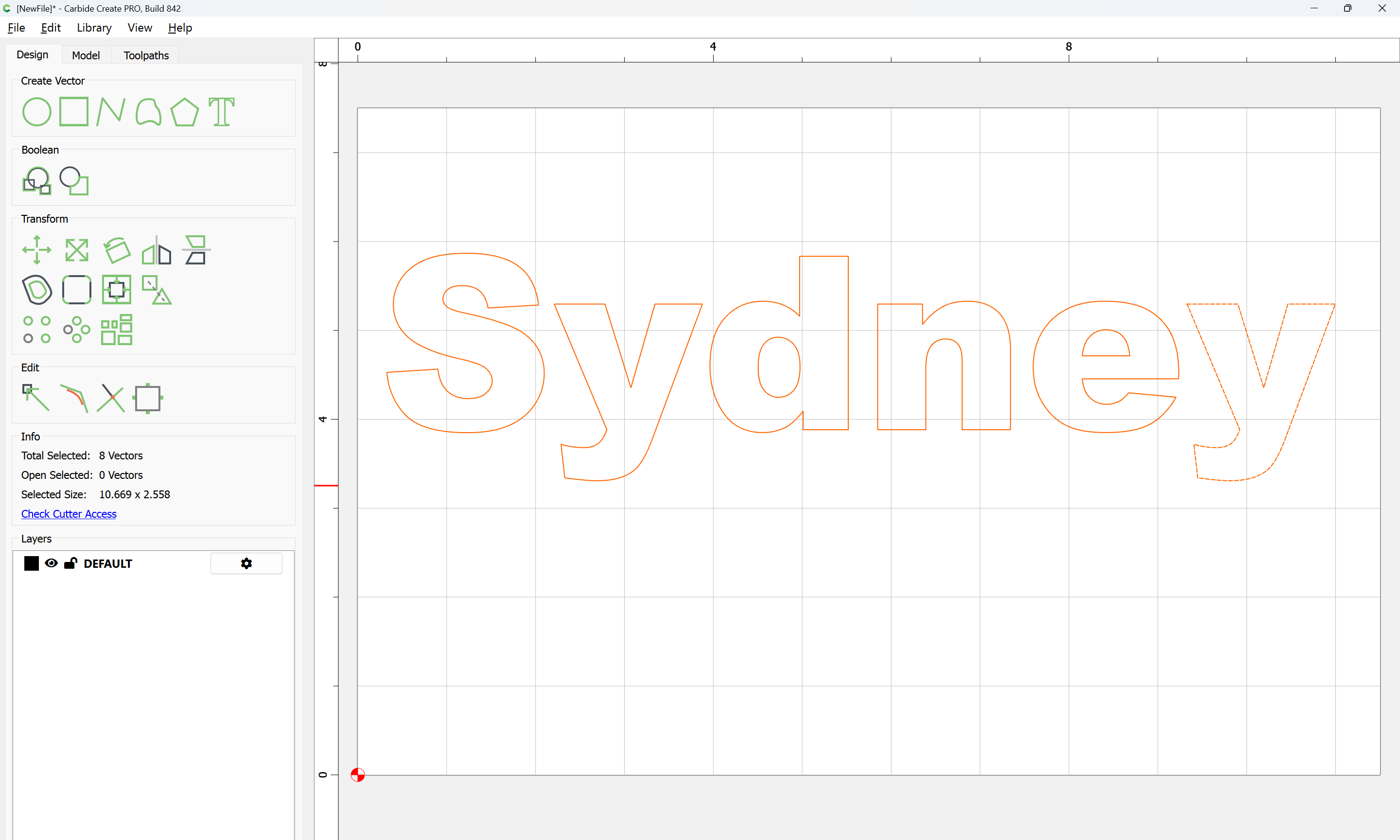

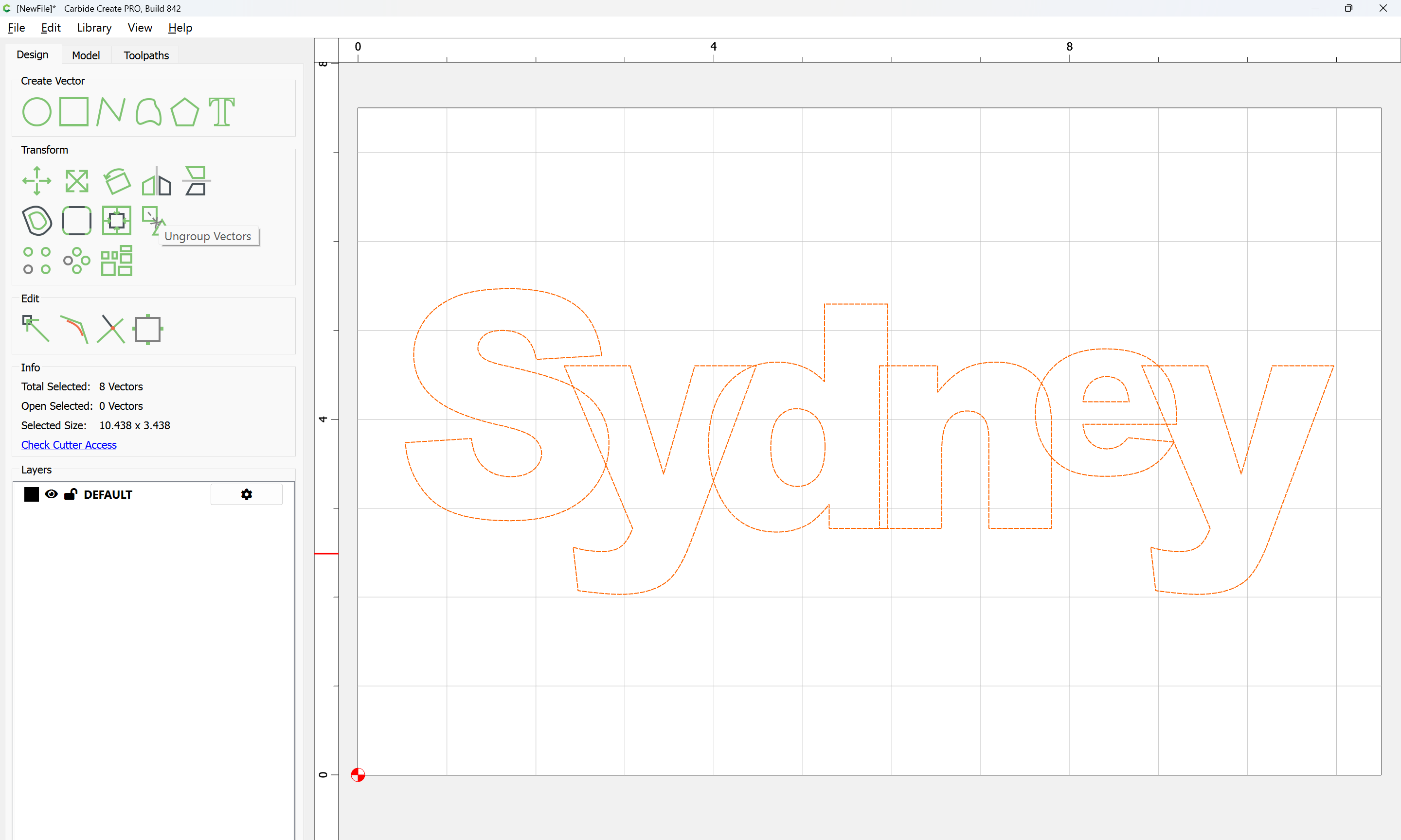

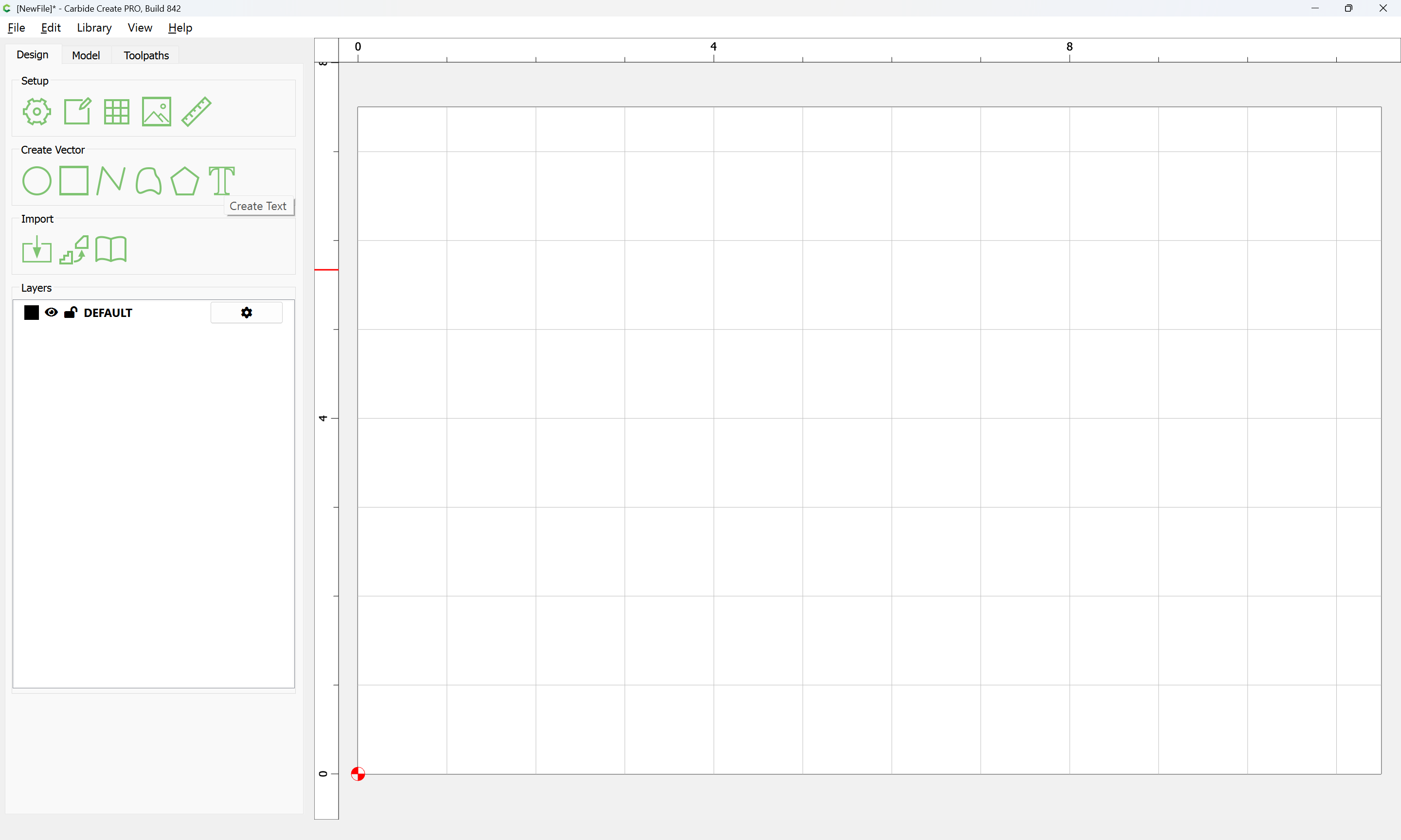

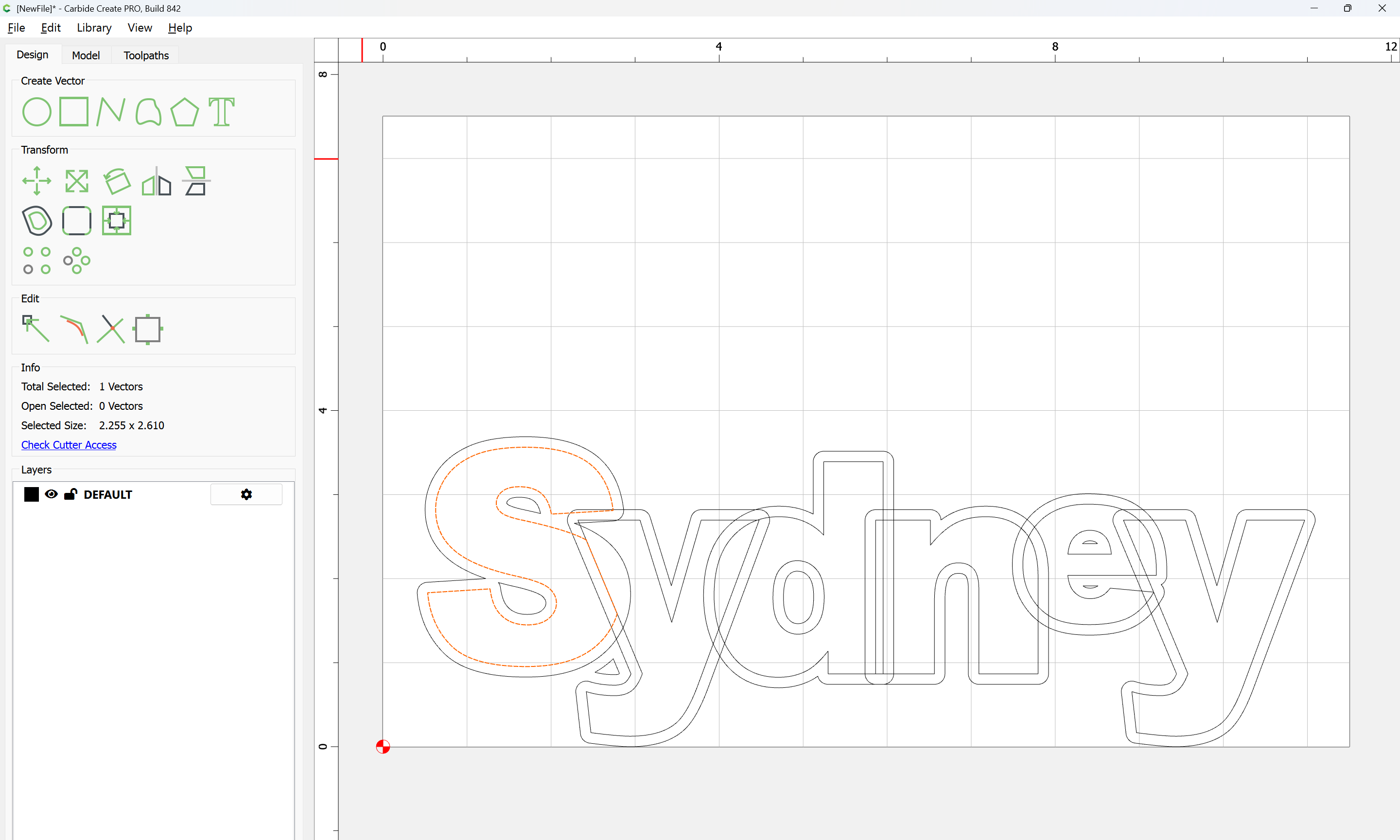

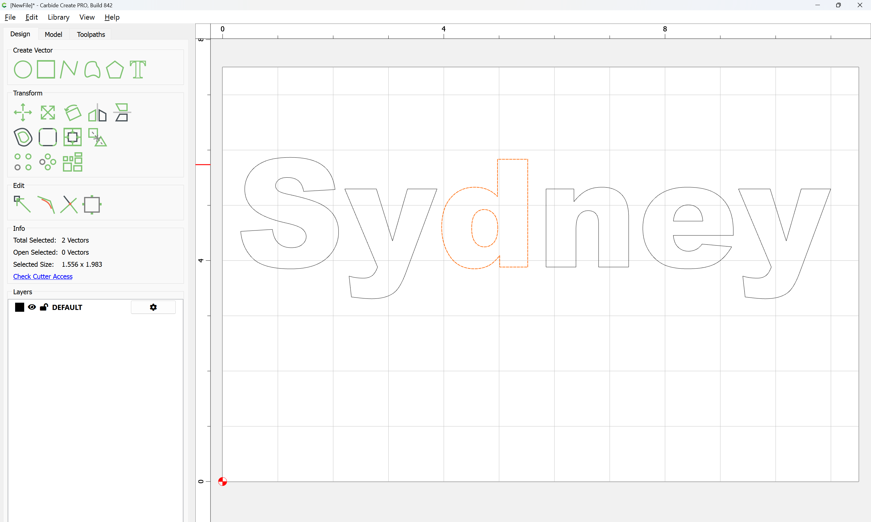

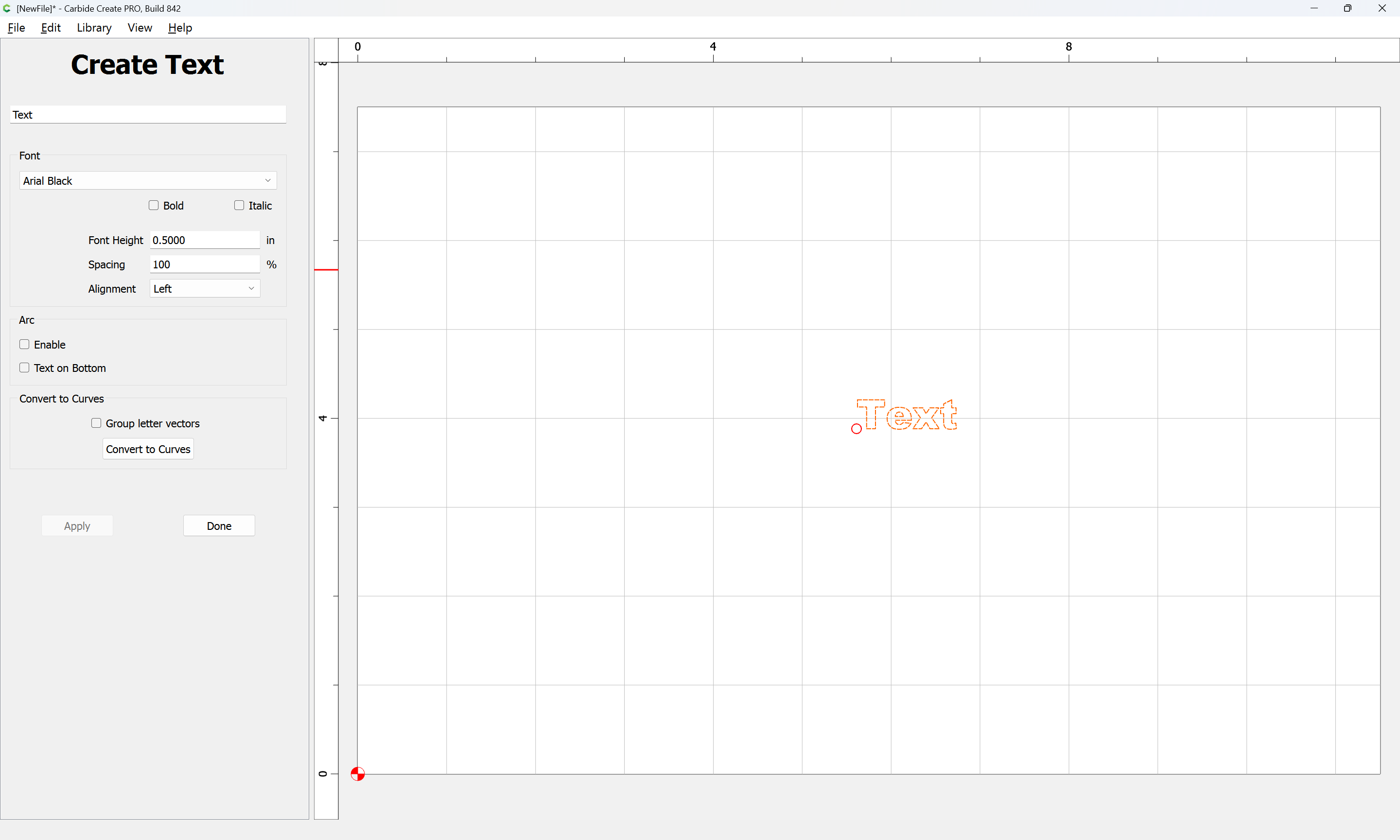

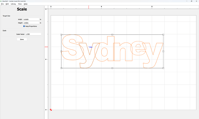

Set the text:
using a suitable font (Arial Black was selected above)
and “Convert to Curves”

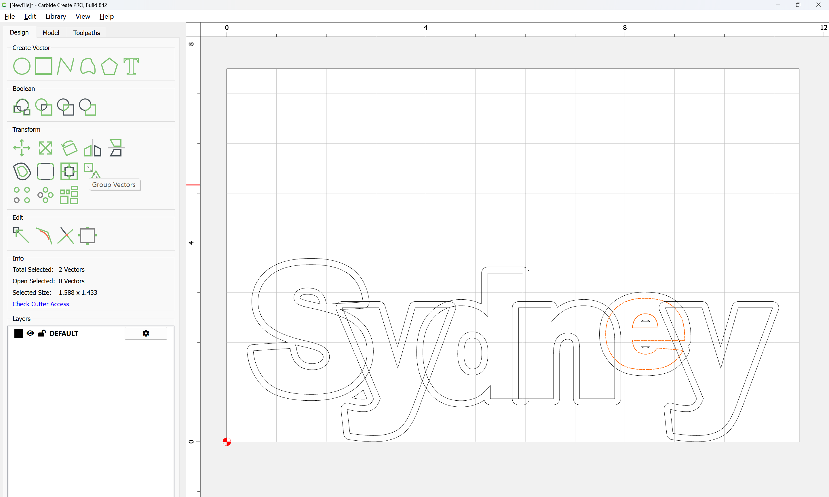

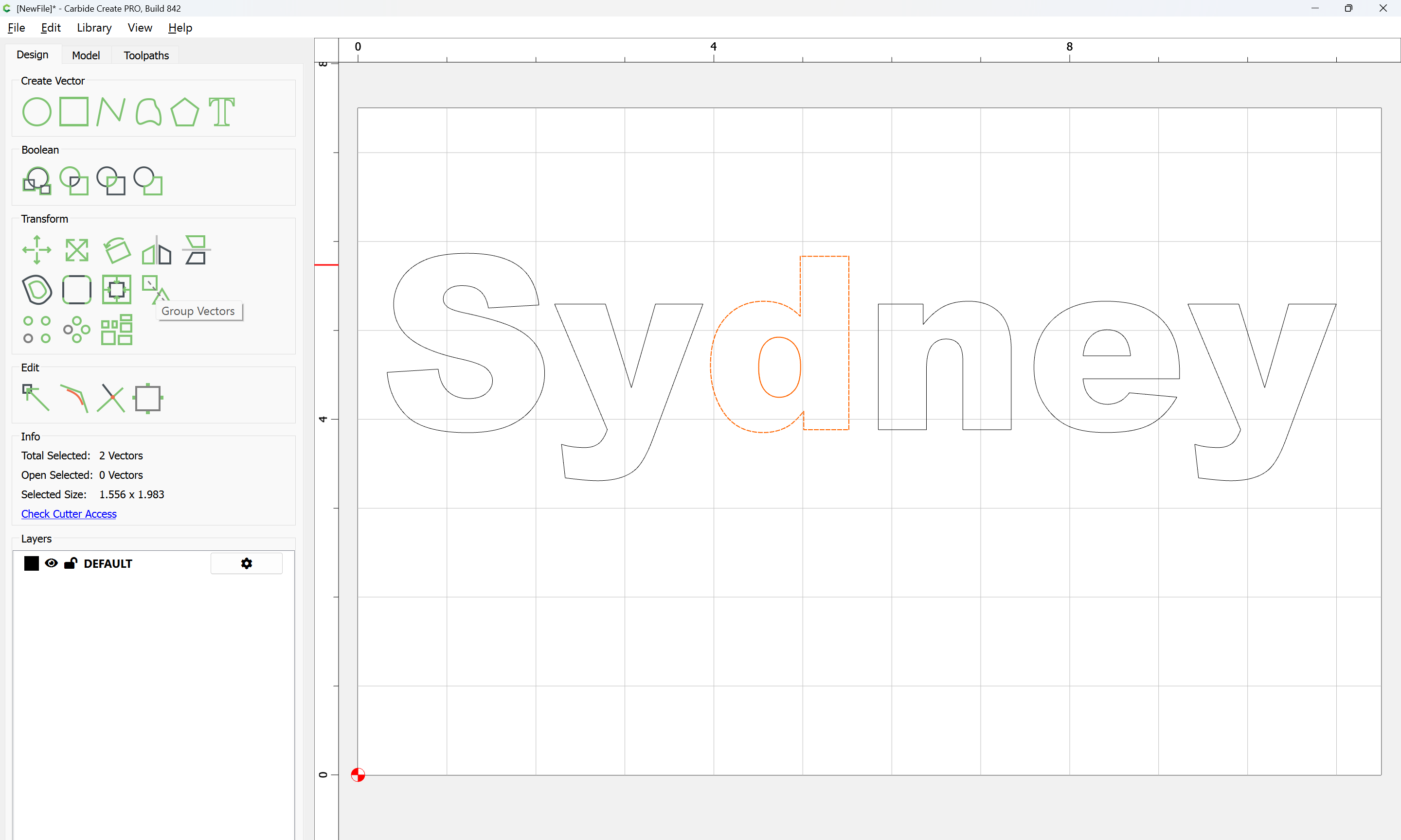

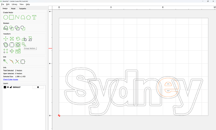

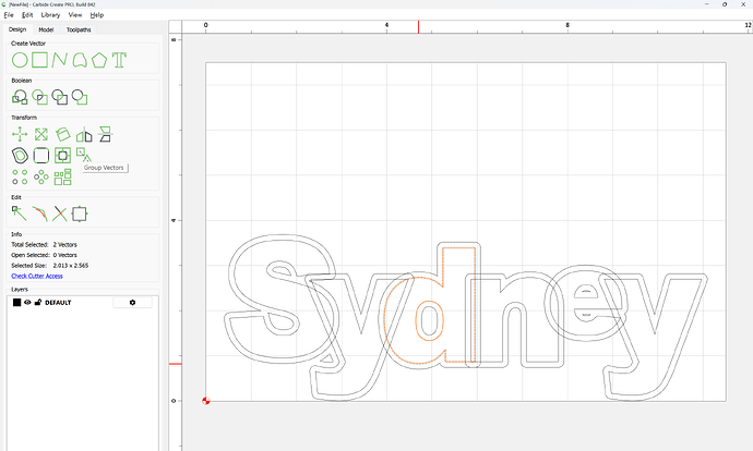

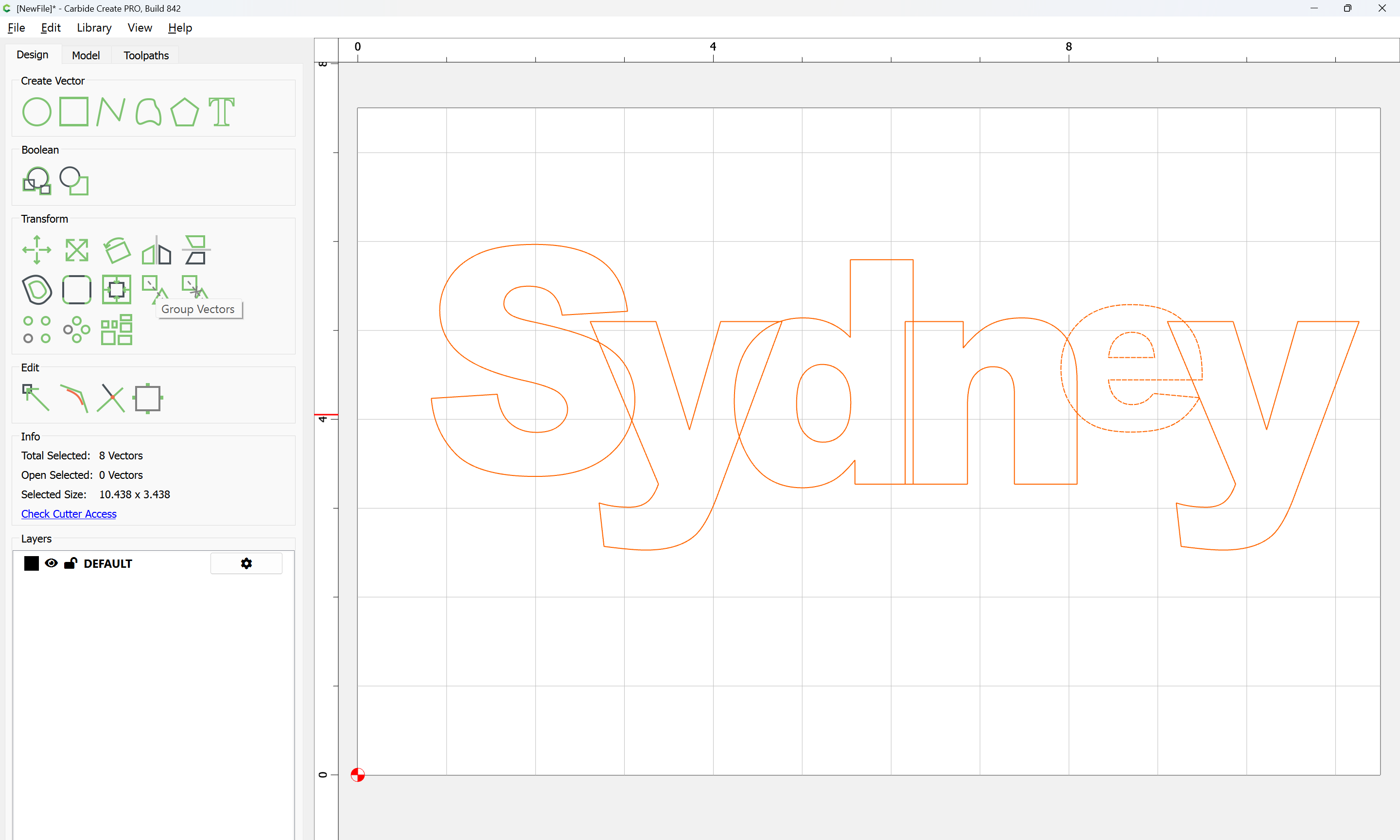

Select each letter with a counter and its counter:
and Group Vectors

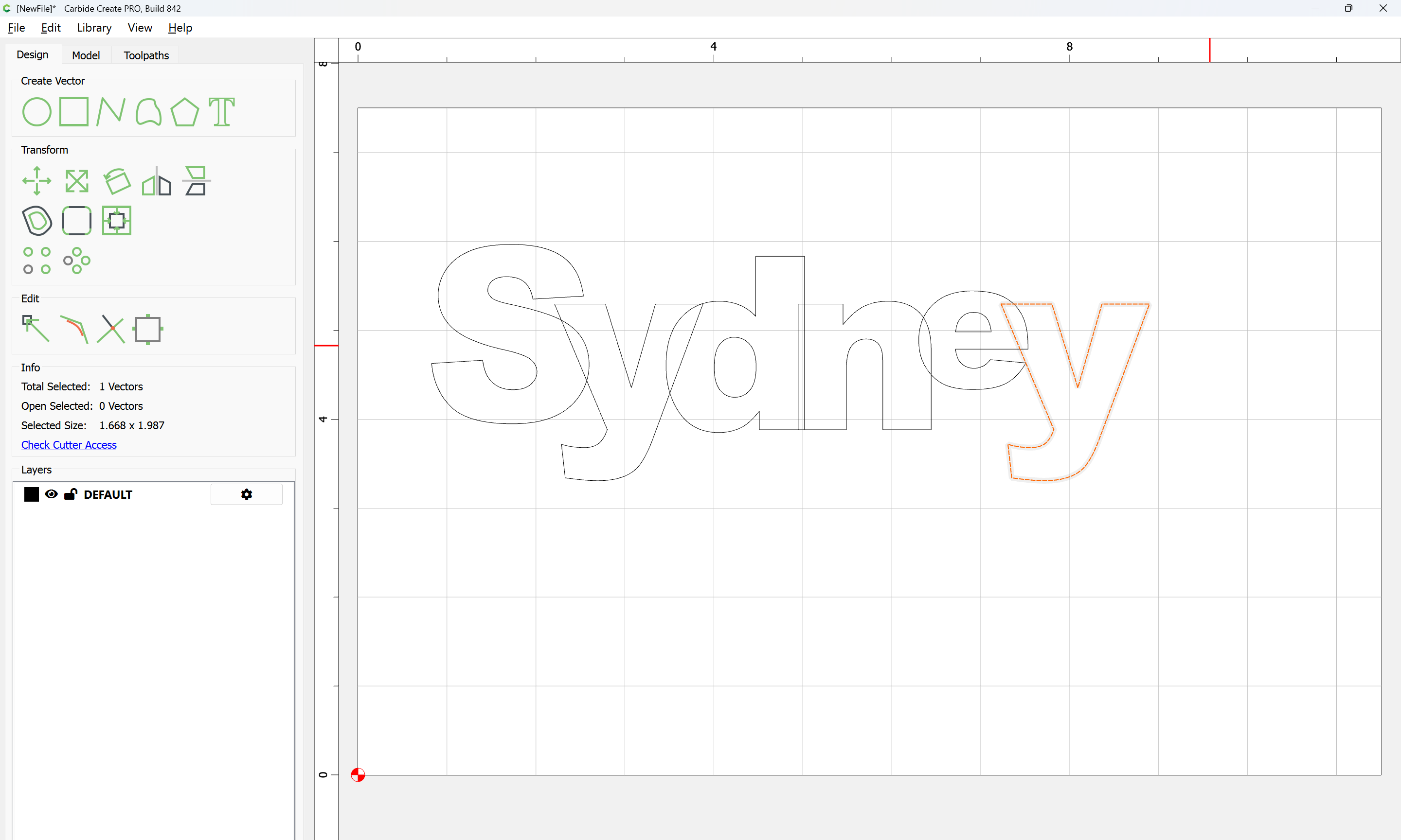

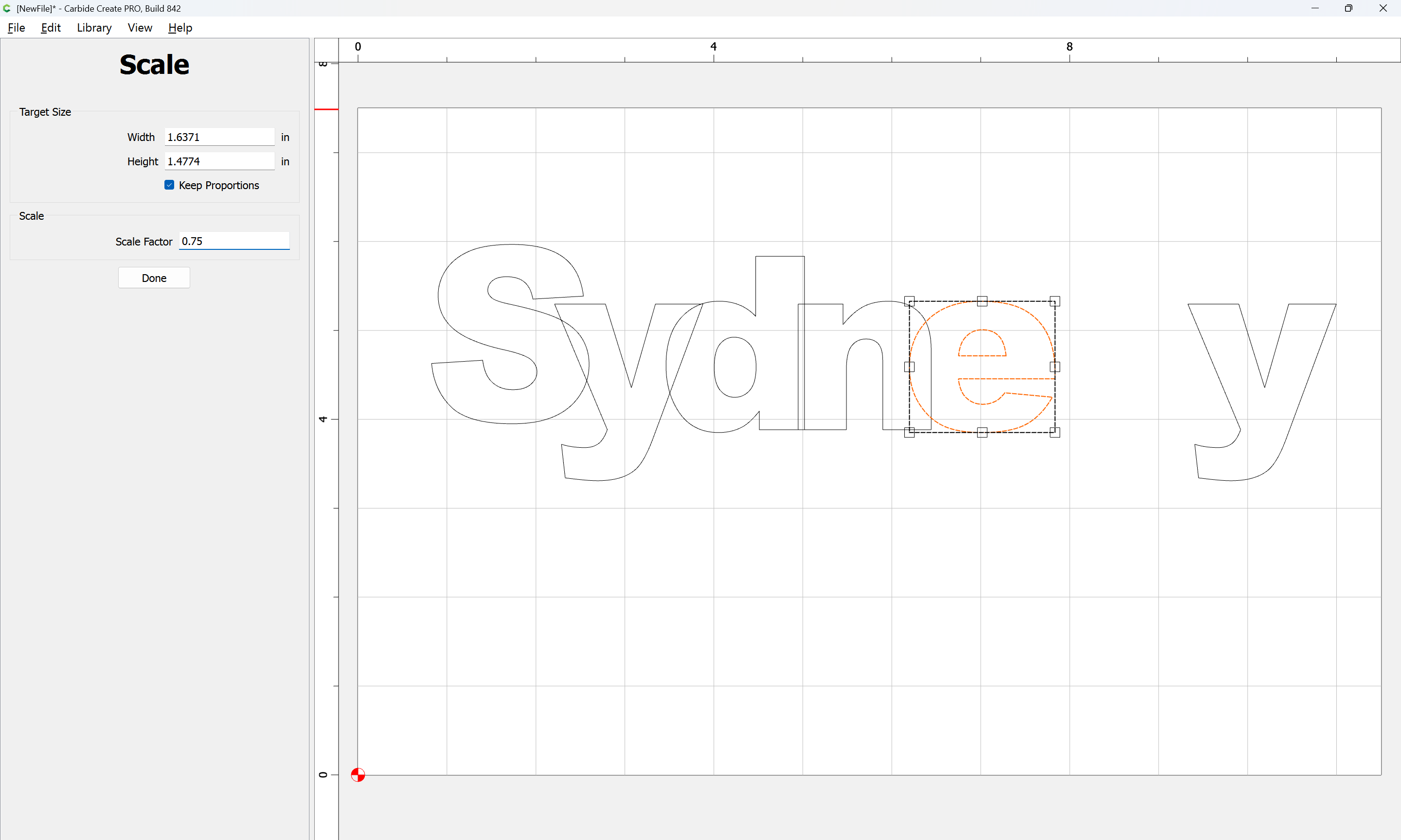

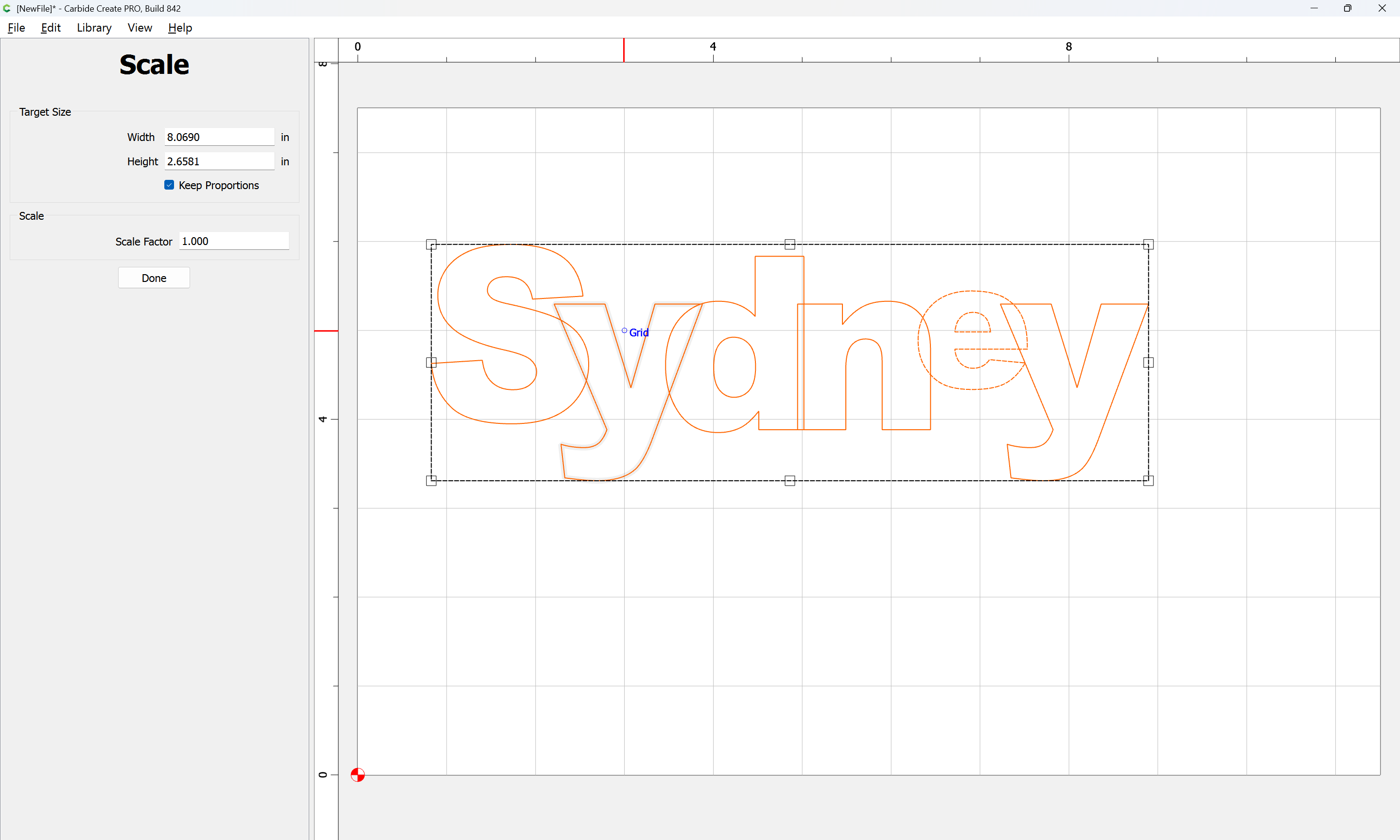

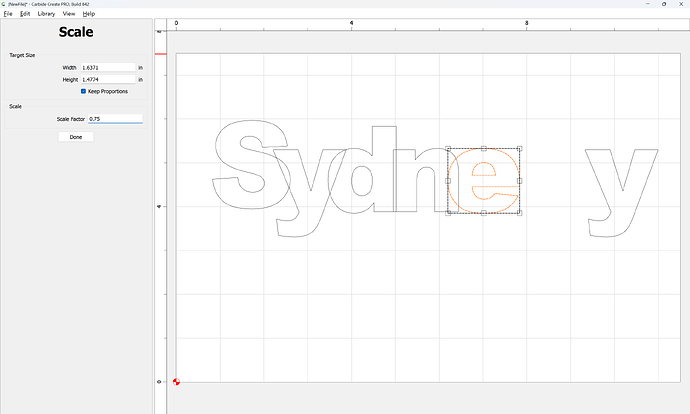

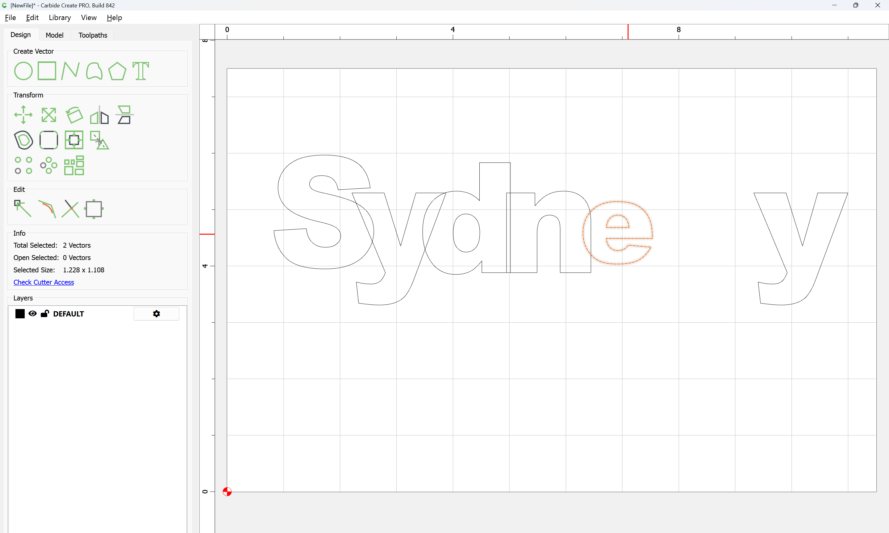

Drag things around and re-arrange as desired, adjust size/scale as appropriate:
Done

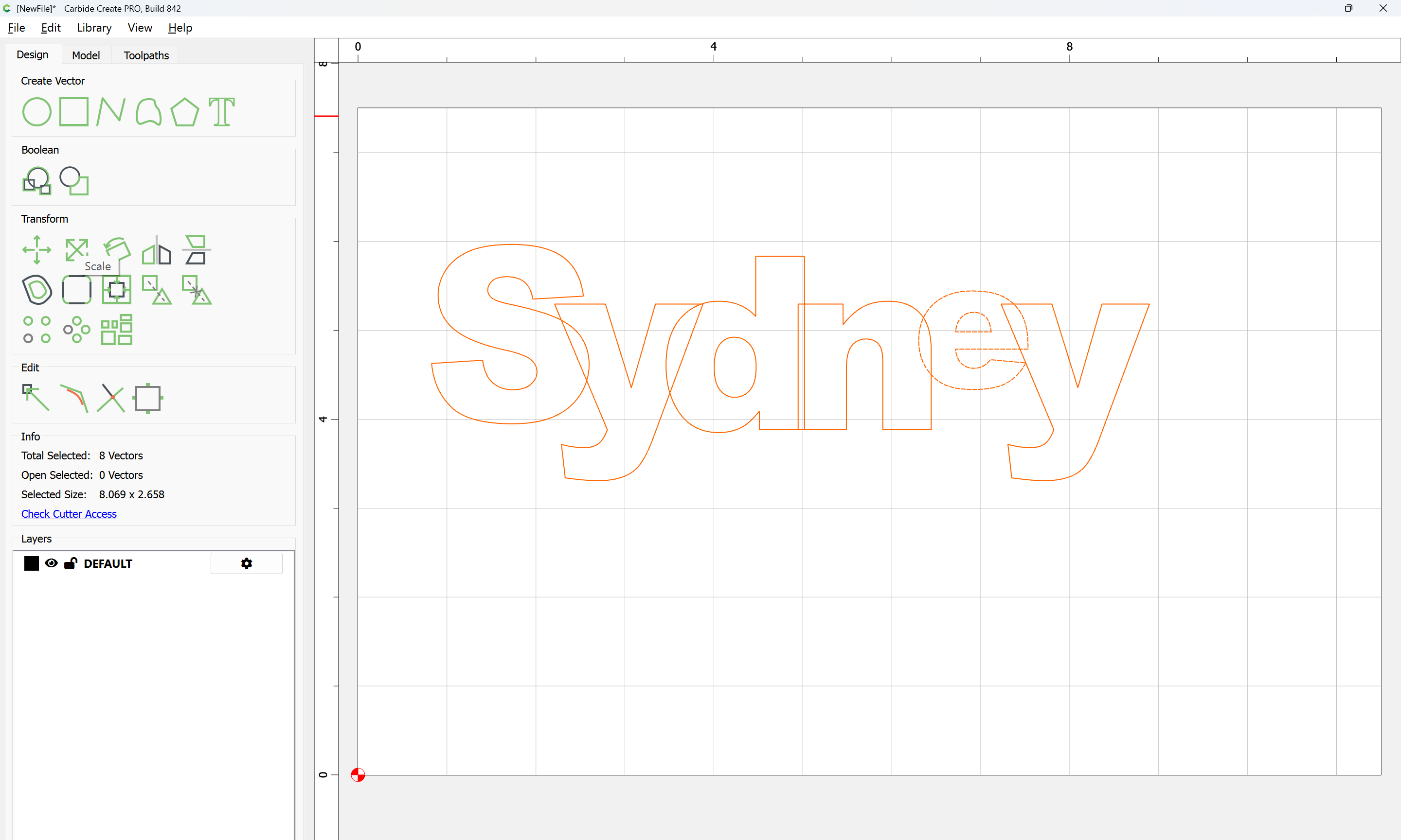

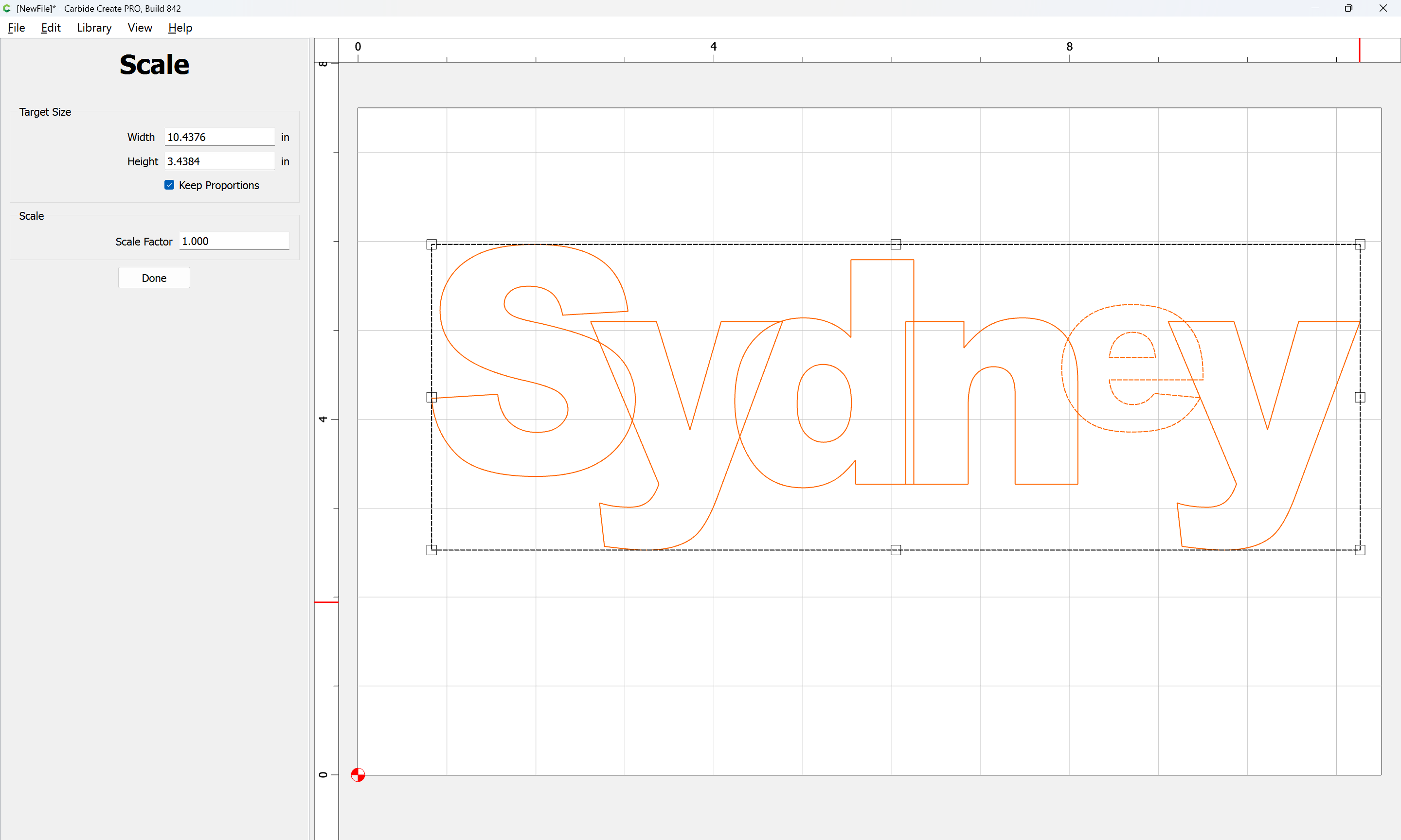

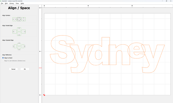

If desired, select everything:
and further scale:
Done

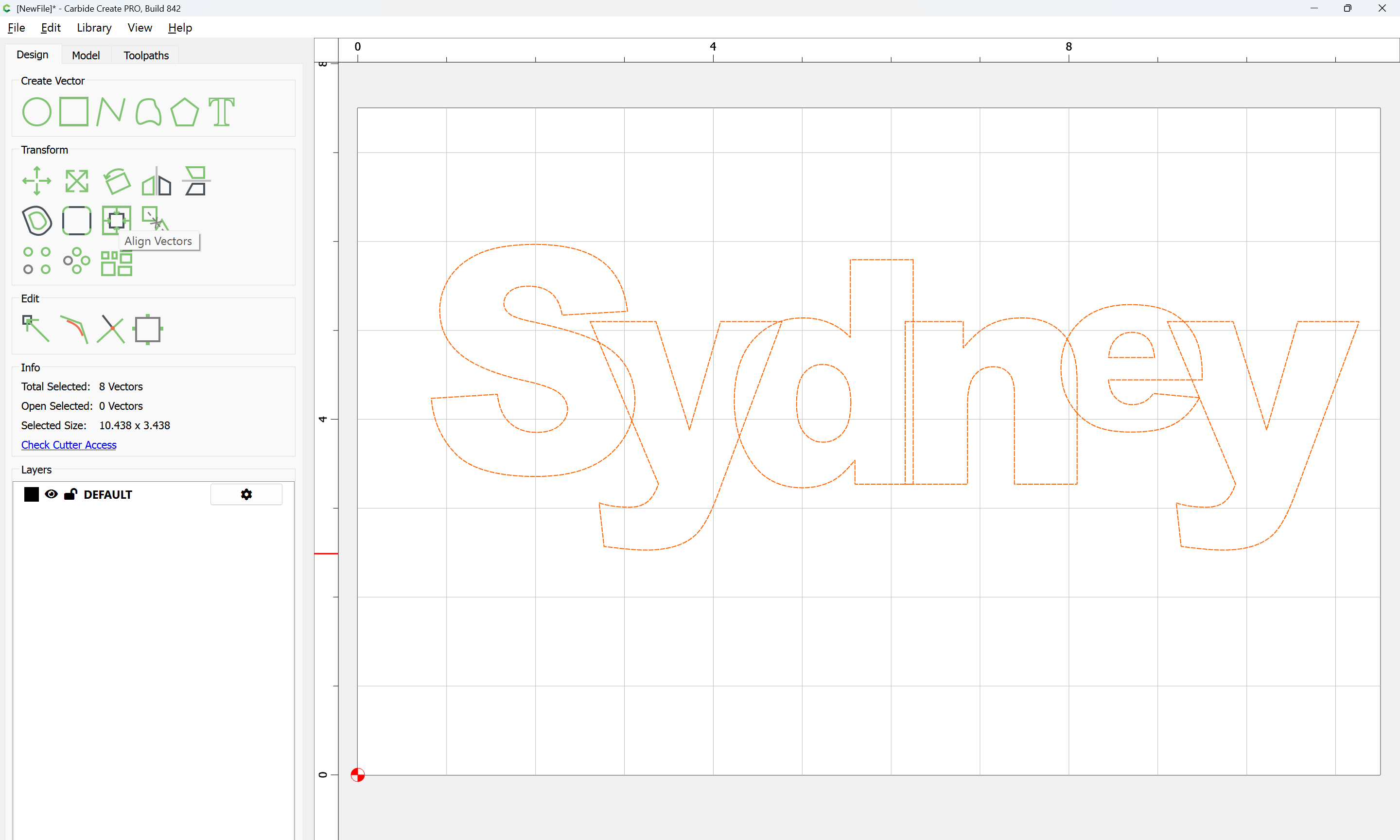

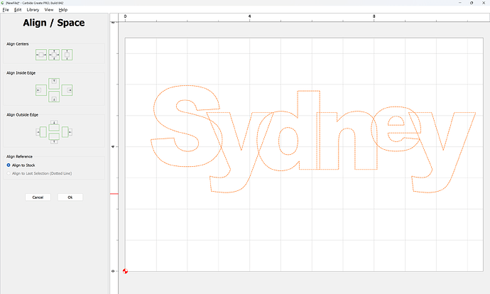

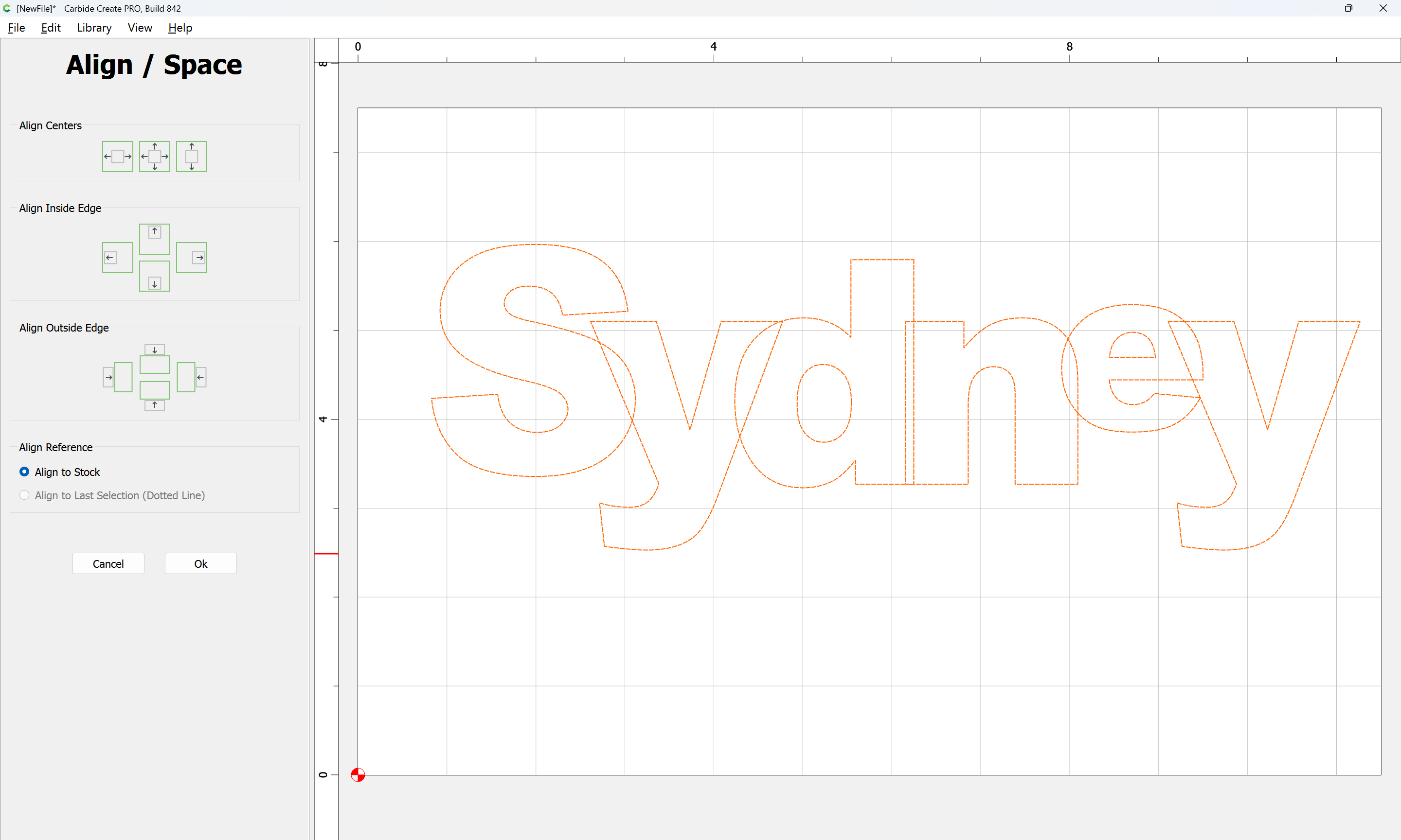

Group everything:
and Align Vectors
to the center of the Stock
Ok
Ungroup Vectors

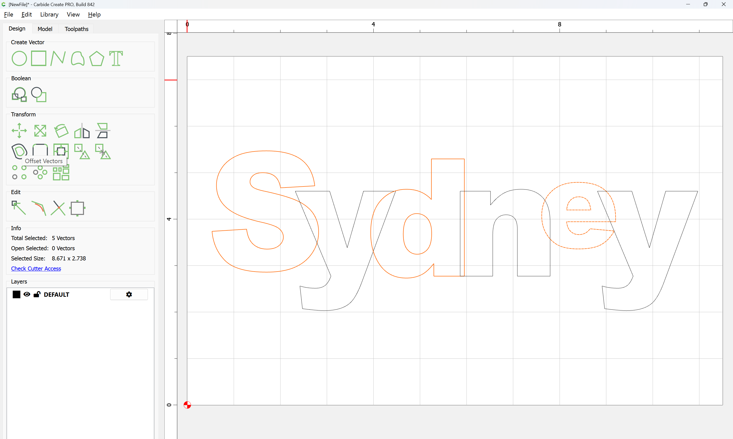

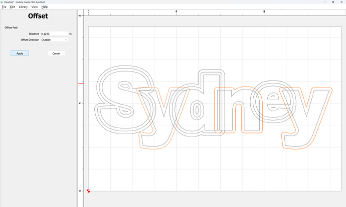

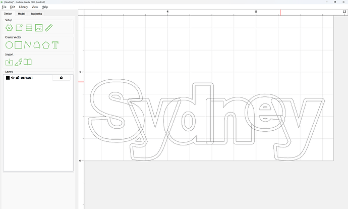

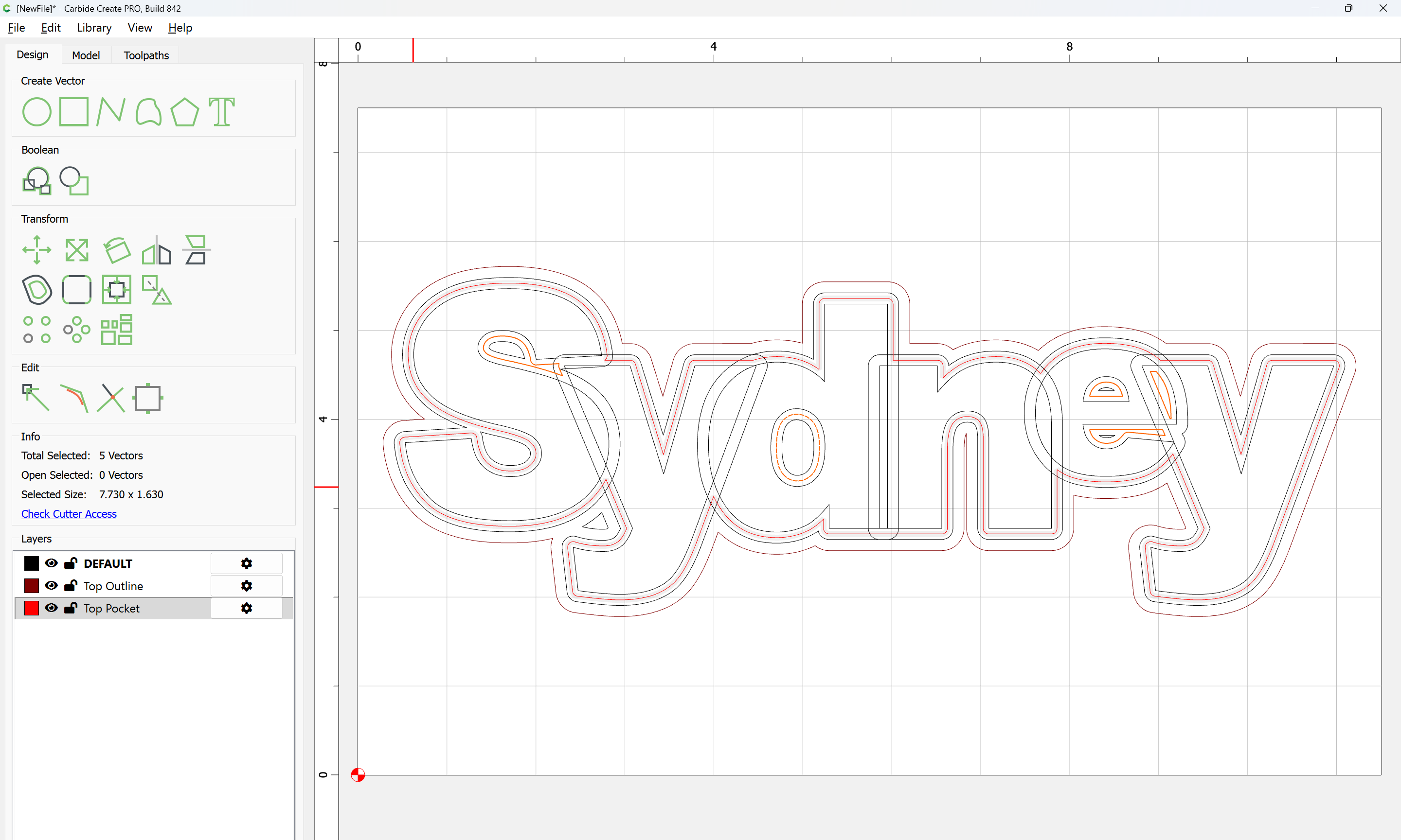

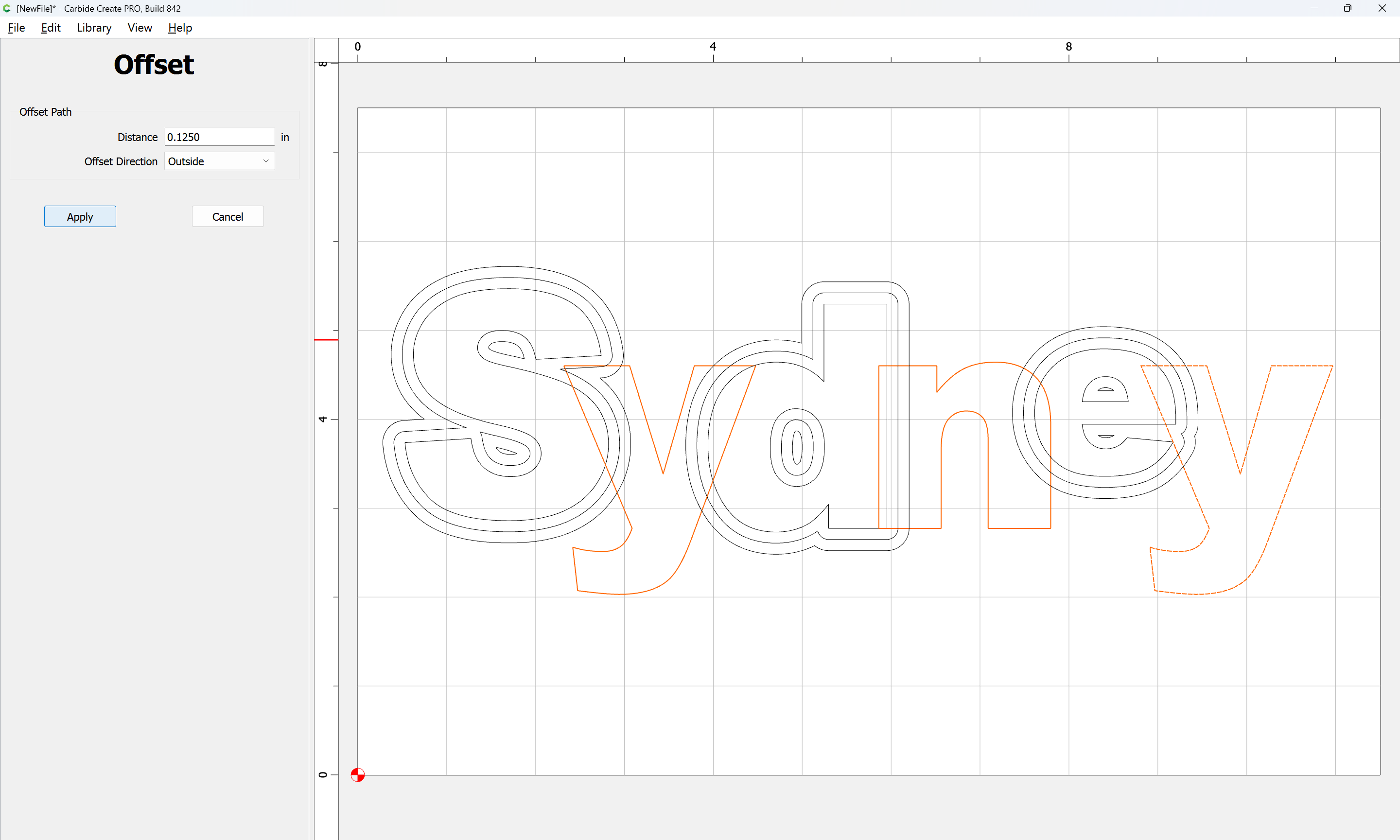

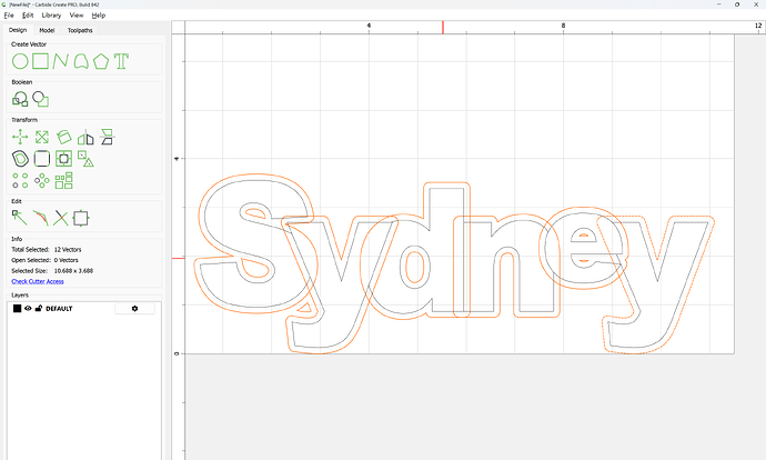

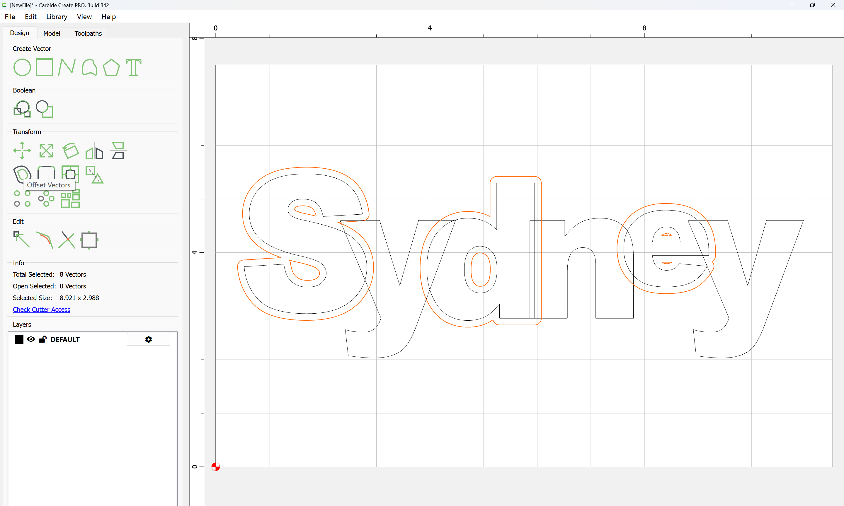

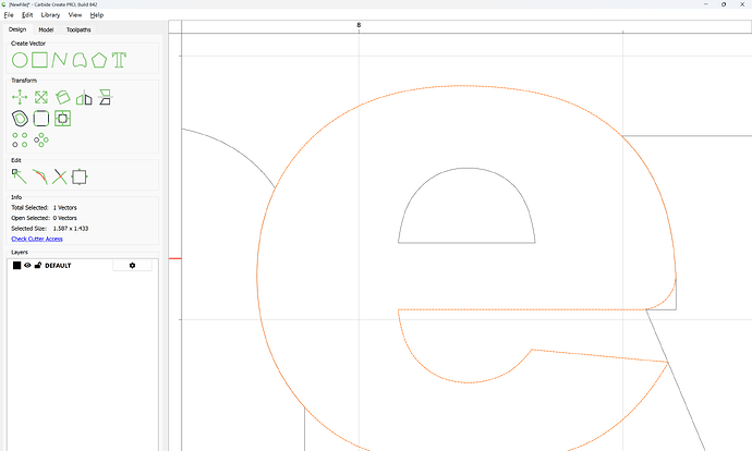

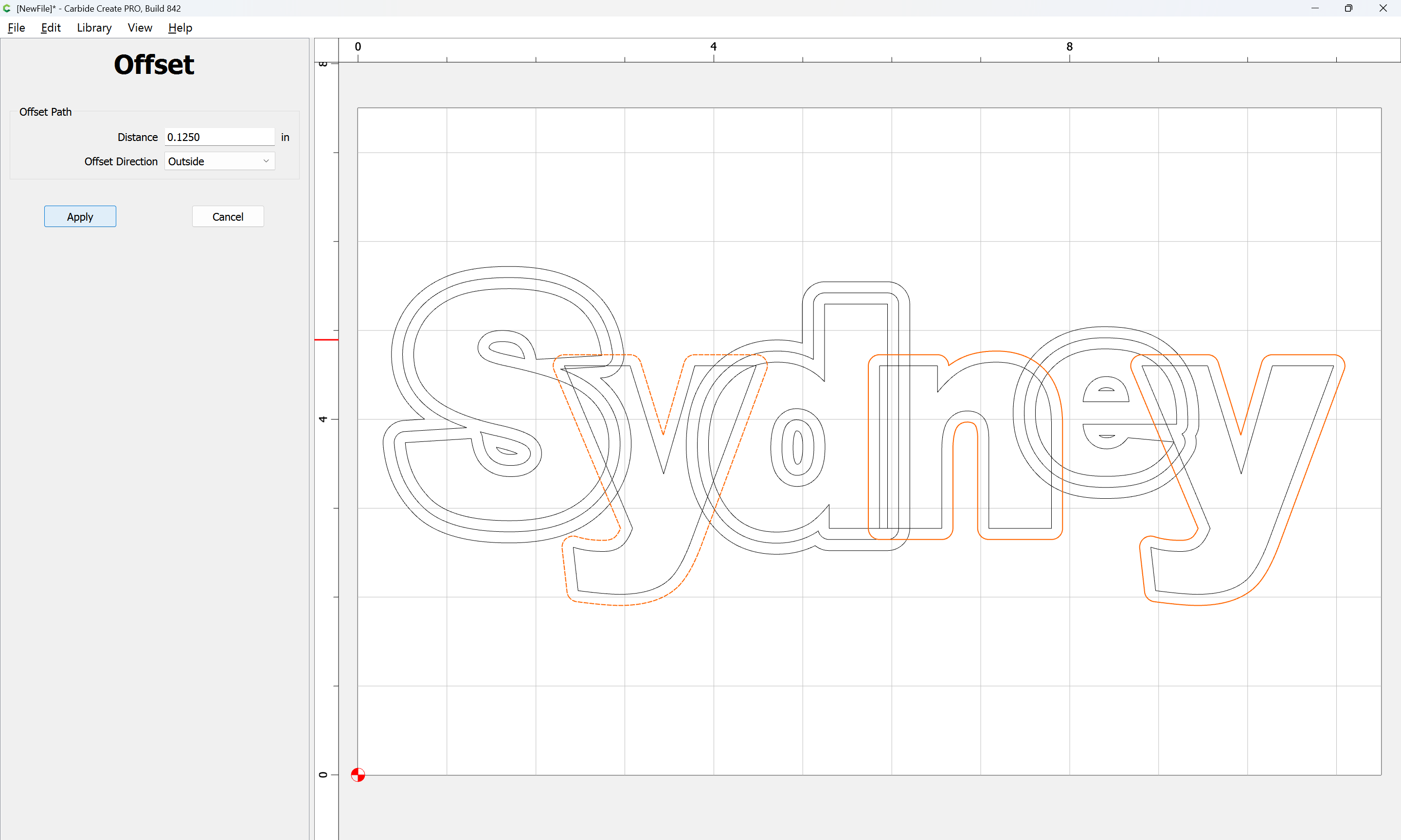

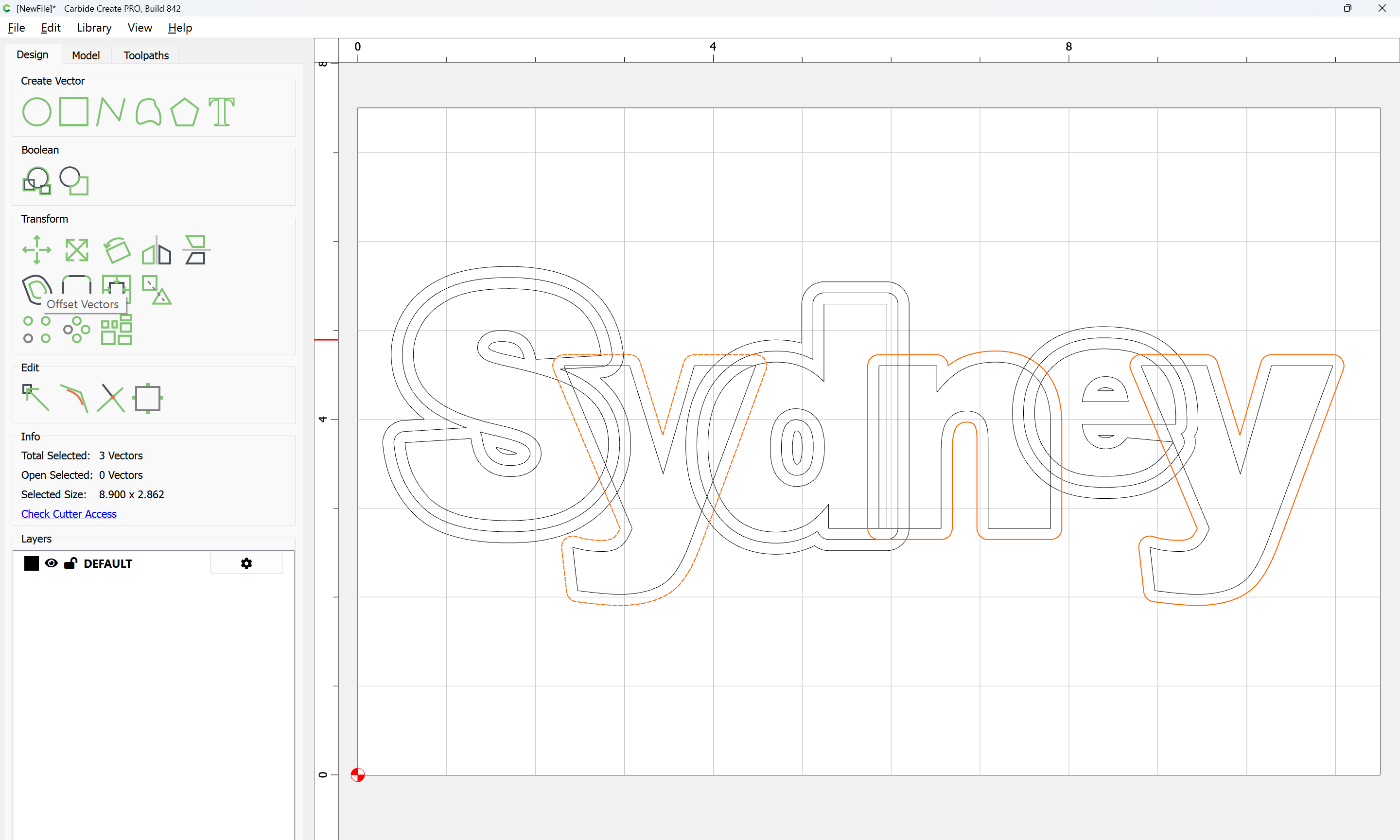

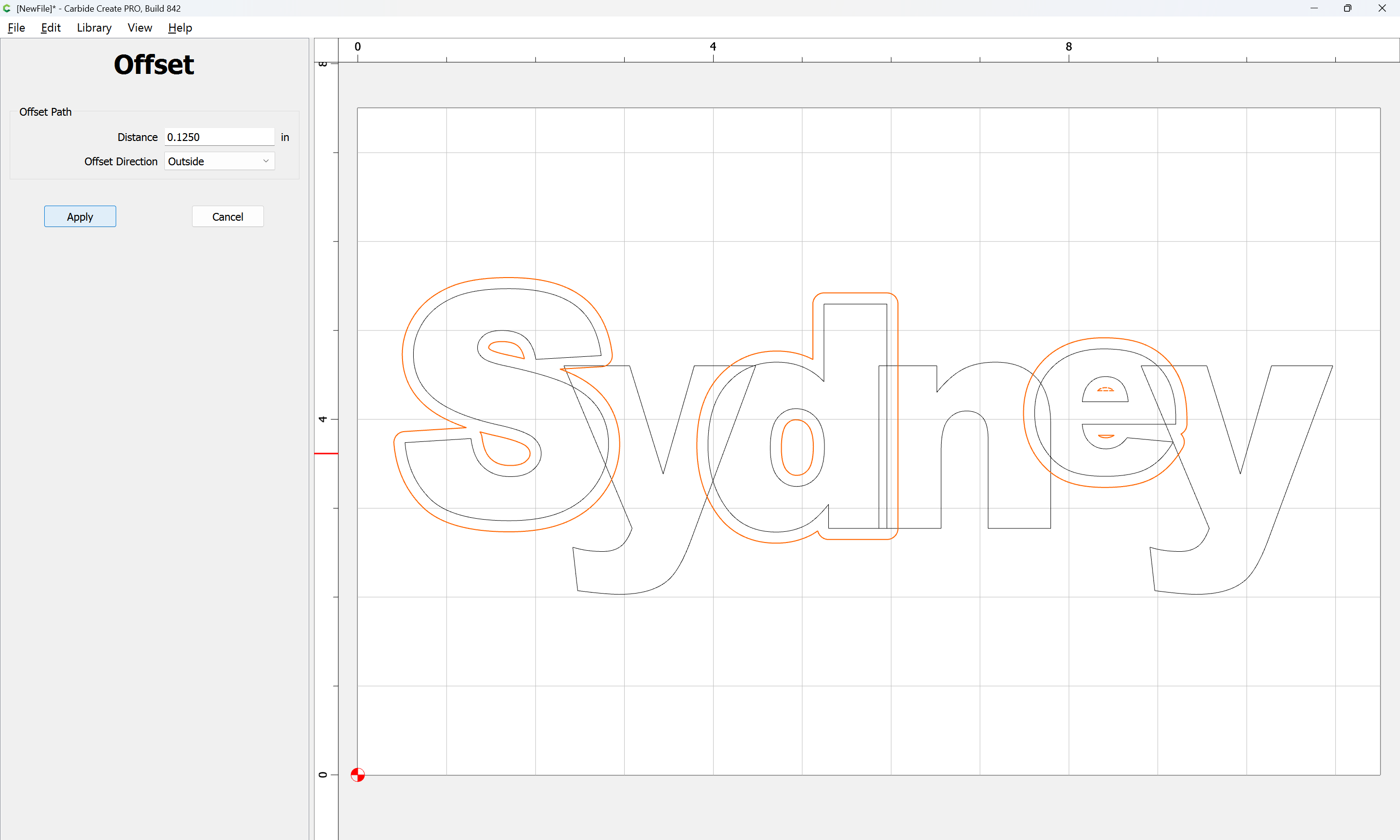

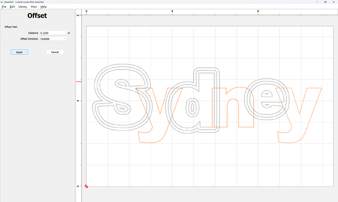

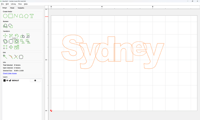

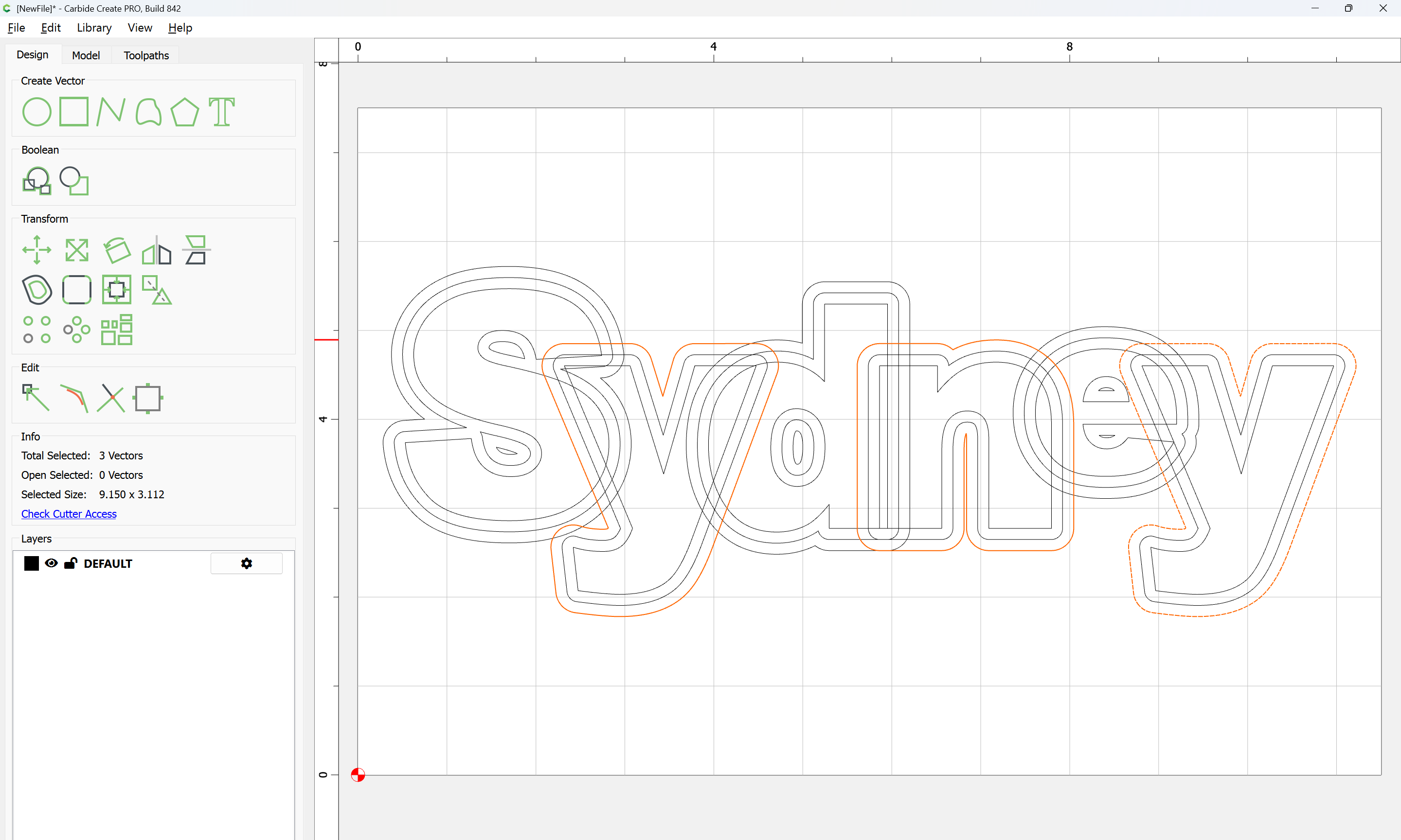

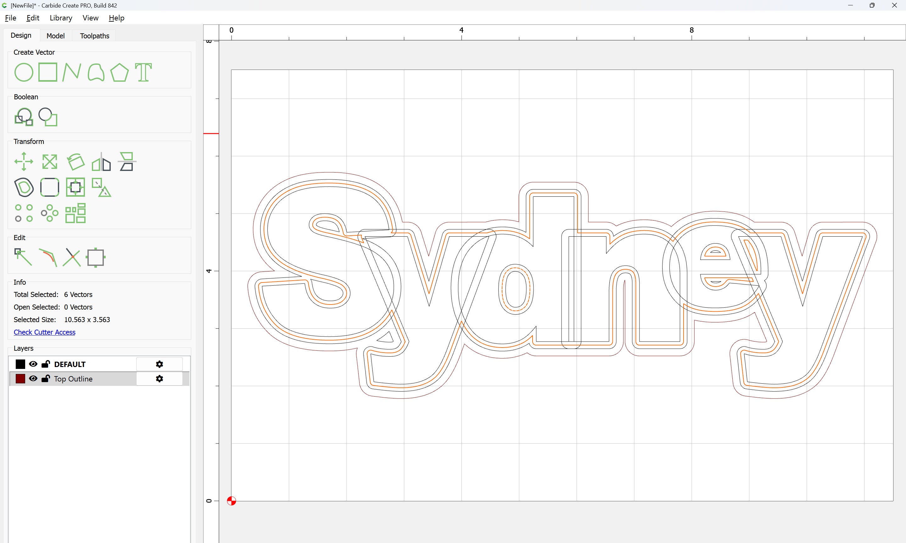

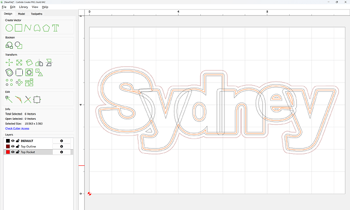

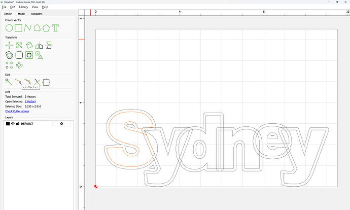

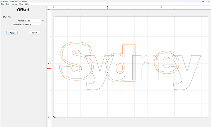

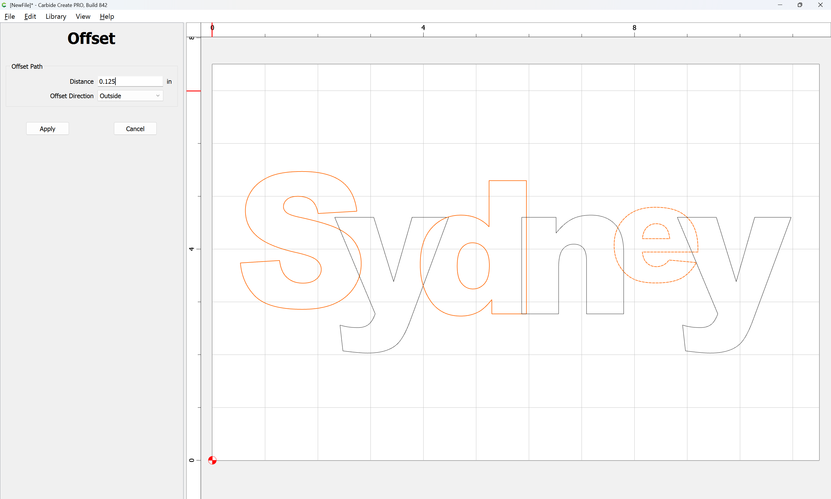

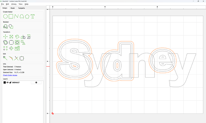

Select every other letter and offset by the two dimensions needed — we will use 0.125" and 0.25":
Apply

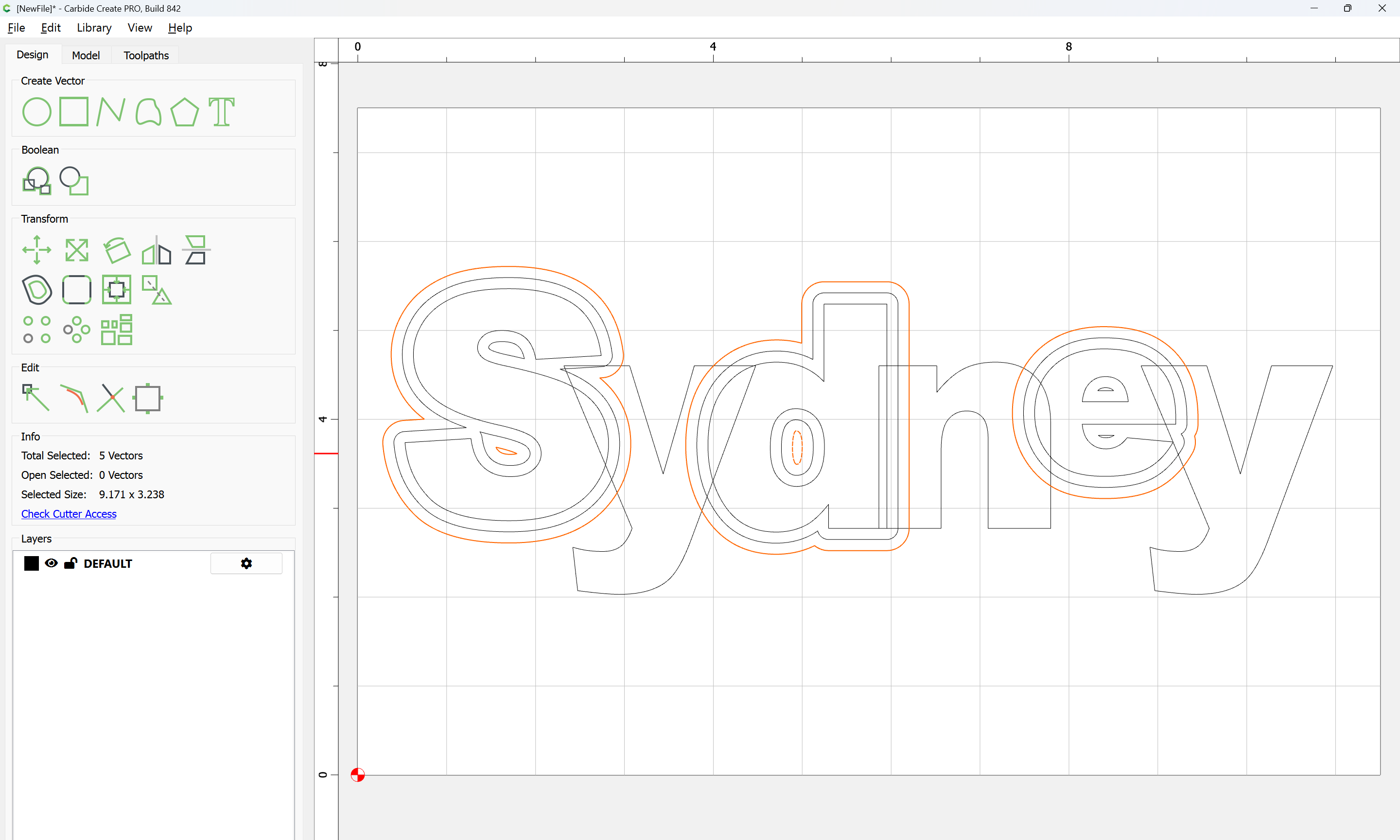

so offsetting by 0.125" a second time:
Apply

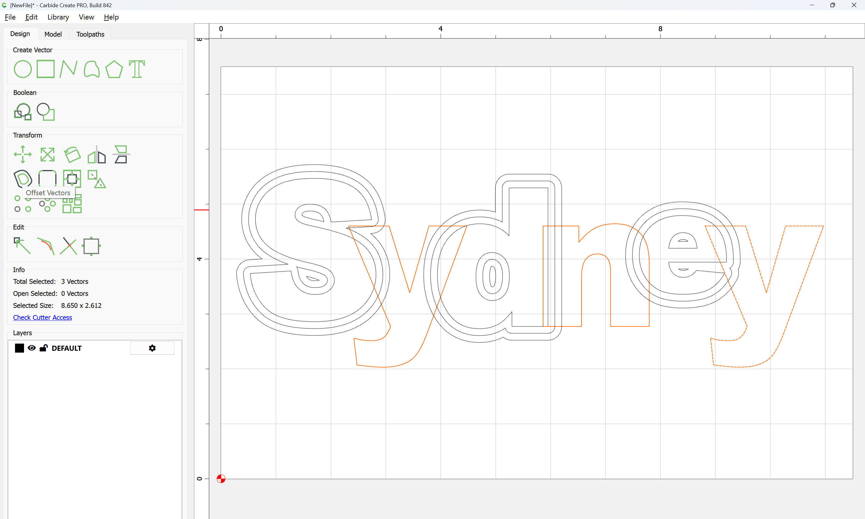

and then repeating for the balance of the letters:
Apply
Apply

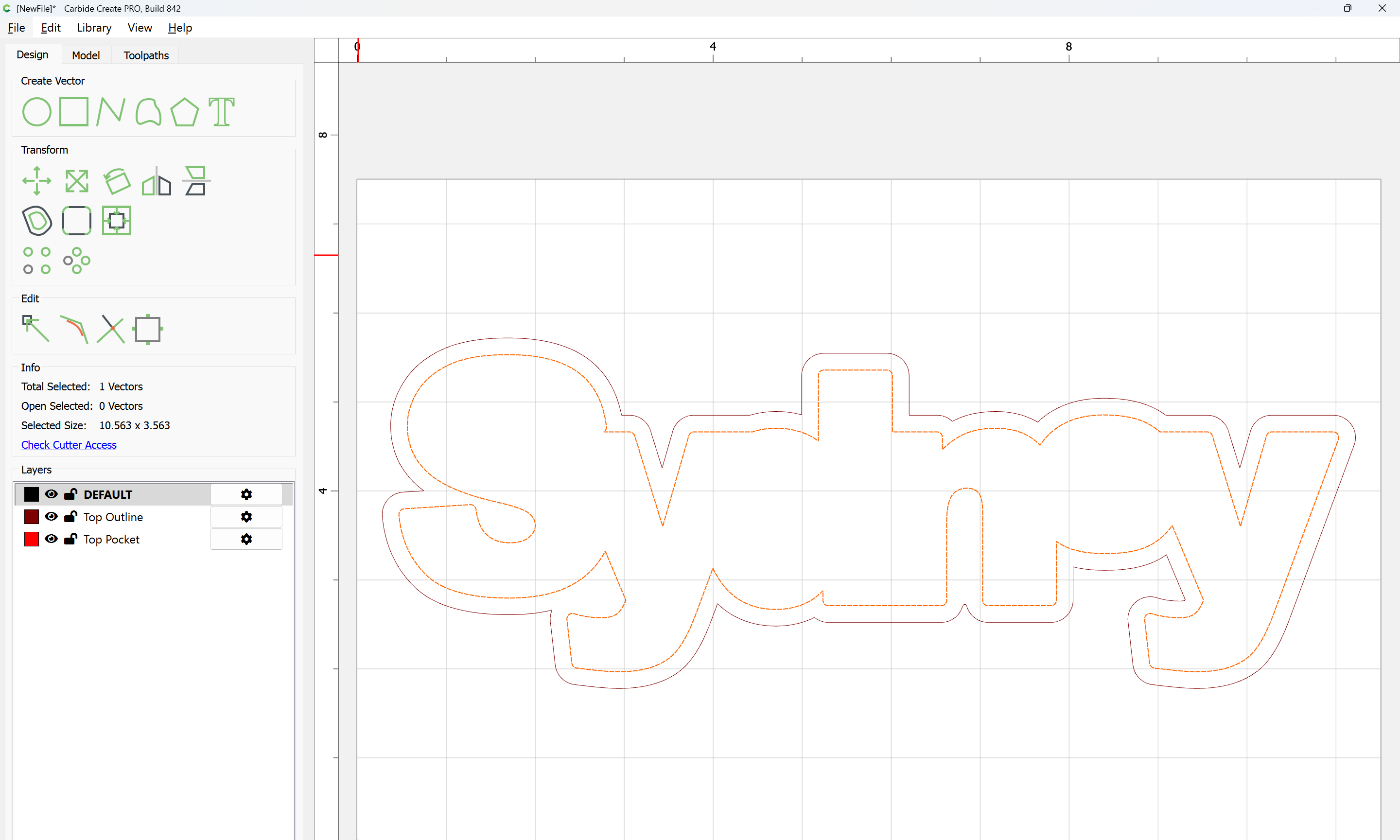

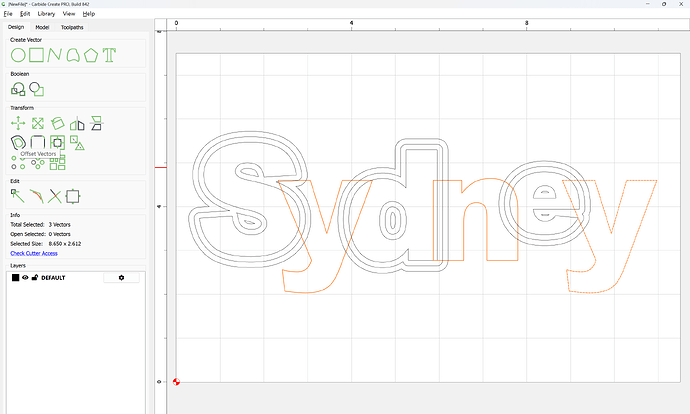

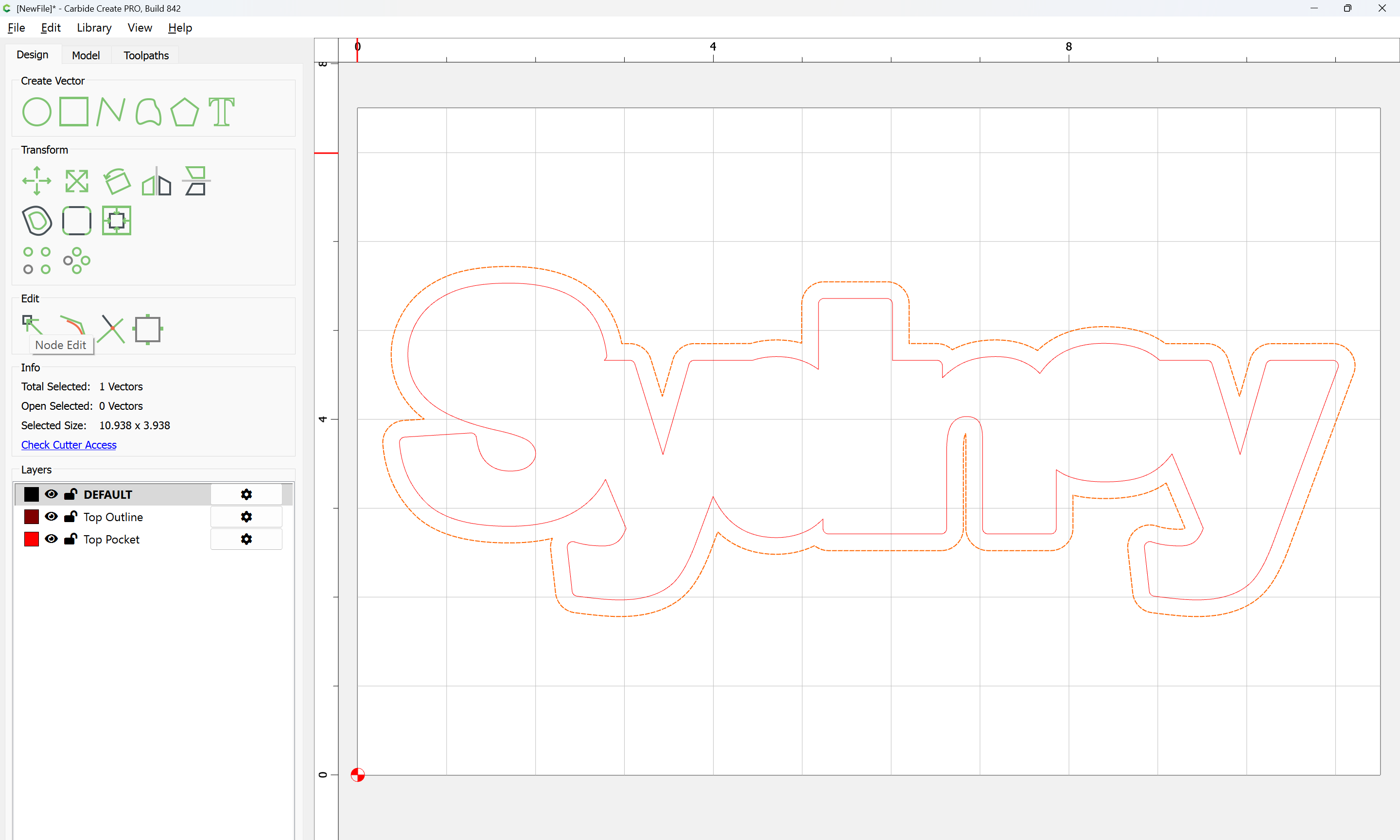

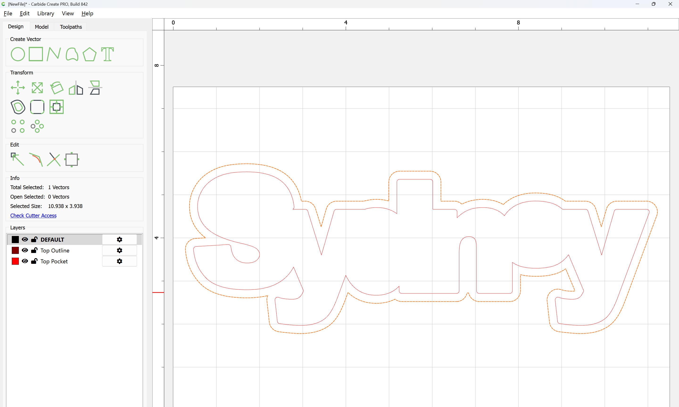

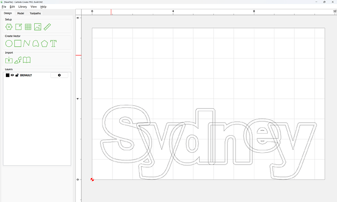

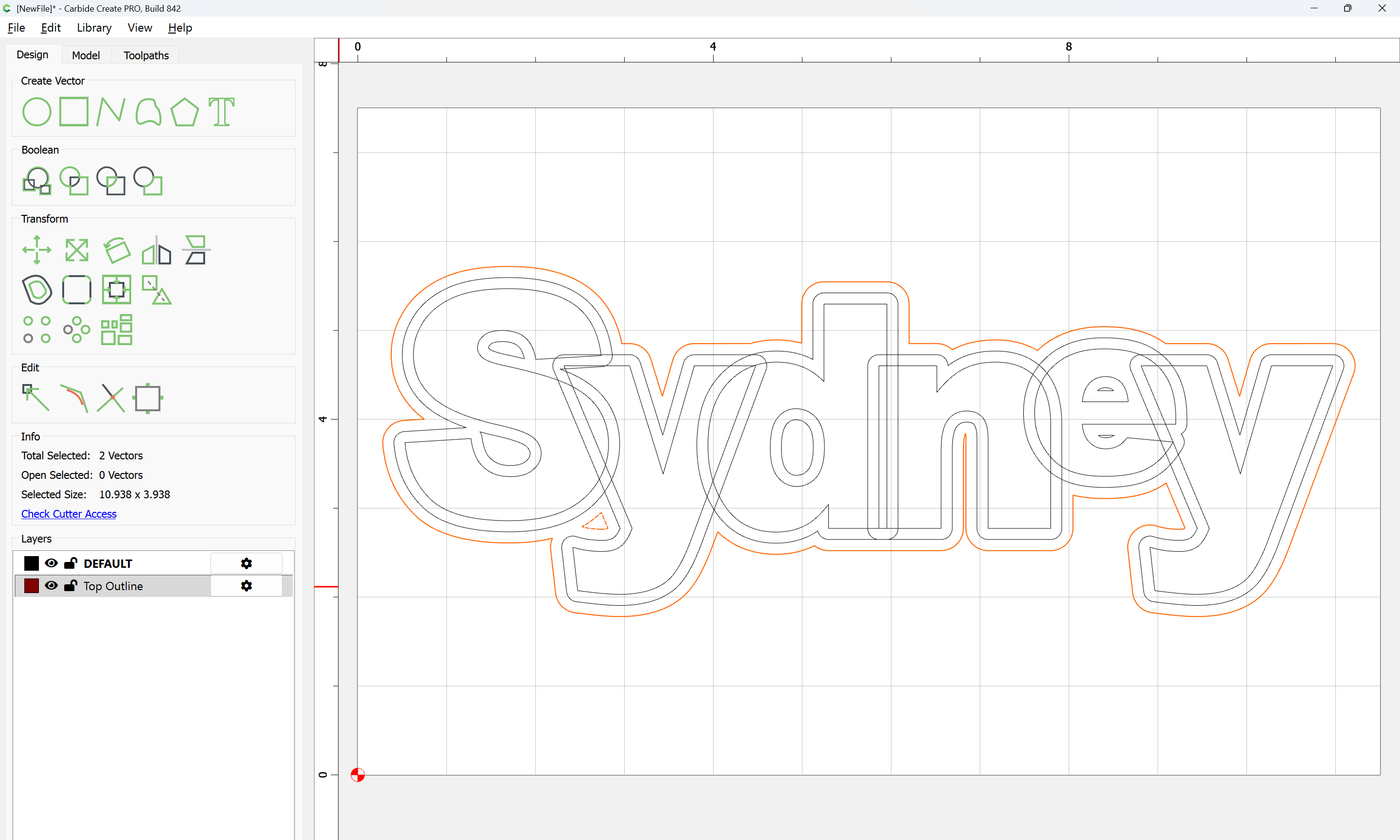

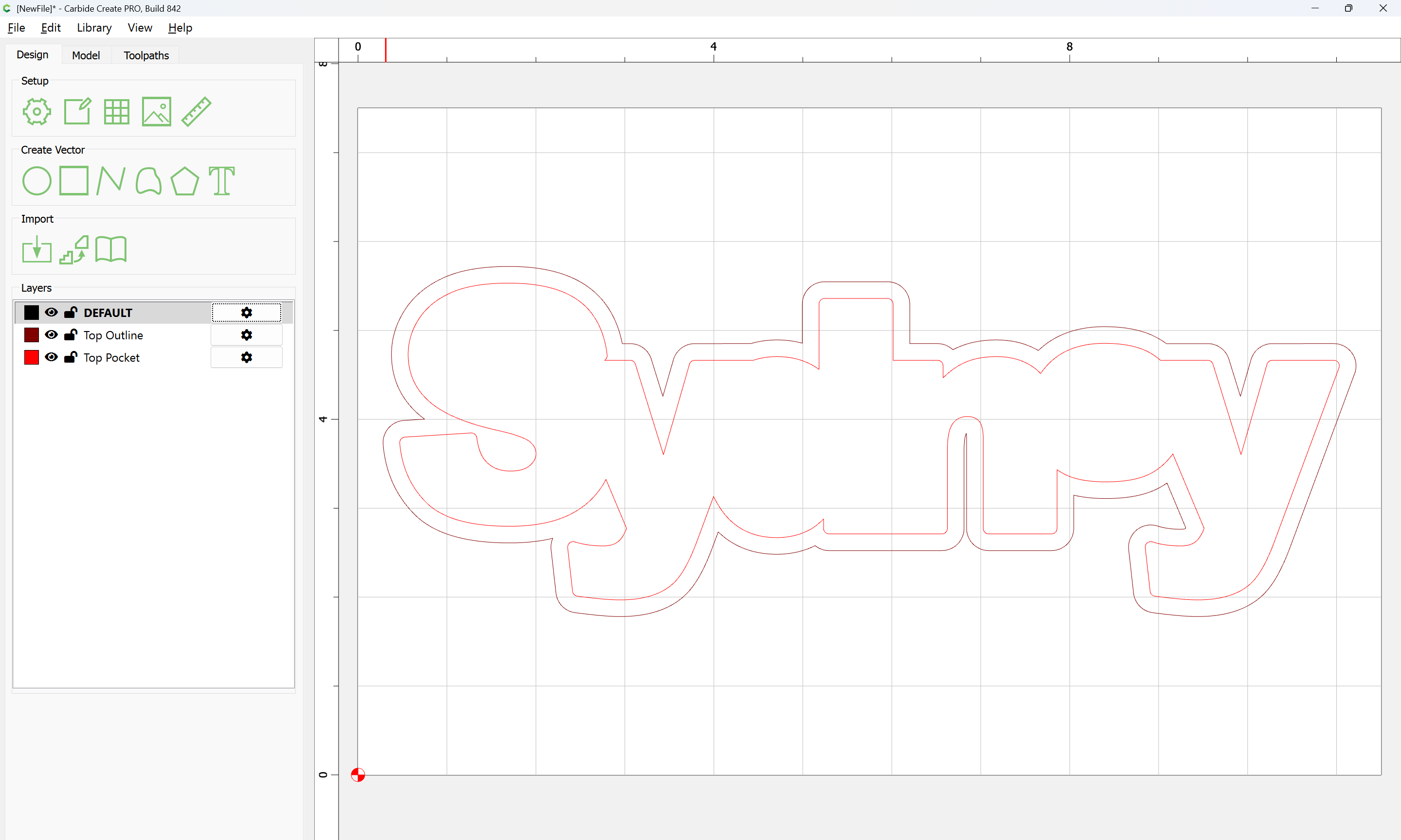

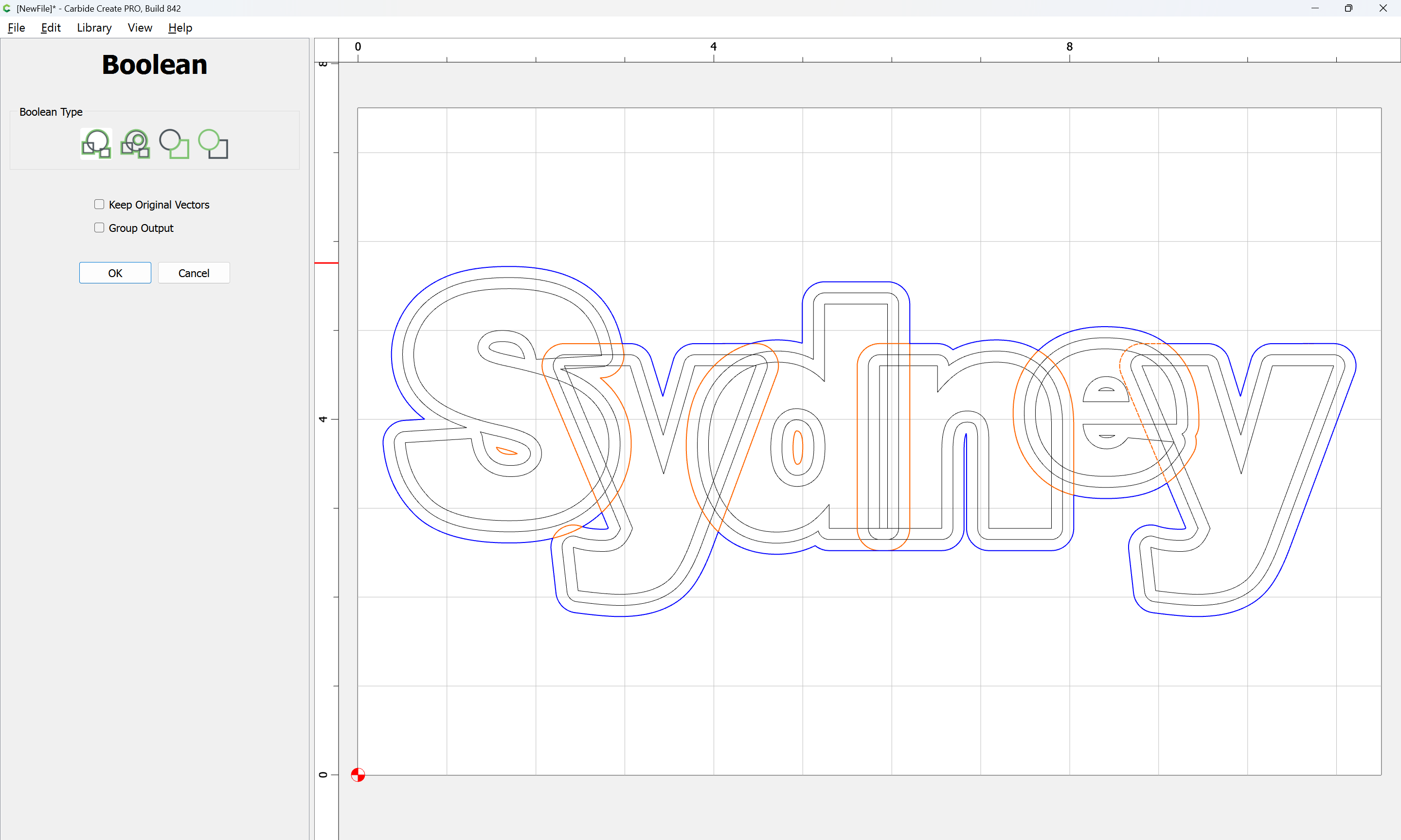

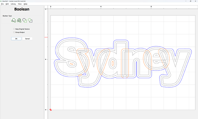

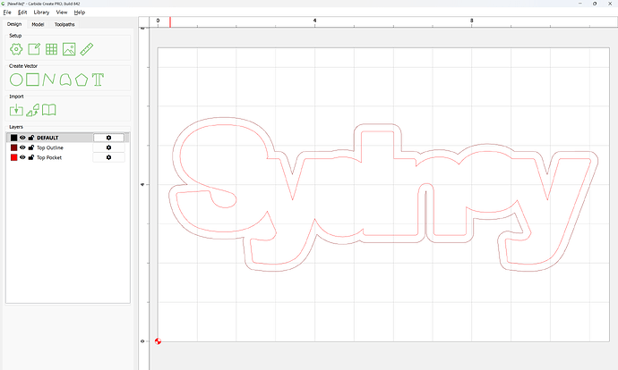

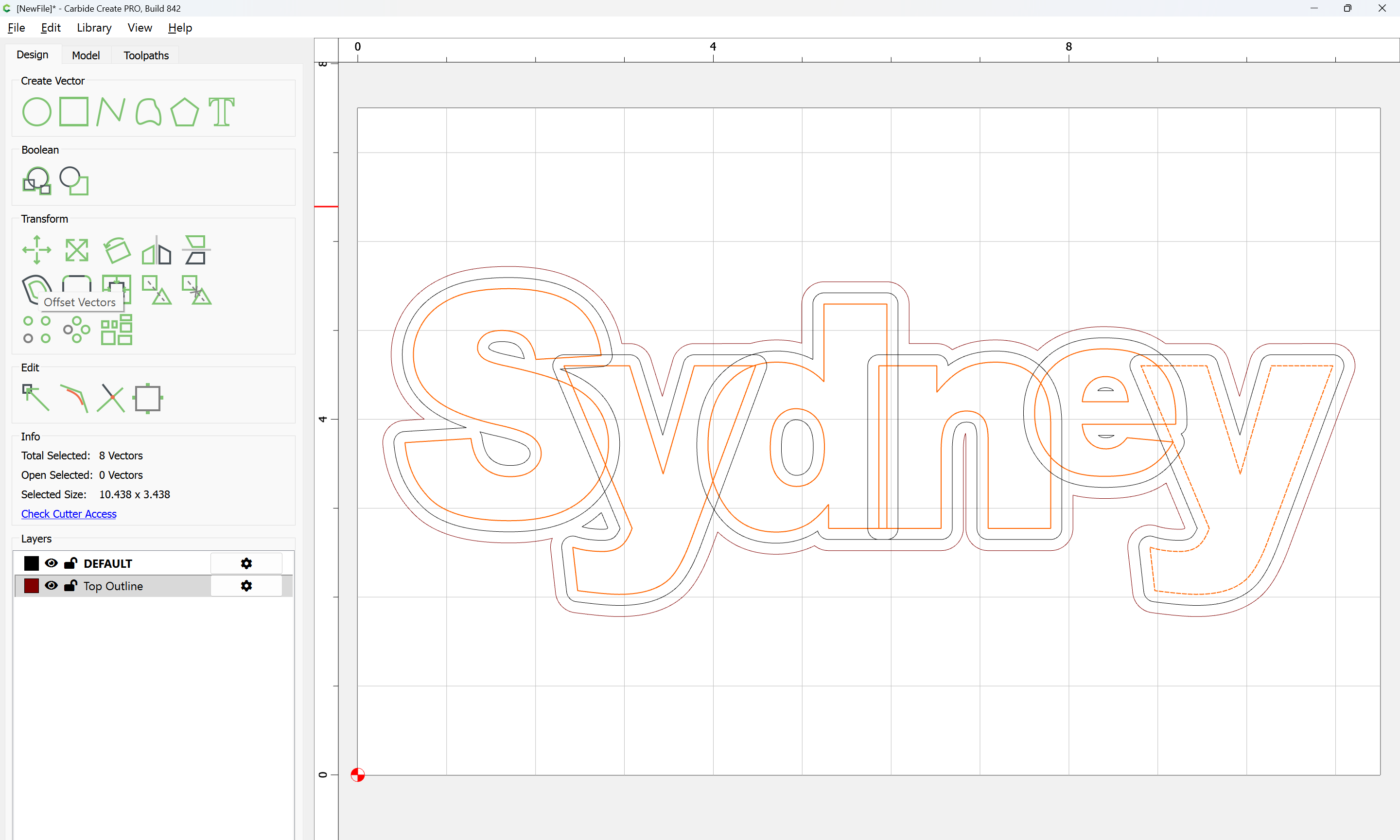

Select the outermost geometry and Boolean Union:
Ok

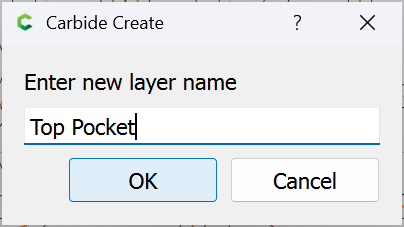

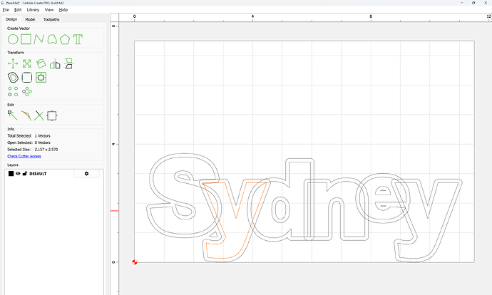

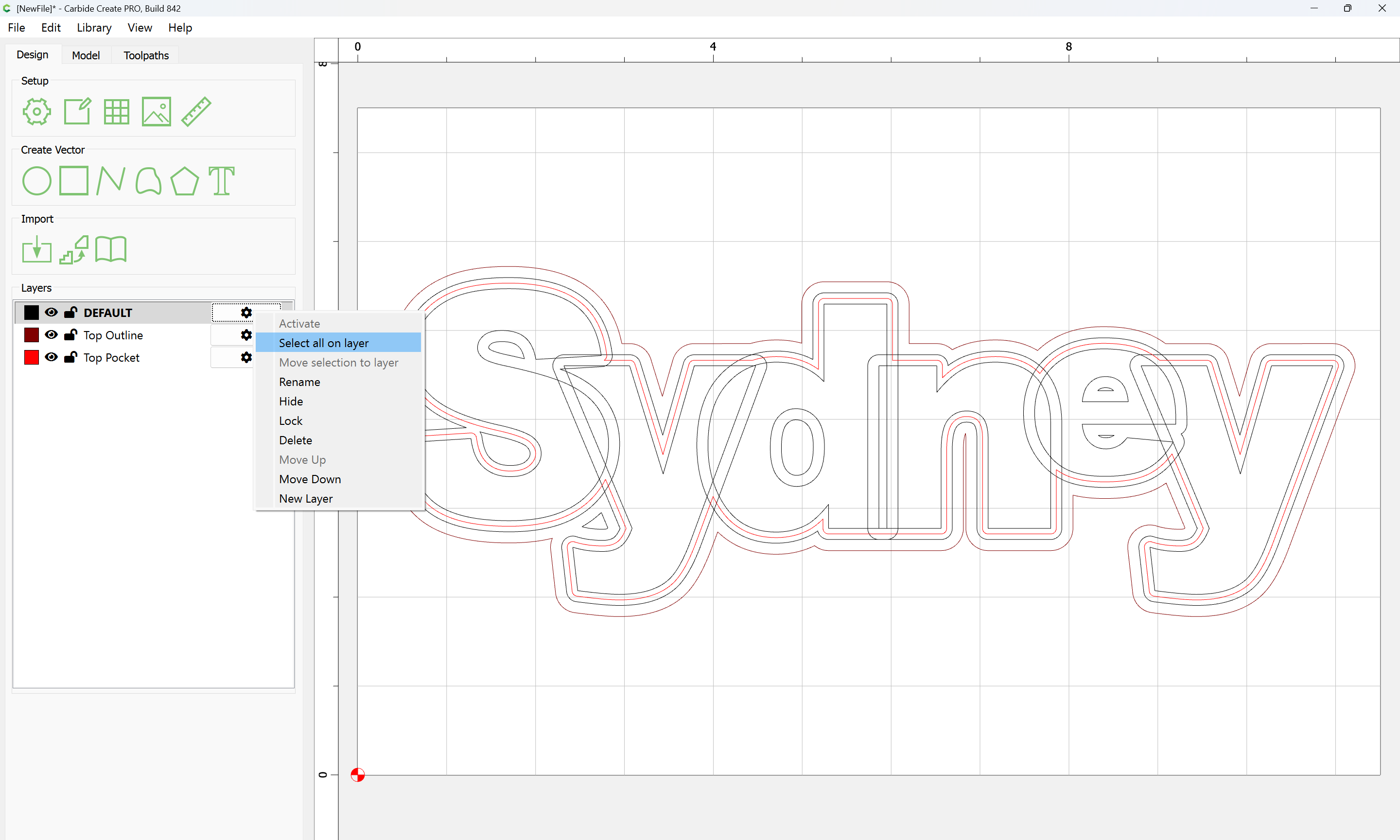

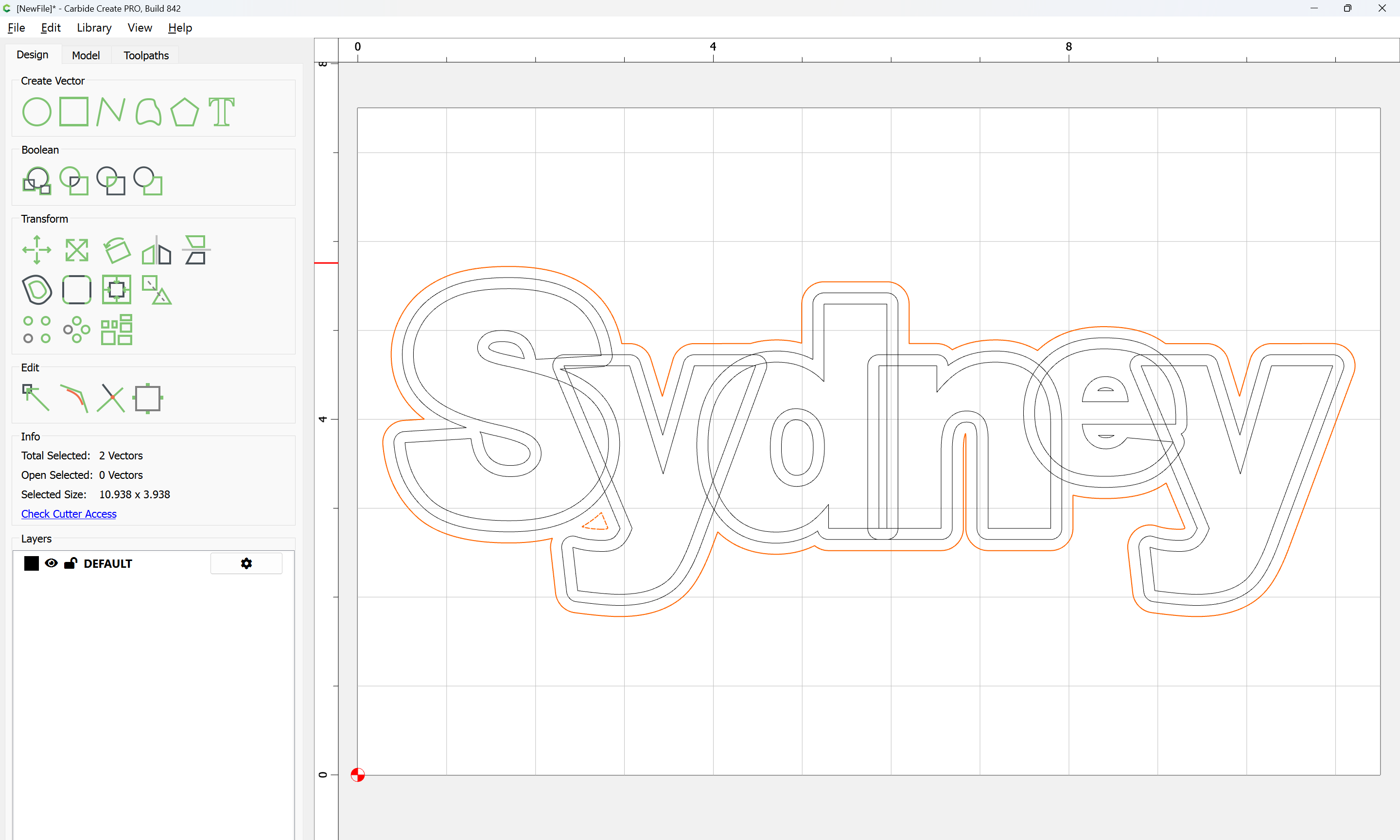

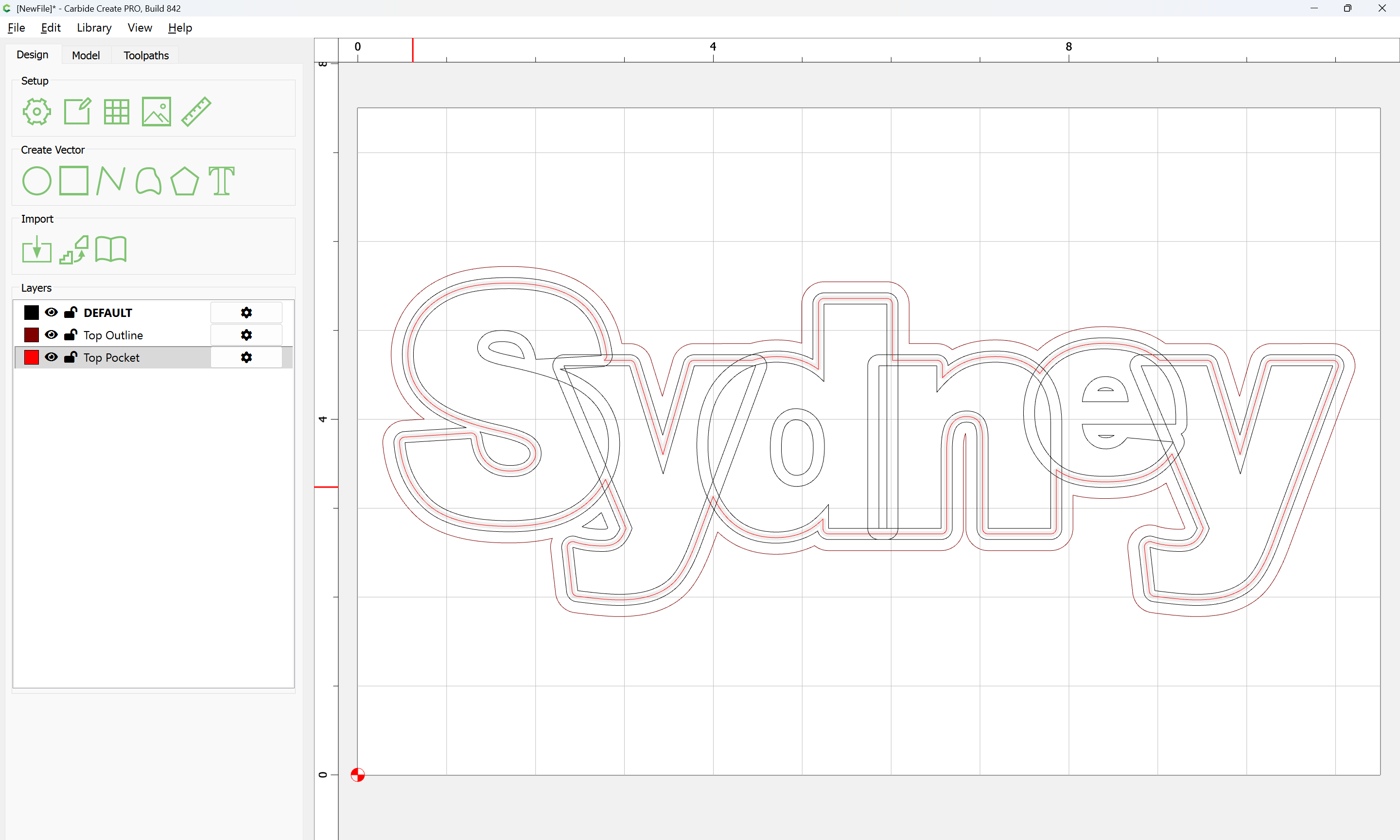

Make a new layer and move the geometry to that:

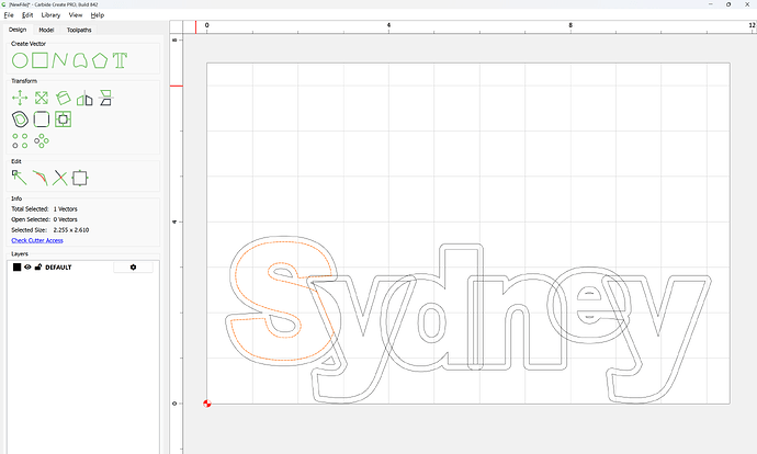

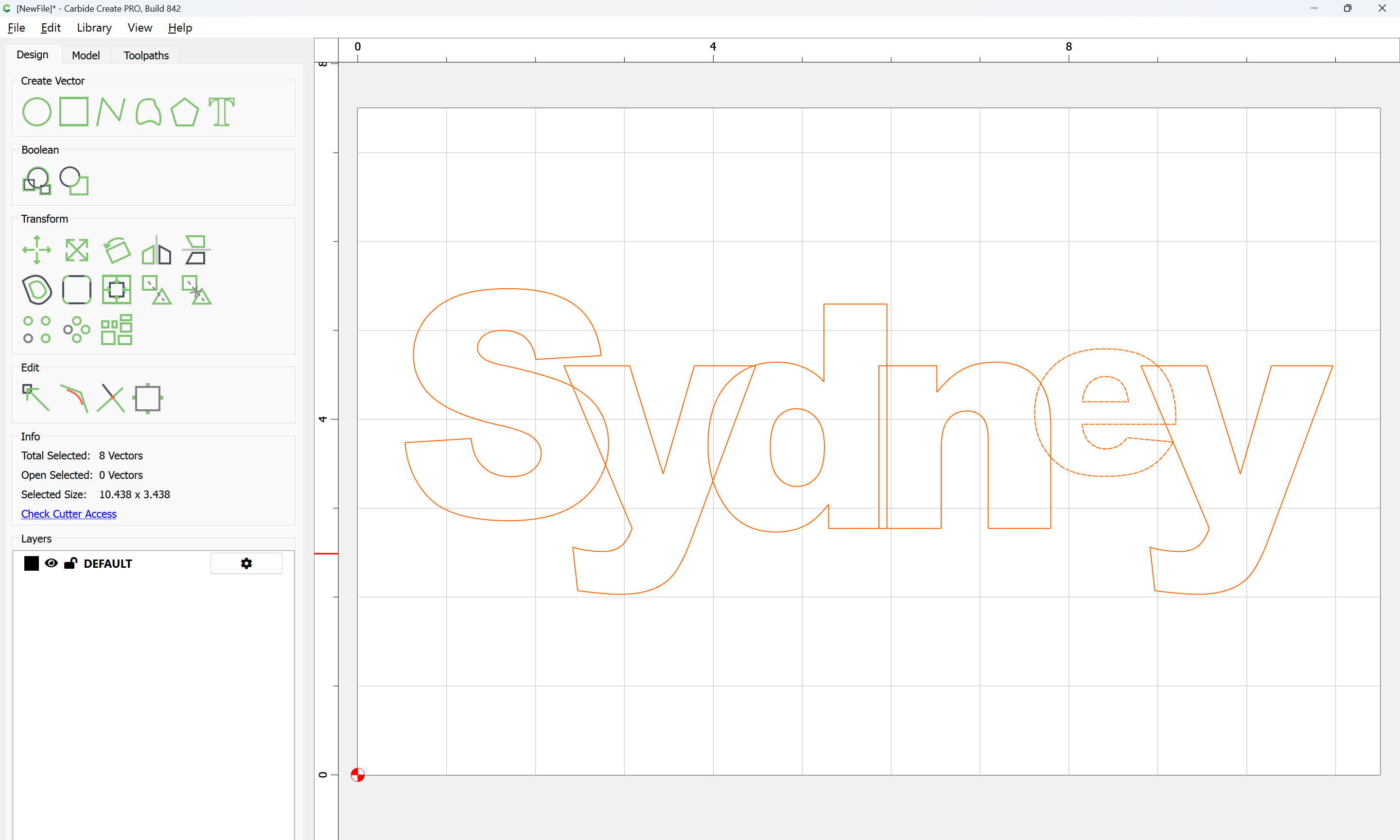

Select the original letters:
and offset by the desired clearance for the letters:
Apply

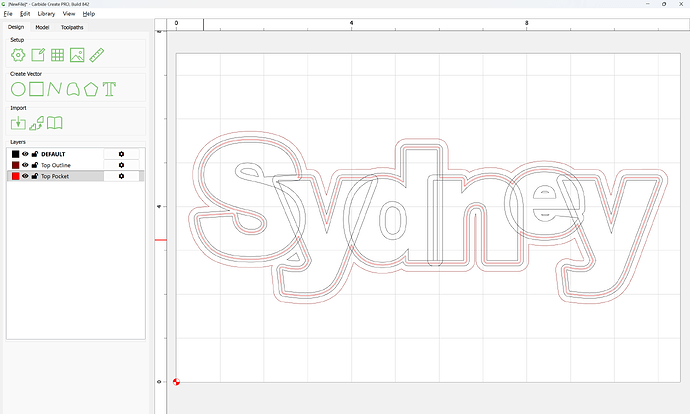

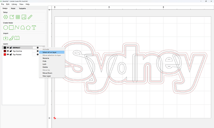

Make a second new layer:
and move the selection to it:
shift-click to deselect the surrounding geometry (which we wish to keep):
and delete the extraneous internal elements:

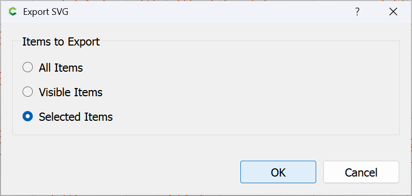

It will be necessary to work in two separate files since the letters will have a different thickness than the top of the stool, so select everything on the DEFAULT layer:
and export it to an SVG:
OK
then delete:

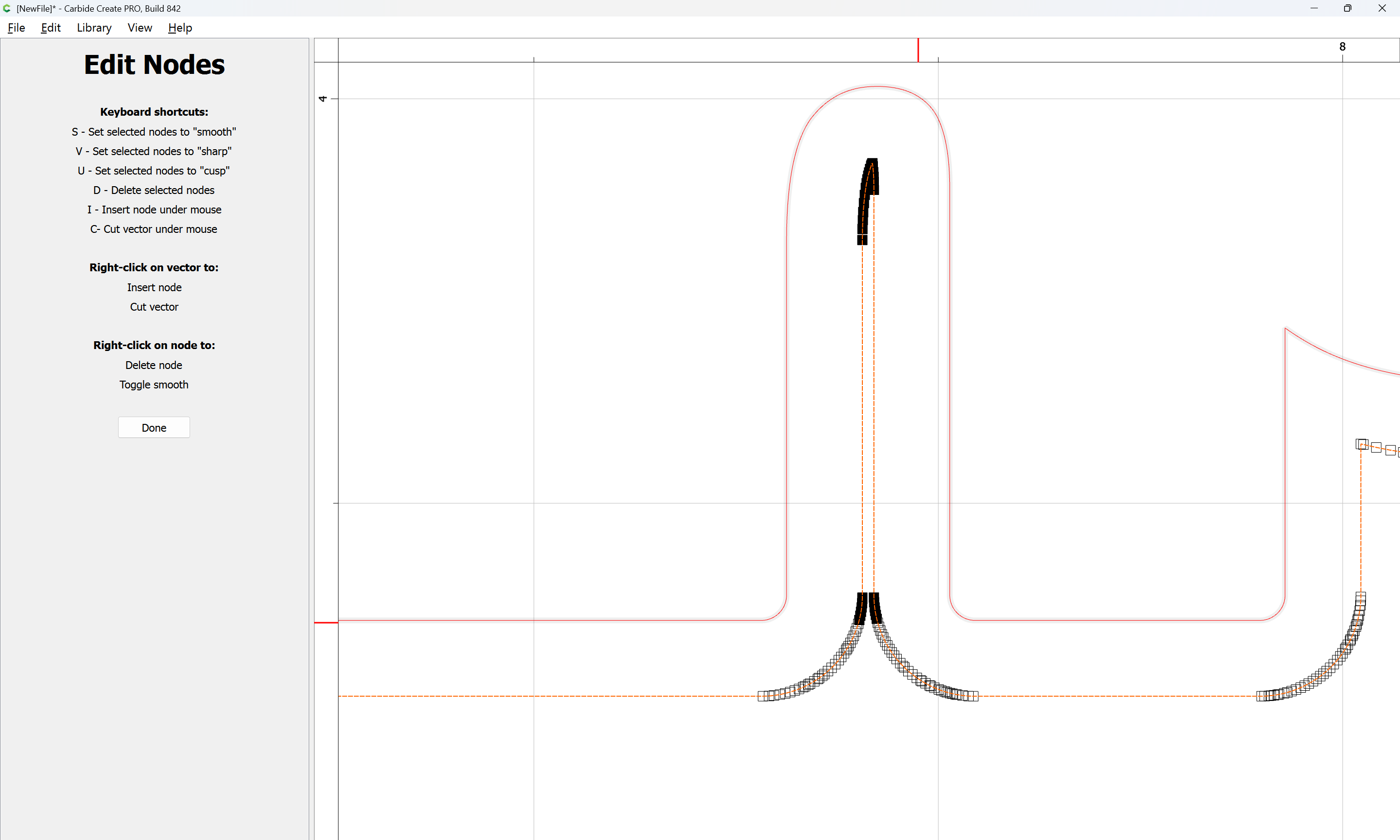

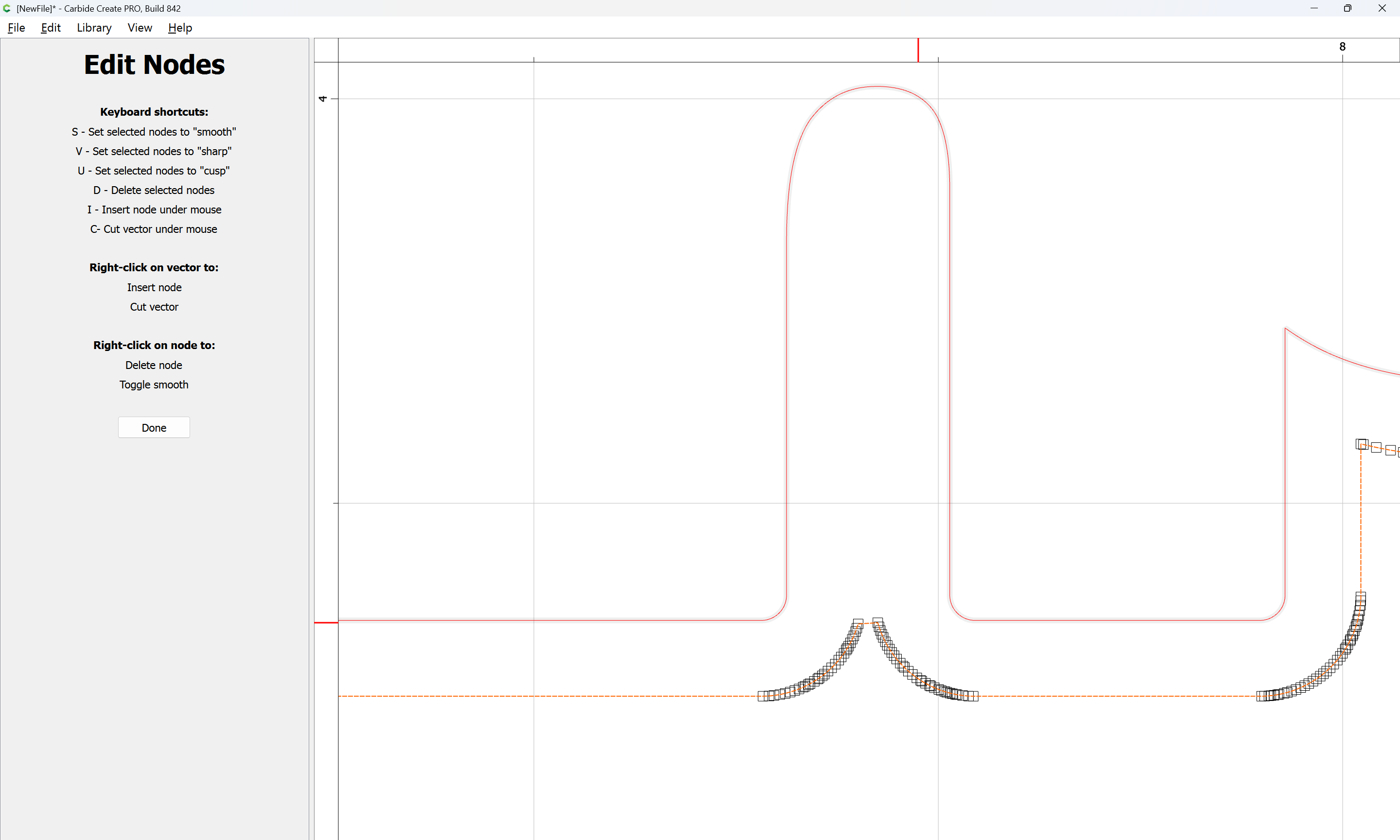

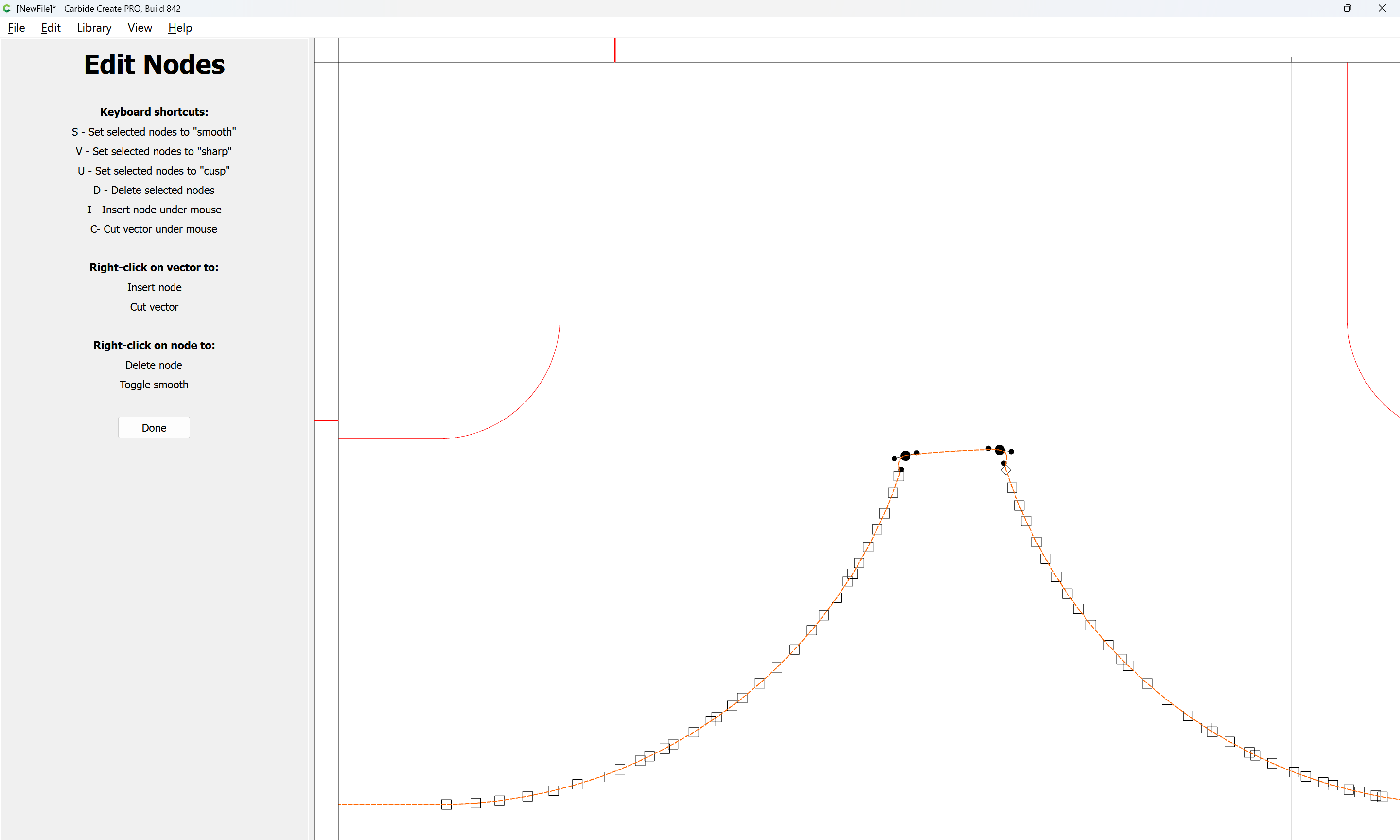

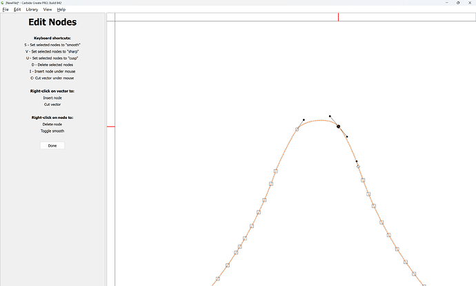

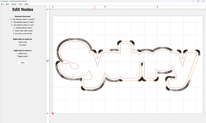

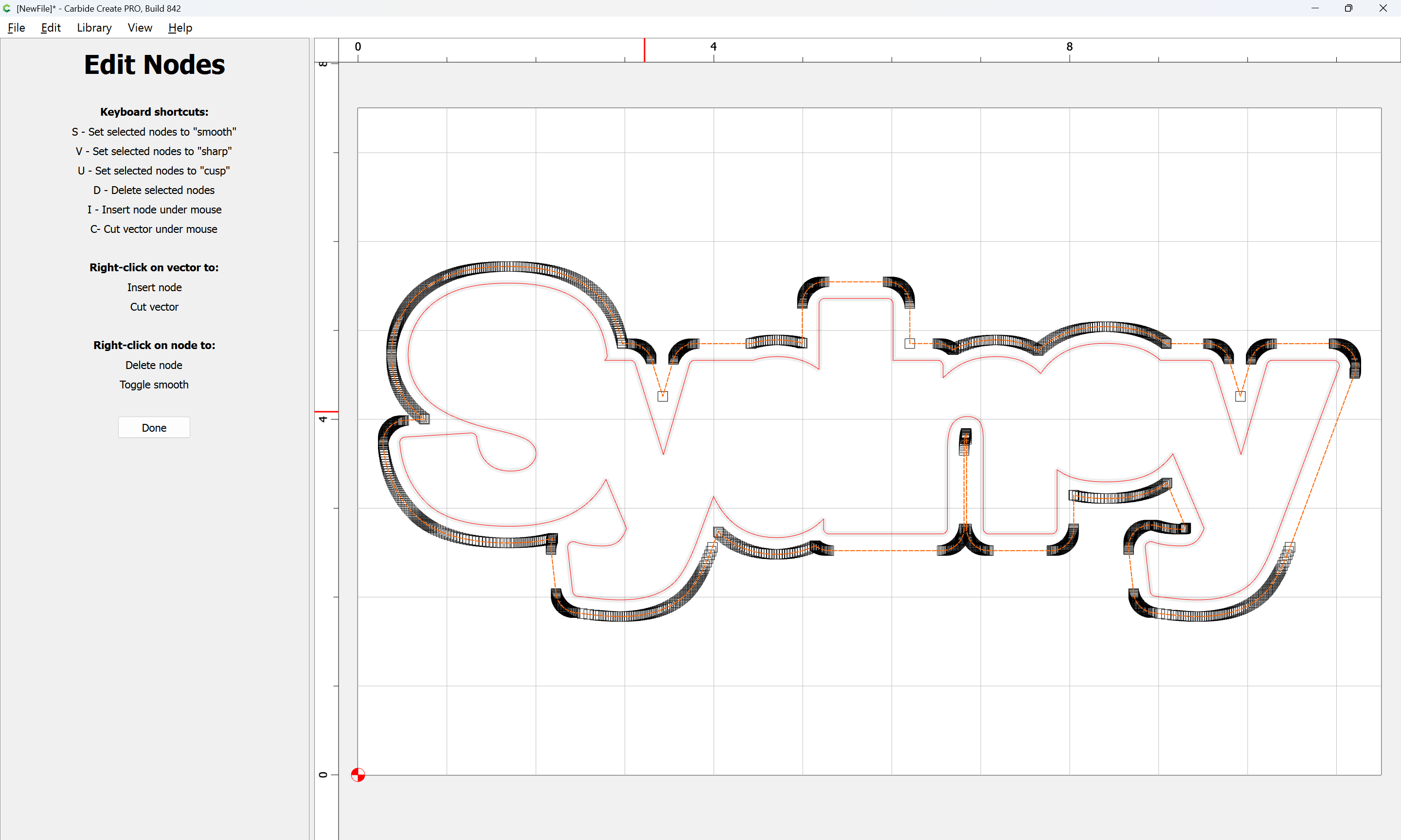

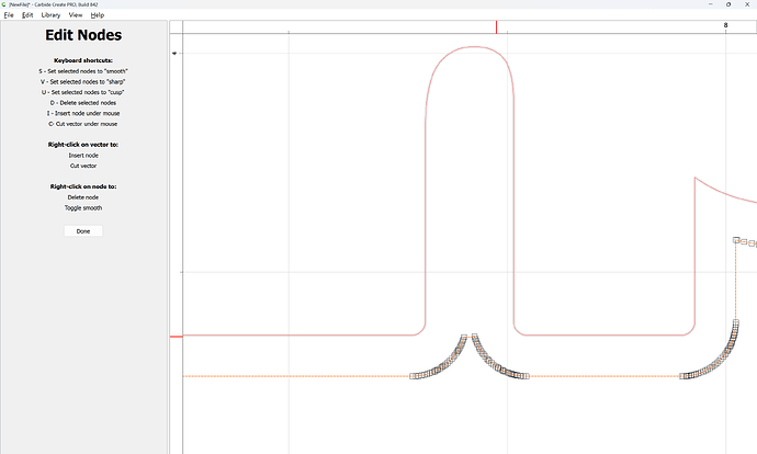

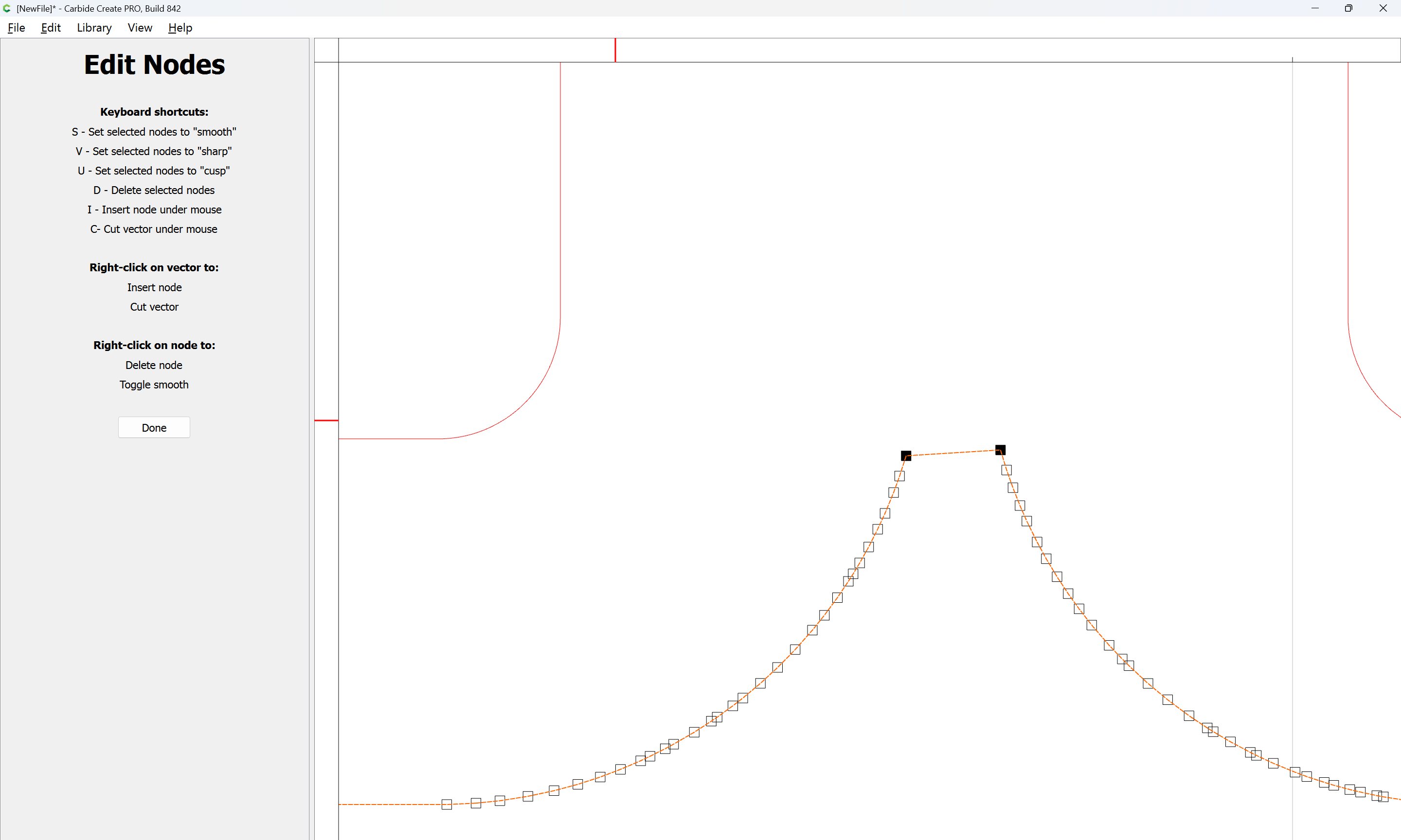

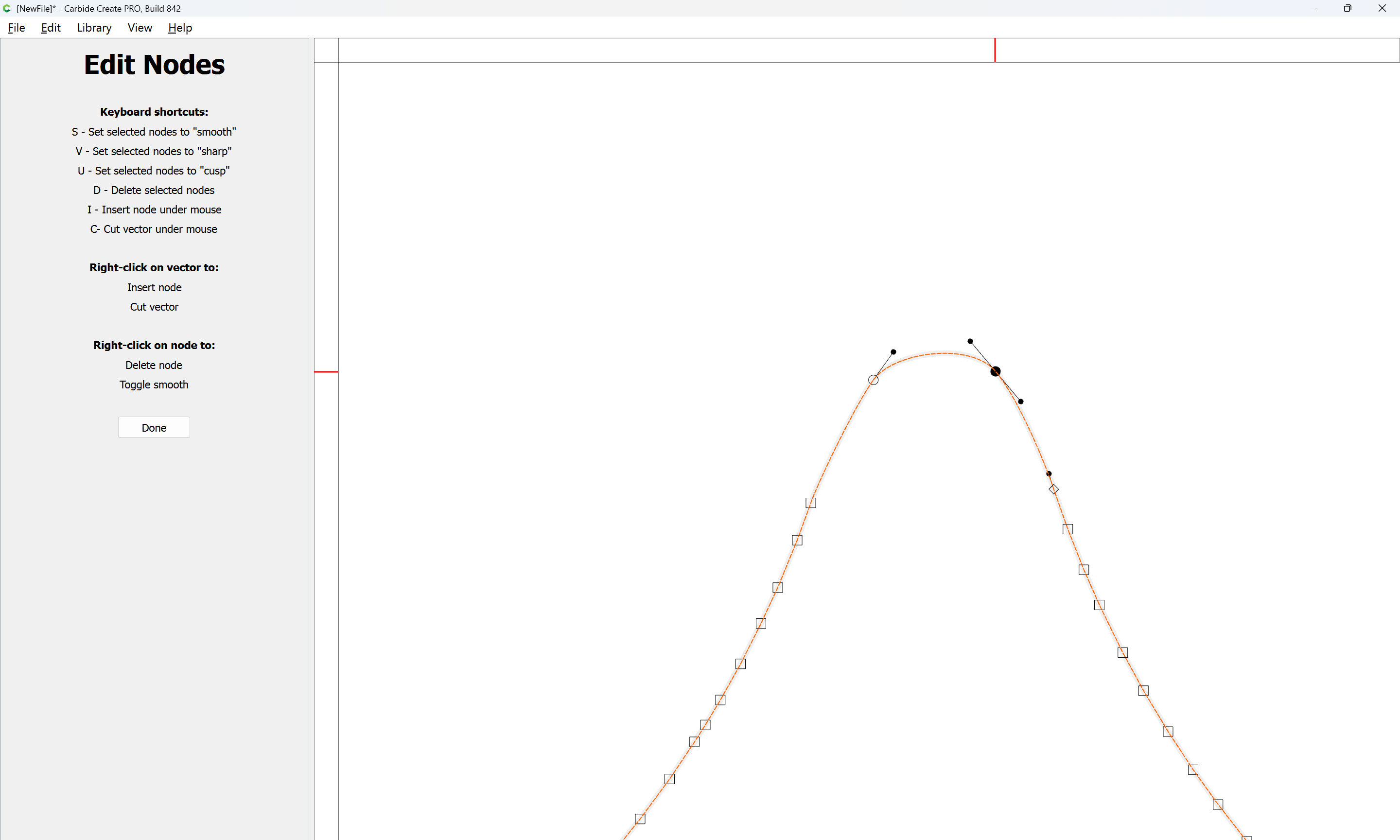

The narrow portion of the n is unlikely to survive long and presents a possibility of splinters so select the geometry:
and use Node Editing:
to remove a reasonable portion:
d
If desired, the two two remaining nodes may be selected:
s (to smooth)
and adjusted as need be
Done

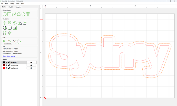

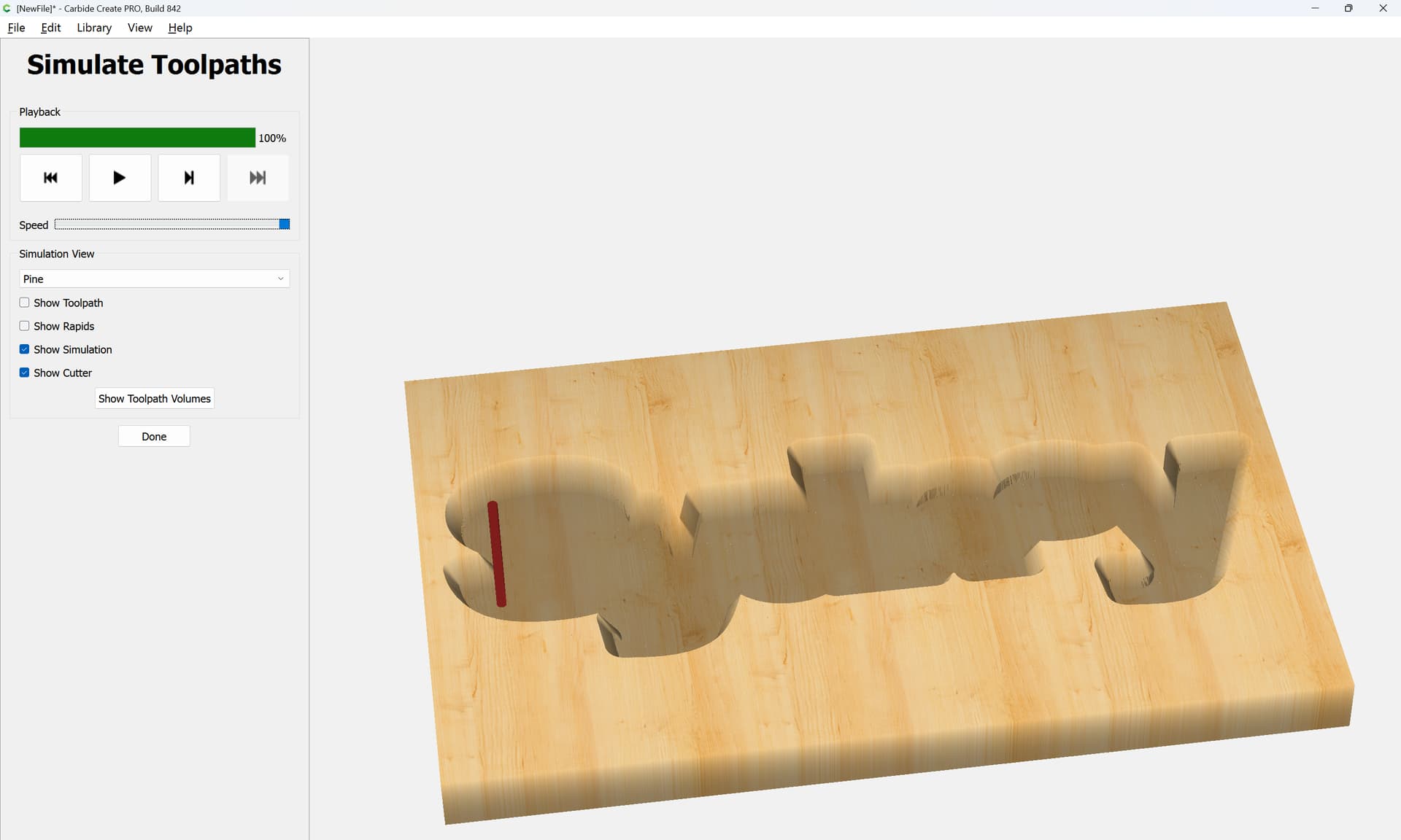

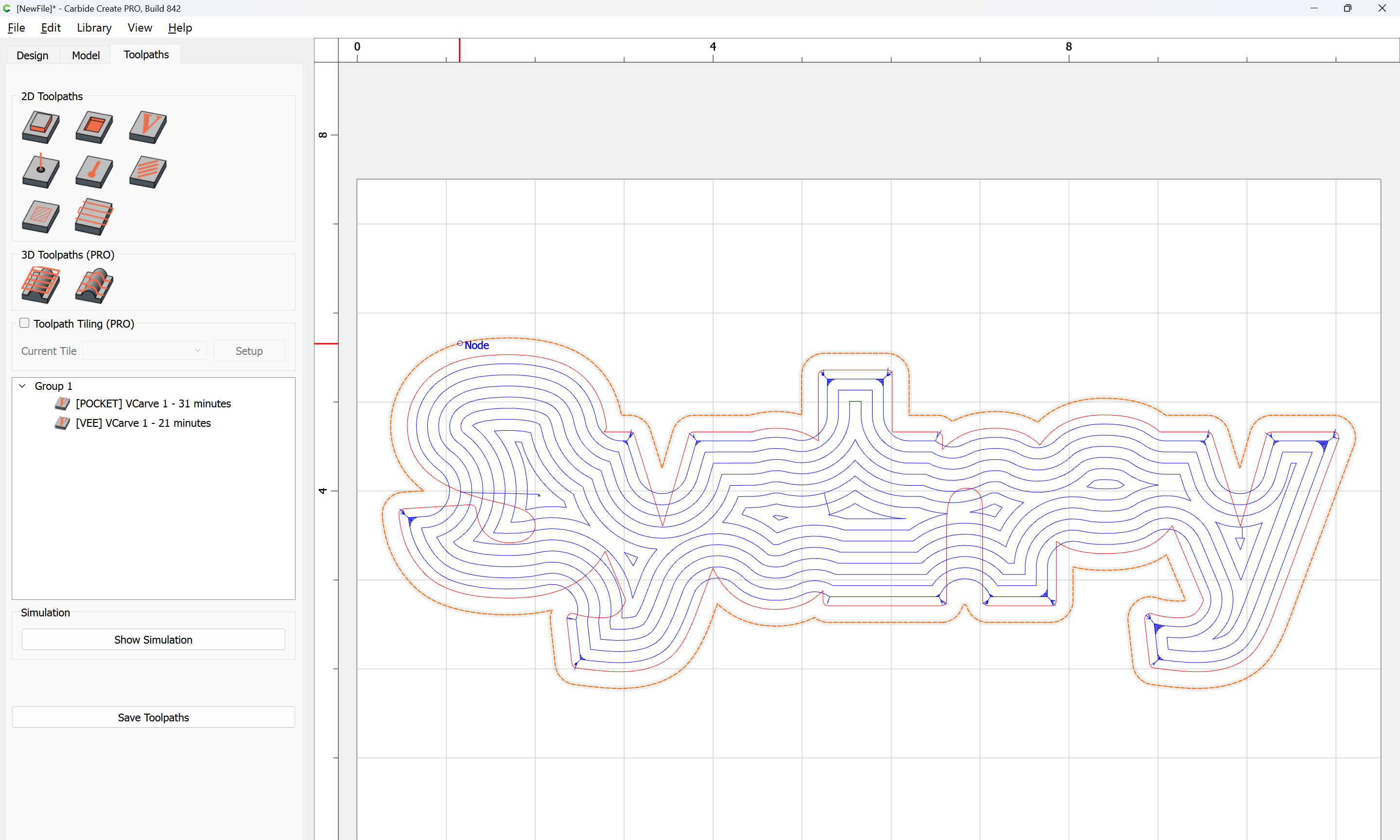

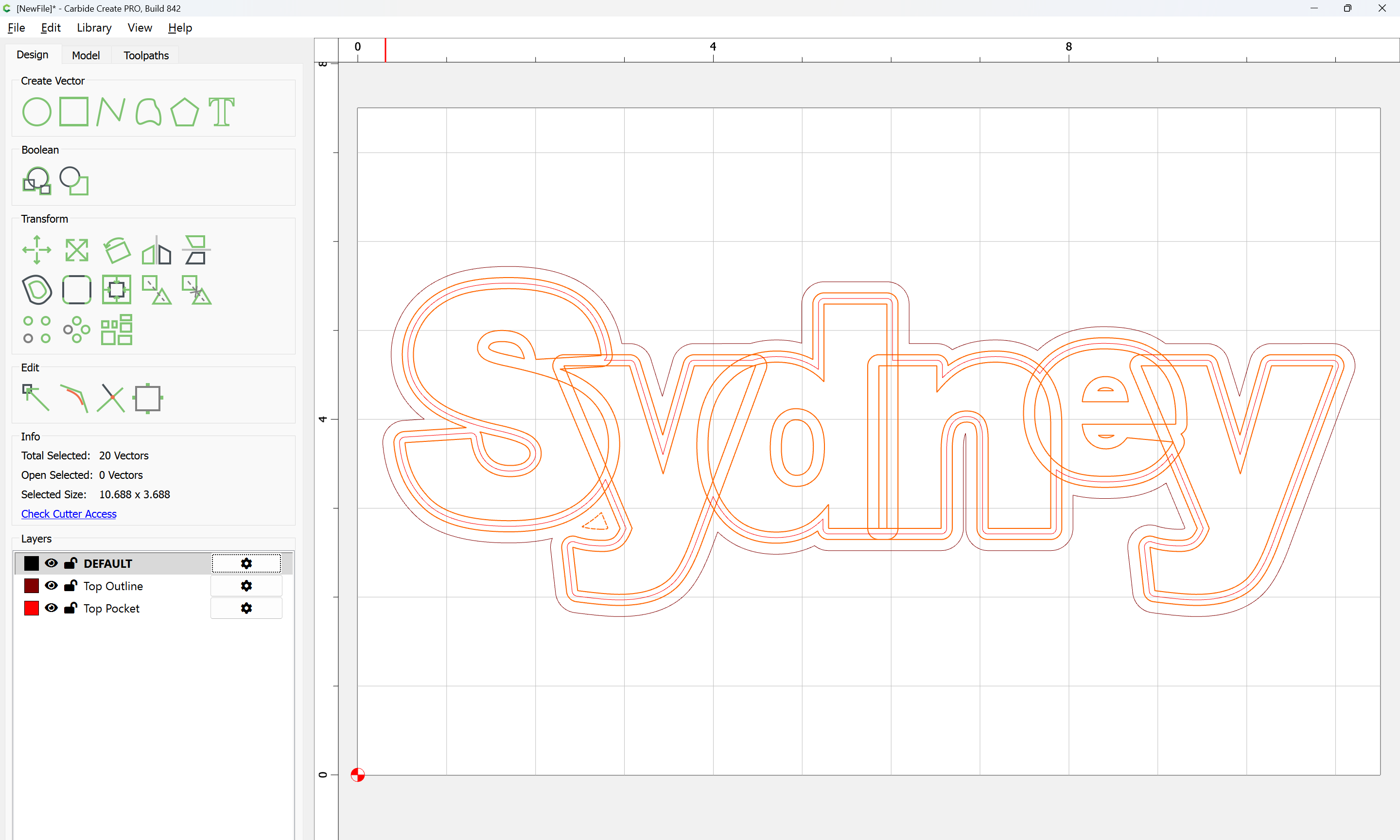

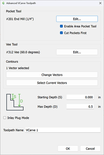

Toolpaths may be assigned for the top to suitable depths:
and the inner geometry assigned an Inside Contour with a suitable tool to a suitable depth:
and the toolpaths/tool selection/depths adjusted as necessary until one arrives at something along the lines of:

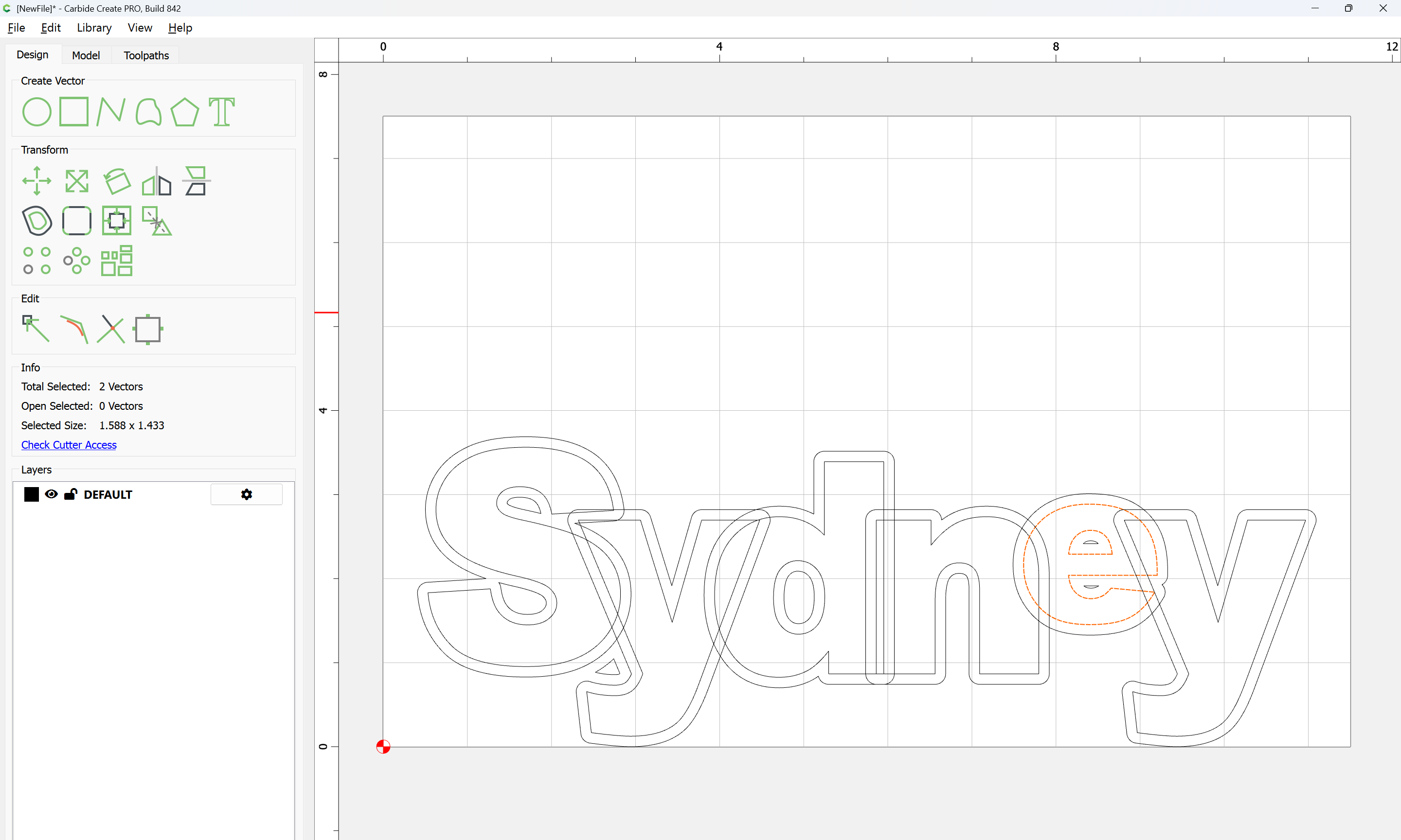

For the letters, open the SVG:
Note that the grouping of letter perimeter with counter will need to be re-done:

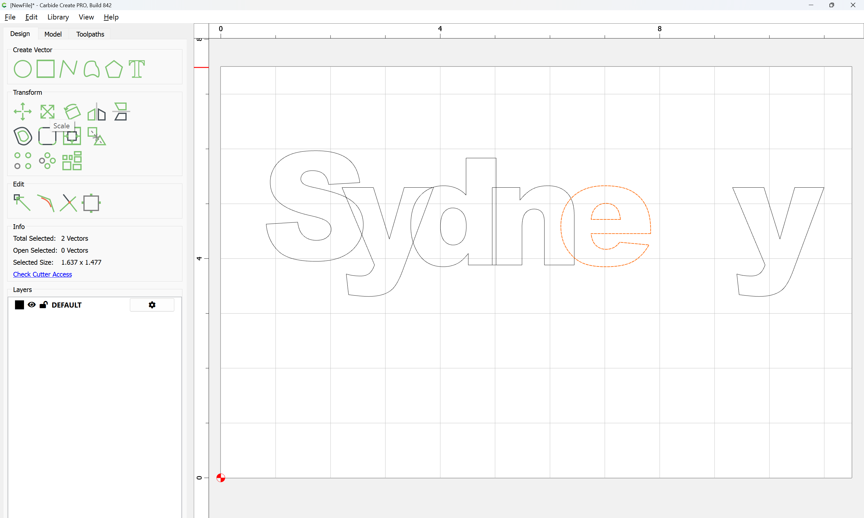

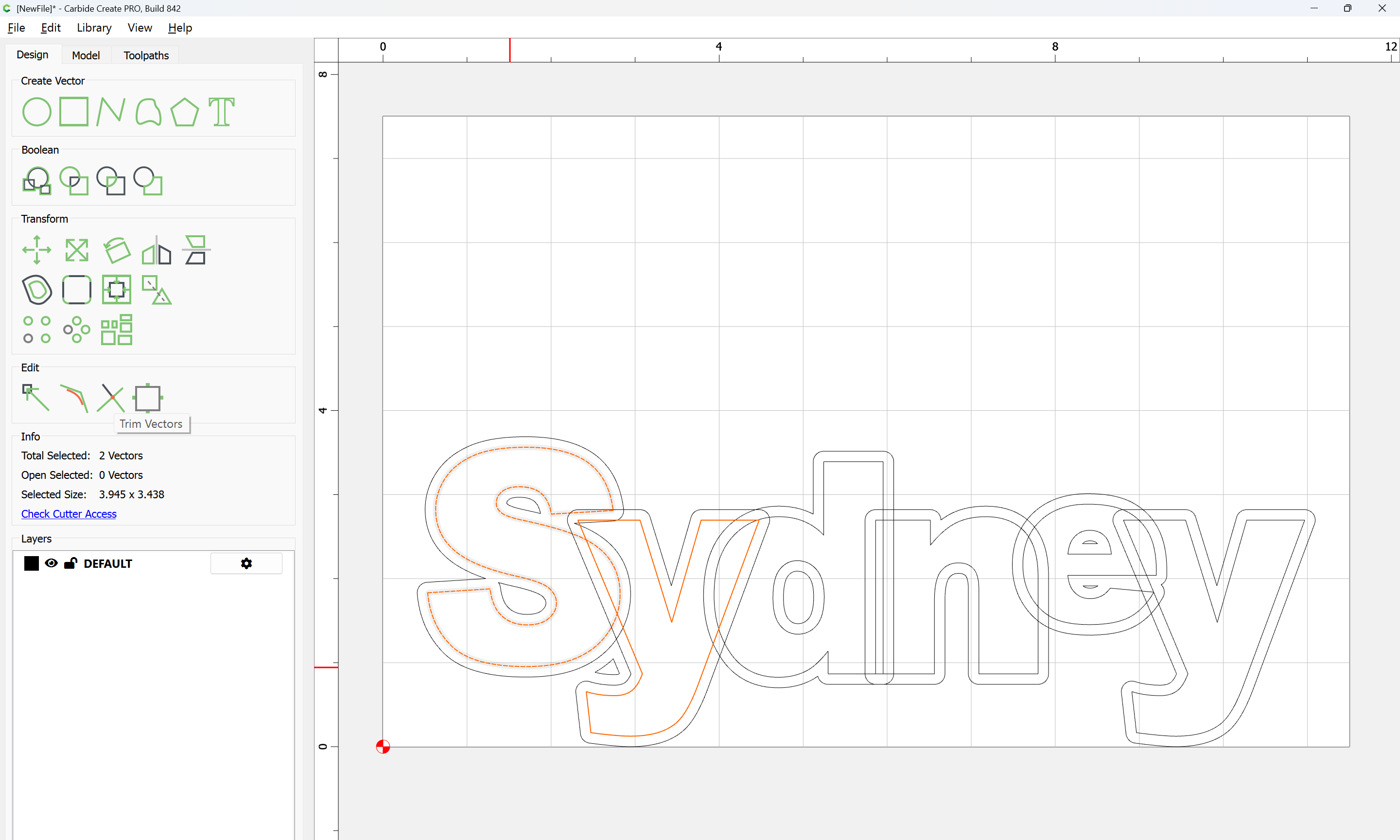

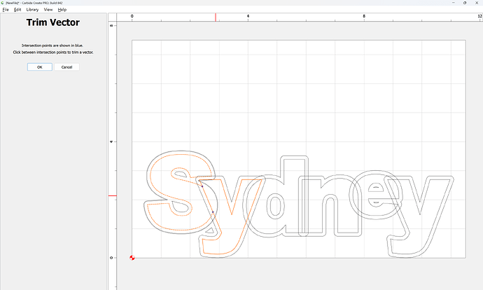

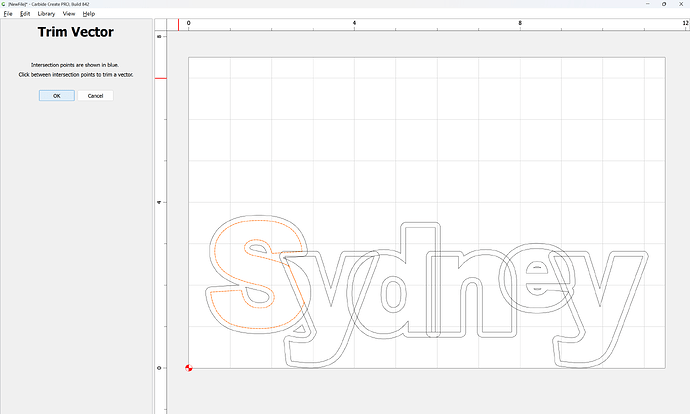

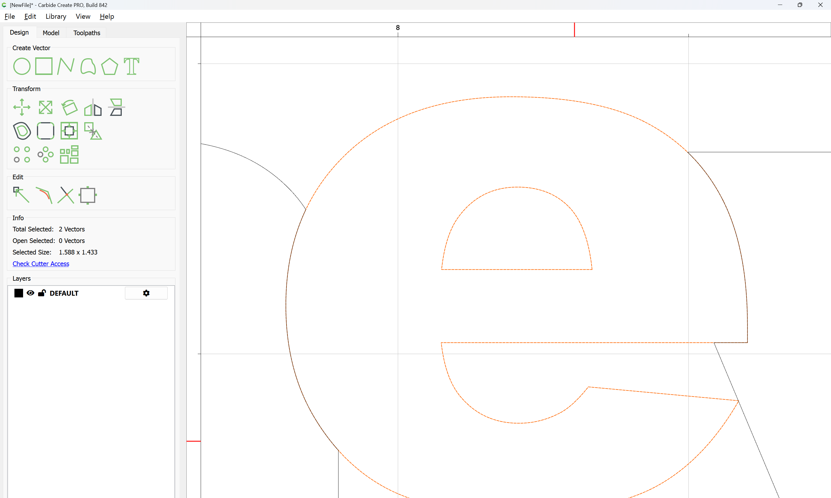

For each letter which crosses over other letter(s) select it and copy-paste it in place so as to create a duplicate in register w/ the original:

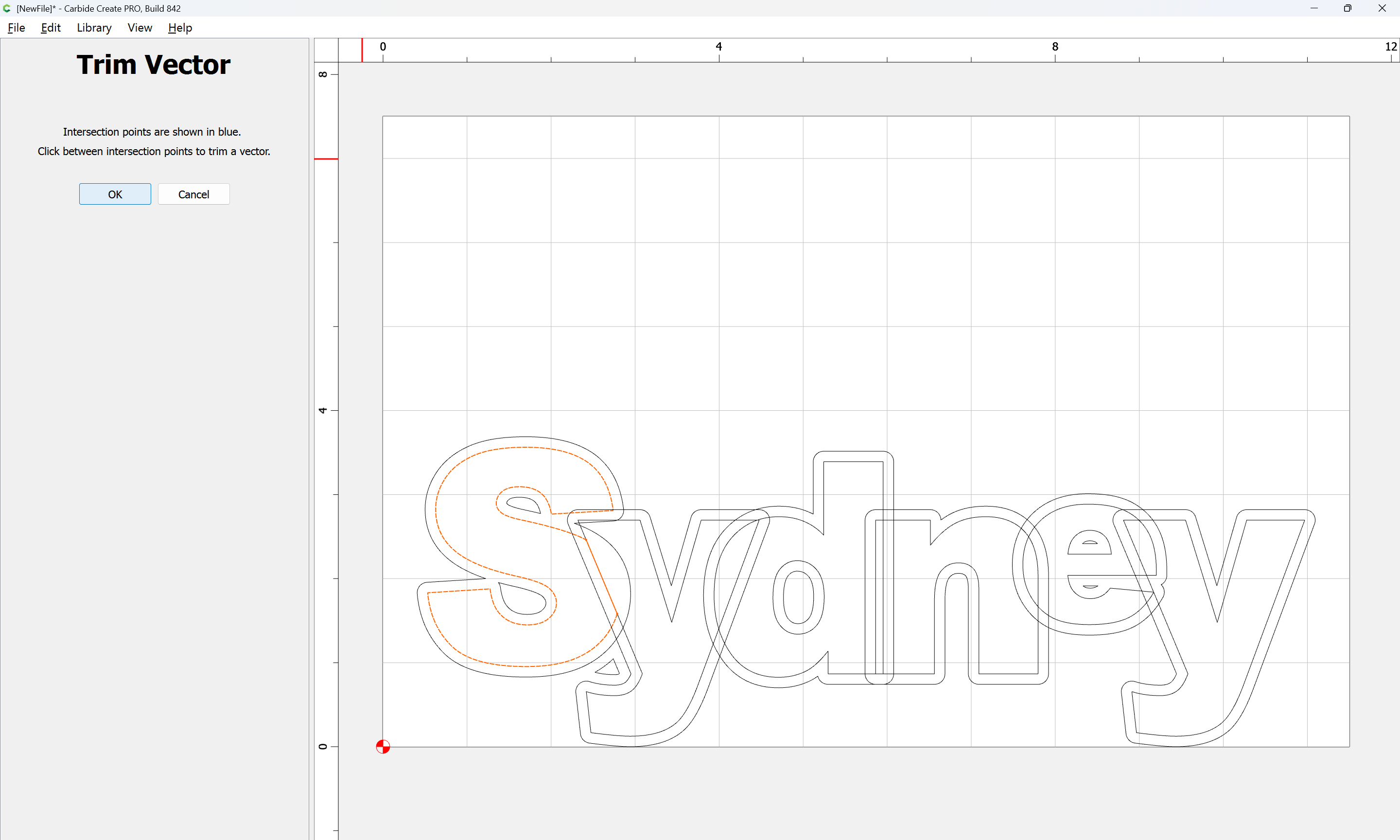

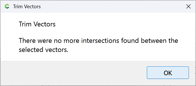

Then select a duplicate and a crossing letter:
and use Trim Vectors to remove what is not wanted:
until one arrives at:
OK
OK

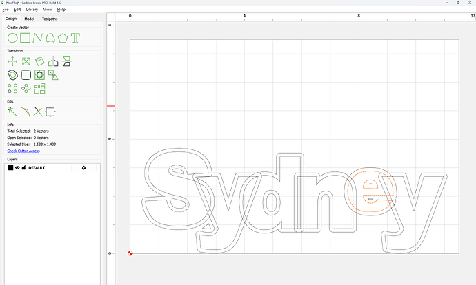

Join Vectors
Yes

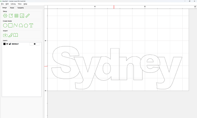

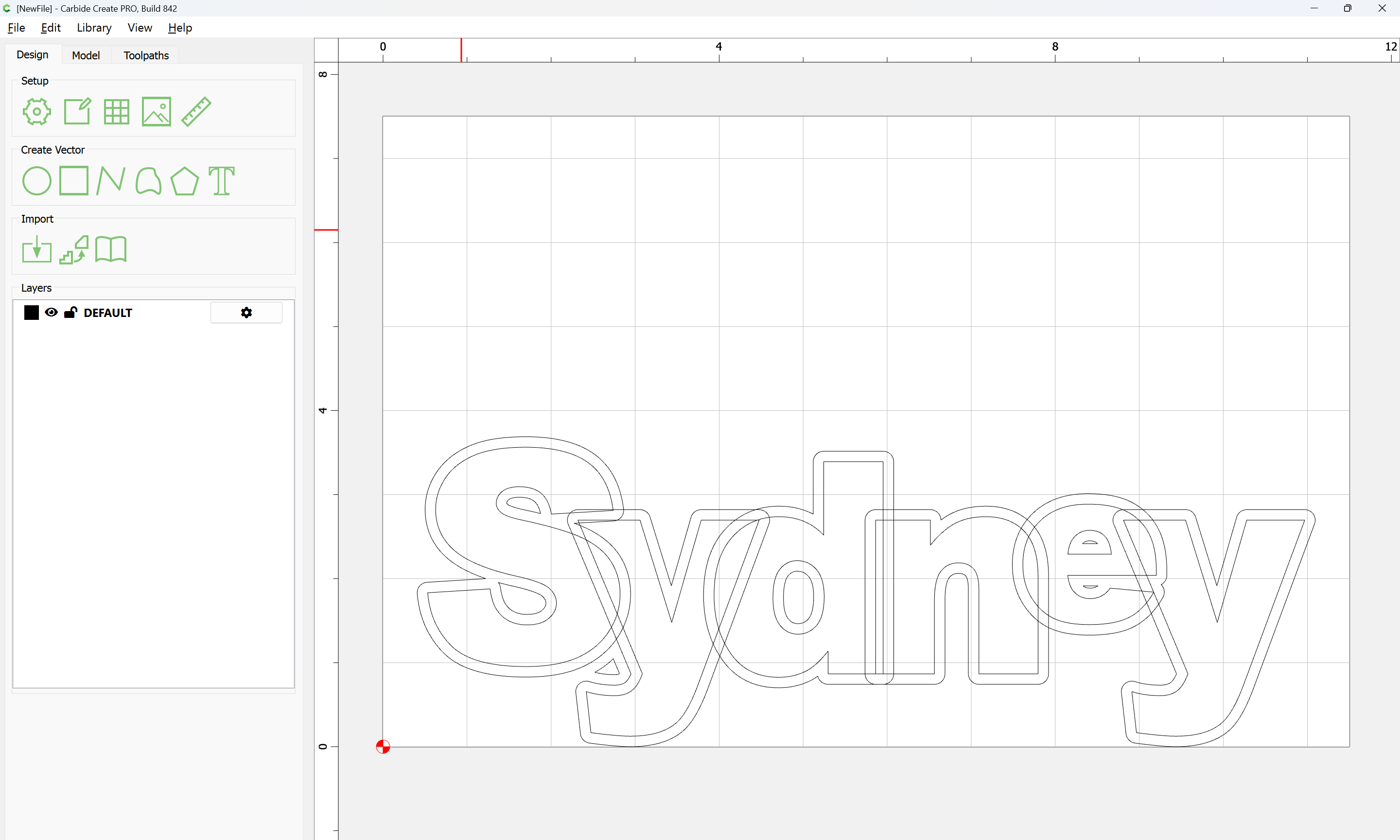

Repeat for each overlapping region until one arrives at:
The surrounding/extraneous geometry may now be selected:
and deleted:

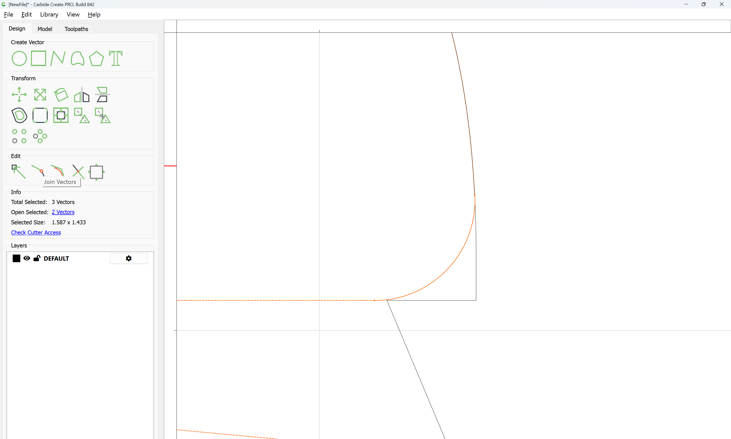

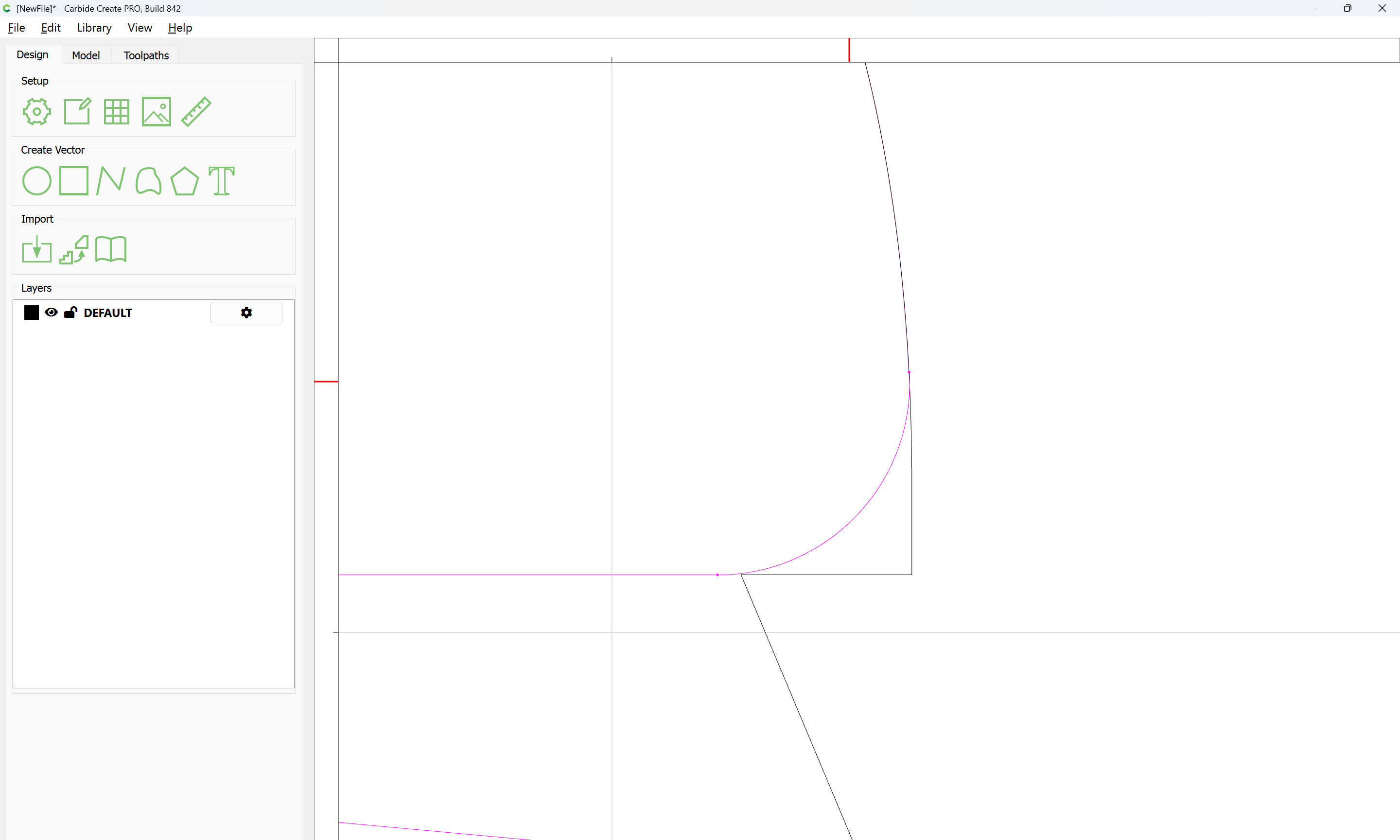

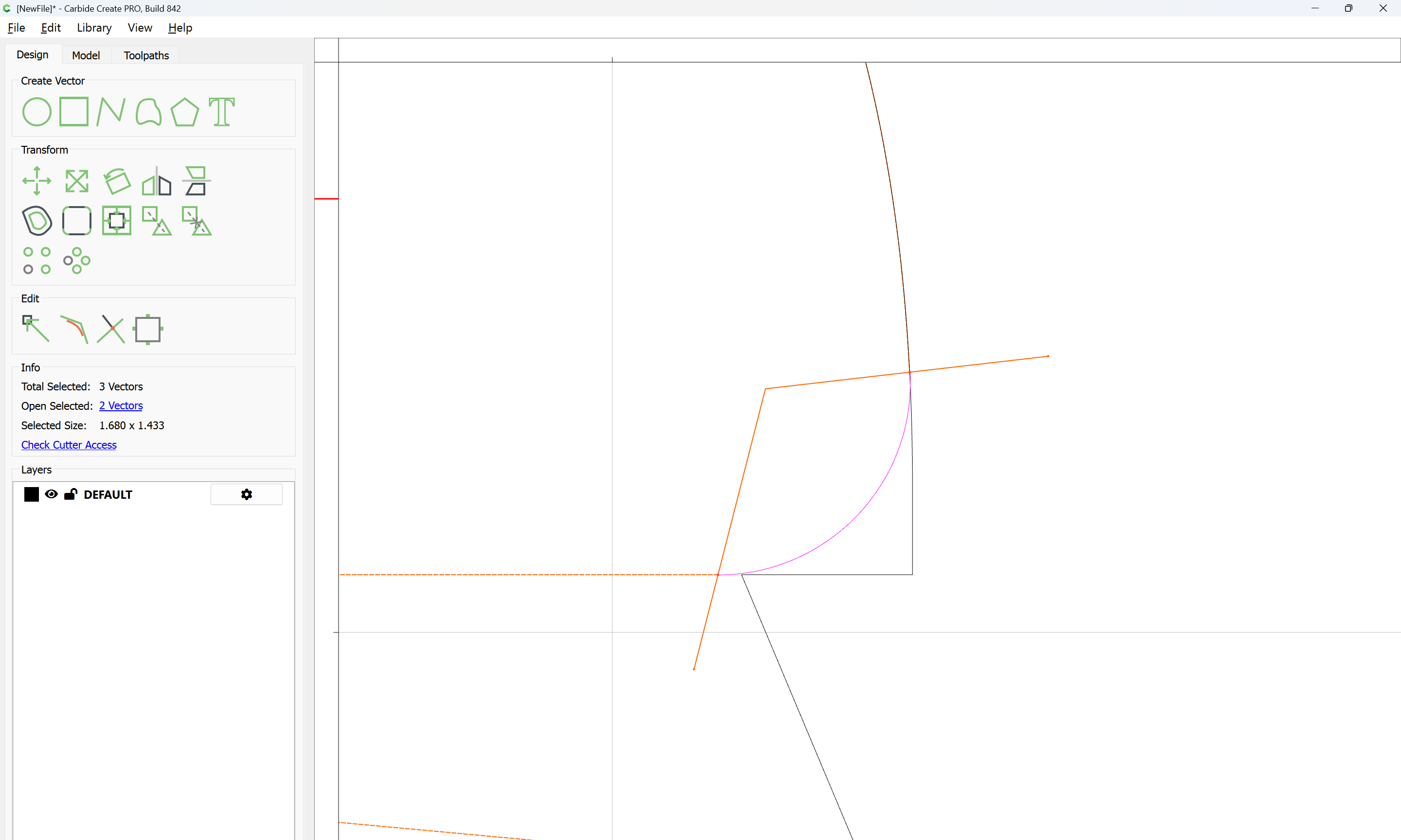

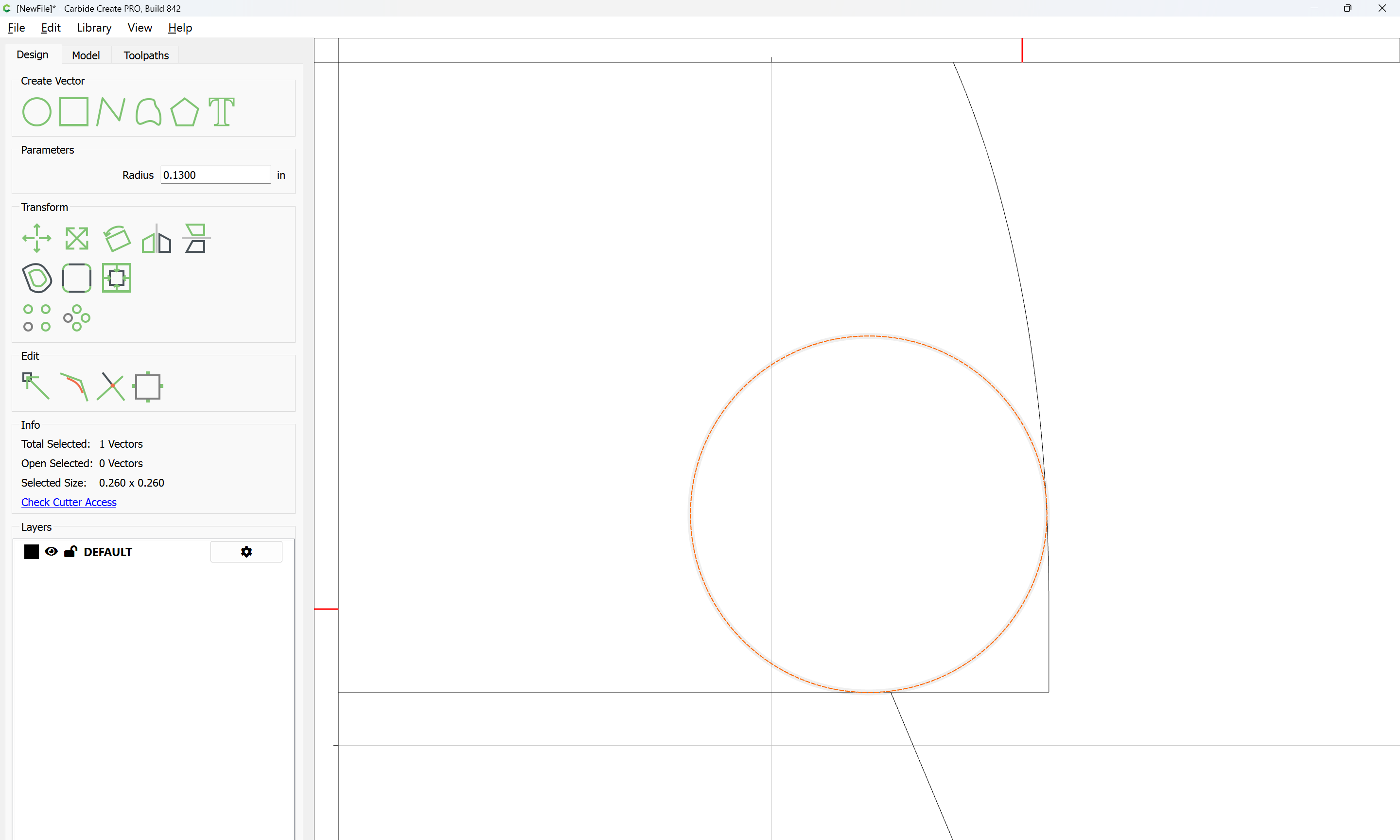

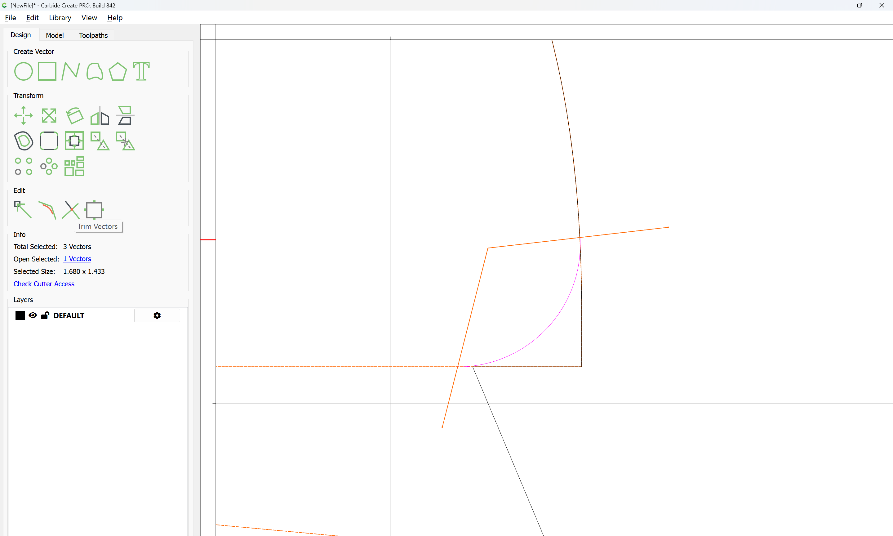

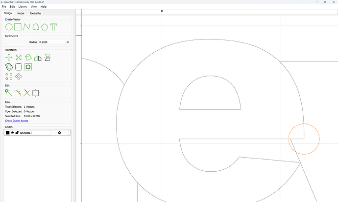

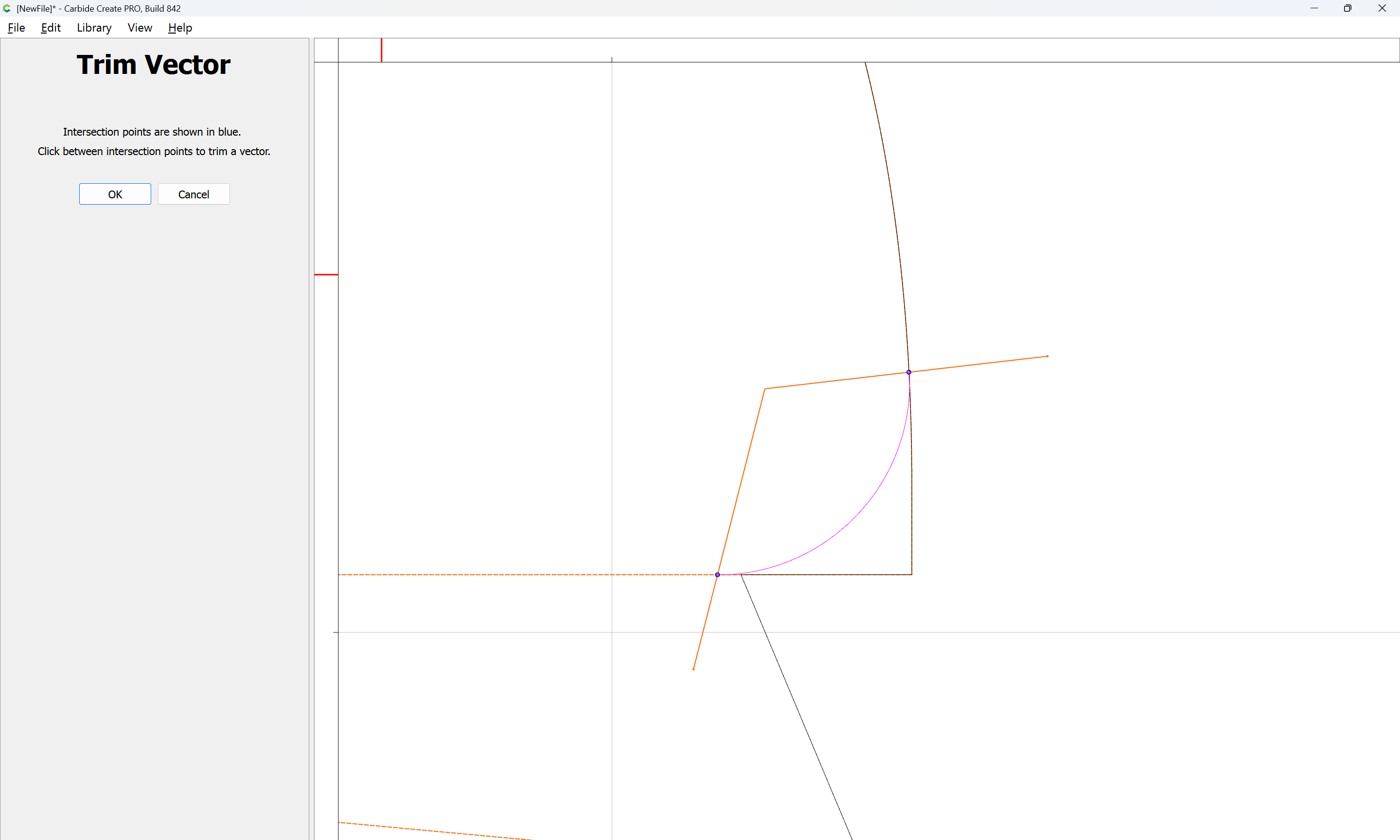

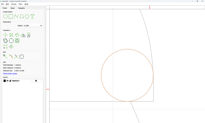

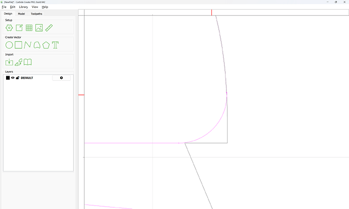

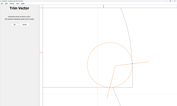

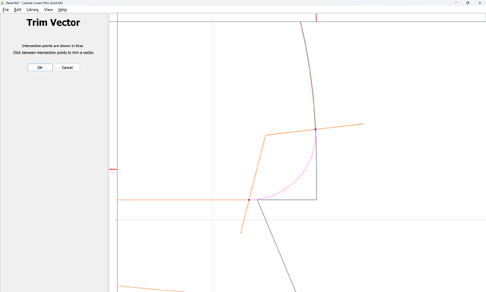

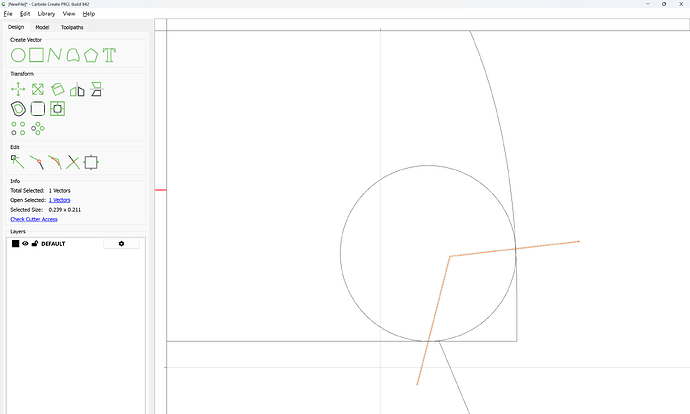

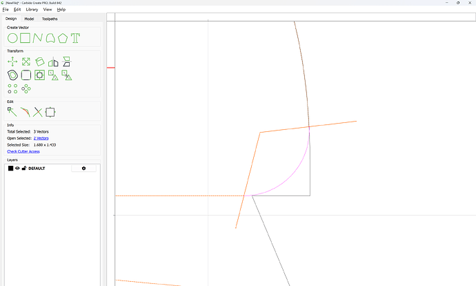

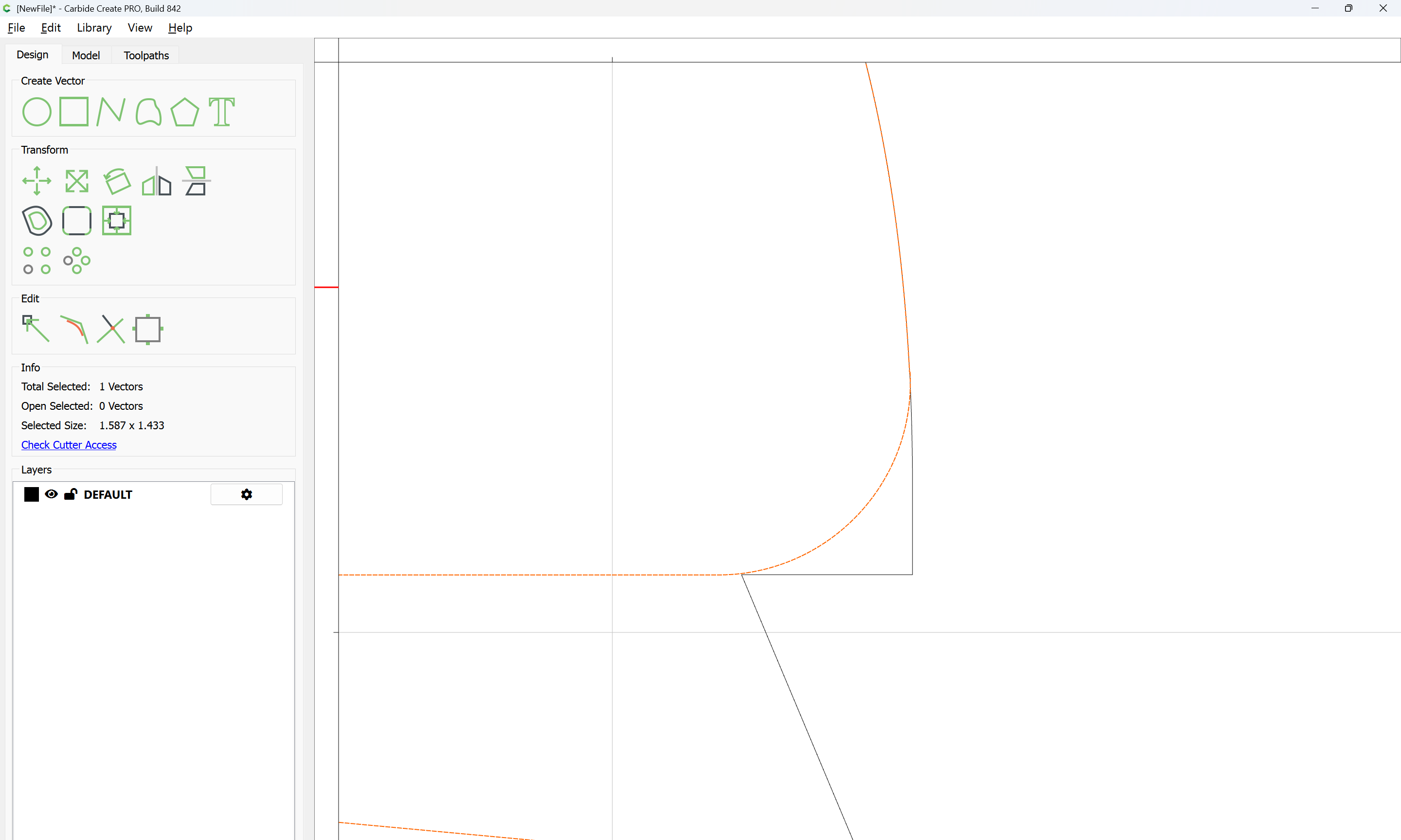

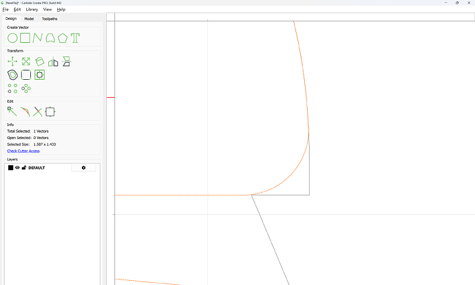

Where necessary, geometry should be rounded:

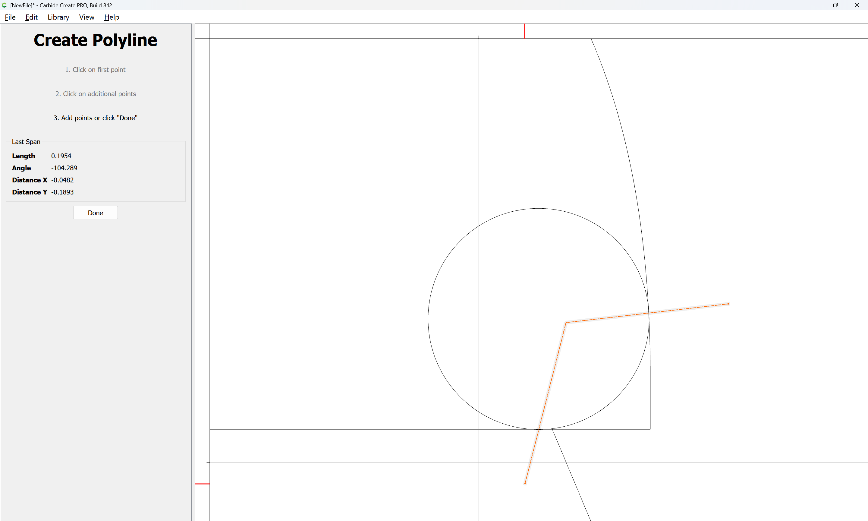

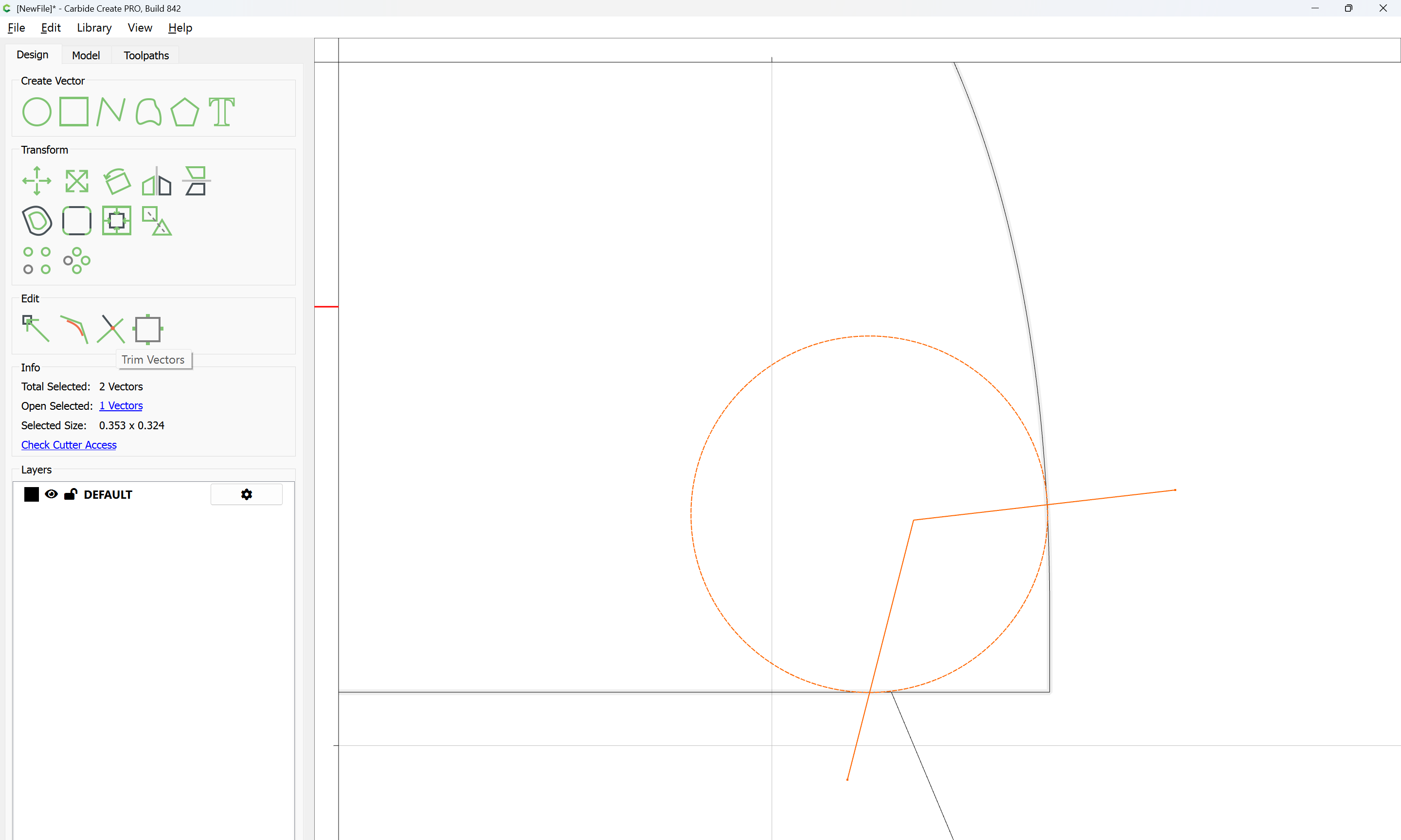

Since letterforms rarely have straight lines which are needed for the automatic techniques to work, the notch where the e fits to the y will need to be rounded manually (arguably, the latter should have been positioned to preclude this necessity).

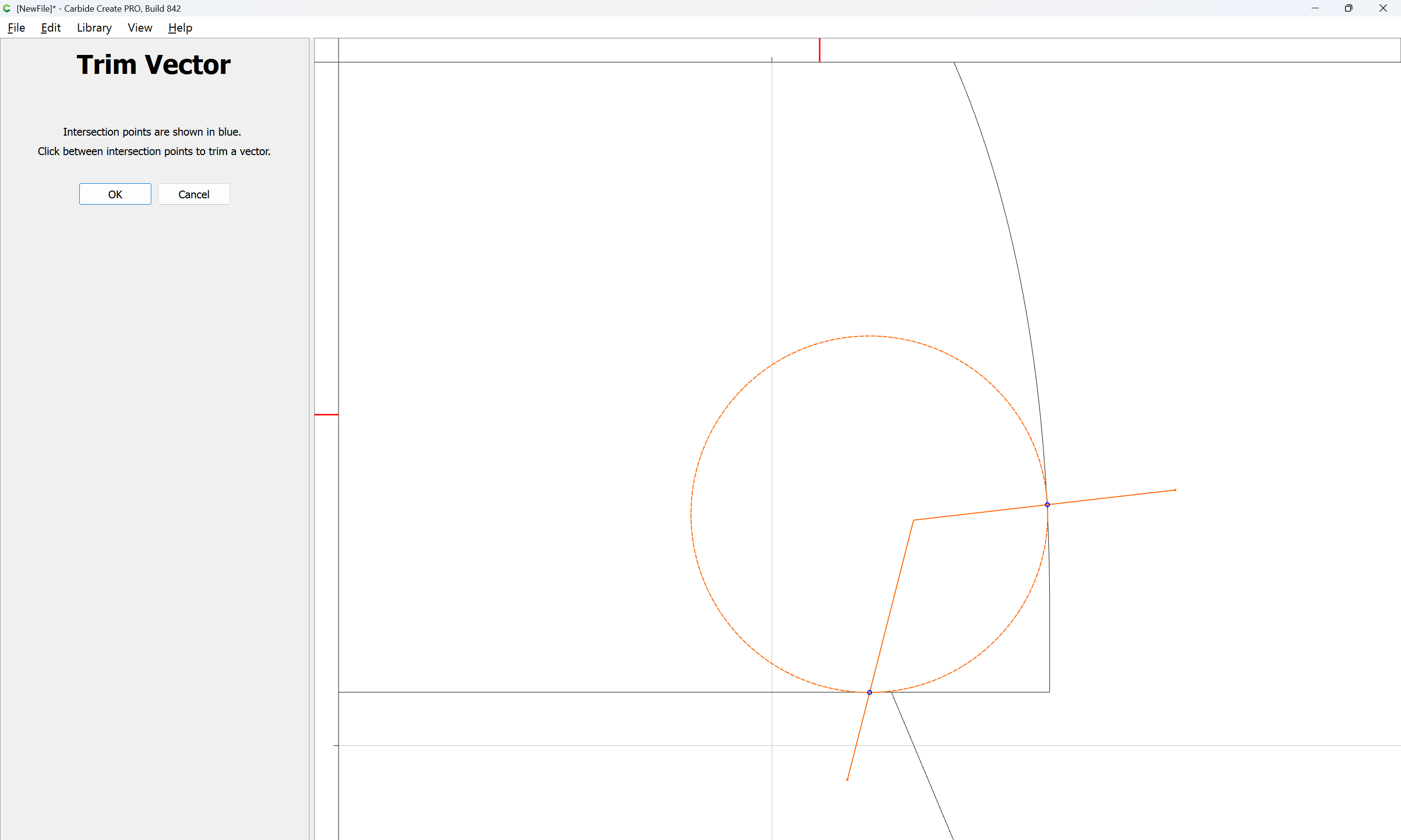

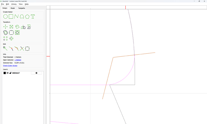

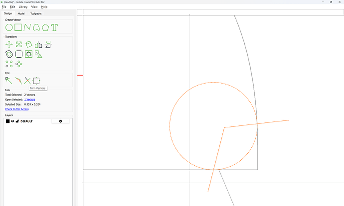

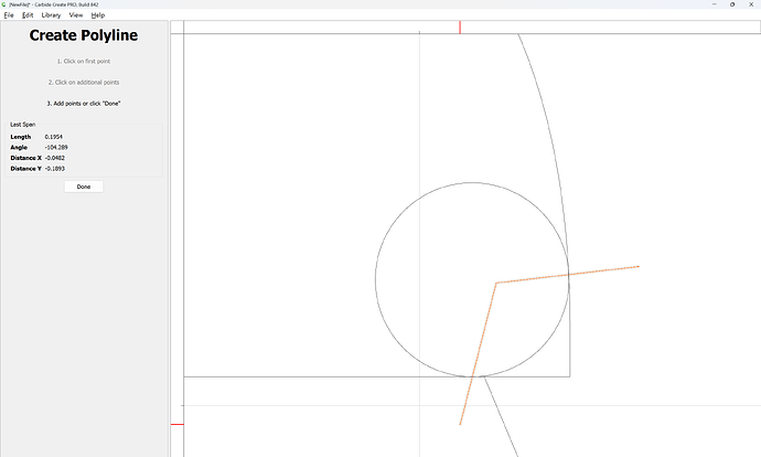

Draw a circle of a suitable size:
and position it so as to either use as a guide for Node Editing, or an element for Trim Vectors:
for the latter, draw in geometry to define where things will meet:
Done

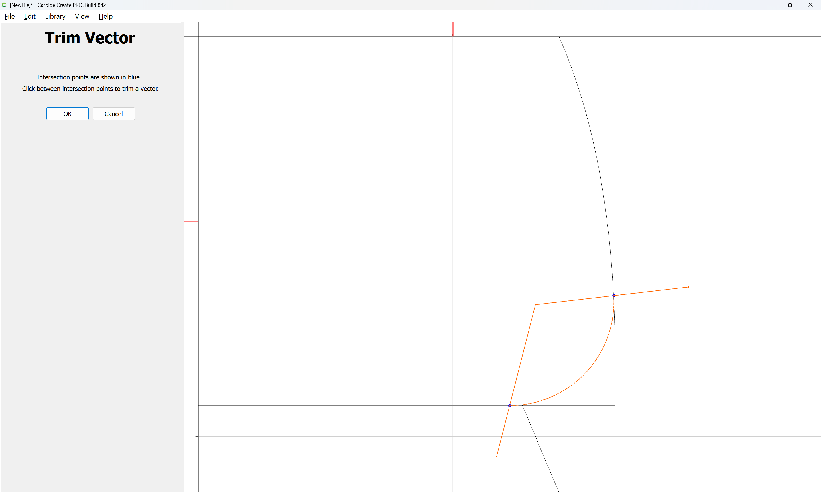

Then add one of the elements to the selection:

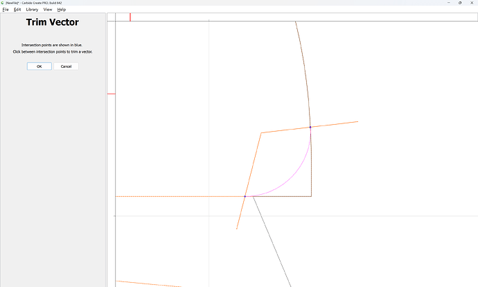

OK
and repeat for the other element:
OK

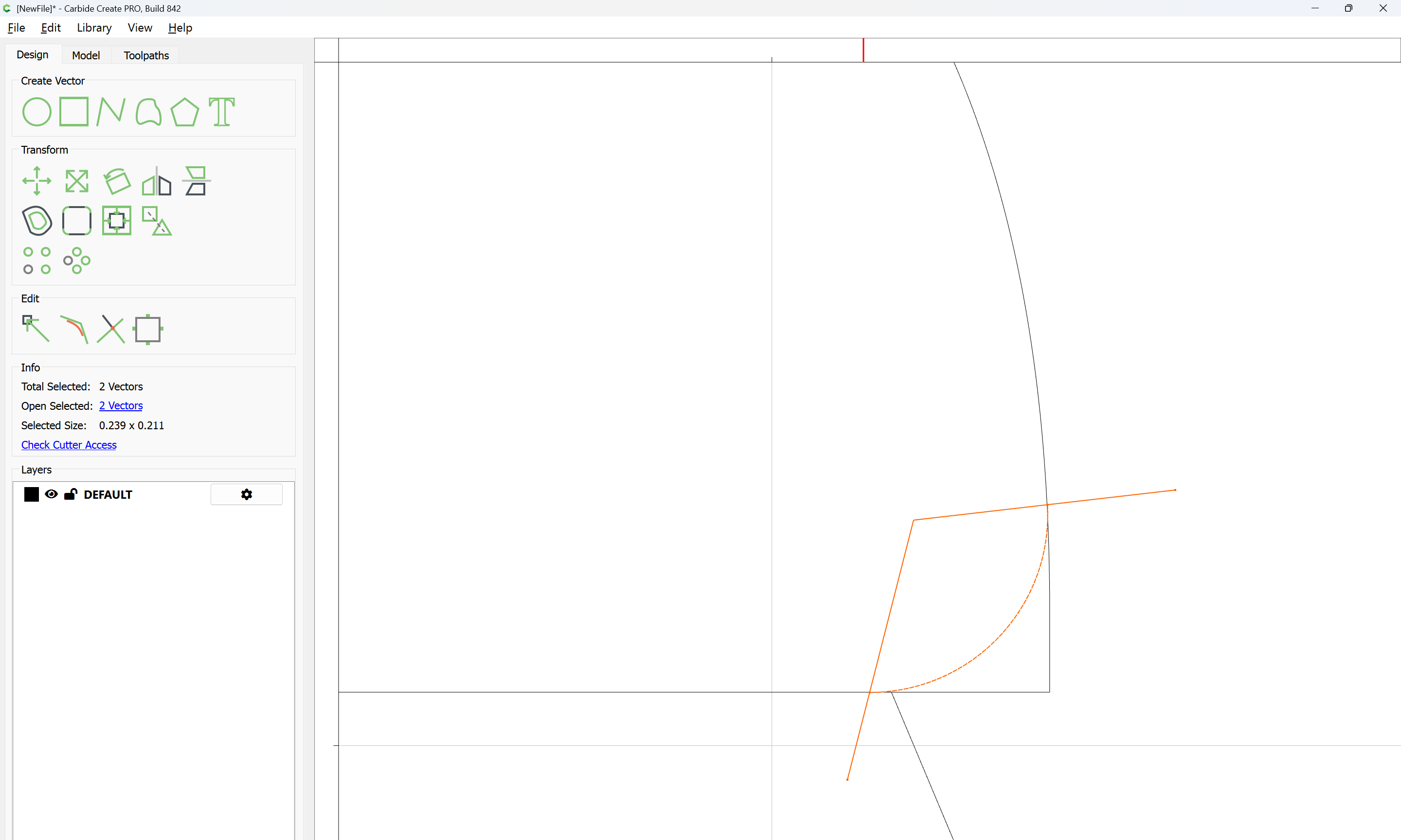

Delete the added geometry:

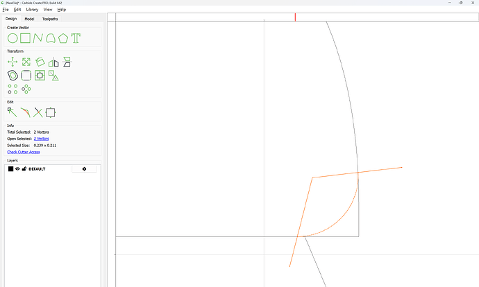

Then select the two open vectors:
and Join Vectors
The letterforms may now be spaced out and cut out of a suitable thickness of material with suitable toolpaths — this is left as an exercise for the reader — if any difficulties are encountered, upload the file and we will look into it.
