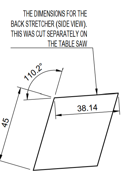

Q: cutting angle - how?

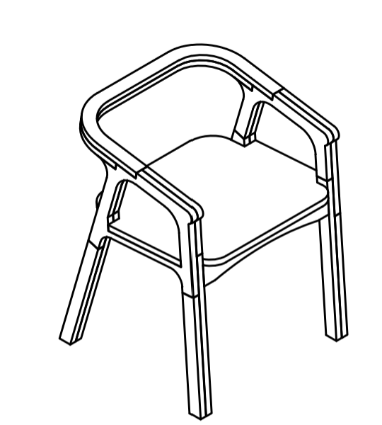

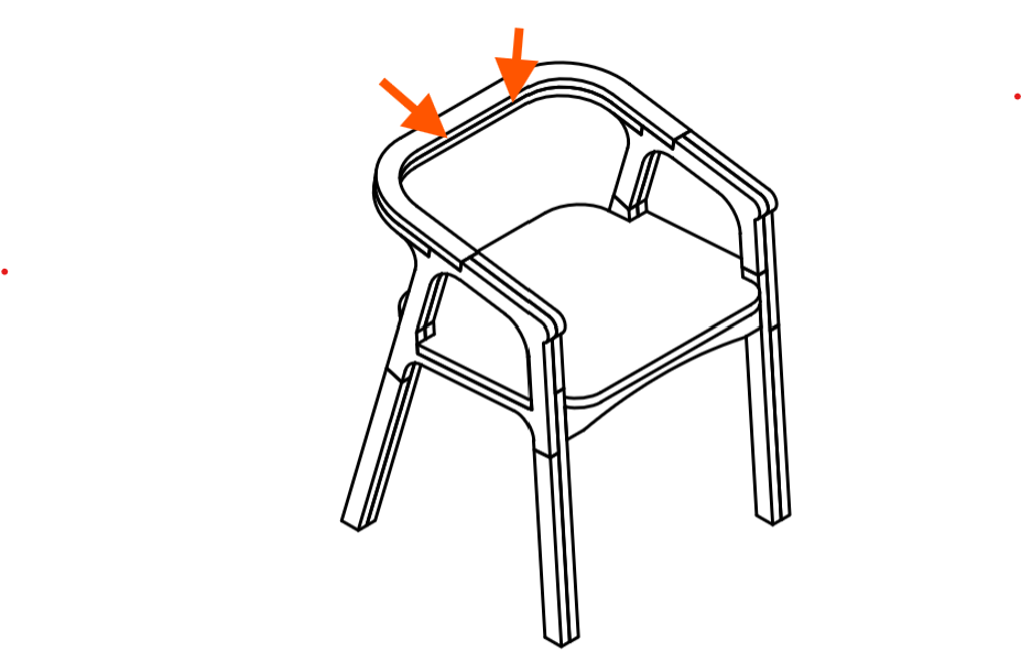

I did some similar chairs like this:
Now when one leans back at exactly that edge it hurts:
Now the Swedish Maker -where I got these images from, the chairs I made are from another place- suggests:
I would not use a band saw, 1. I do not have one, and 2. it would be a breach in tool sets.
Ideas how to proceed?

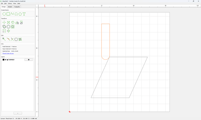

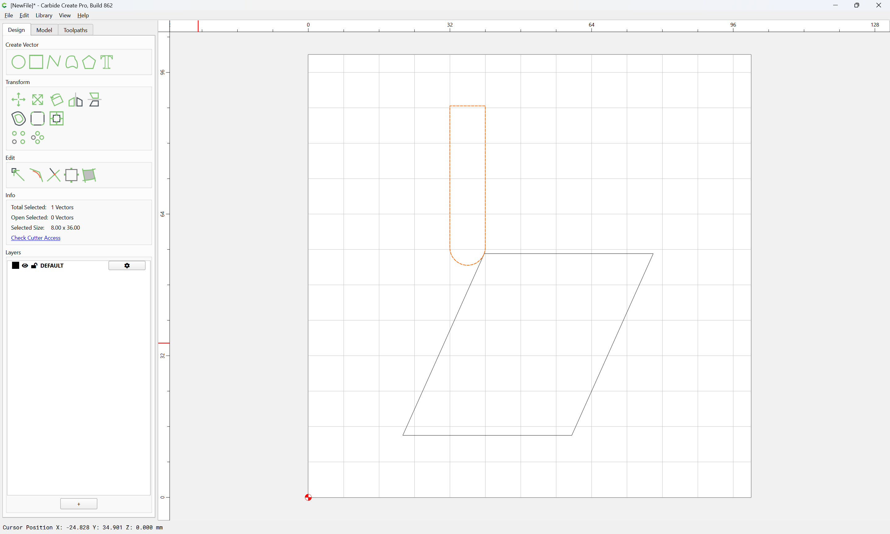

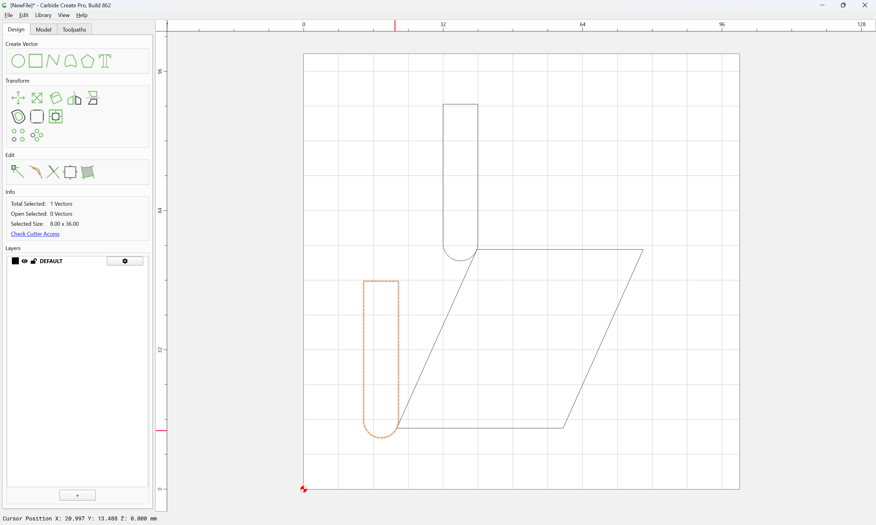

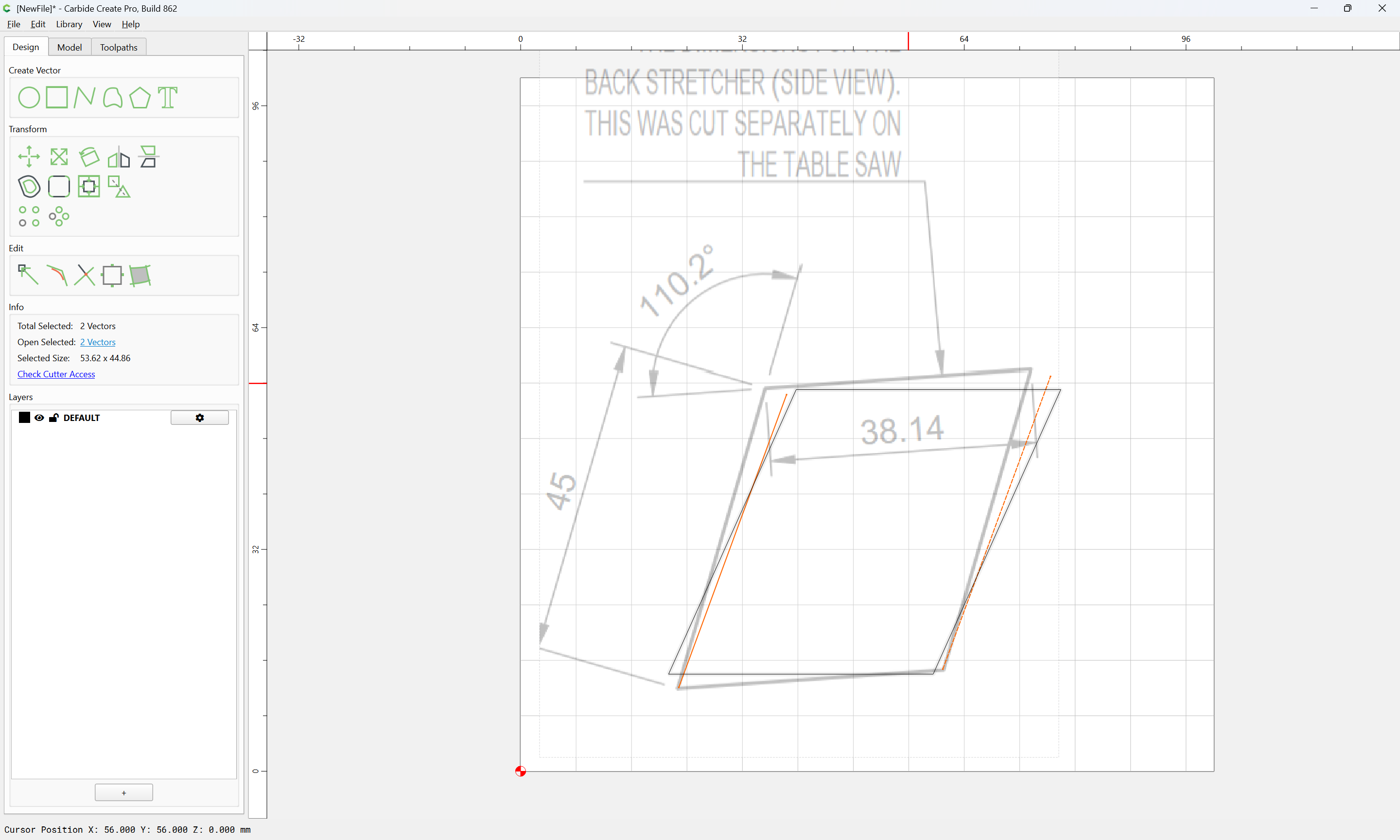

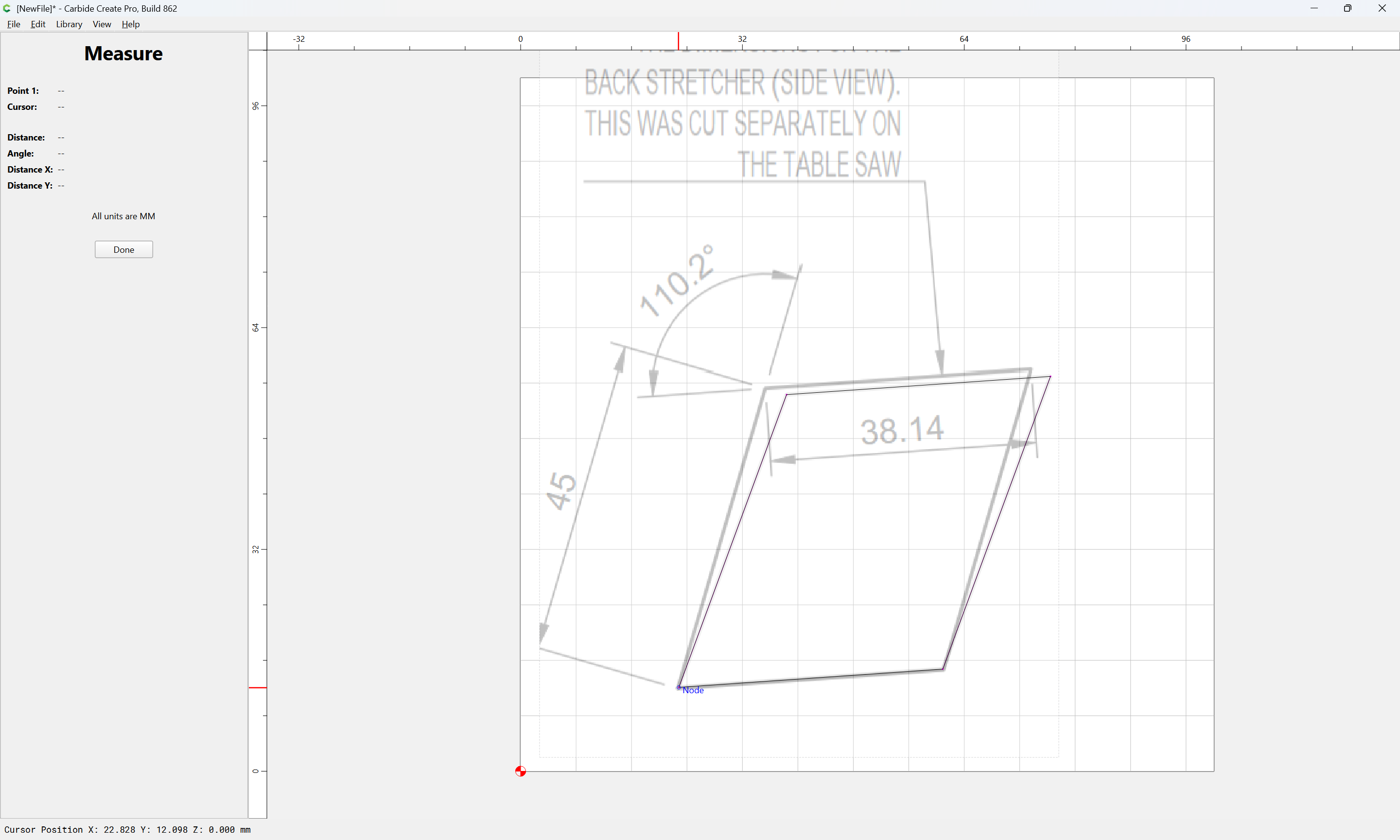

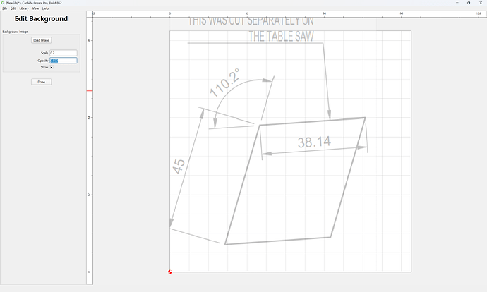

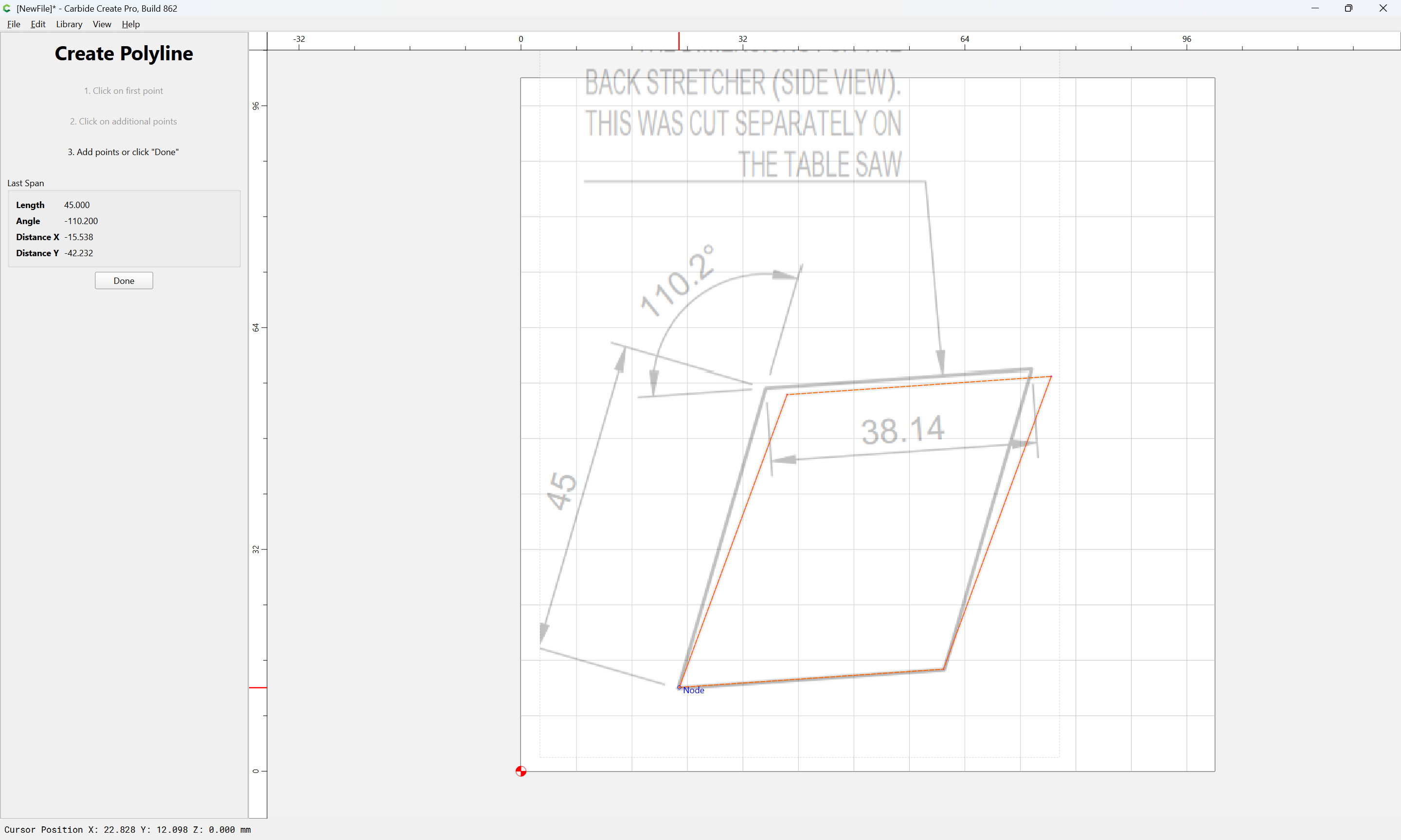

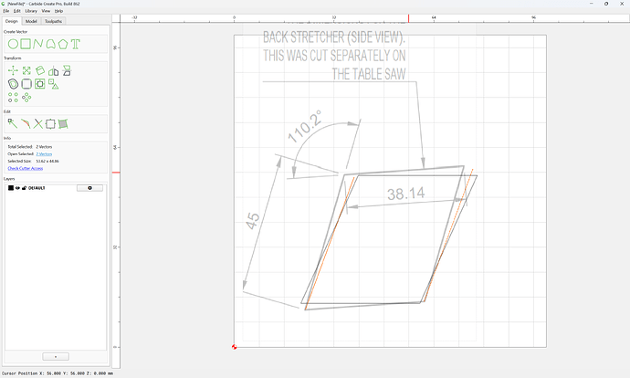

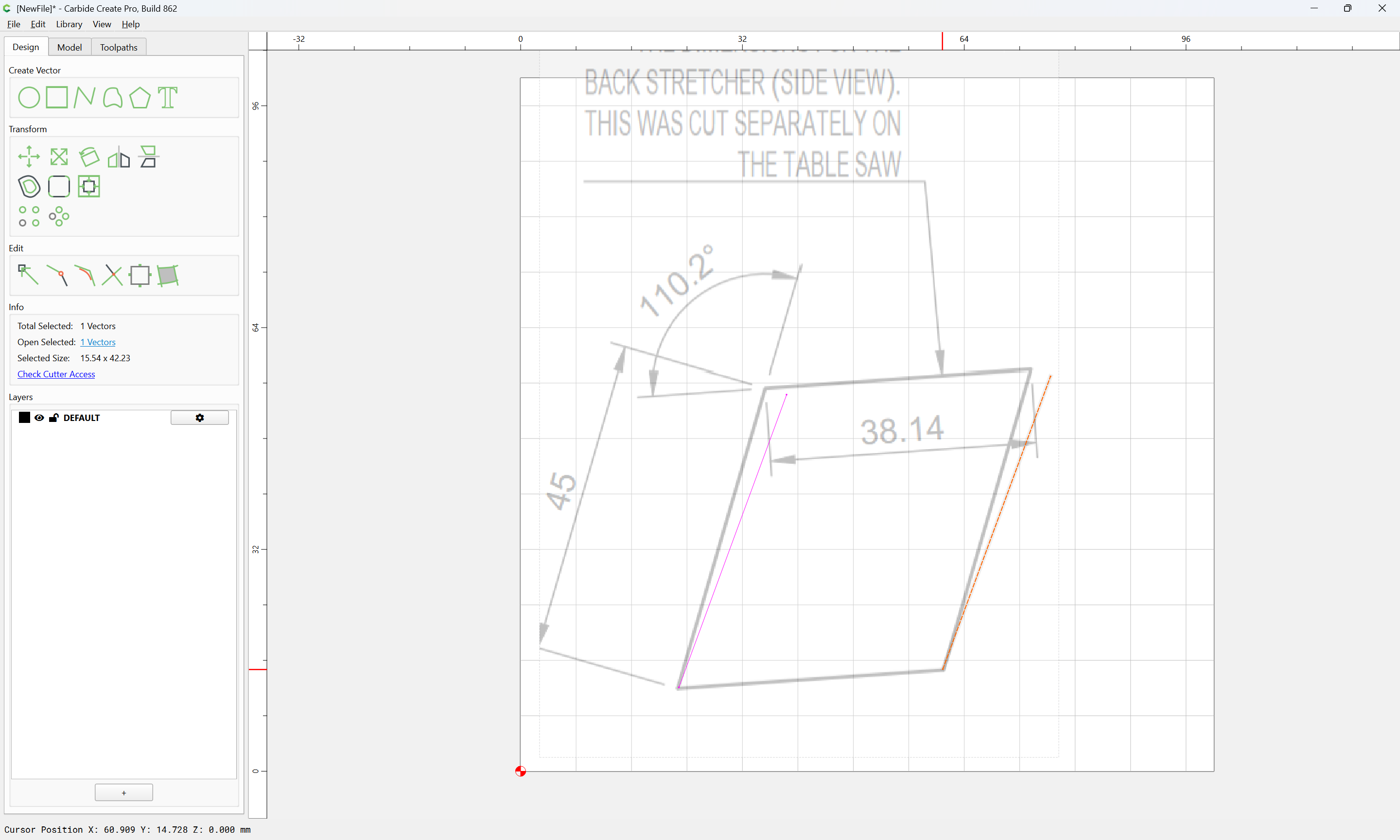

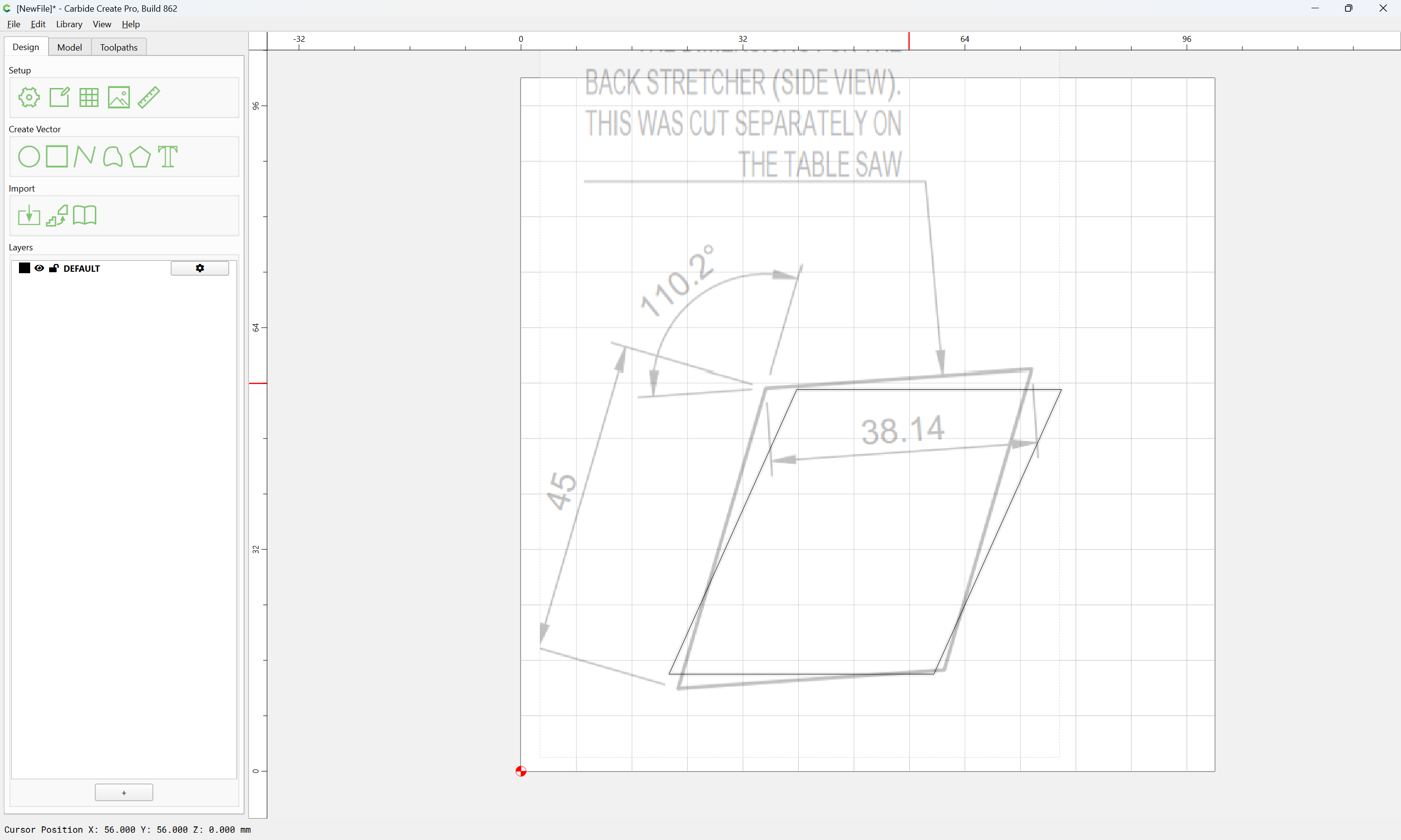

that said, one could either model this in 3D (if one uses 3D CAD/CAM or has Carbide Create Pro) or draw things up in profile and ease the edge w/ a series of passes w/ a ball-nose tool.

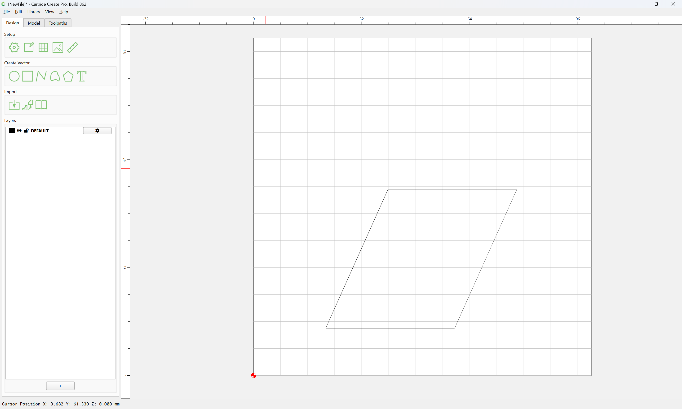

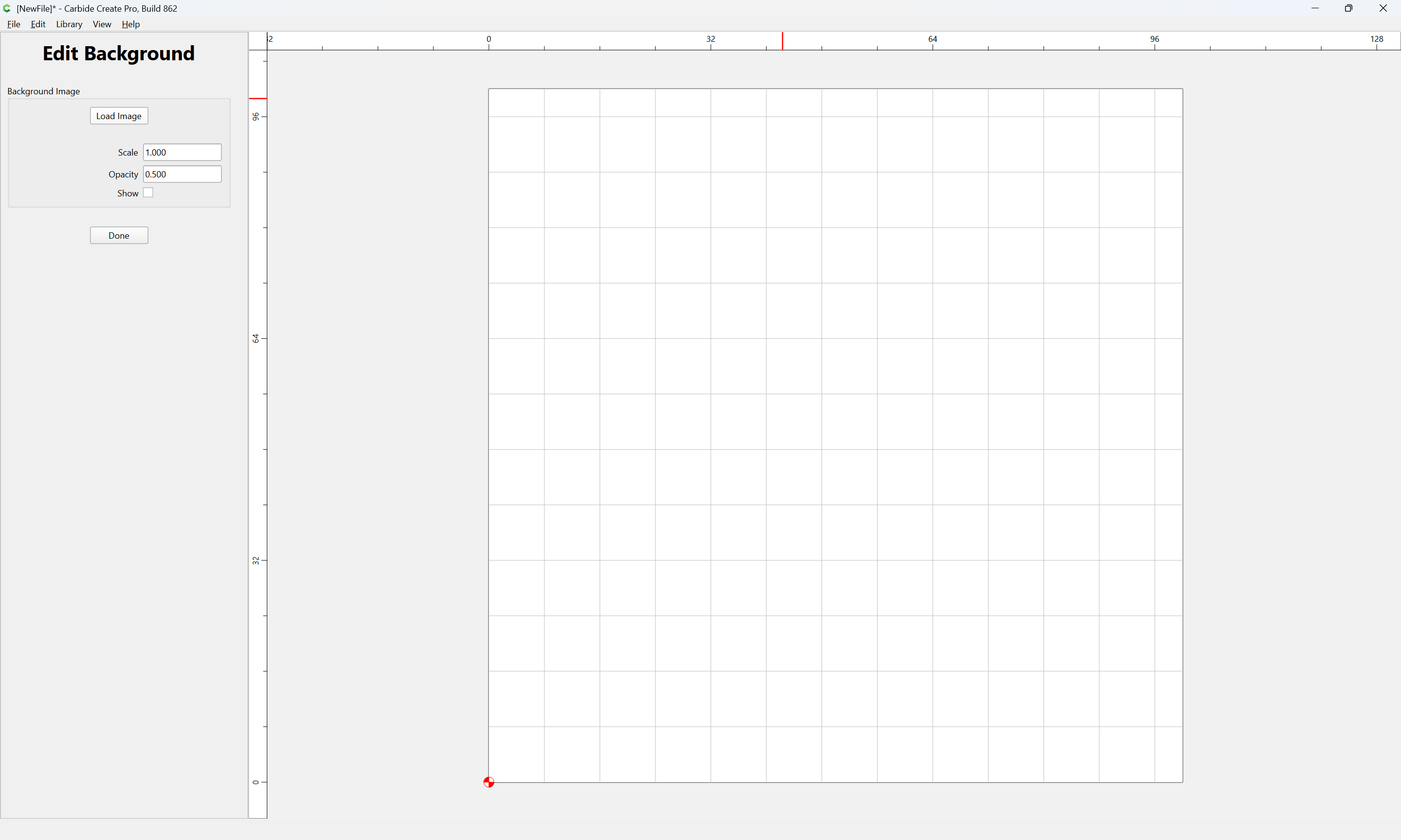

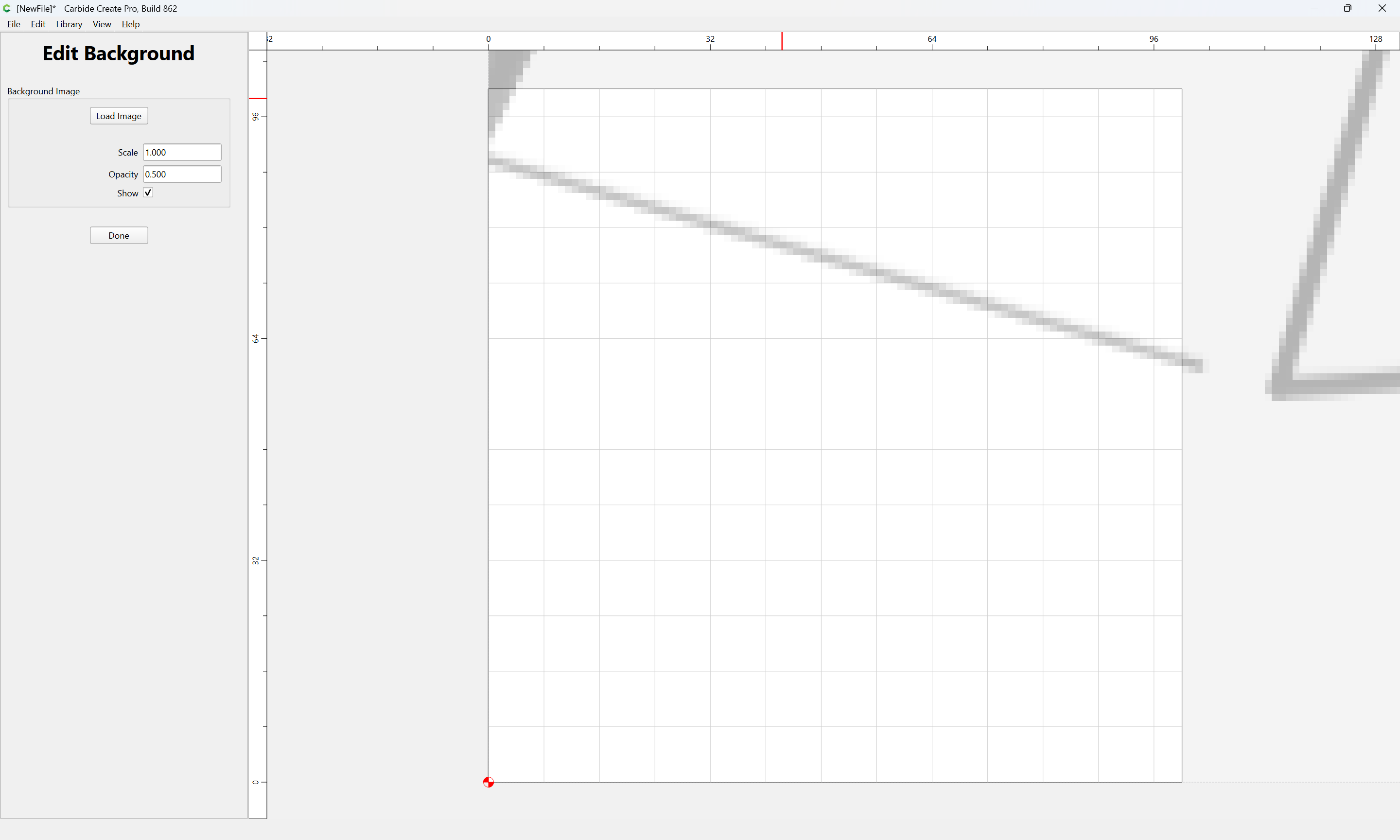

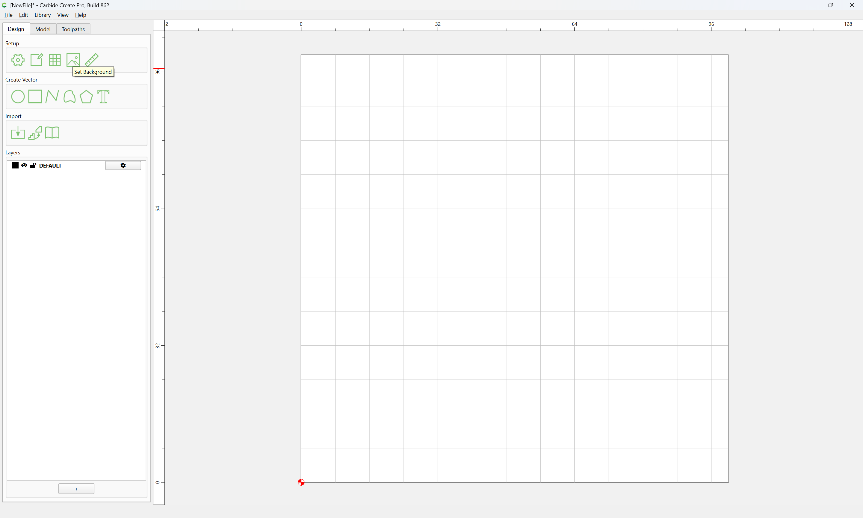

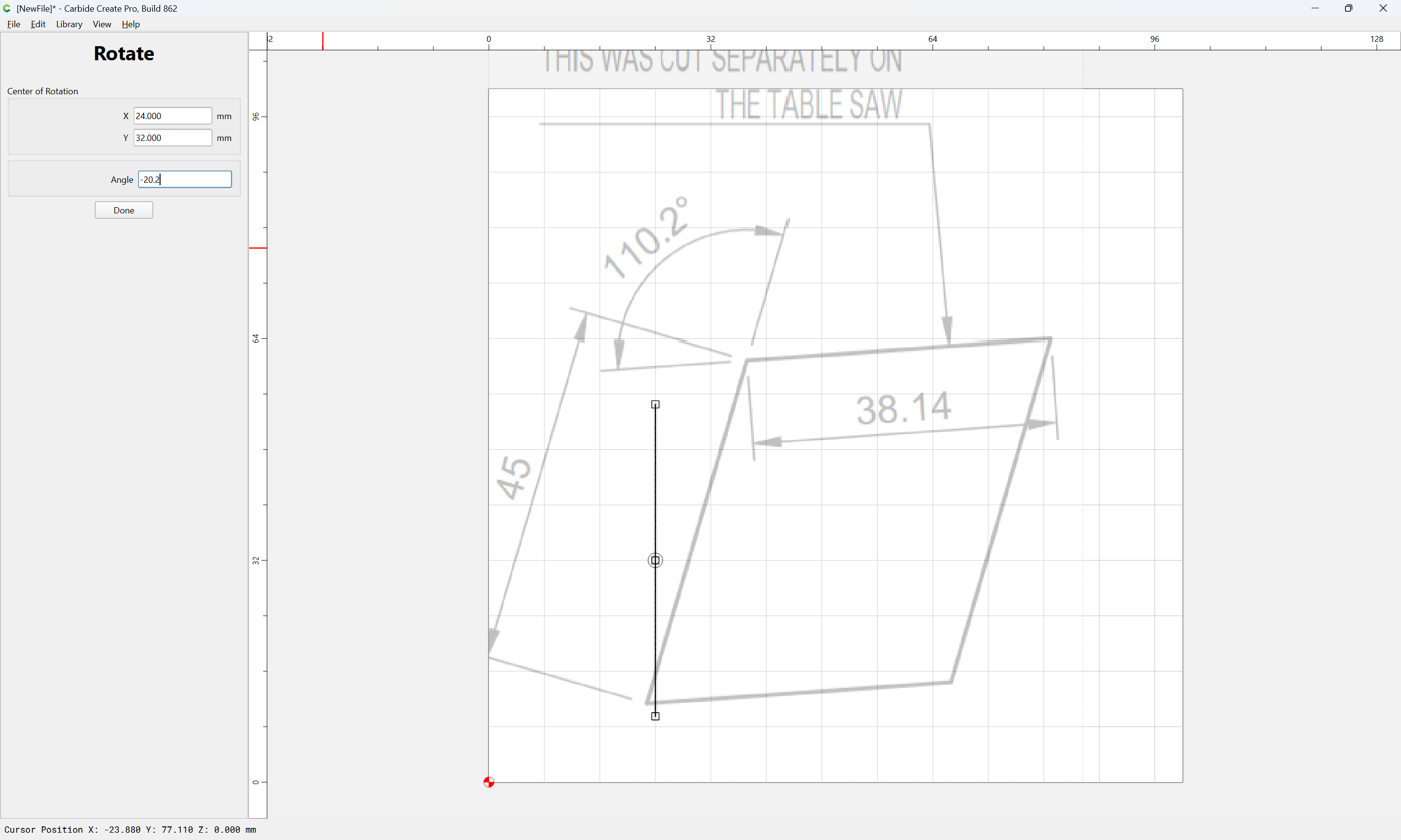

set up a file:

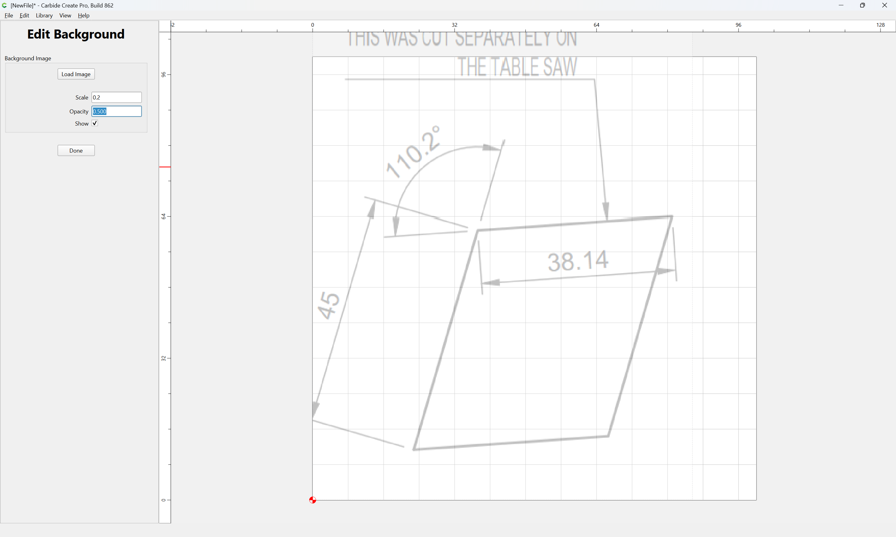

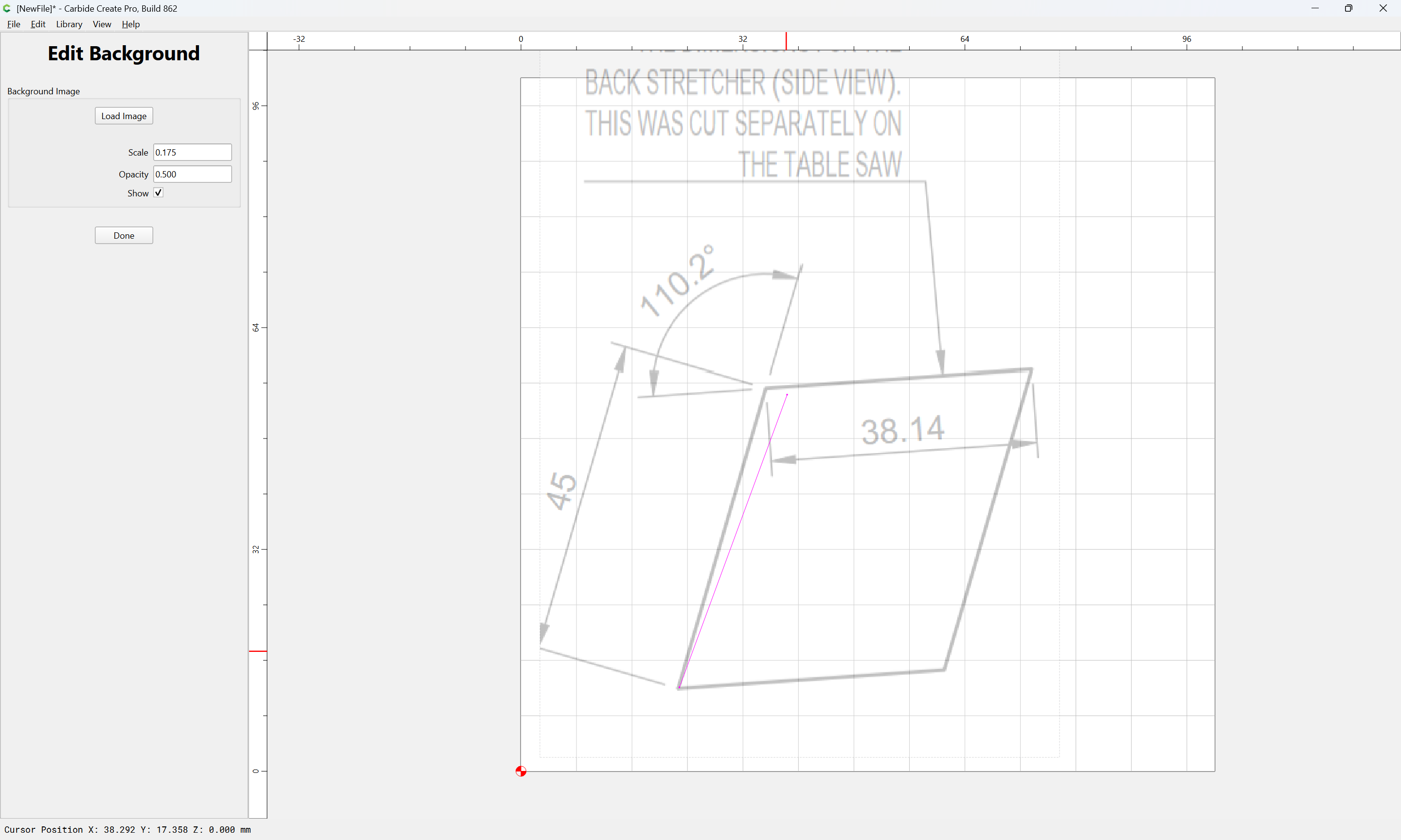

Set Background
Load Image
Adjust as necessary:

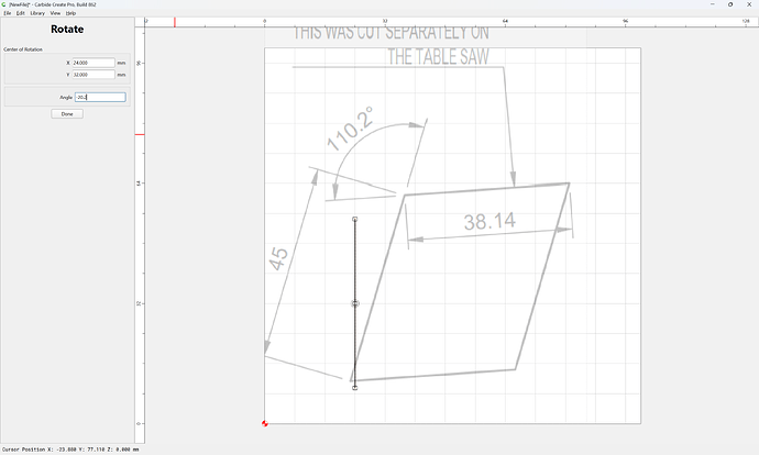

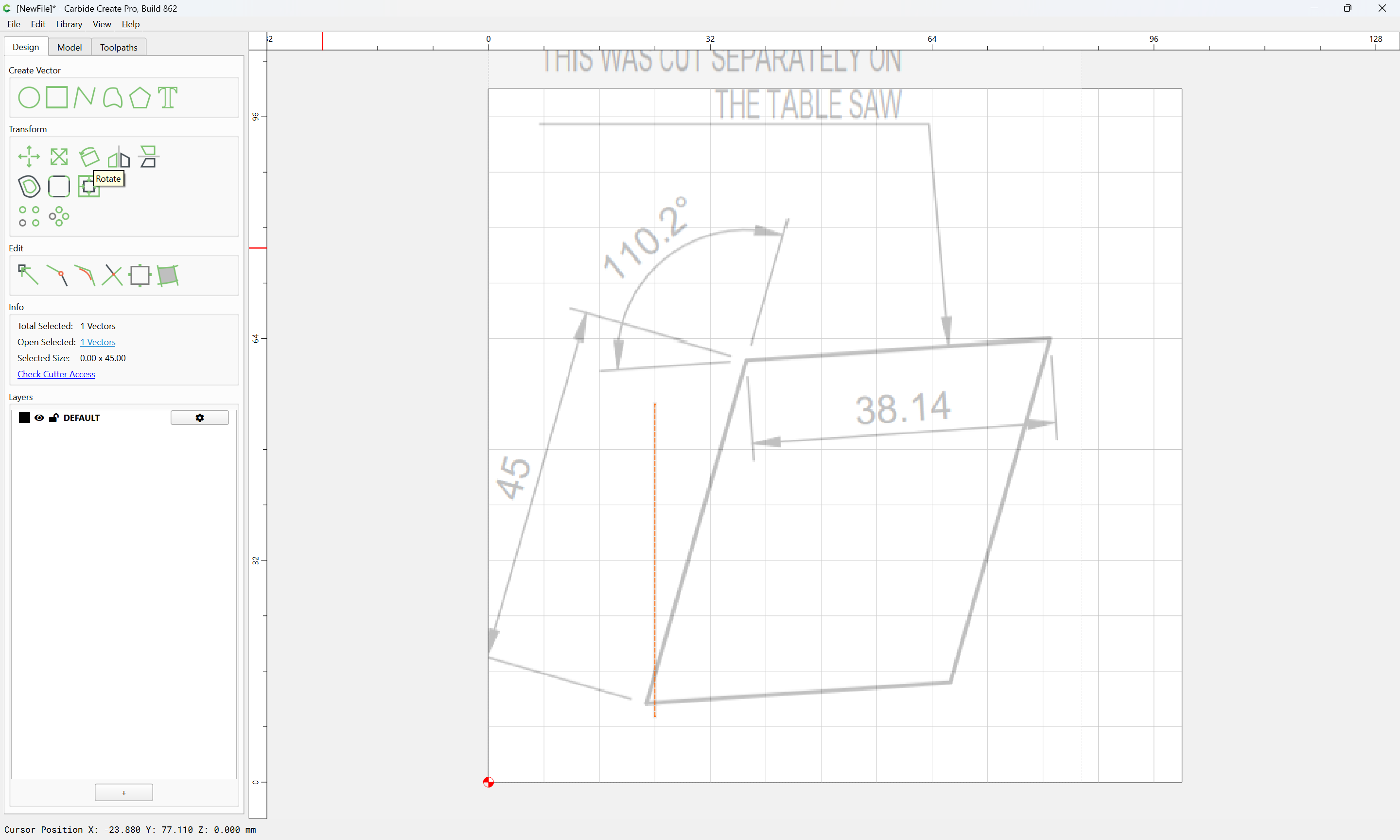

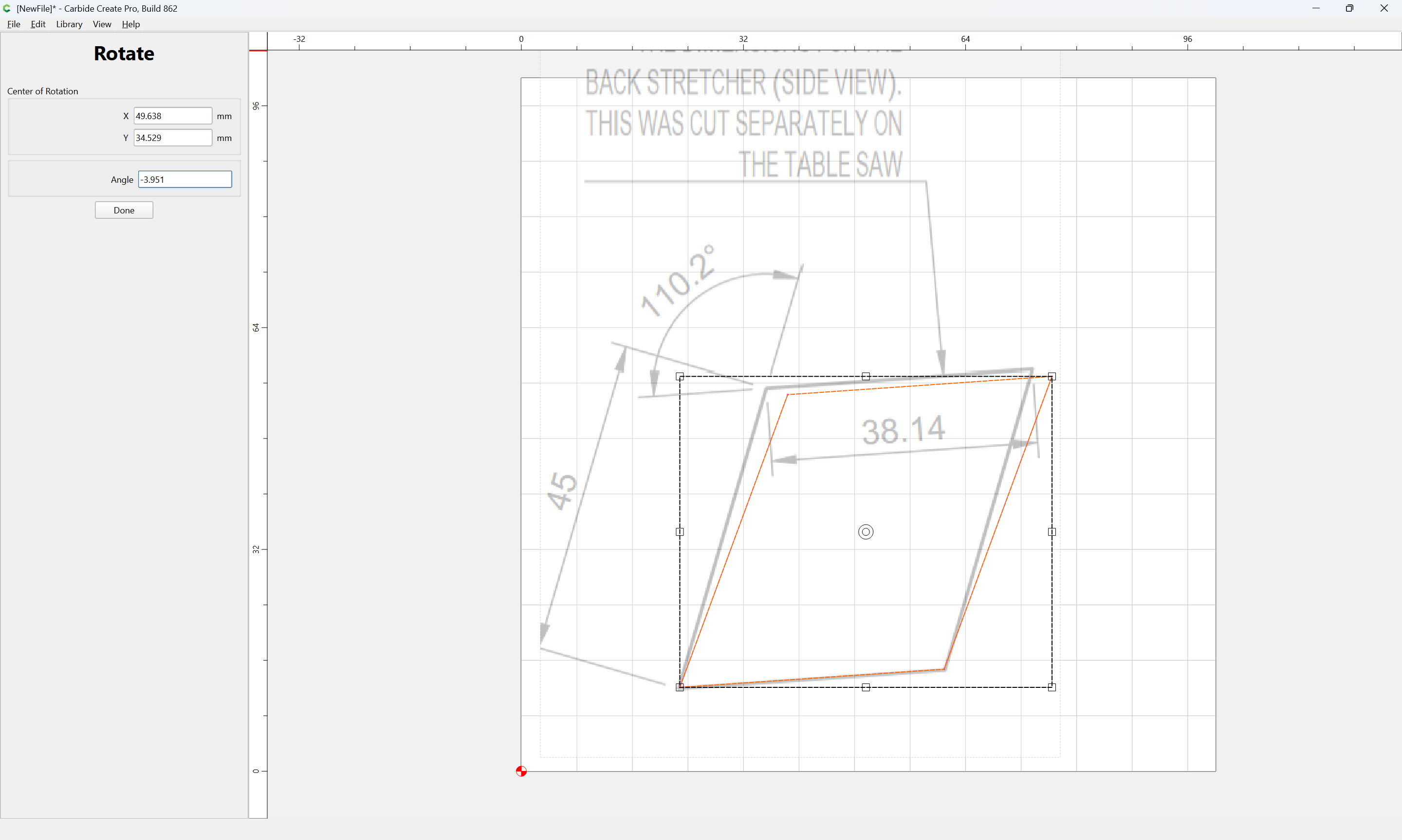

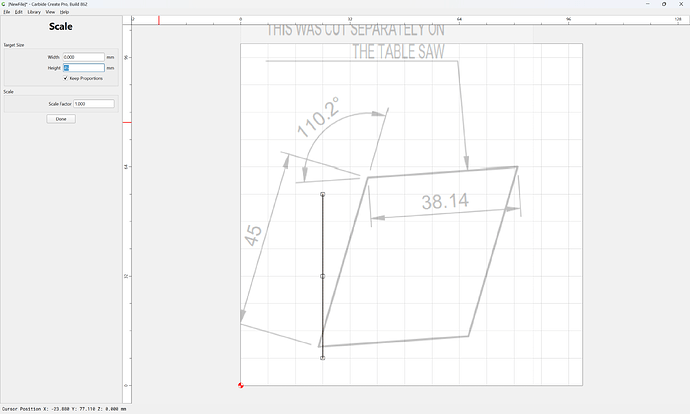

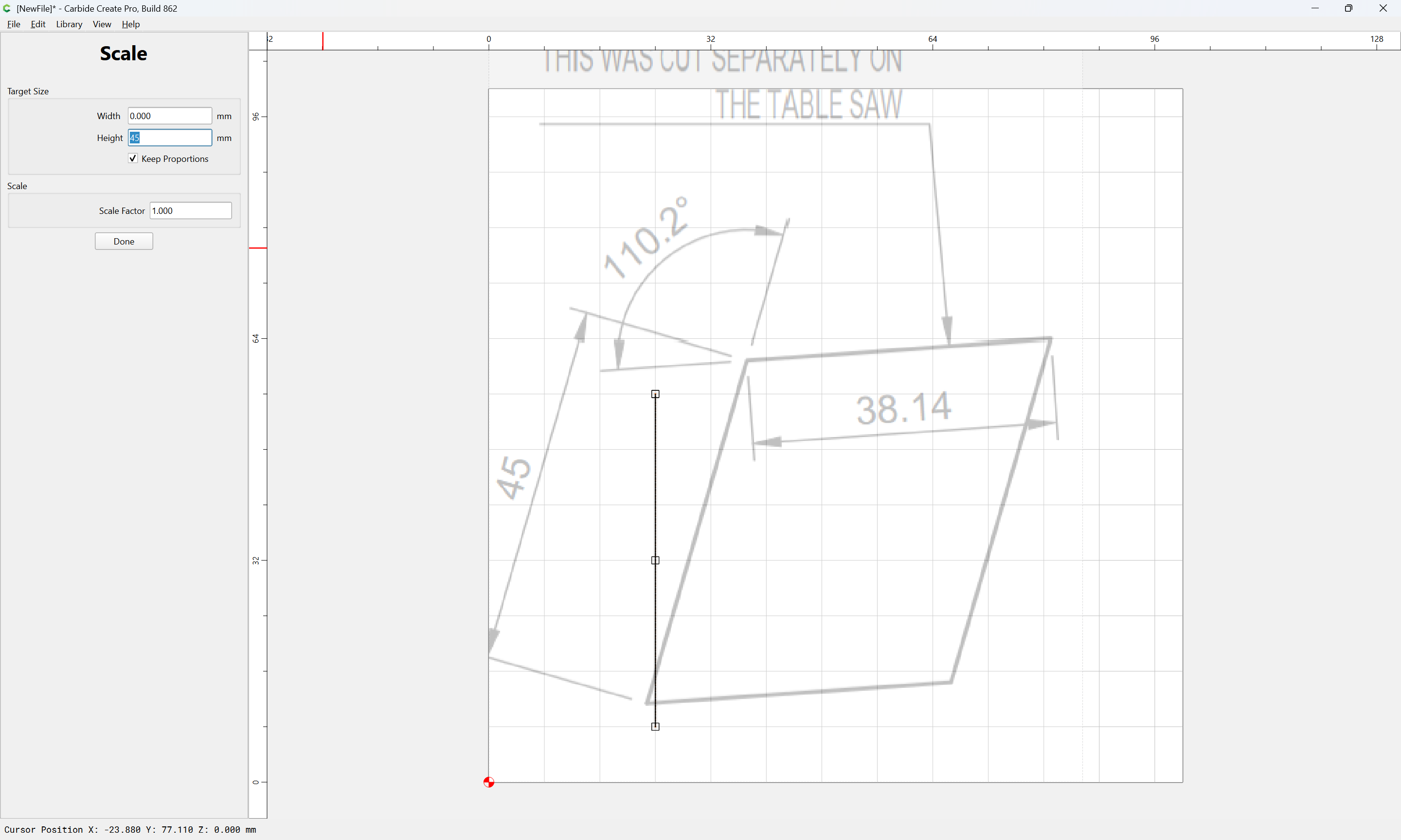

Draw a line of the requisite length:

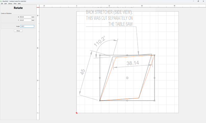

then rotate it:
and adjust as need be:

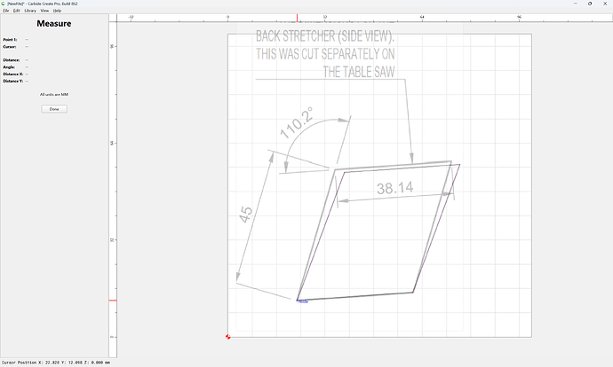

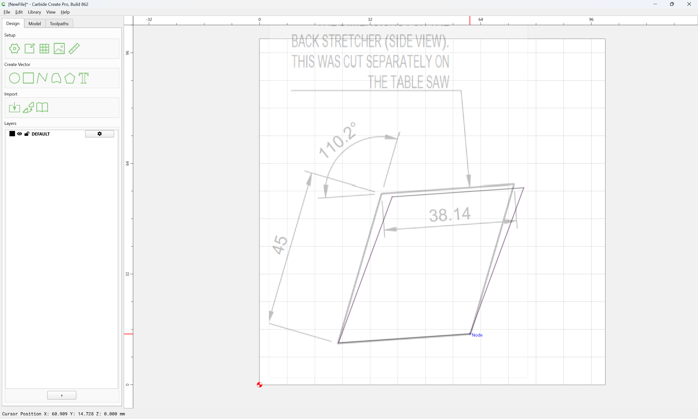

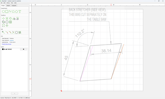

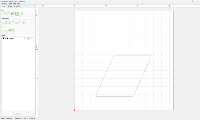

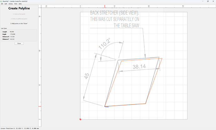

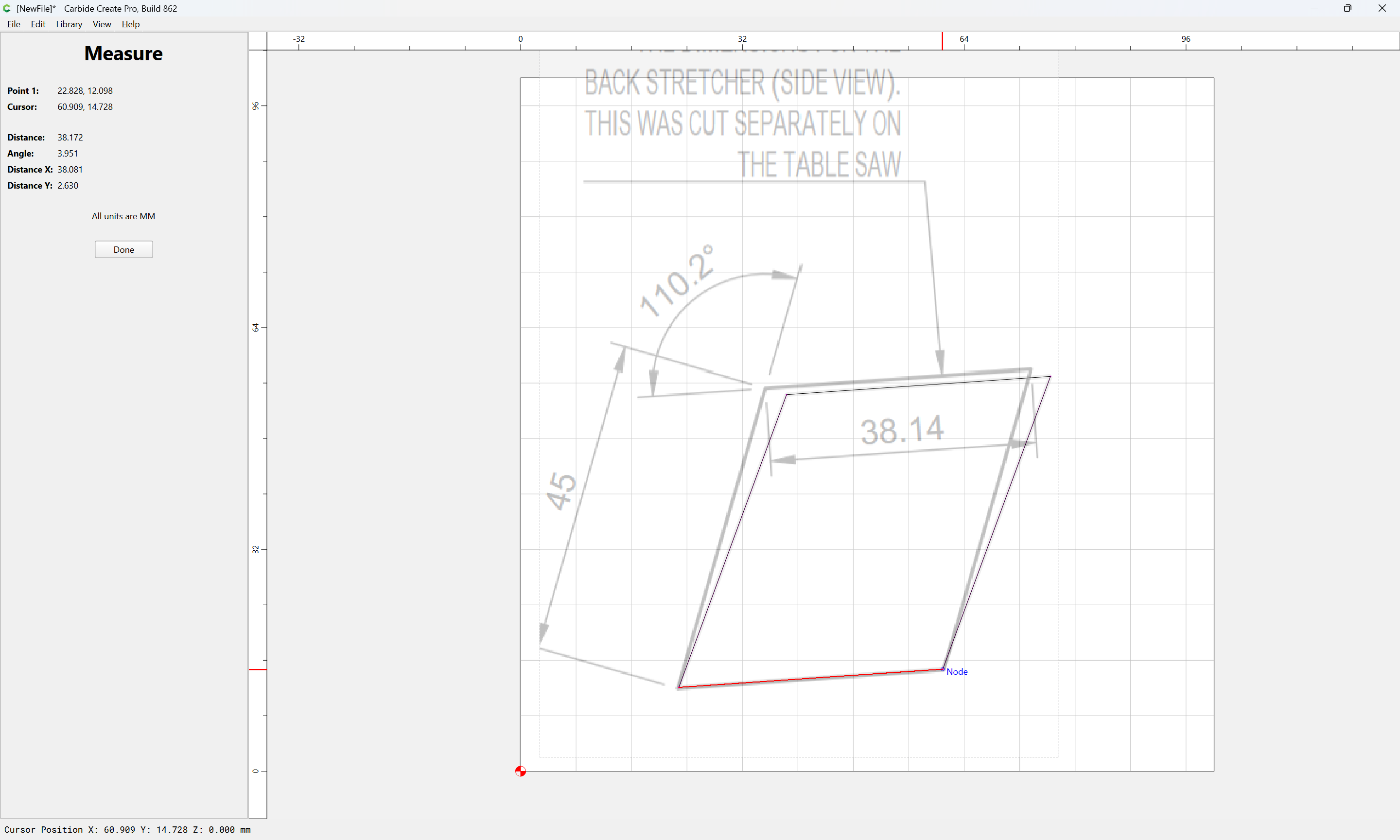

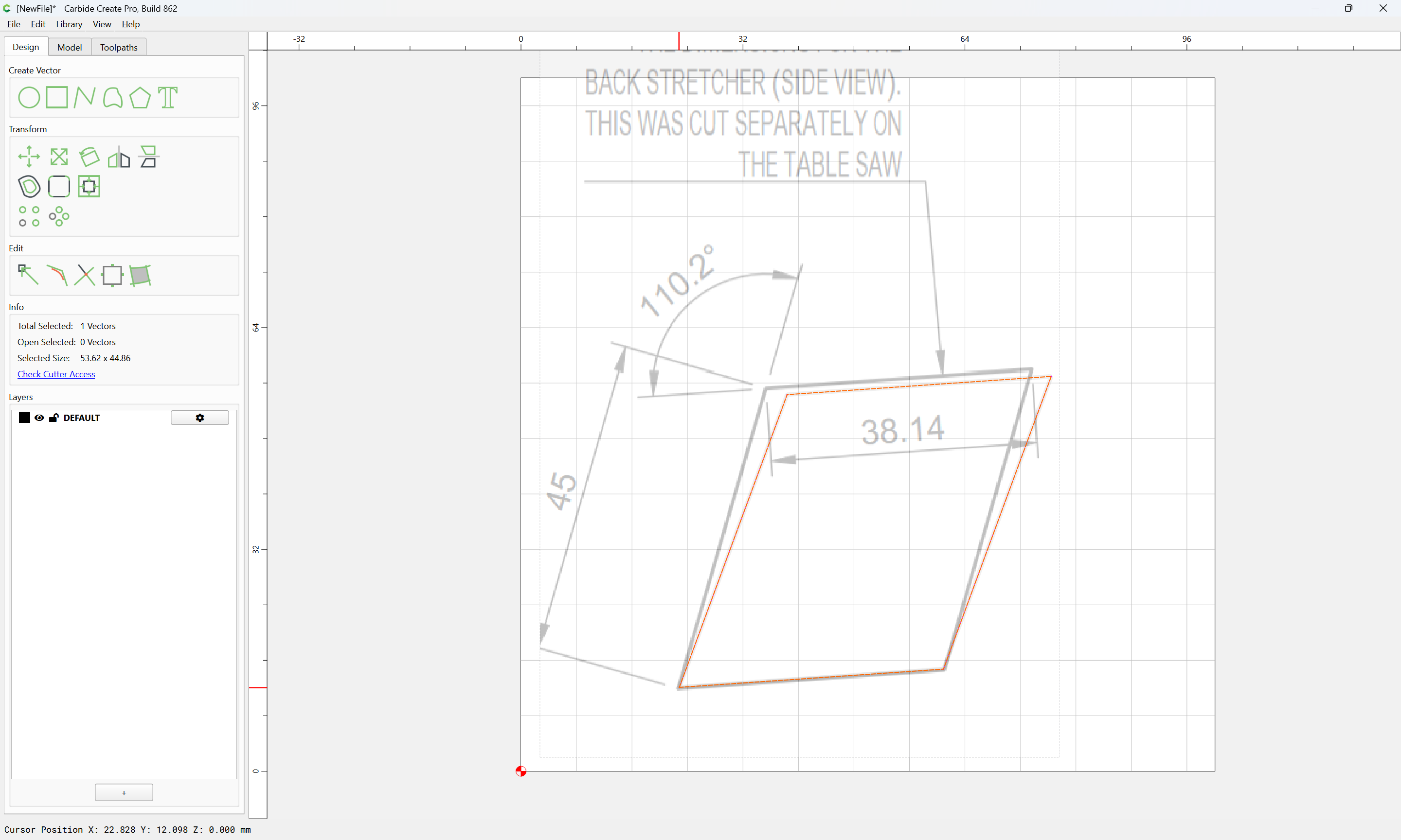

then draw the outline:

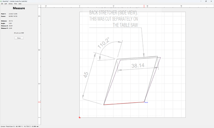

then measure to get the rotation:
Done
then rotate to flat:
then clean up:

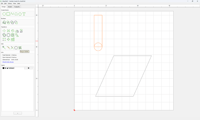

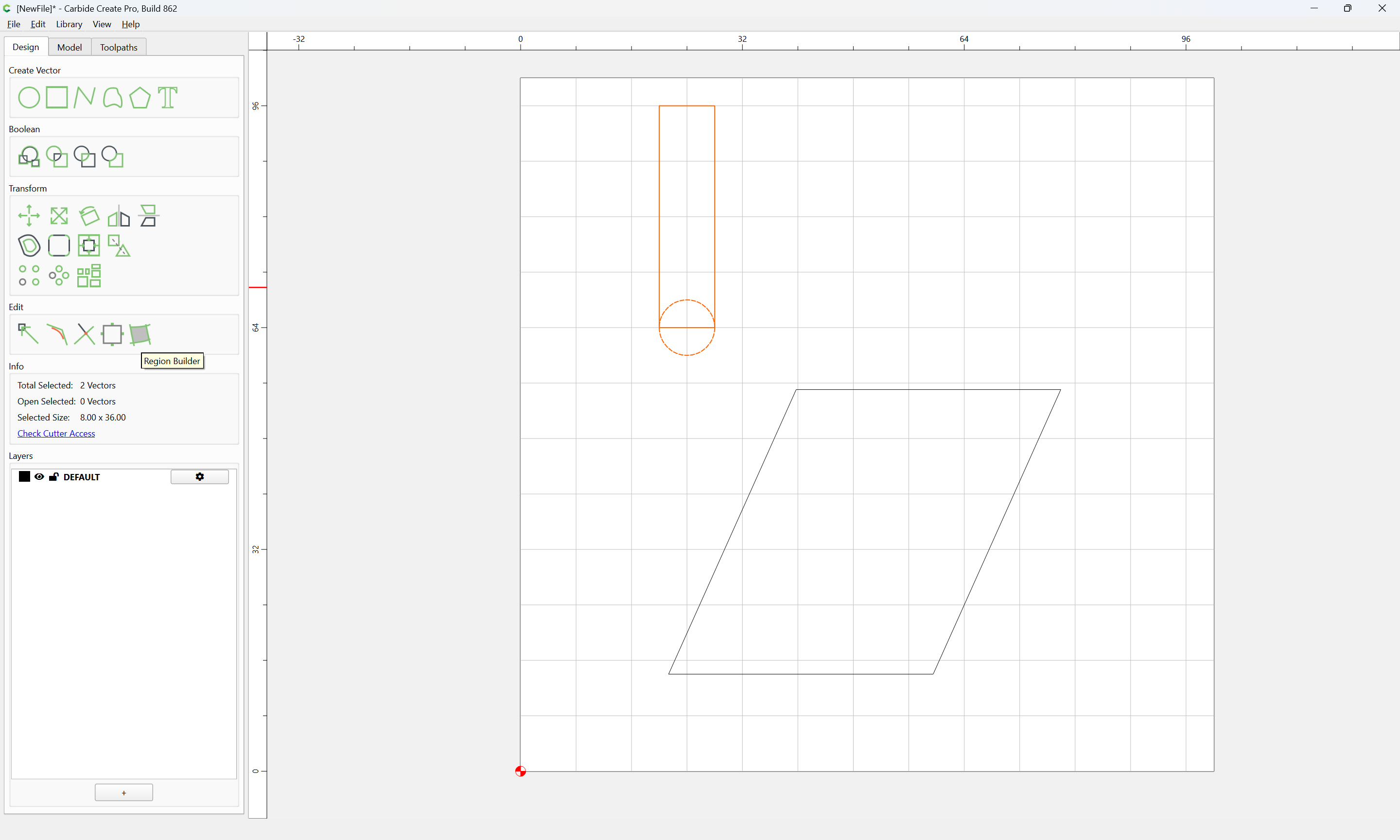

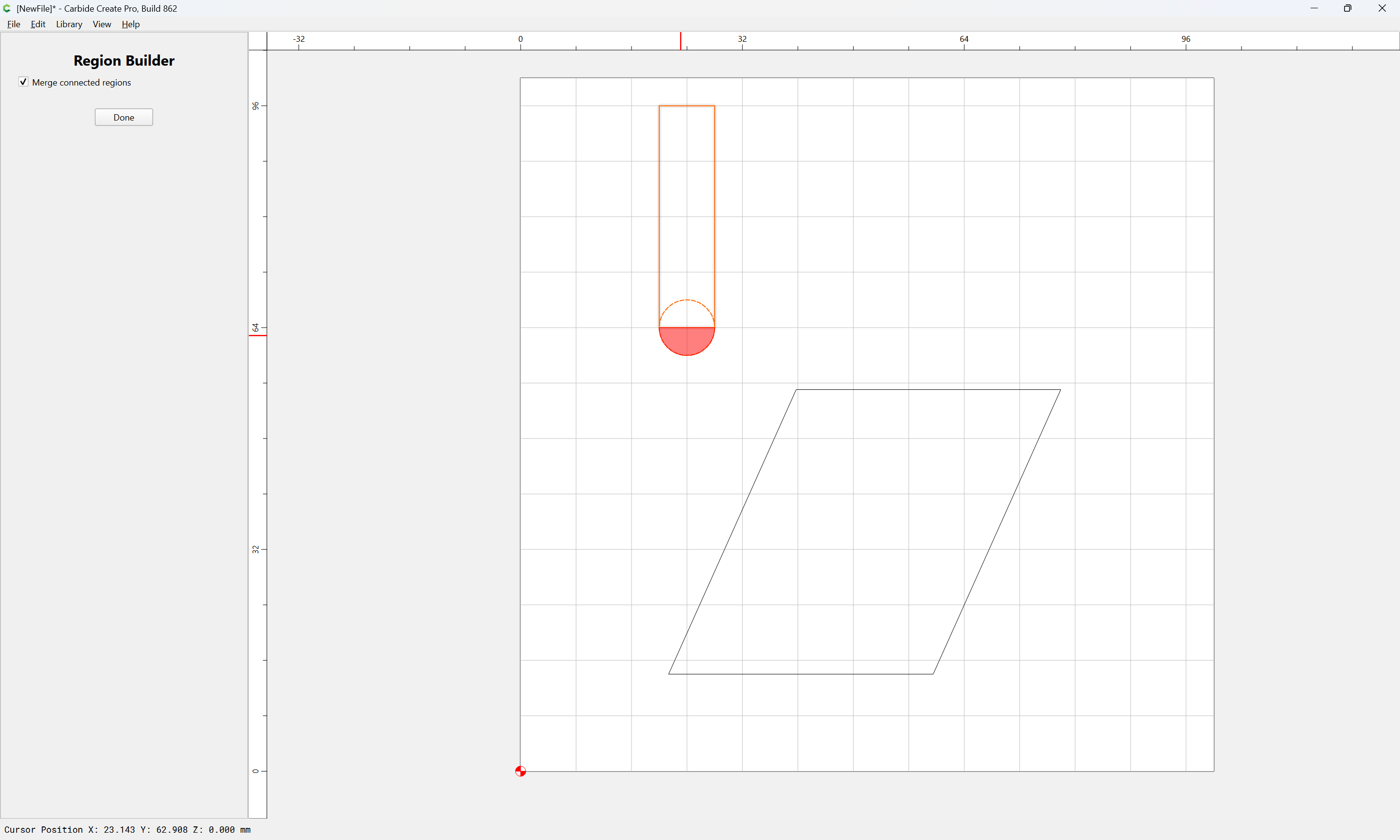

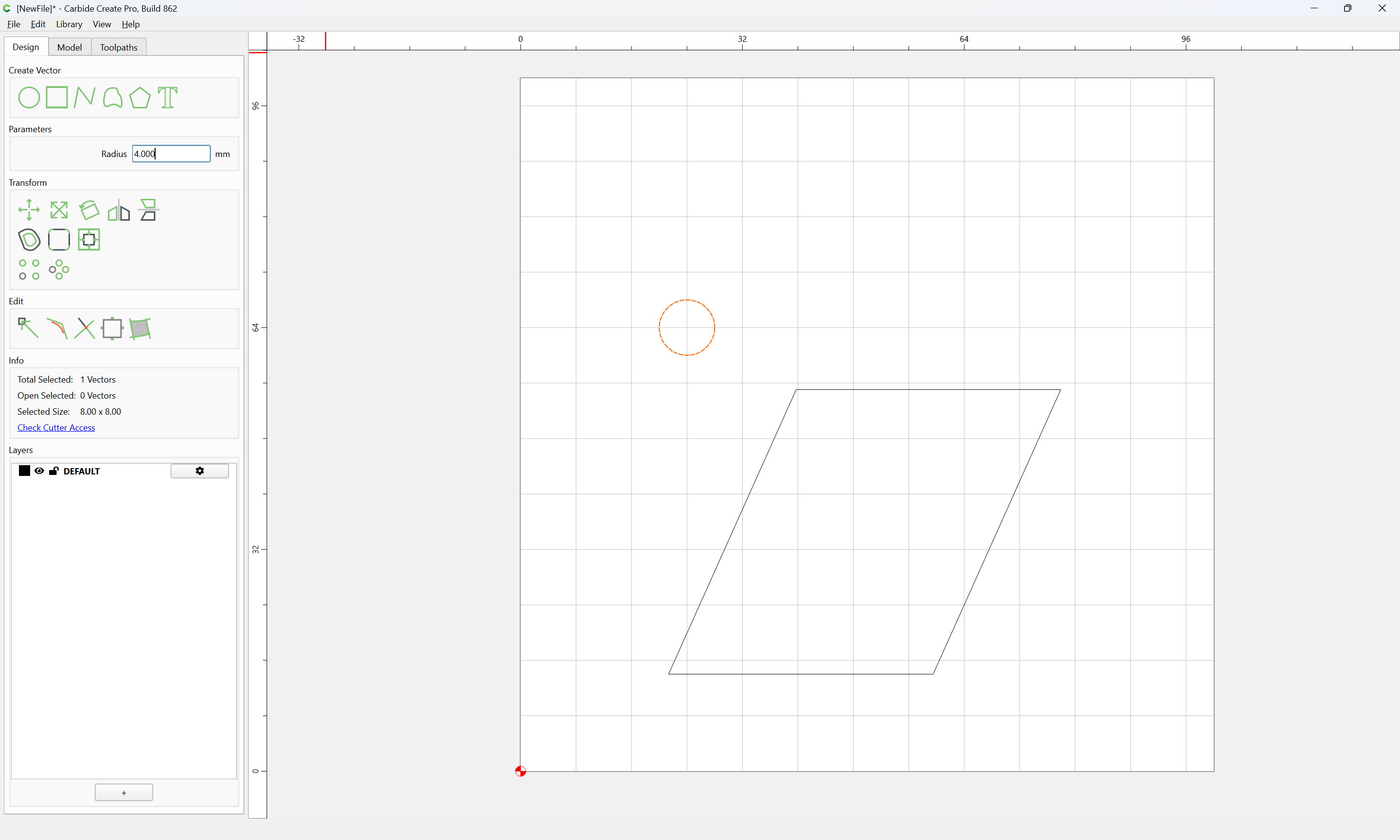

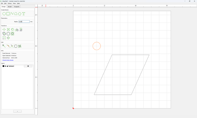

Then draw a ball-nose tool up in profile:
Done
and
position relative to the desired slope:
and at the bottom:

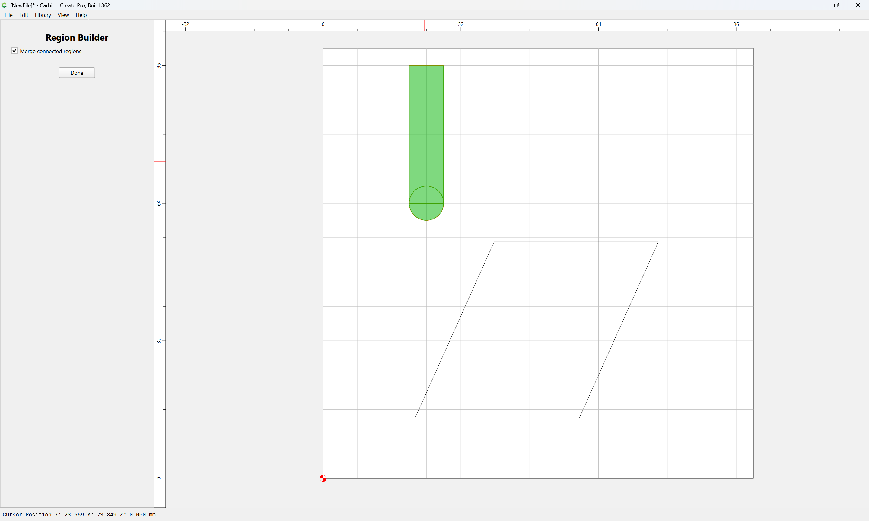

then use the technique from:
to draw a suitable number of offset lines and assign No Offset Contour toolpaths to the requisite depths.
