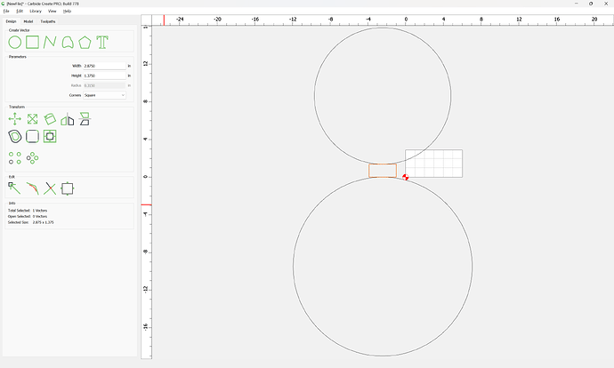

First, set up the file:
Then, draw up the cut in profile:
The easiest way to align these is to duplicate the stock profile and increase its height:
and then add the circles to the selection and use Trim Vectors:

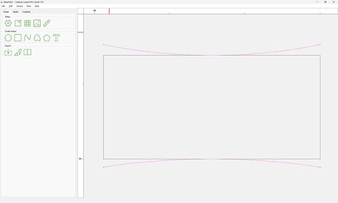

Then drag geometry into alignment:

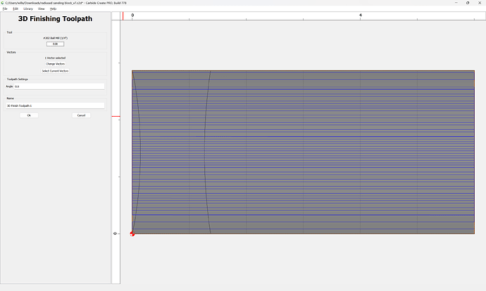

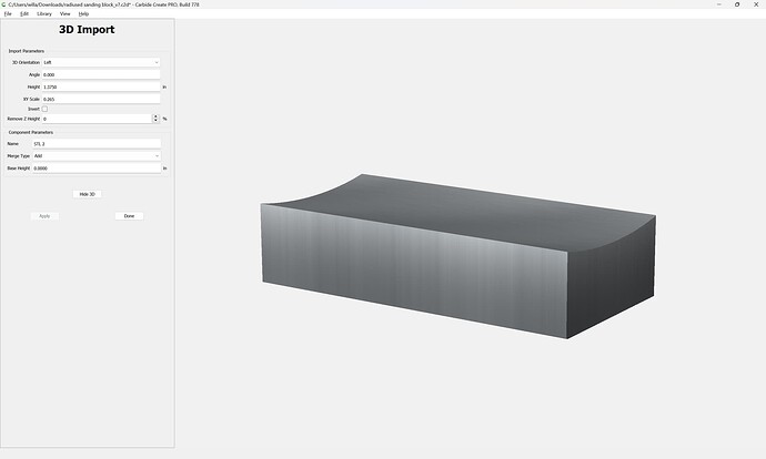

and import into Carbide Create Pro:
then assign 3D toolpaths:
If one wishes to cut both sides:
Attached as a v7 file.
radiused sanding block_pro_v7.c2d (268 KB)

I had a chance to try this today. I went the pro route since I have it. I used Autodesk Fusion to do the extruding and export the STL.
All worked like a charm. I even went back and put some text on the side so I know the radius at a glance.
