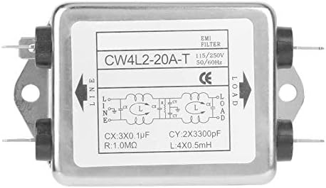

I was browsing around the other day and found this site for LED-Transformators(sorry it is in norwegian): https://ledlyskilder.no/transformator/2920-emi-filter-stoyfilter-10a-230v.html?gclid=EAIaIQobChMI552QyorX6wIVBbd3Ch0pNQdHEAQYBCABEgJCfPD_BwE
And was wandering if this might be a viable sollution. I did google the product name and found out that this comes in different sizes and shapes and from different vendors. Would this device be suitable to suppress noise from the spindle,vacum,compressor and other noisy equippment and if so wich rating should the EMI filter be?
Edit: Would it stop EMI from entering the connected equipment or leaving or maybe both?

It may be worth adding a noise suppressor such as the one listed, these filters are very common and also used to reduce the noise from VFDs. That particular one is a single stage with pretty common capacitor and inductor values, there are also double stage versions available and different capacitance and inductance values. Here’s a standard commodity one on Amazon UK
You can also pay 5-50x what they’re worth by buying them as “power conditioning” multi-socket leads from the likes of Belkin. Some vendors such as Furman Power do actually make more complex and capable power filters for uses like recording studios but a dual conversion UPS for the computer and Shapeoko is arguably a sheaper and more effective solution.
The question with the noise suppressor is whether to use them at source to try to isolate the noise from the motor (vac or compressor) from the mains wiring or to use them to shield the sensitive components such as the Shapeoko.
It’s worth talking to the support team as they’ve worked through this problem with quite a few people but if you want to try some stuff some EMI filters in the power lines are unlikely to make things worse.

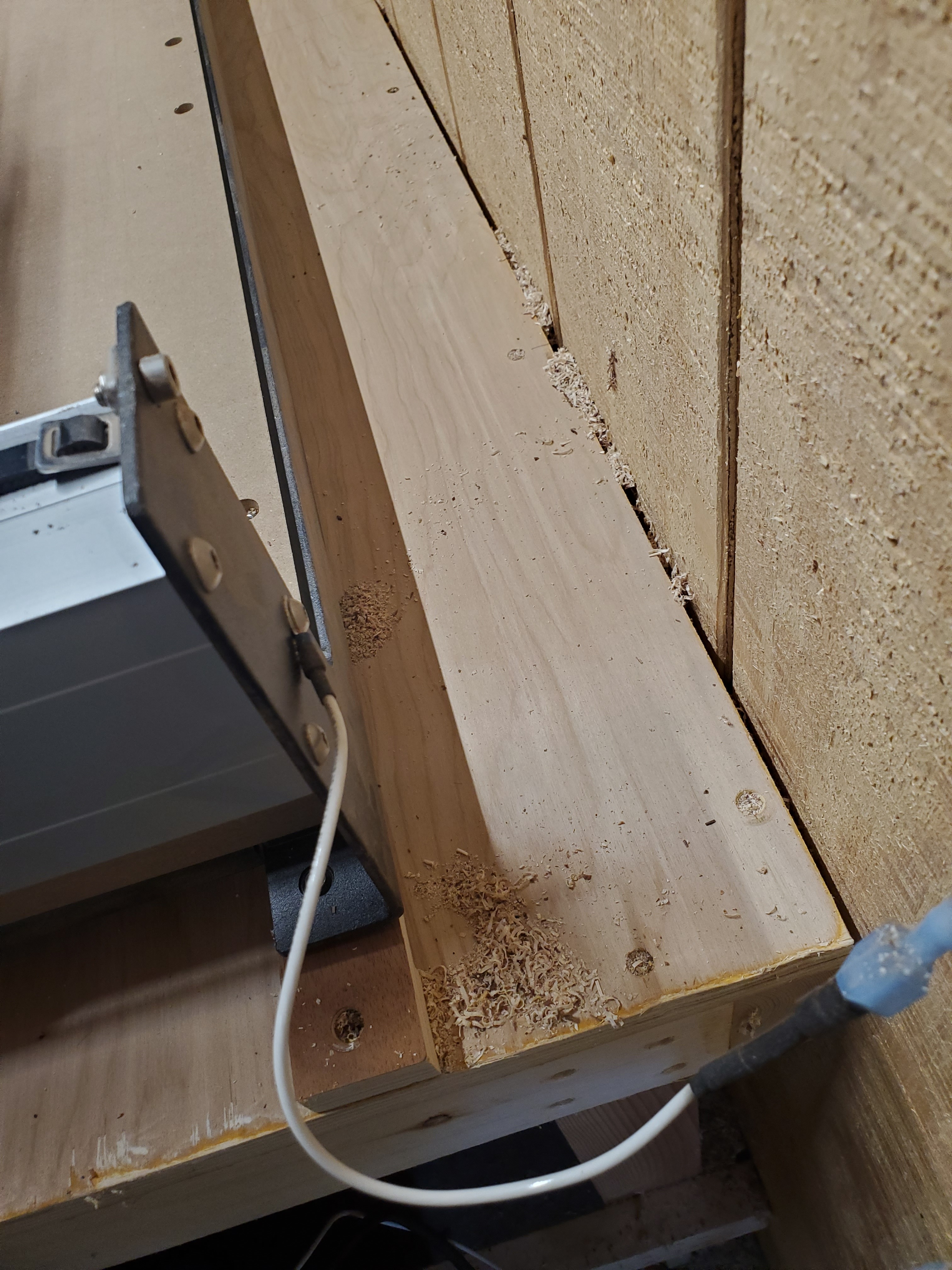

I had horrible EMI issues when i would run the vac or if i ever touched the metal. I talked with some helpful folks here on the forum and ended up being able to solve all my problems for the cost of a roll of wire and some plugs. see the photos below. I just grounded everything to the screw in the junction box and I haven’t had an issue one since that day.
Then from my router bracket to the dust collection hose. I stripped the shielding off the wire so the static could get all sexy with the the bare copper. It hasn’t caused any clogs or obstructions thus far. you can see the wire in the hose in the photo.
Remember to use star lock washers between the wire terminal and the aluminum, it will cut through the anodizing in multiple points and make a better connection. This works for me. I also taped a bare copper wire all along the dust collection hose to pick up static eletricity.
