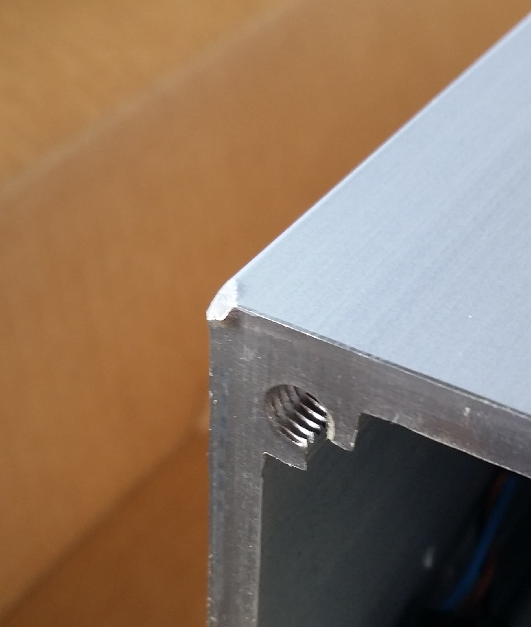

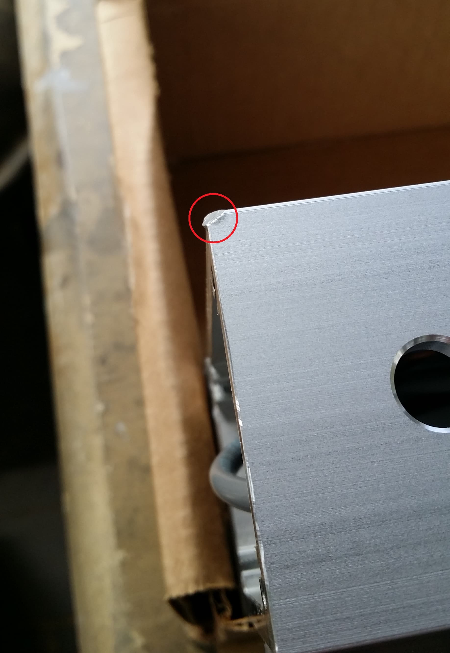

Also, this:
This clearly hit a hard surface, likely a concrete floor in a shop (seen it a number of times) when it was dropped. This is how it came right out of the undamaged box. I don’t imagine Carbide is shipping brand new parts like this, it likely was the result of whoever sent the machine back that they were assembled into.
This isn’t what I paid thousands of dollars for.
As far as I understand, the ends of these rails aren’t super critical to machine squareness, only the endplates sit against them. I imagine that the endplates are assumed to be flush with the rail, however. This isn’t going to result in an endplate being flush.
Granted, I can fix it myself with some time spent filing it flat again, but I paid for a brand new machine that didn’t require repairing damaged parts. If I was going to receive used (let alone damaged) parts, I should’ve been offered some kind of compensation because I didn’t pay for a used machine (or a machine that has used parts).

The rail definitely was dropped onto a hard surface, or was struck by something hard at some point in time before it was shipped. Brandon offered to ship me new Y-rails but the situation is that I needed to get the machine up and running ASAP as we’re already behind per the Y-rail mix-up with my original machine order. I was able to file down the mushroomed spots around the dinged corner and have the endplate sit flush, as intended.
