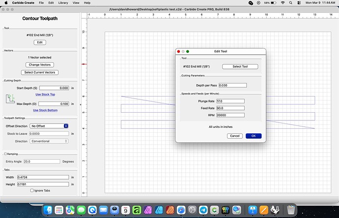

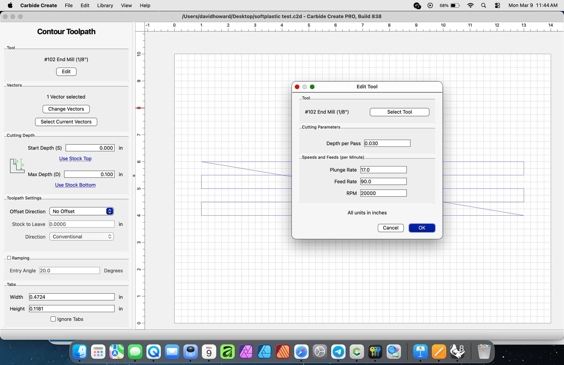

Cutting .25 thick plexiglass for a guitar body template, using 1/8" 2 flute bit and the CC Pro recommends, 20,000 RPM, and feed at 90.0, at .030 depth per pass. I am testing these settings and others settings, but it still melts the plastic and the shavings stick to it… I am wondering if the bit (an old bit) is dull and if that can be and issue. Or do I need a specific type of bit.

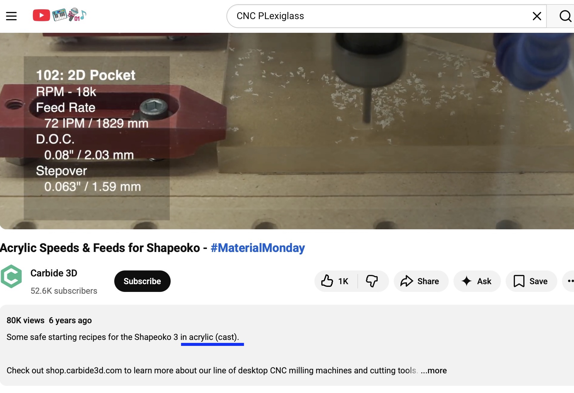

See:
and consider single flute tooling, or a tool w/ a geometry optimized for plastic.

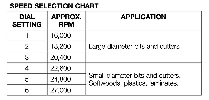

Here is the speeds on my Router…I have tried the lowest setting…it still melts and sticks
and a screen shot of what CC Pro recommends.
I run a 1/4" O-flute at 8000 RPM (My slowest speed).
You can try 16000 and increase the feedrate. A single flute cutter may help as well.

Regarding “MaterialMonday” Videos I don’t recall any reference to which type of plexiglass, cast or extruded.
Plexiglass is acrylic, see the entry for “Cast acrylic”.
Moreover, consider single-flute tooling — there’s at least one video on that there.
