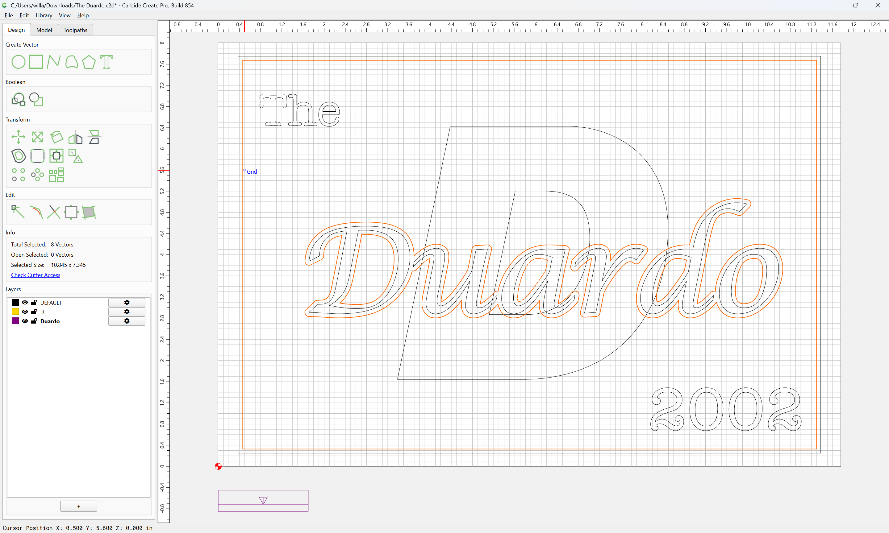

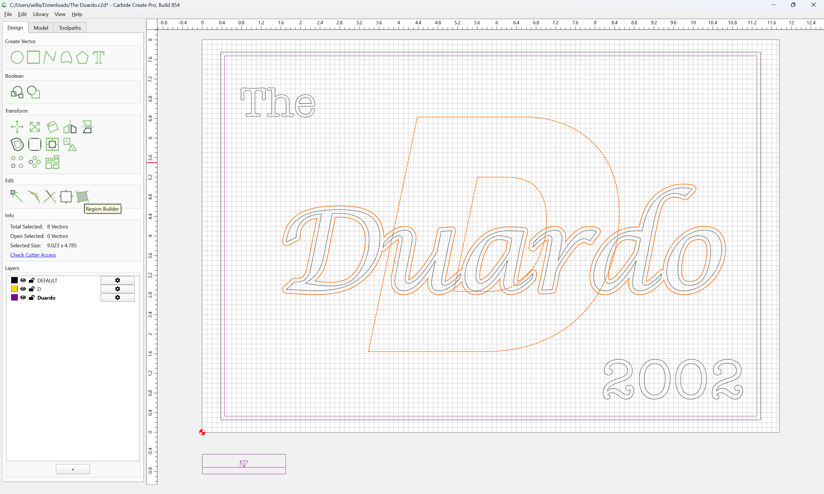

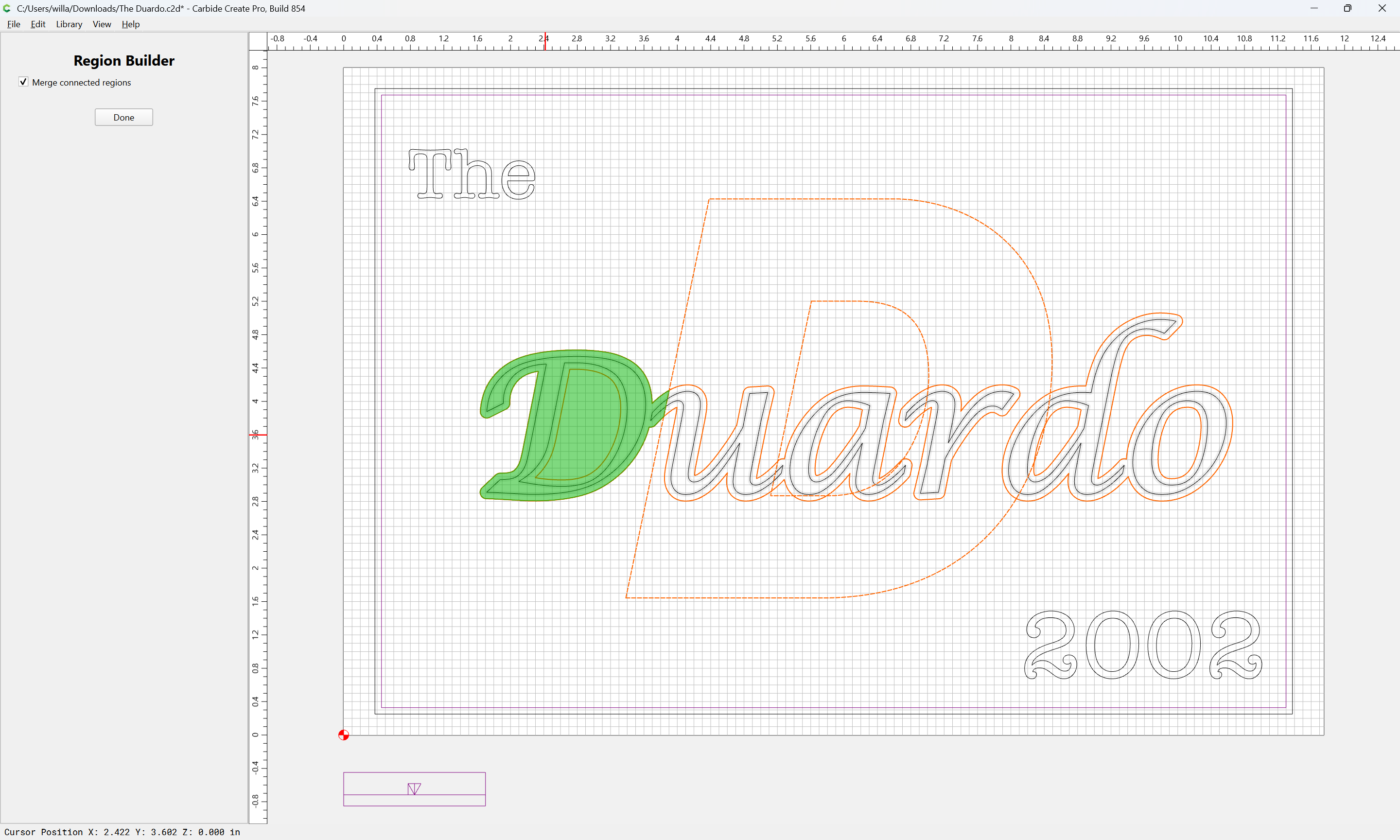

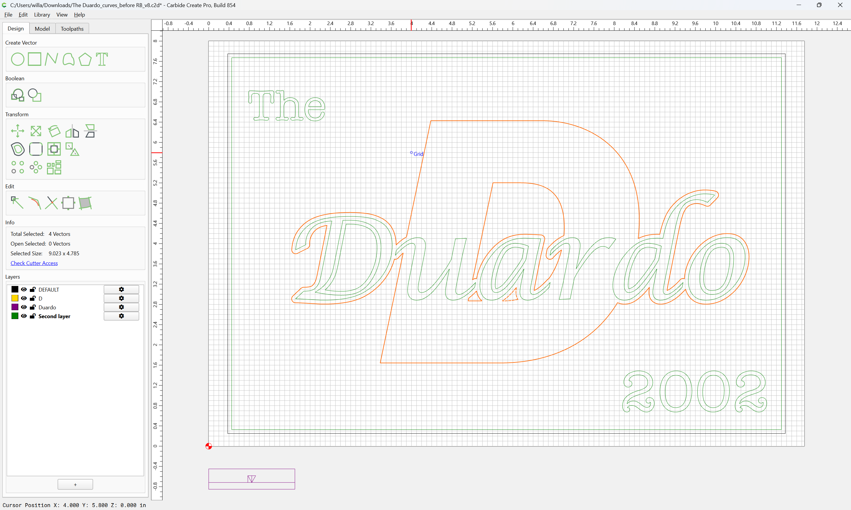

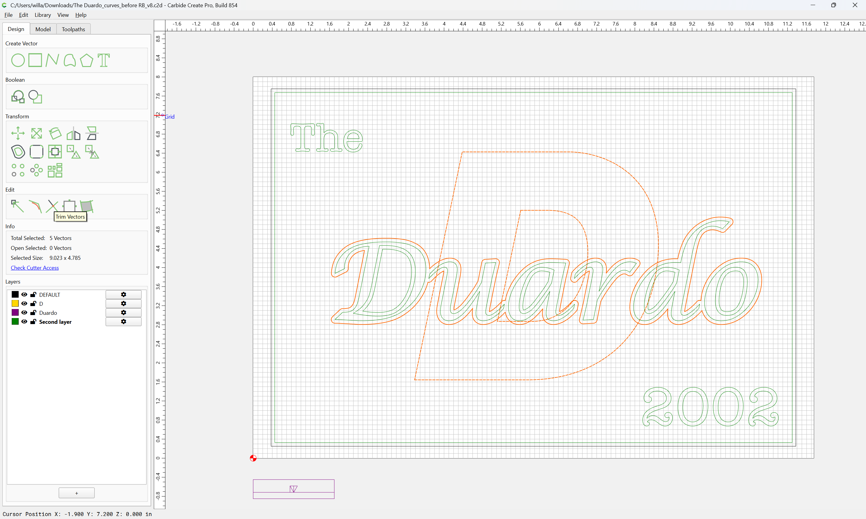

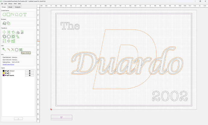

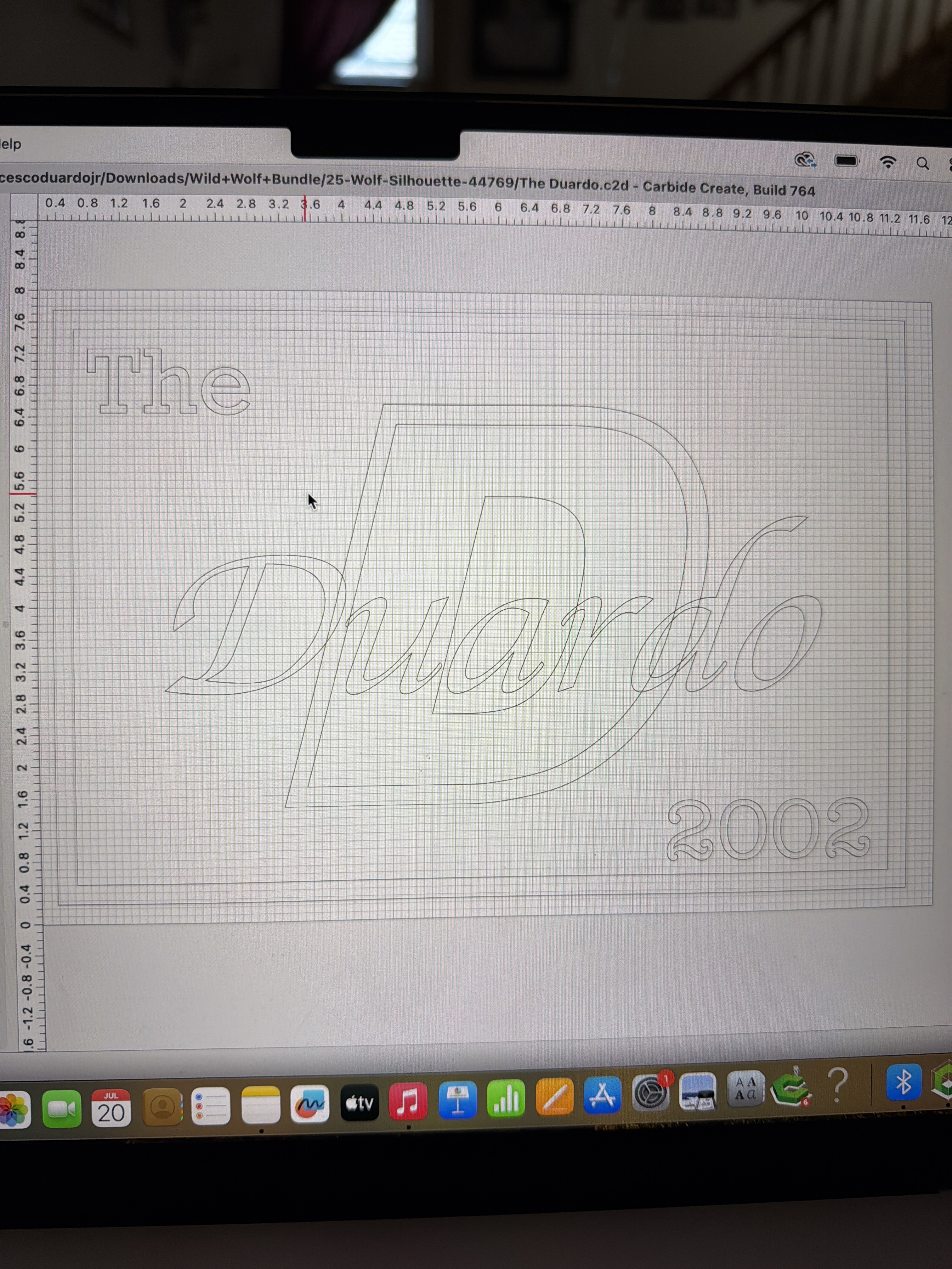

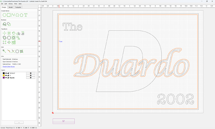

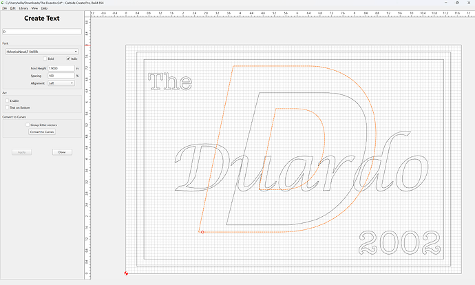

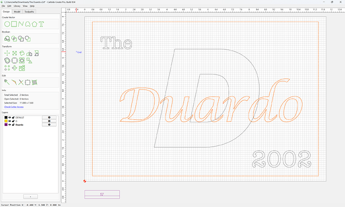

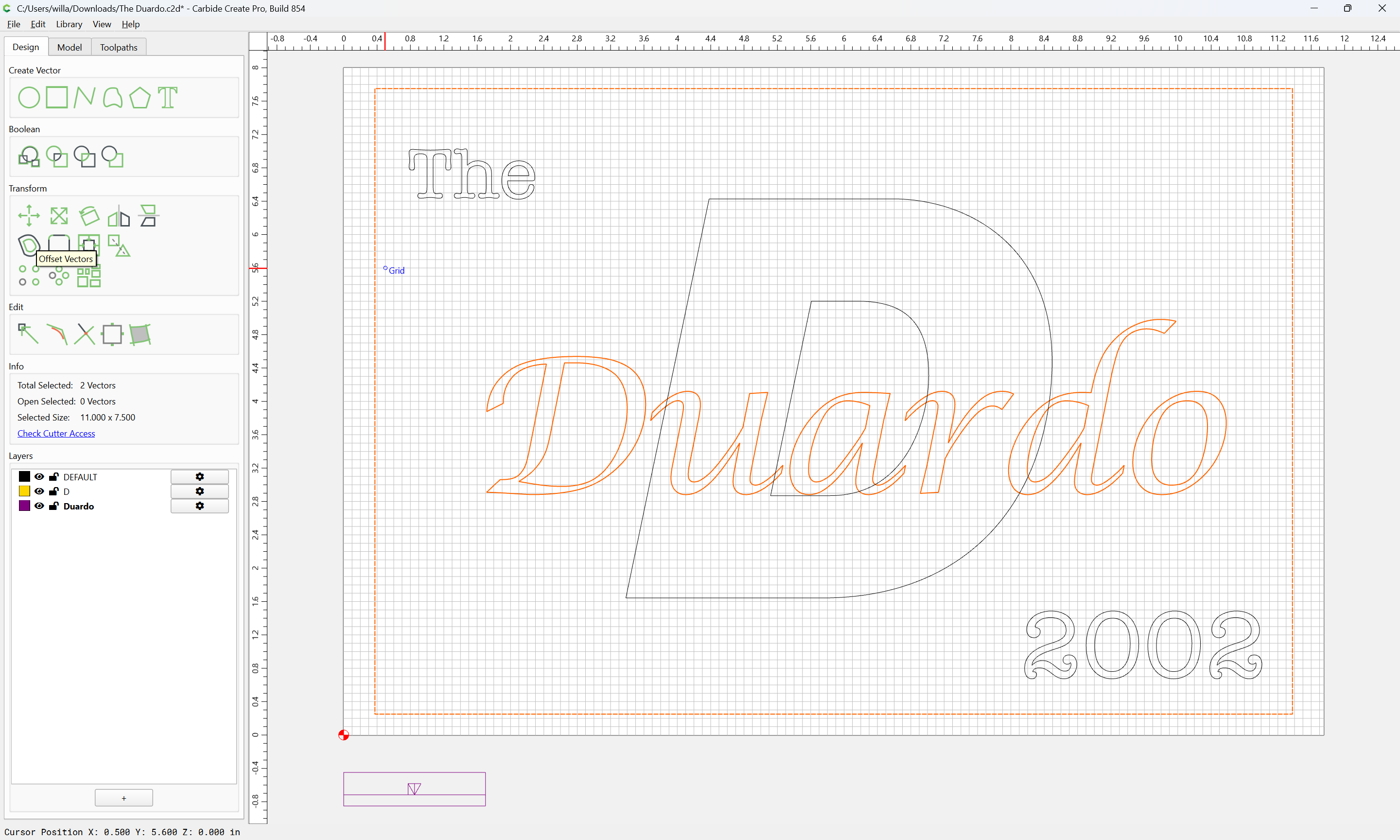

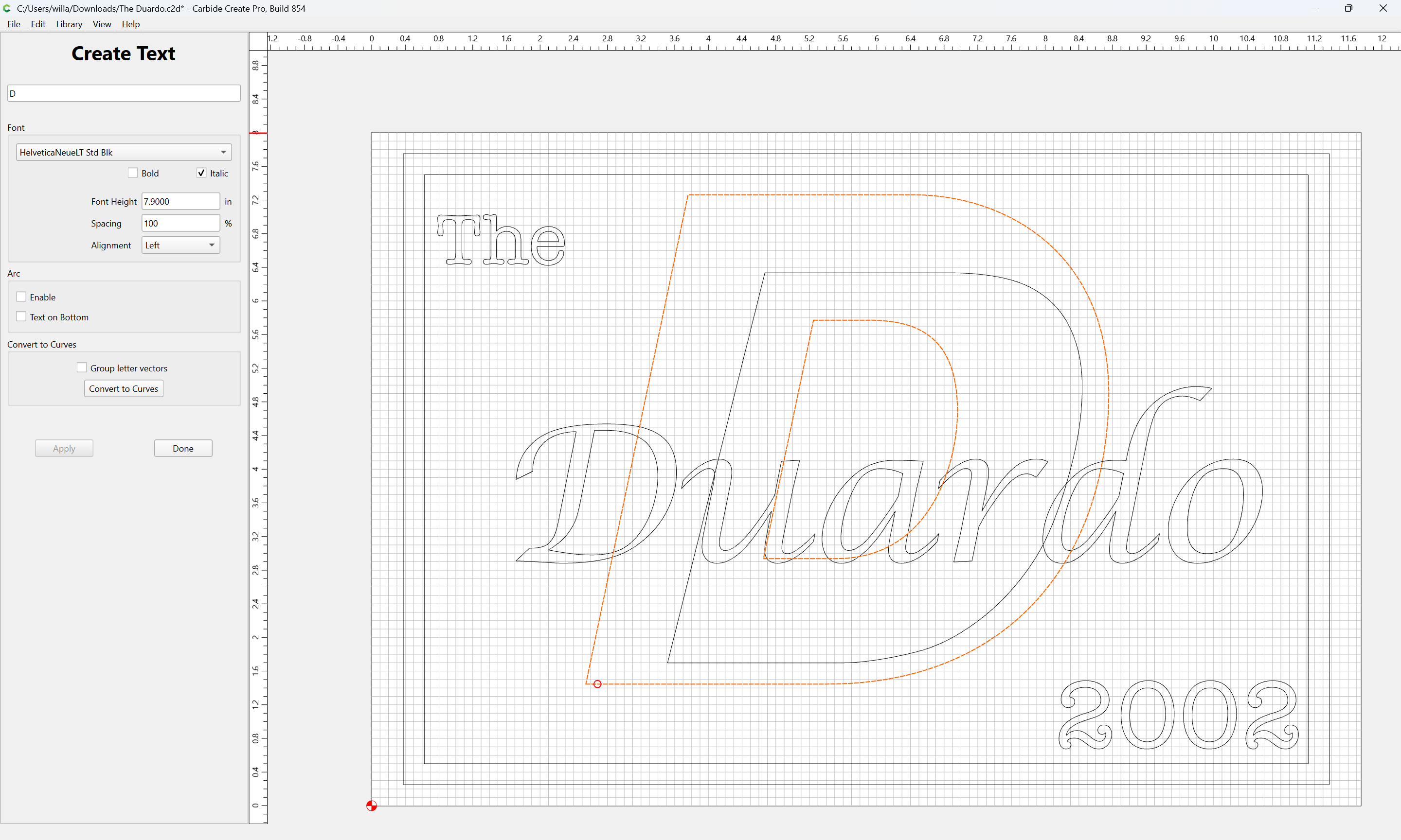

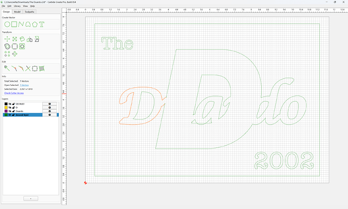

Hi, I am trying to cleanup unnecessary lines within the last name “Duardo” notice there are lines going through my last name from the large letter D I am a beginner with editing any help would be greatly appreciated I hope I explained it well.
See:
and

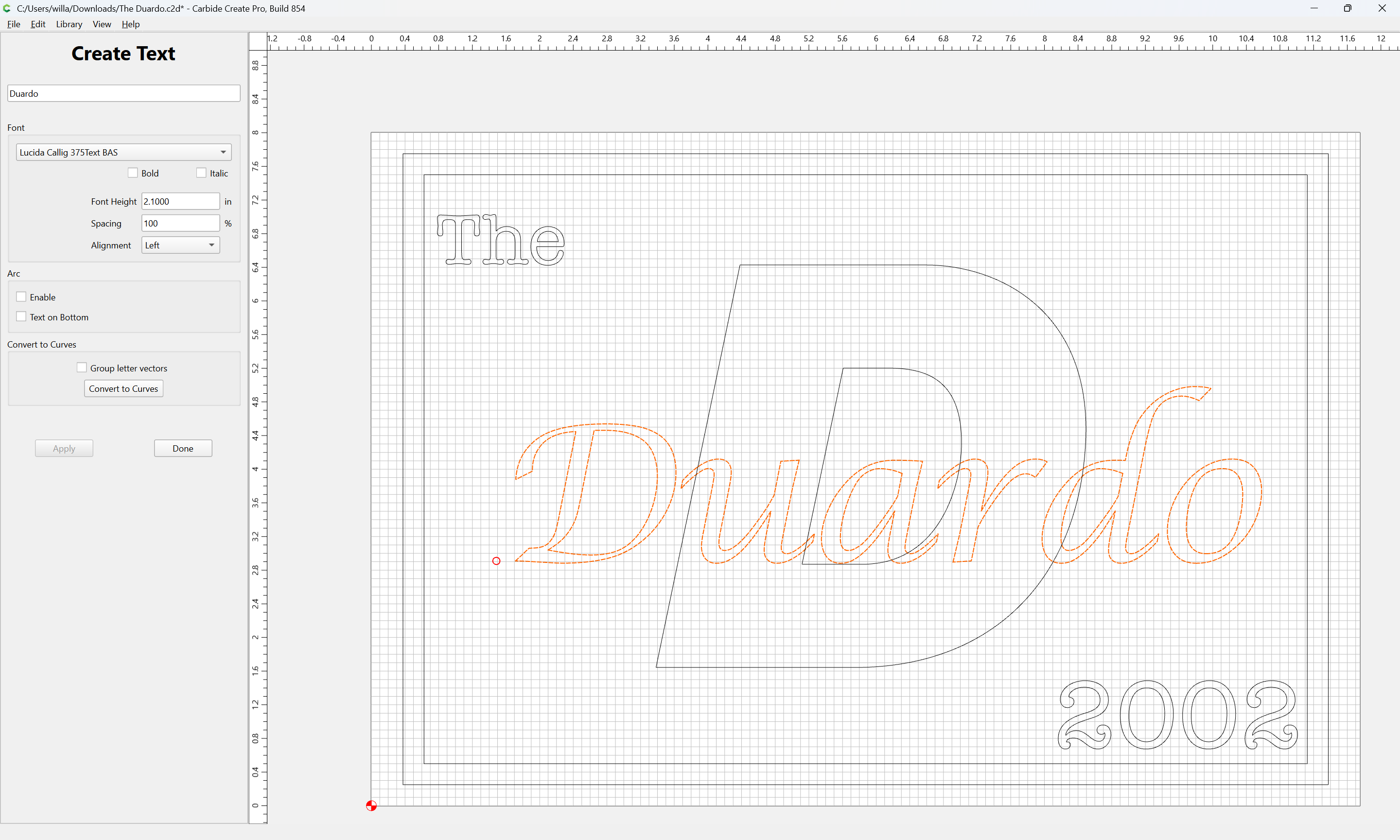

The file was sent via a PM, unfortunately, I do not have the specific fonts used:

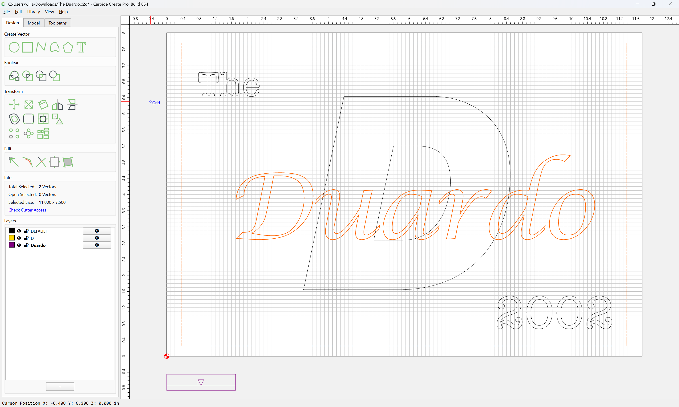

Making reasonable substitutions we arrive at:

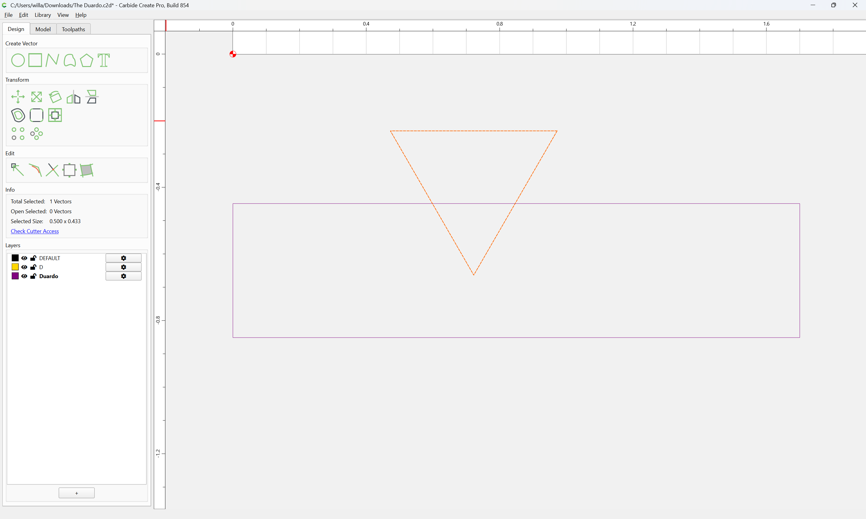

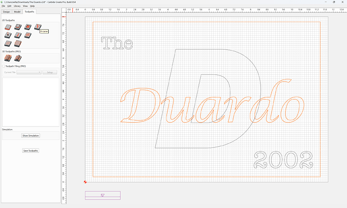

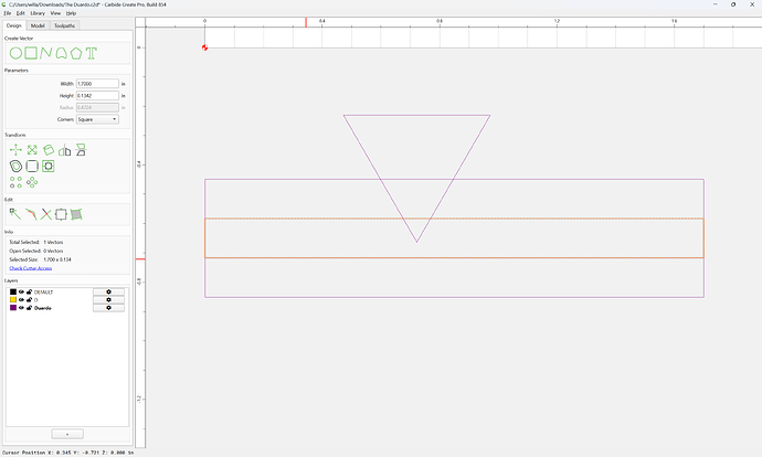

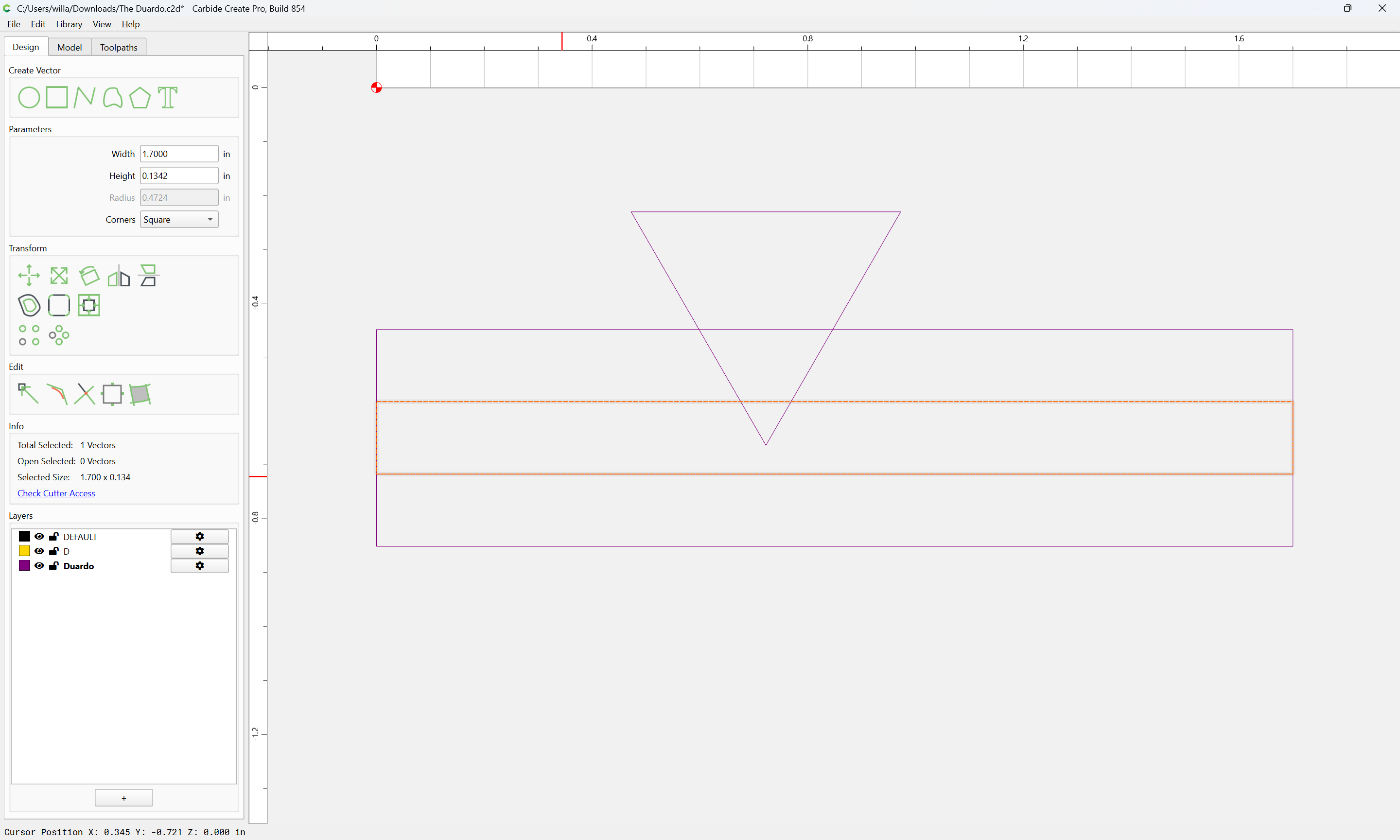

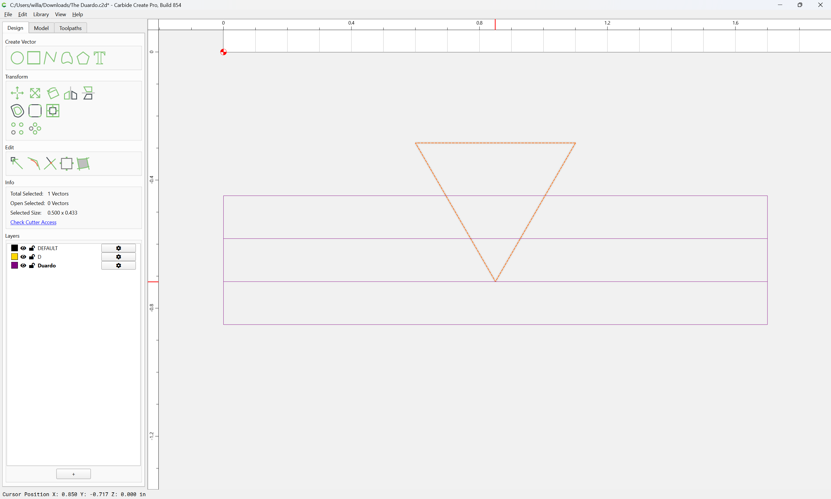

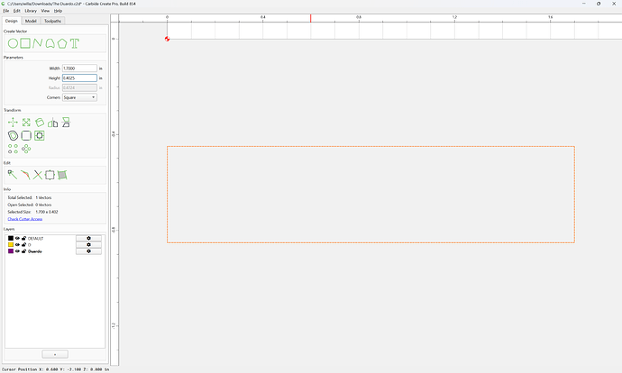

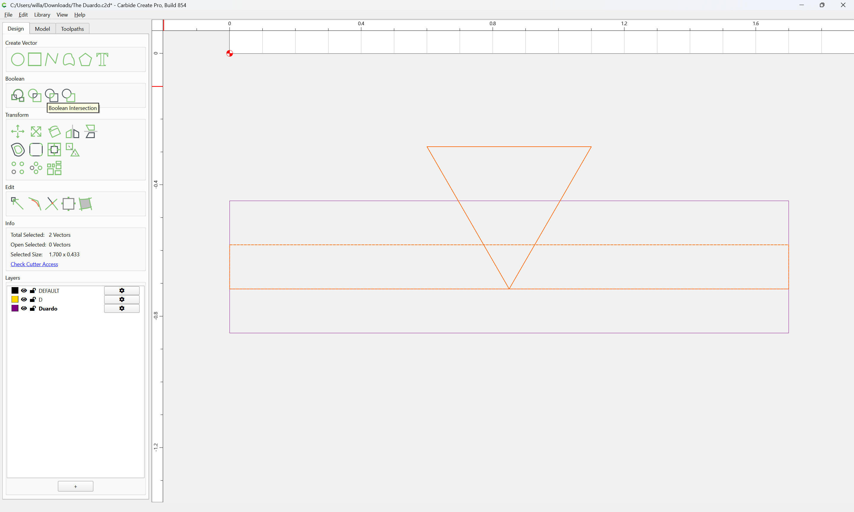

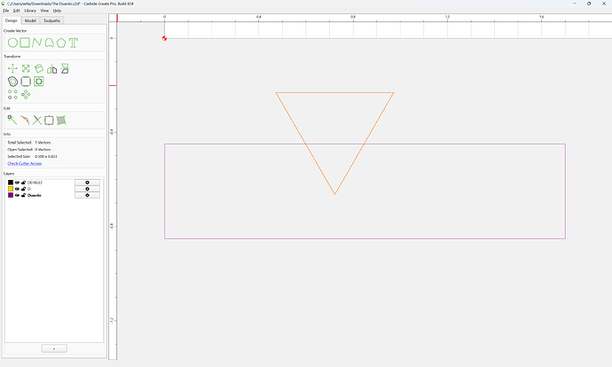

First, we draw up the cut in profile:

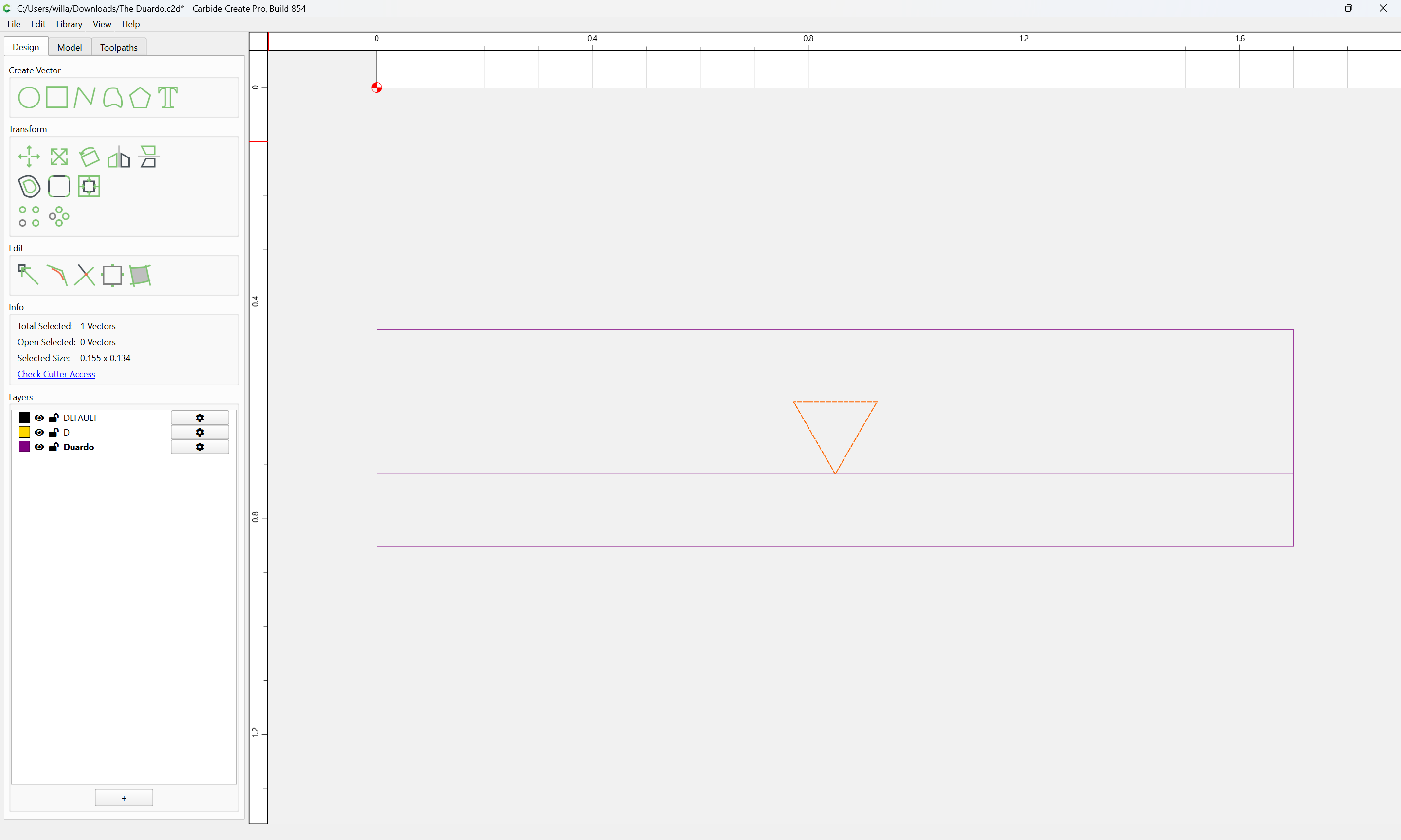

and the tool to be used (a 60 degree V tool was selected)

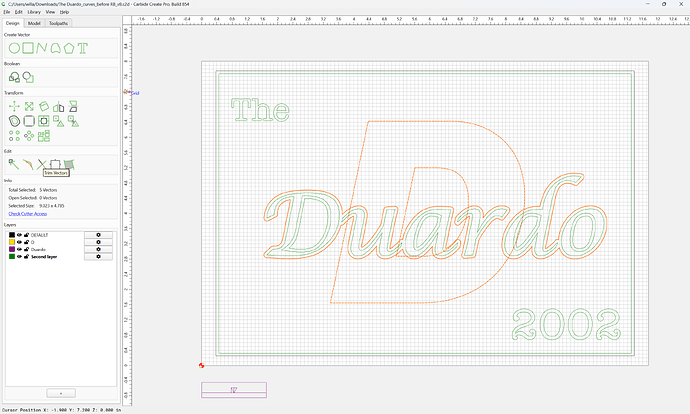

Then, the three layers of the cut:

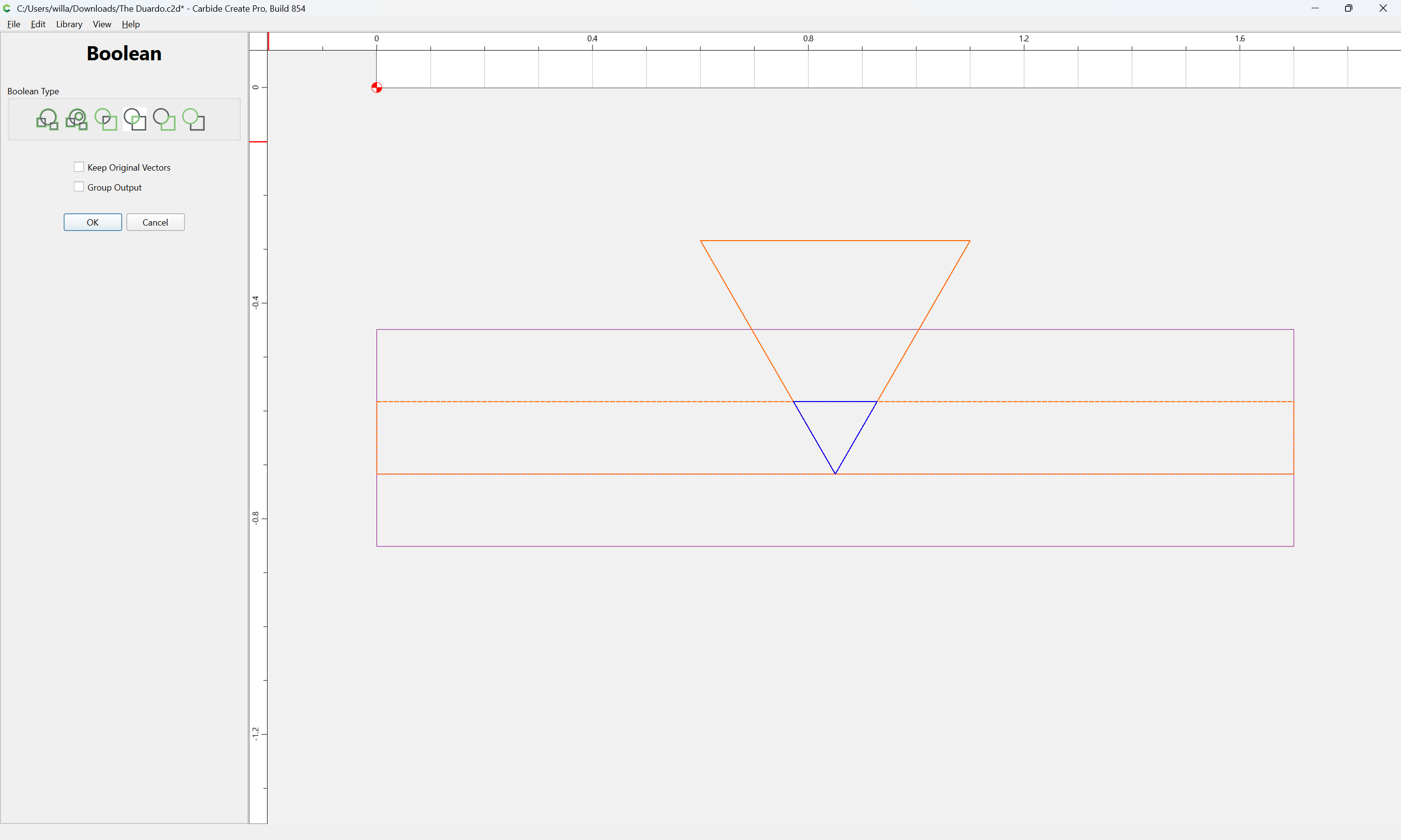

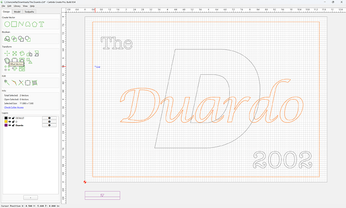

Getting the intersection of the V tool and the middle layer:

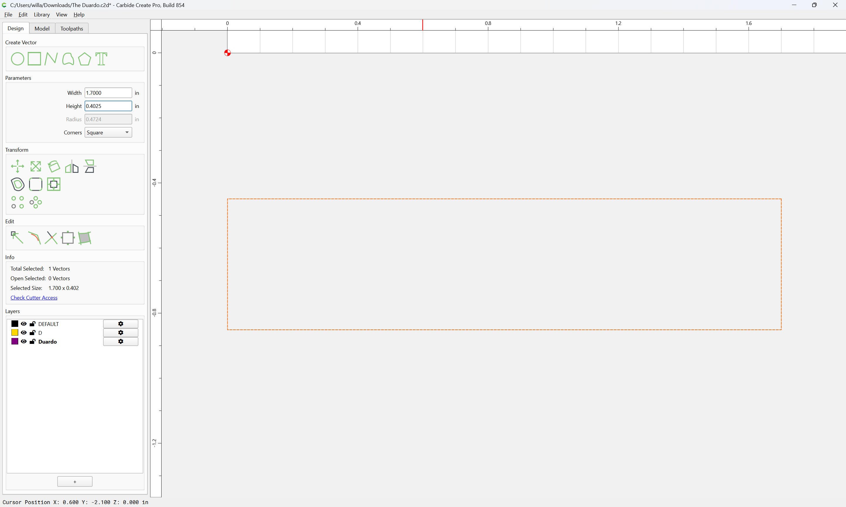

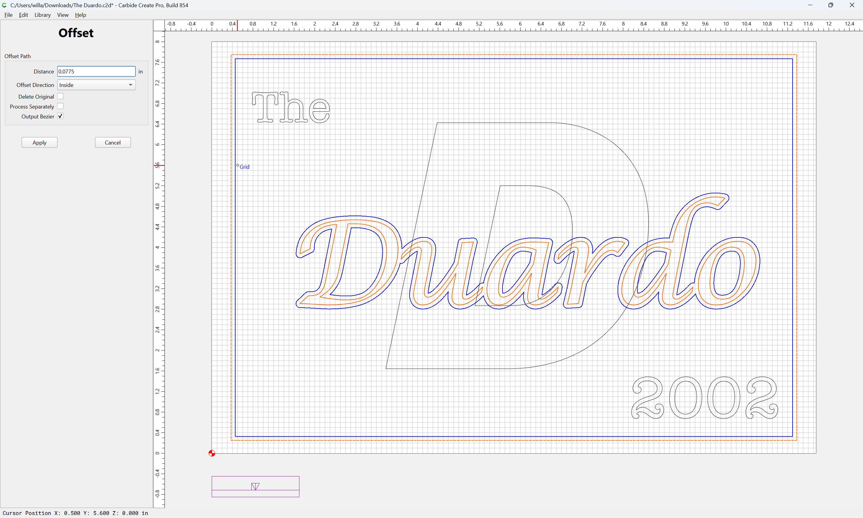

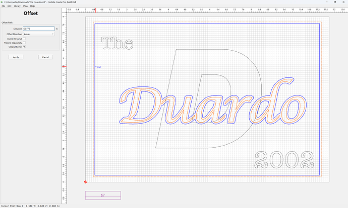

We can see that it will be necessary to offset by 0.0775 and that each layer should be cut to a depth of 0.1342".

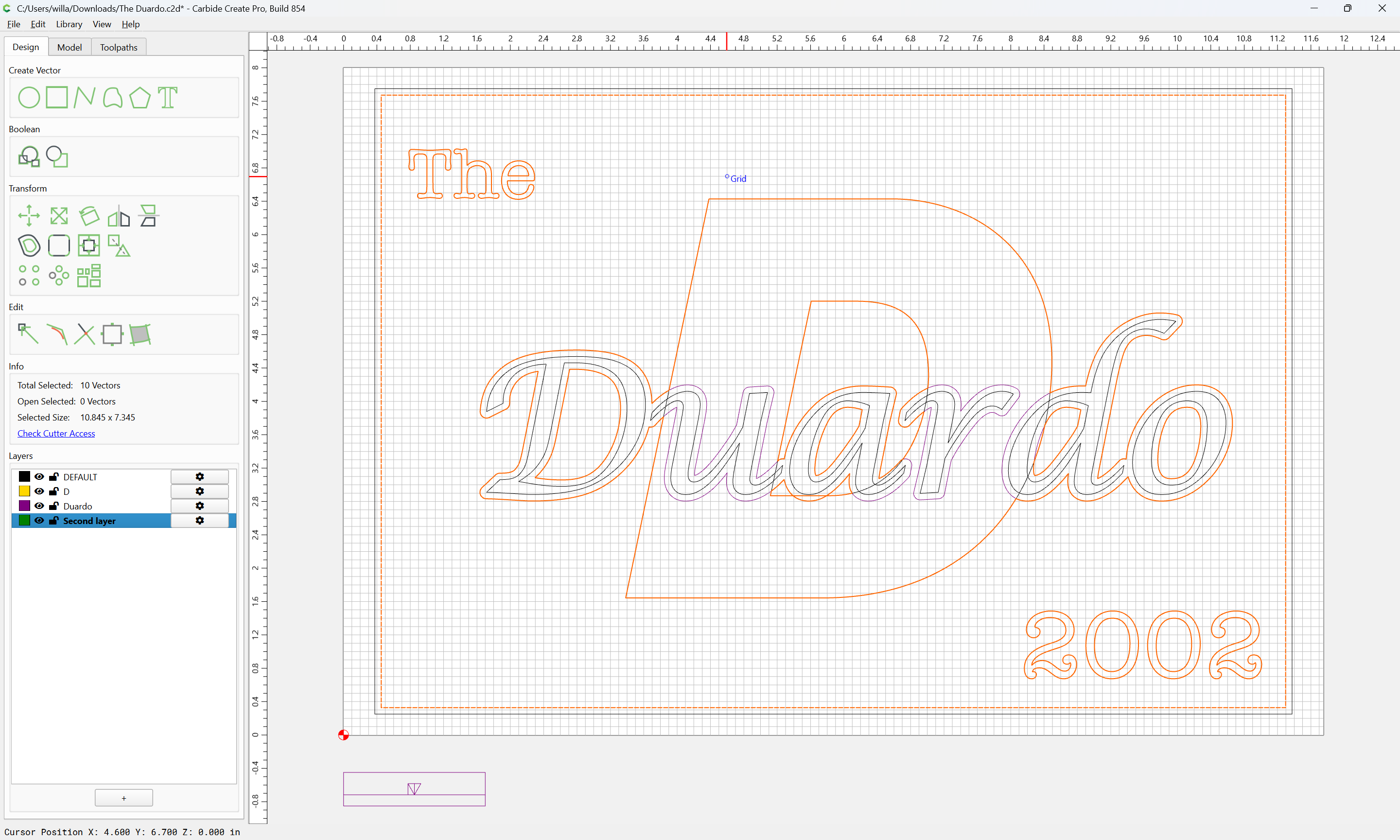

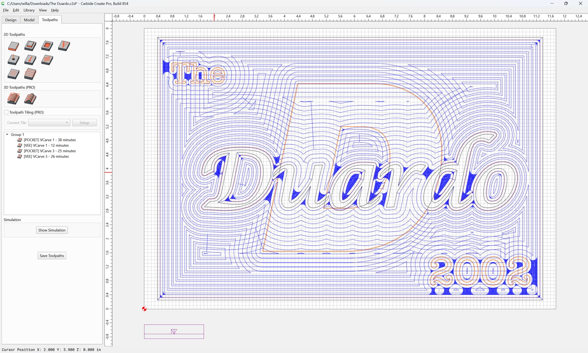

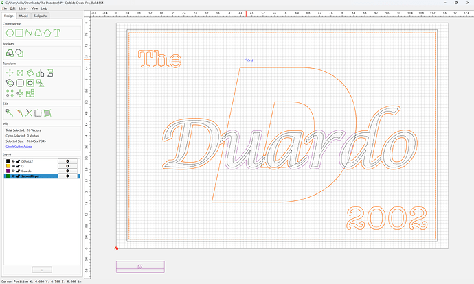

Cut the first layer:

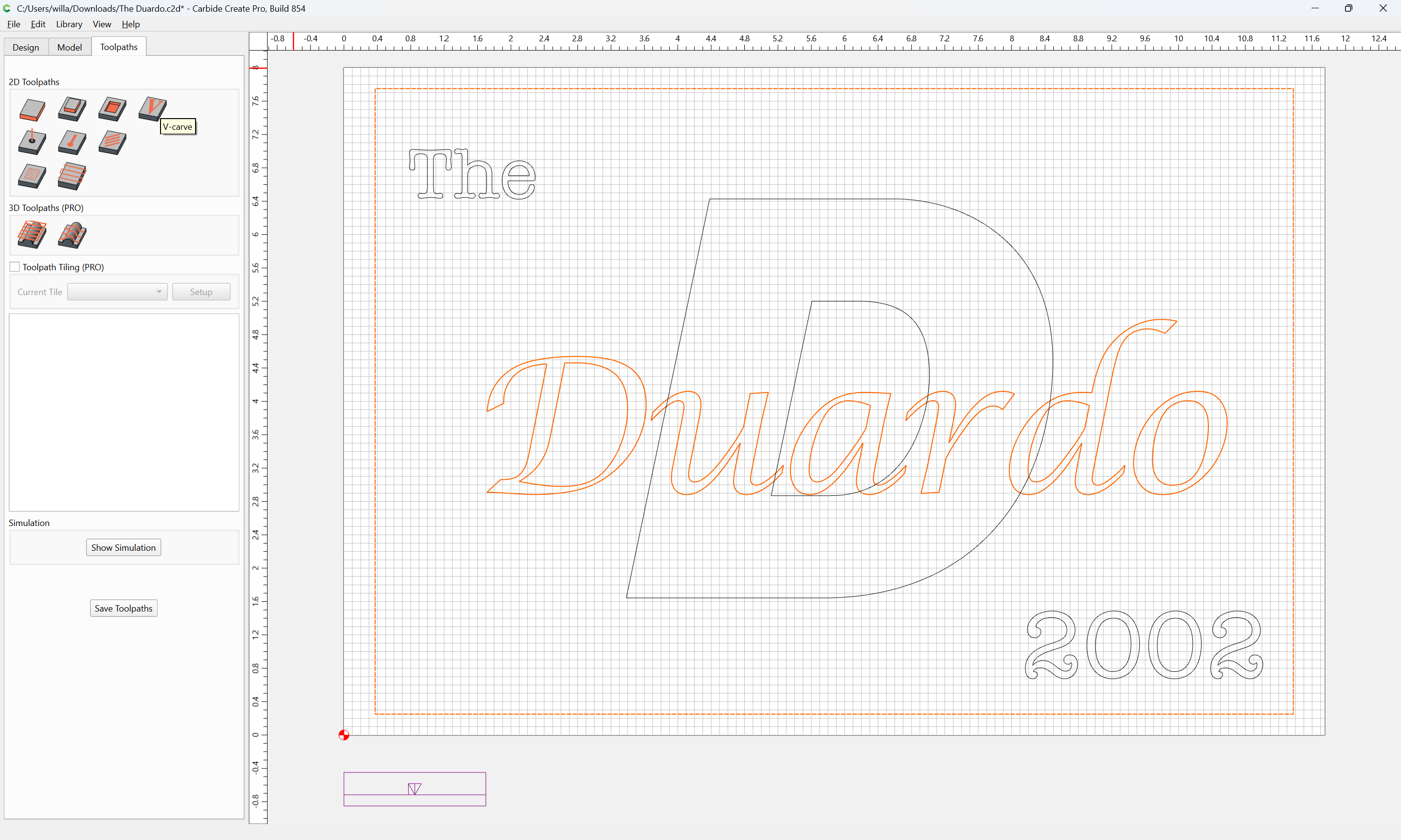

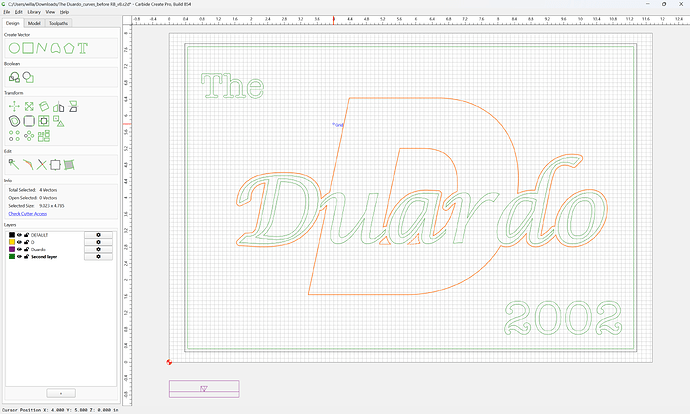

The text and rectangle for the first layer is then offset by the desired dimension:

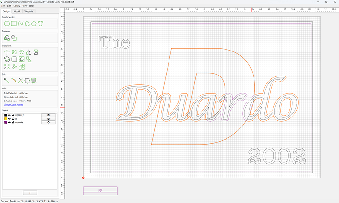

Apply

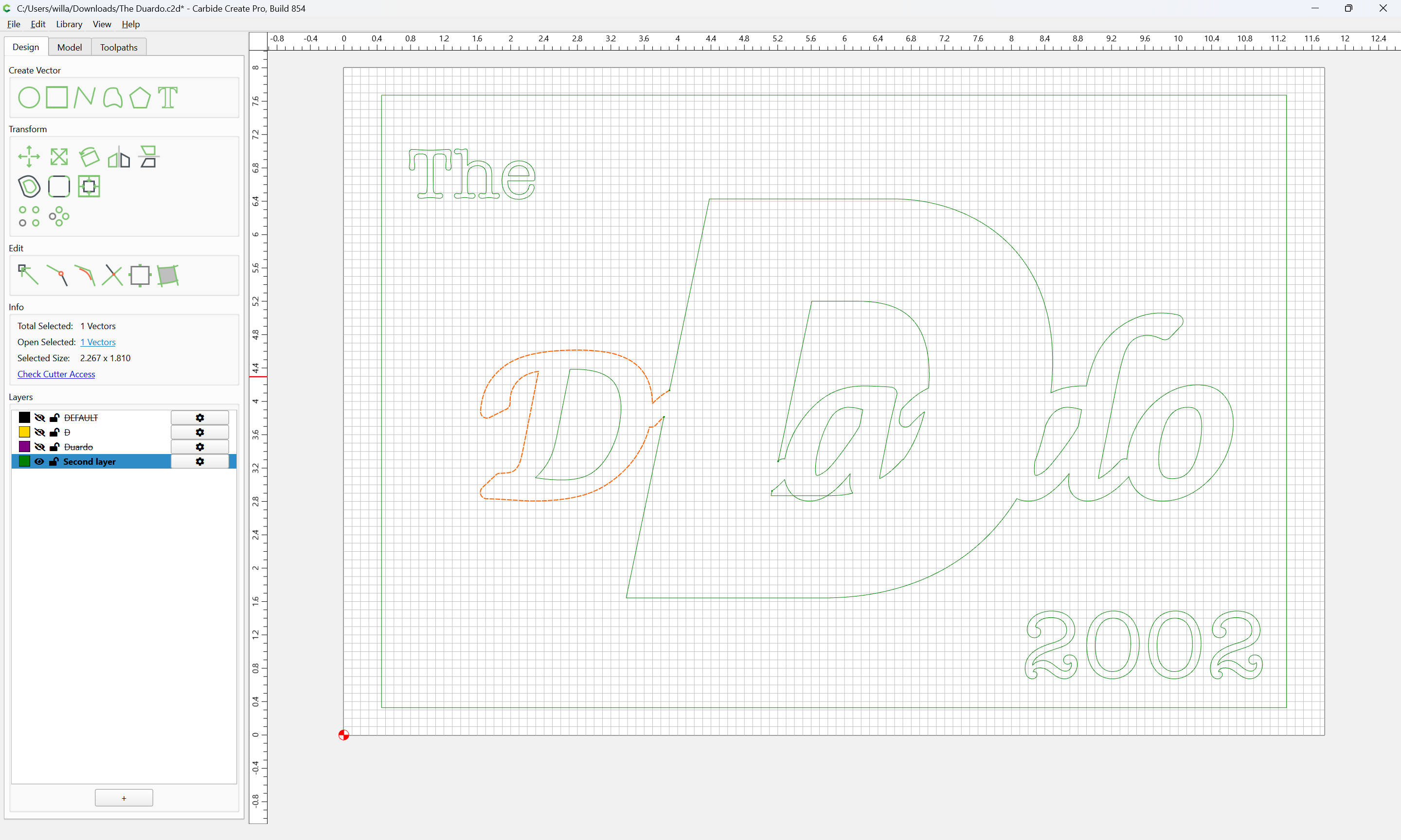

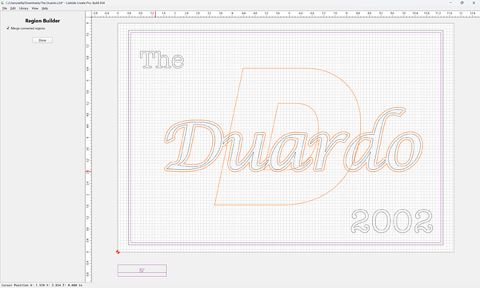

shift-click on the rectangle to remove it from the selection and shift-click on the lower layer to add it:

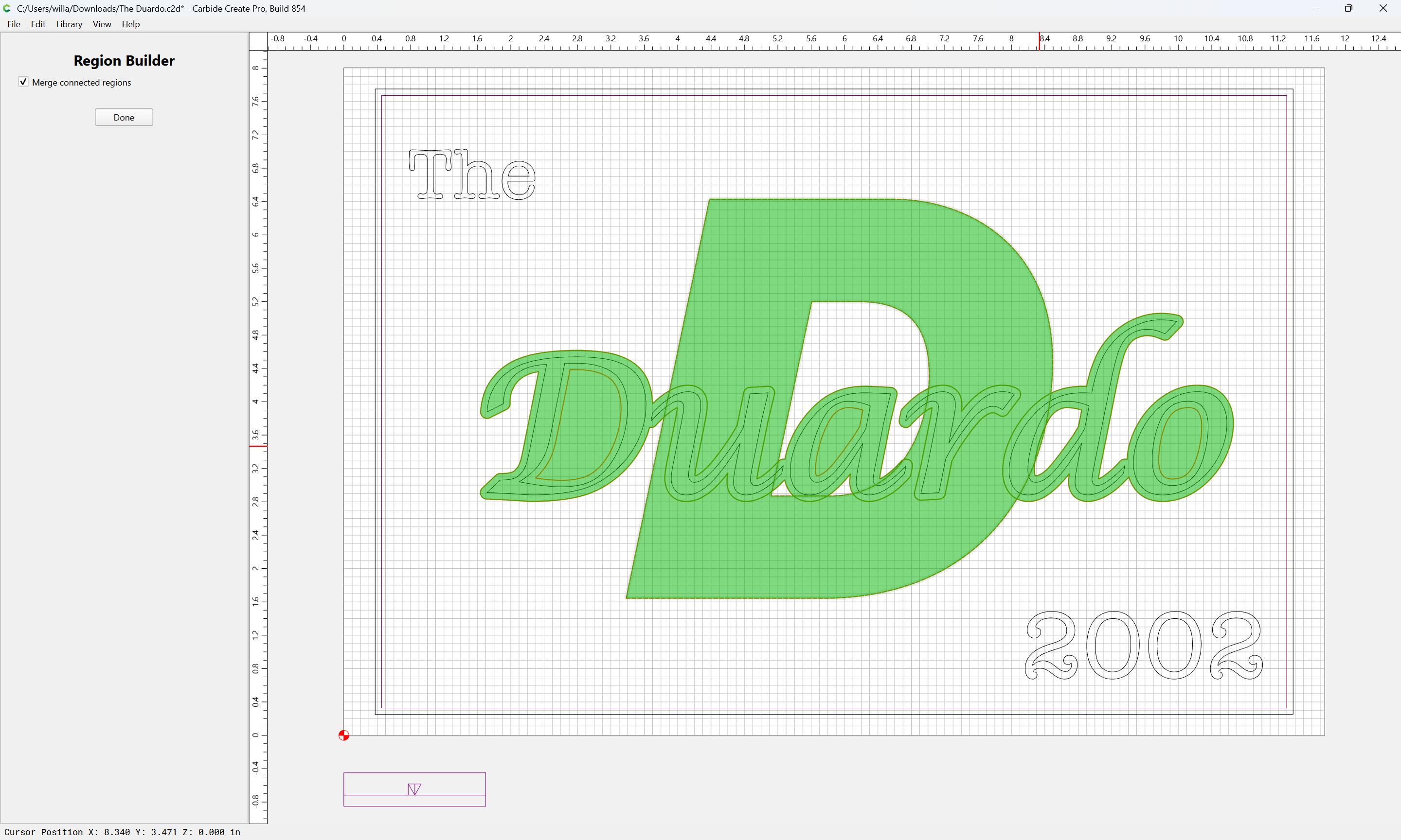

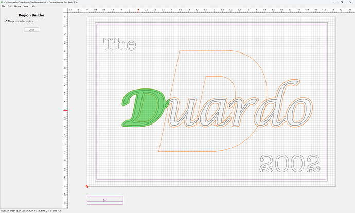

and use Region Builder to define the region for the lower layer:
Yes
Yes
Done

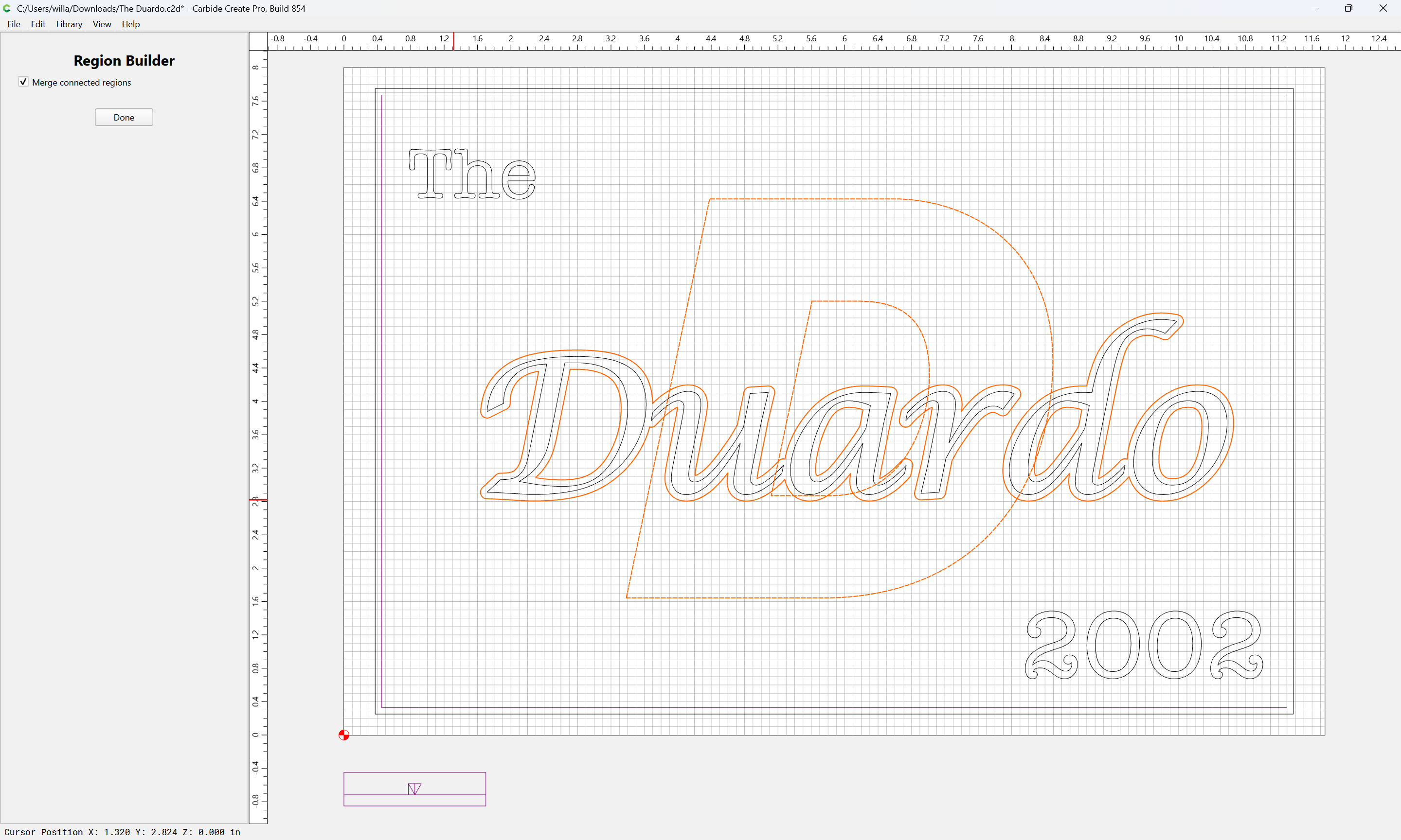

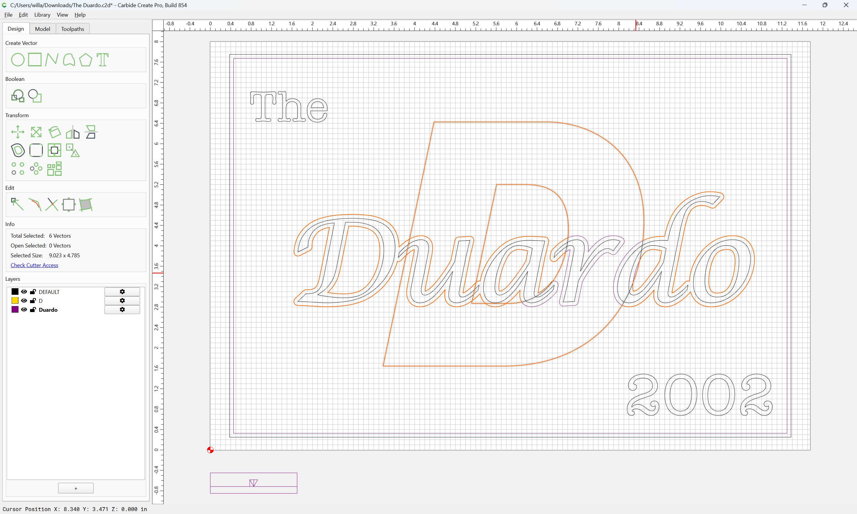

If need be, adjust the built regions:

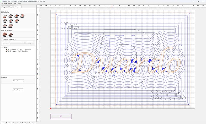

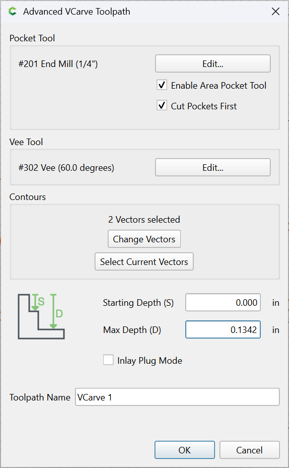

Add the offset rectangle and the secondary text to the selection:

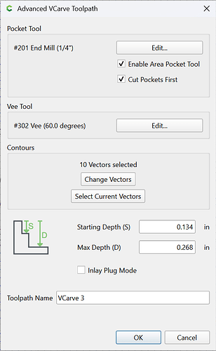

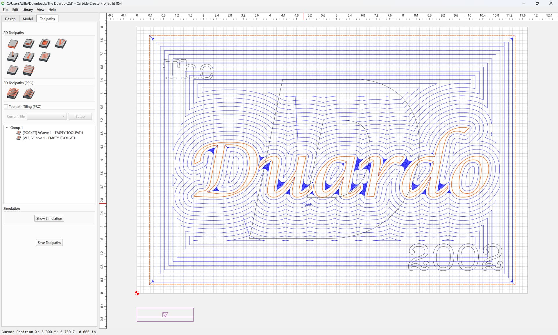

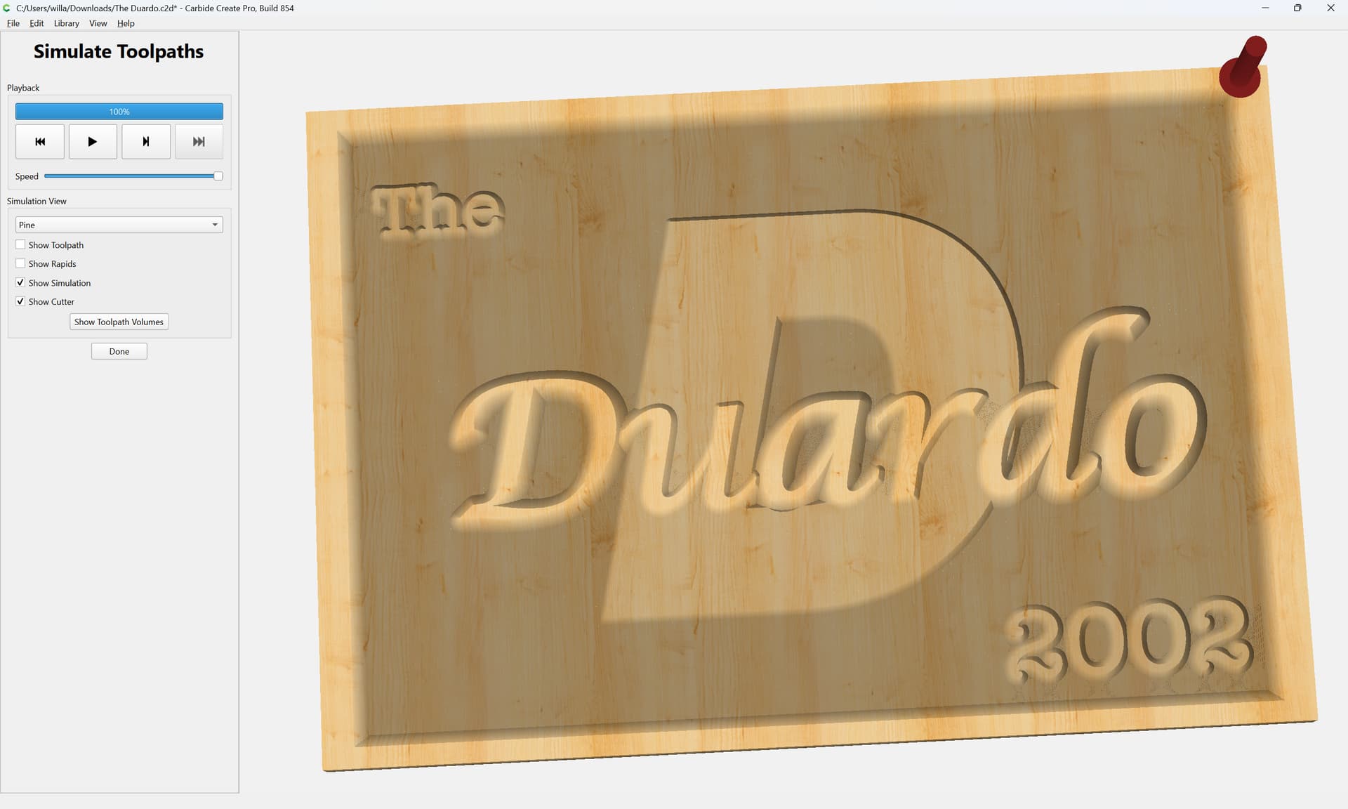

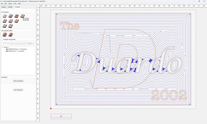

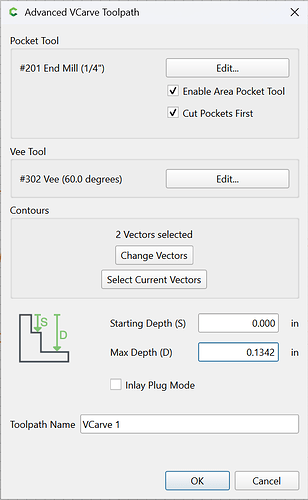

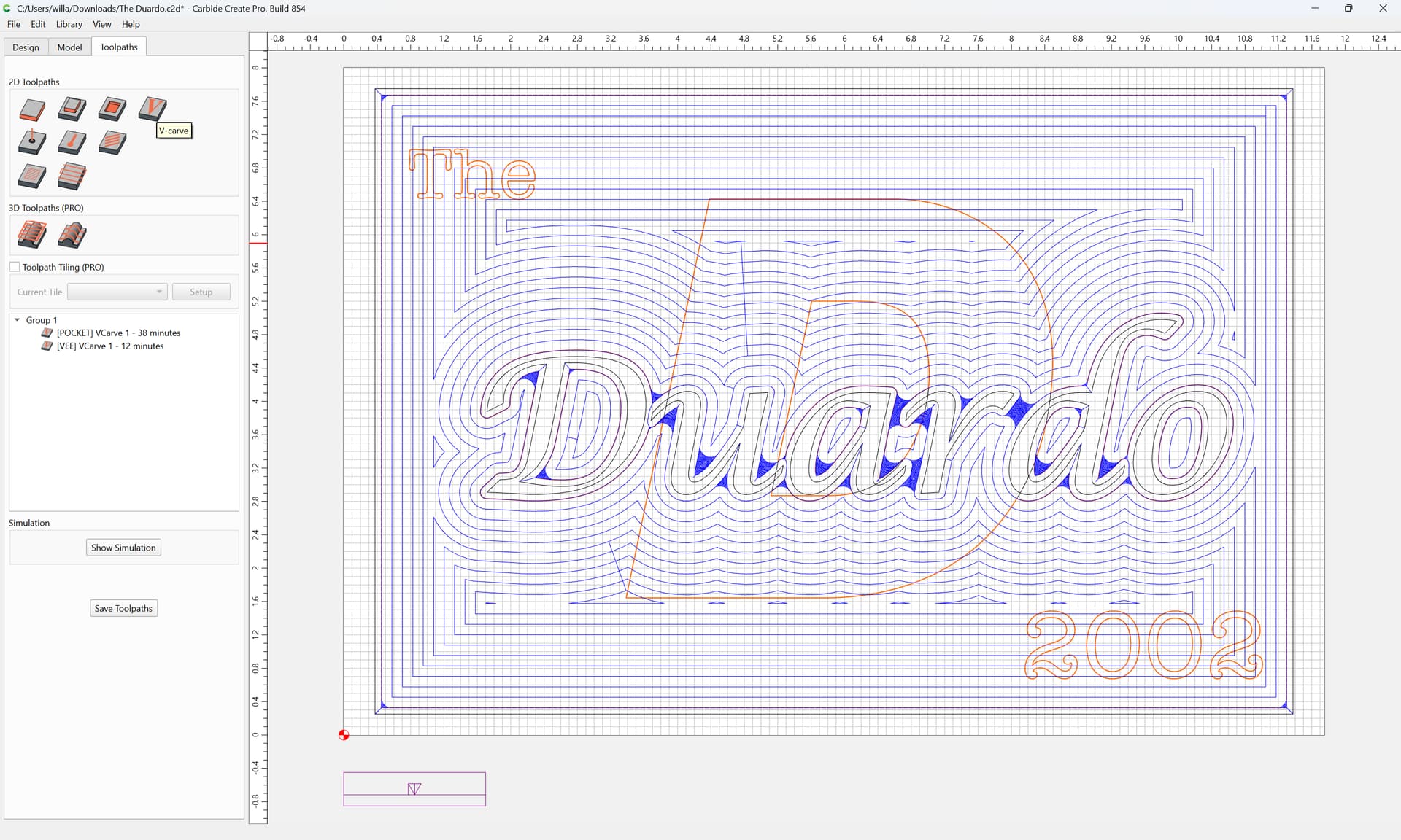

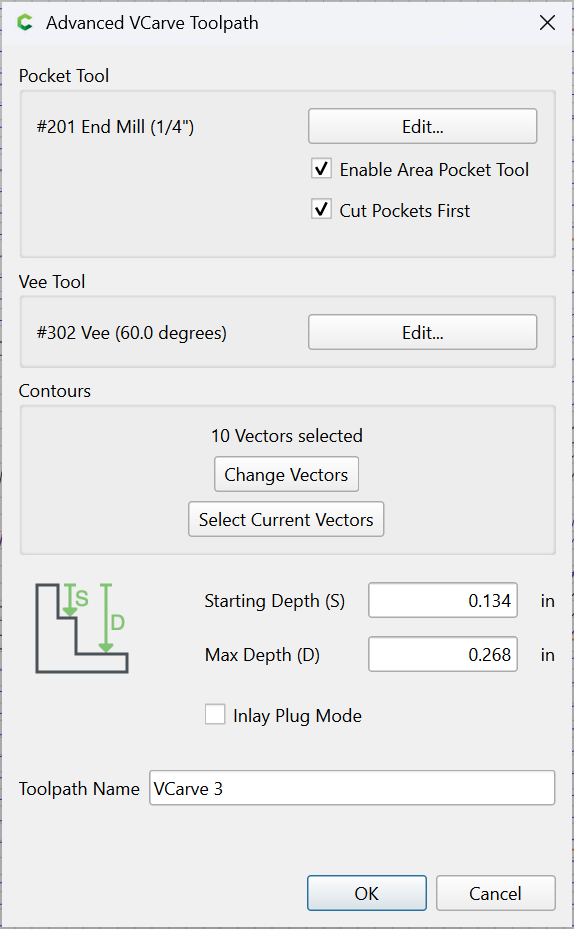

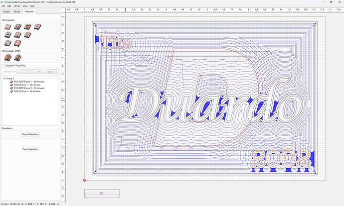

Start a V carve at the bottom of the previous pocket:
Attached as a v8 file (with the type converted to curves)
The Duardo_curves_v8.c2d (488 KB)
Good Morning William,
Thank you for taking the time to provide me Step-by-Step instructions, the final result looks awesome. The font is just fine as well, i will follow these steps and look forward to seeing the results.

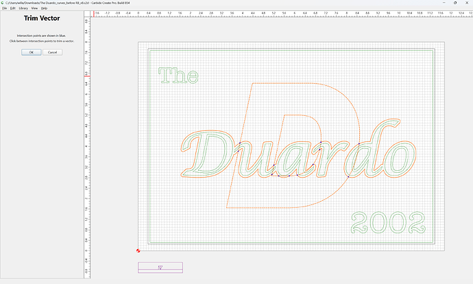

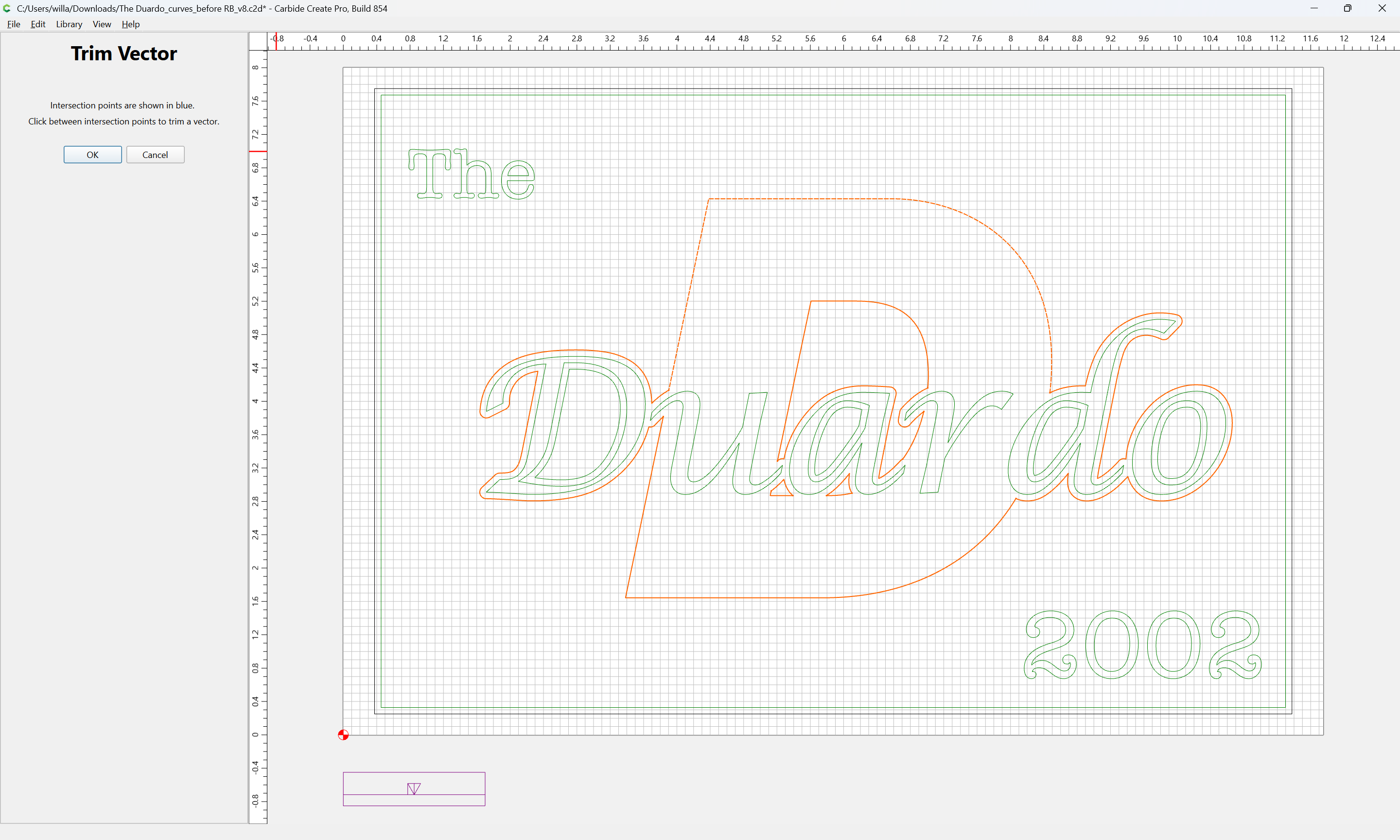

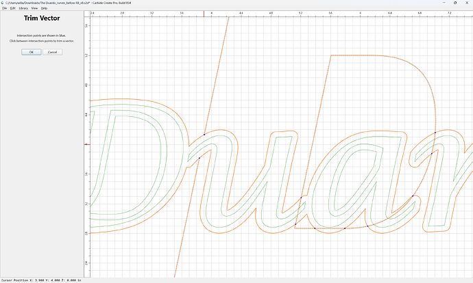

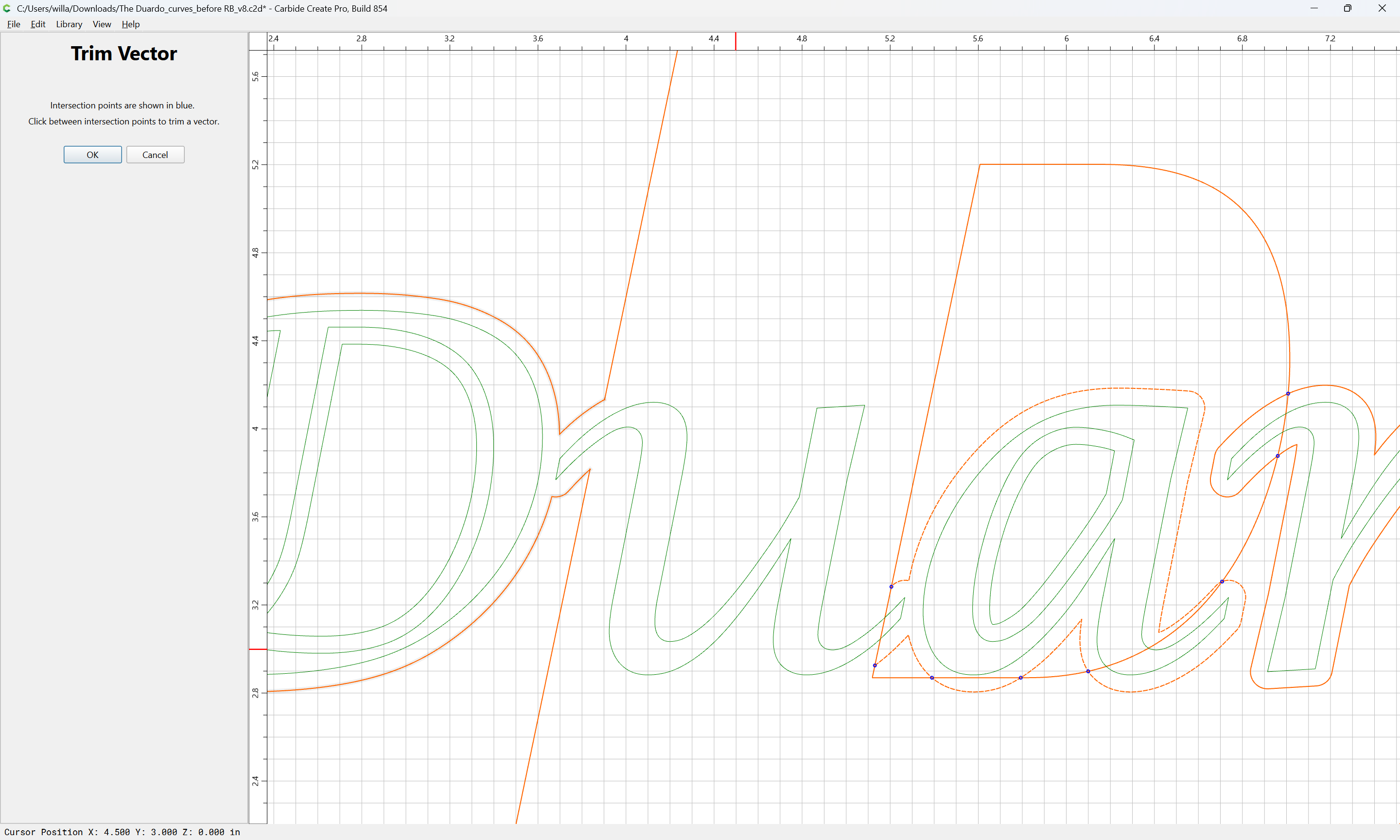

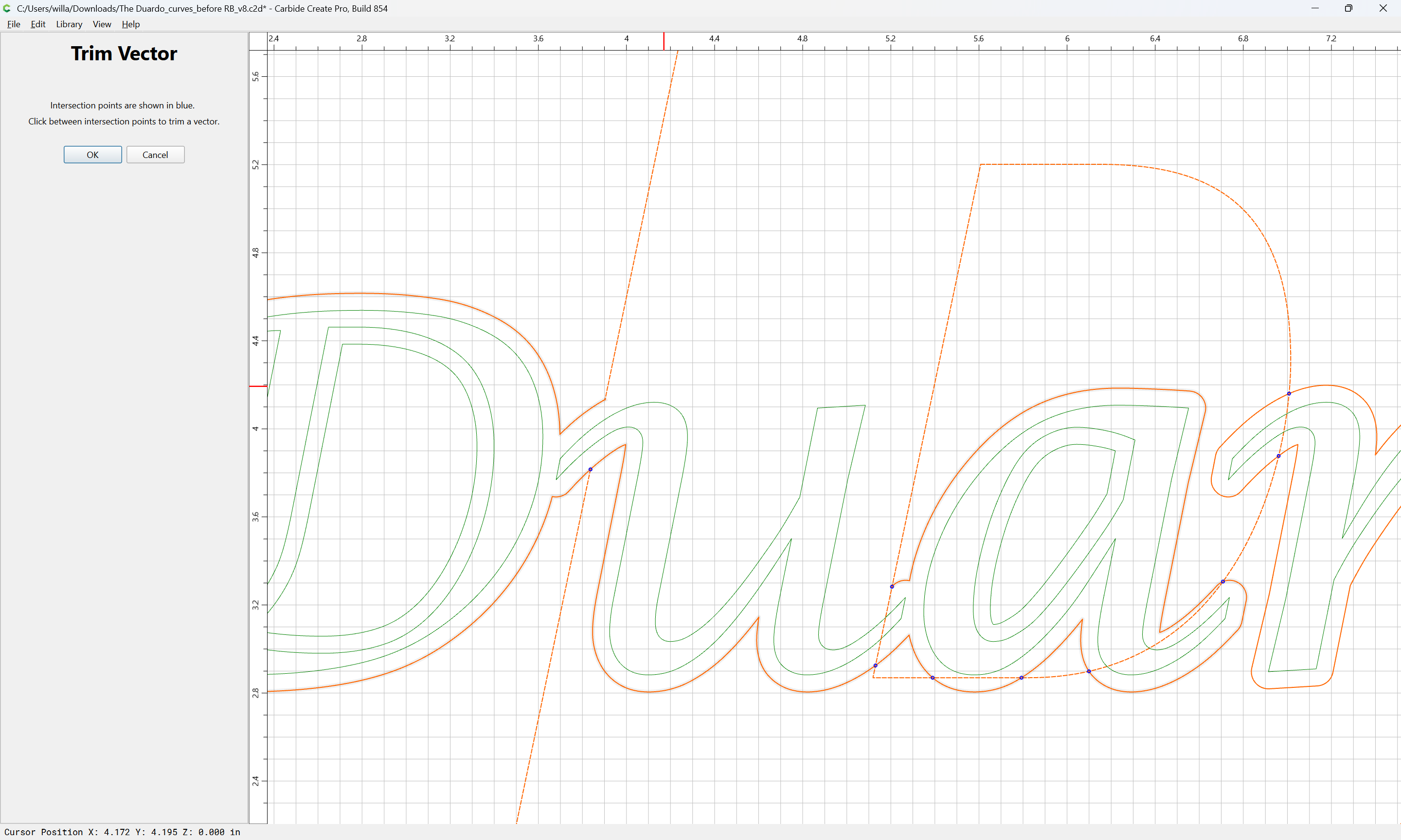

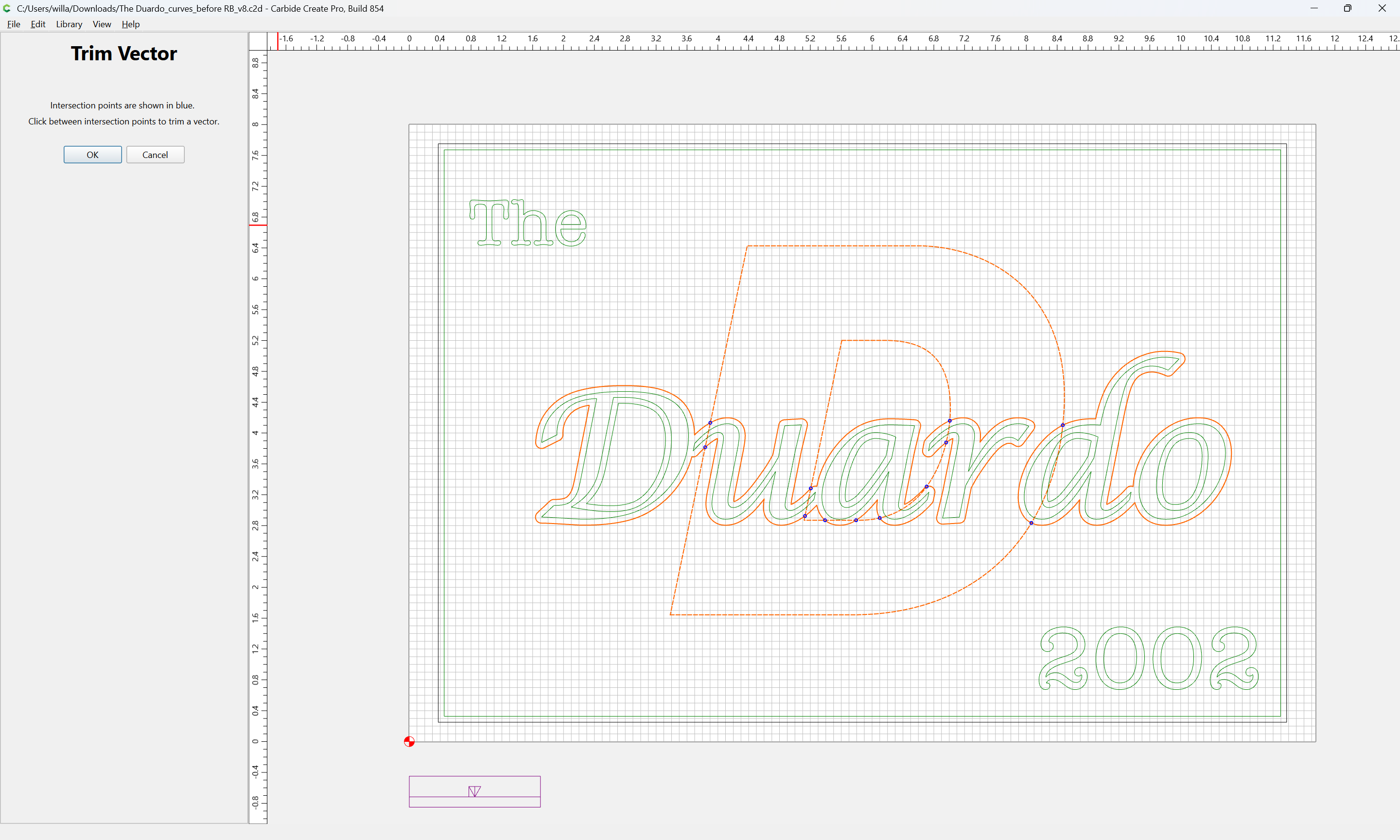

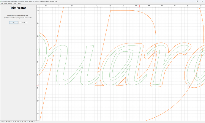

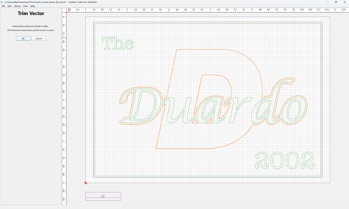

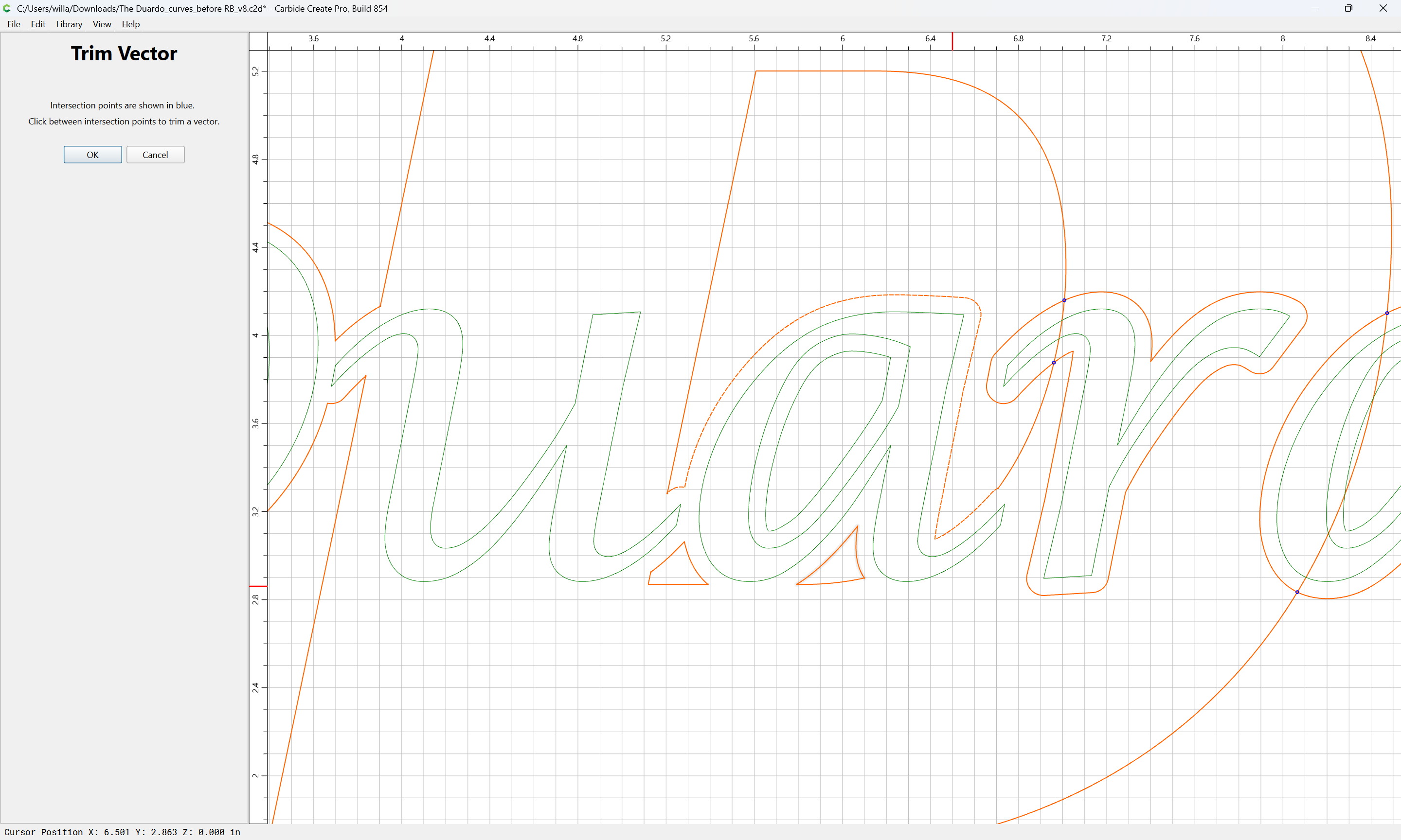

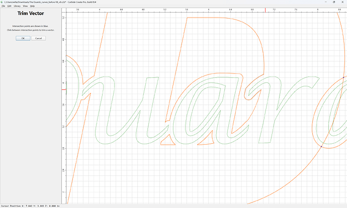

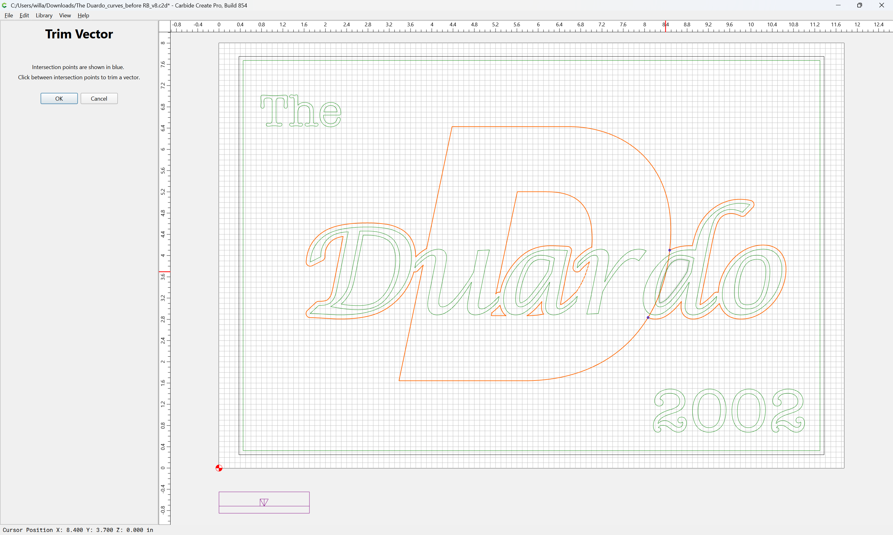

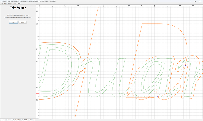

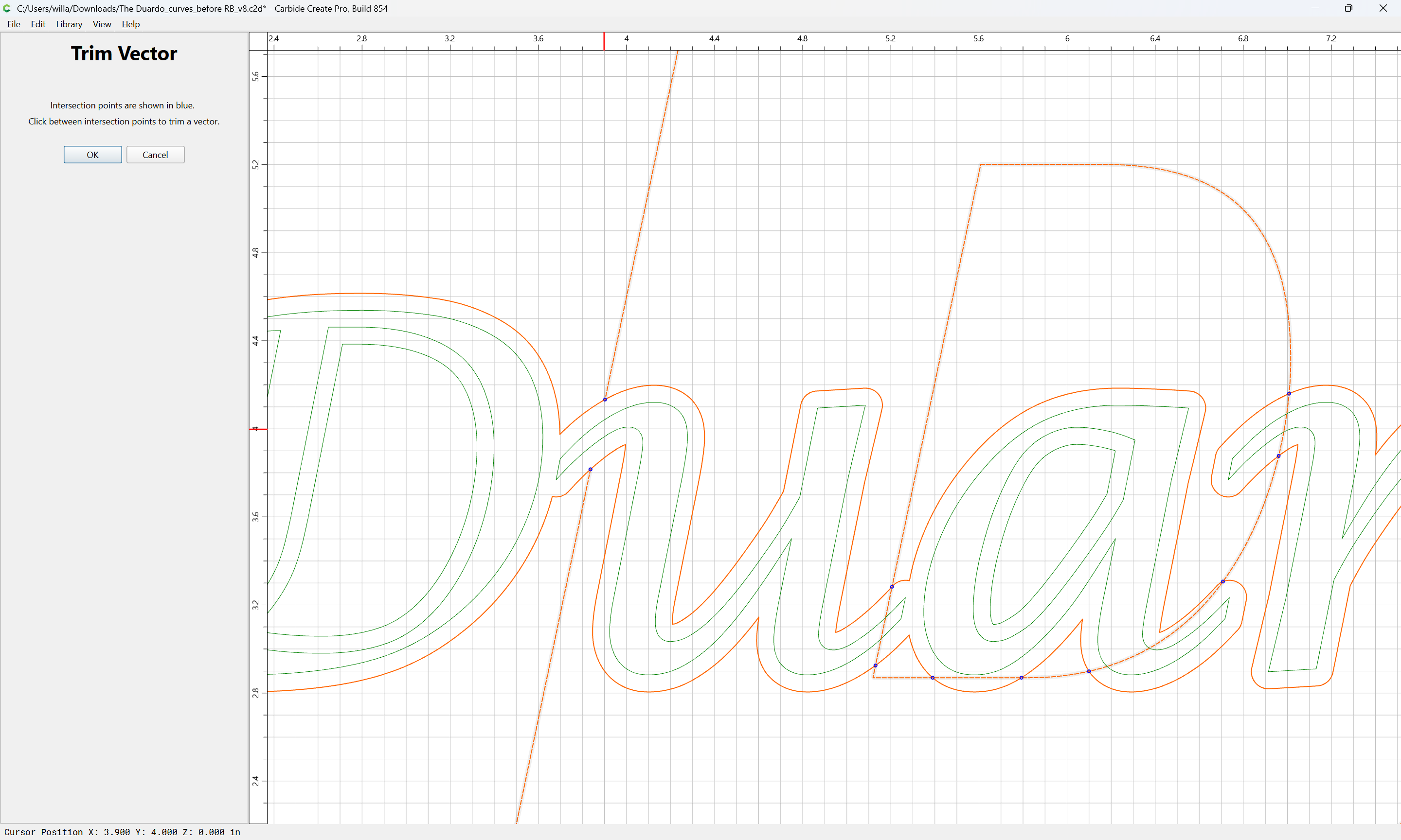

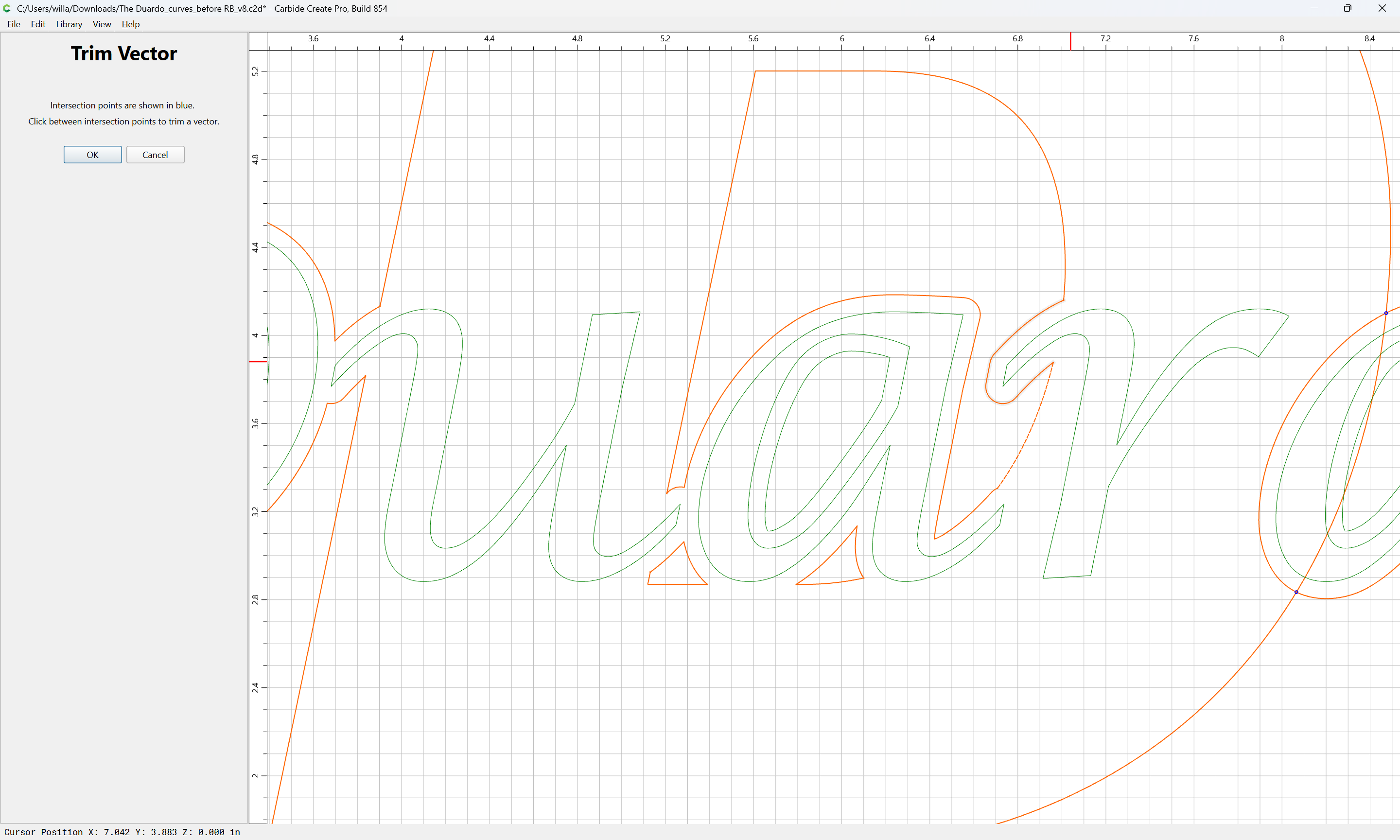

I glossed over a small issue with the results of Region Builder (filed a bug report) — see the above links for using Boolean operations/Trim vectors — if need be, we can walk through that with you.

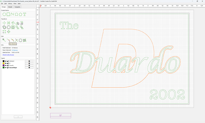

To do this with Trim Vectors:

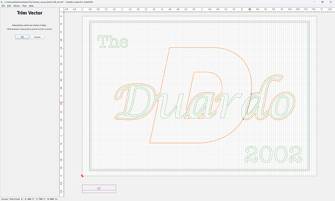

click on the lines which you wish to remove:
Until one arrives at:
OK
OK

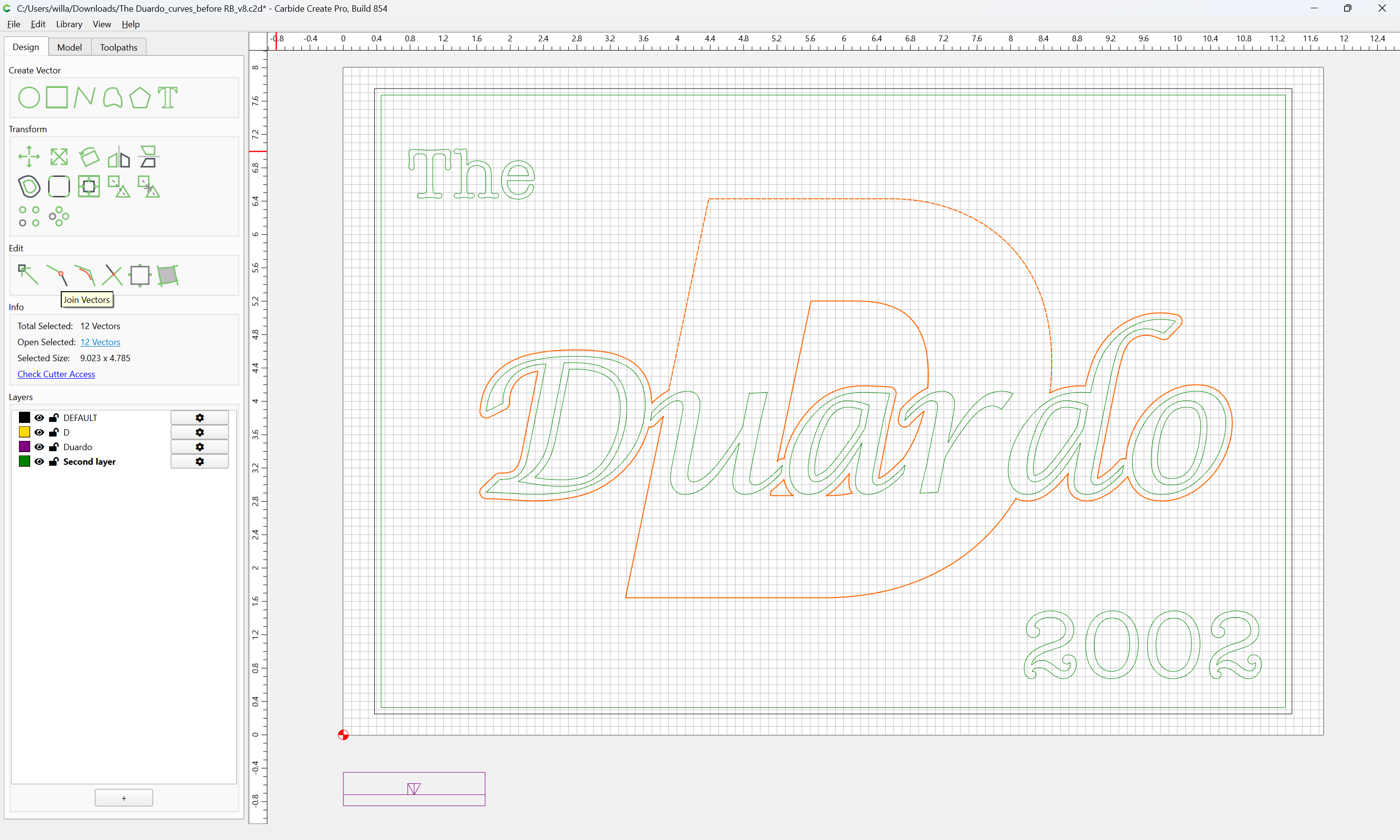

Join Vectors
Yes
