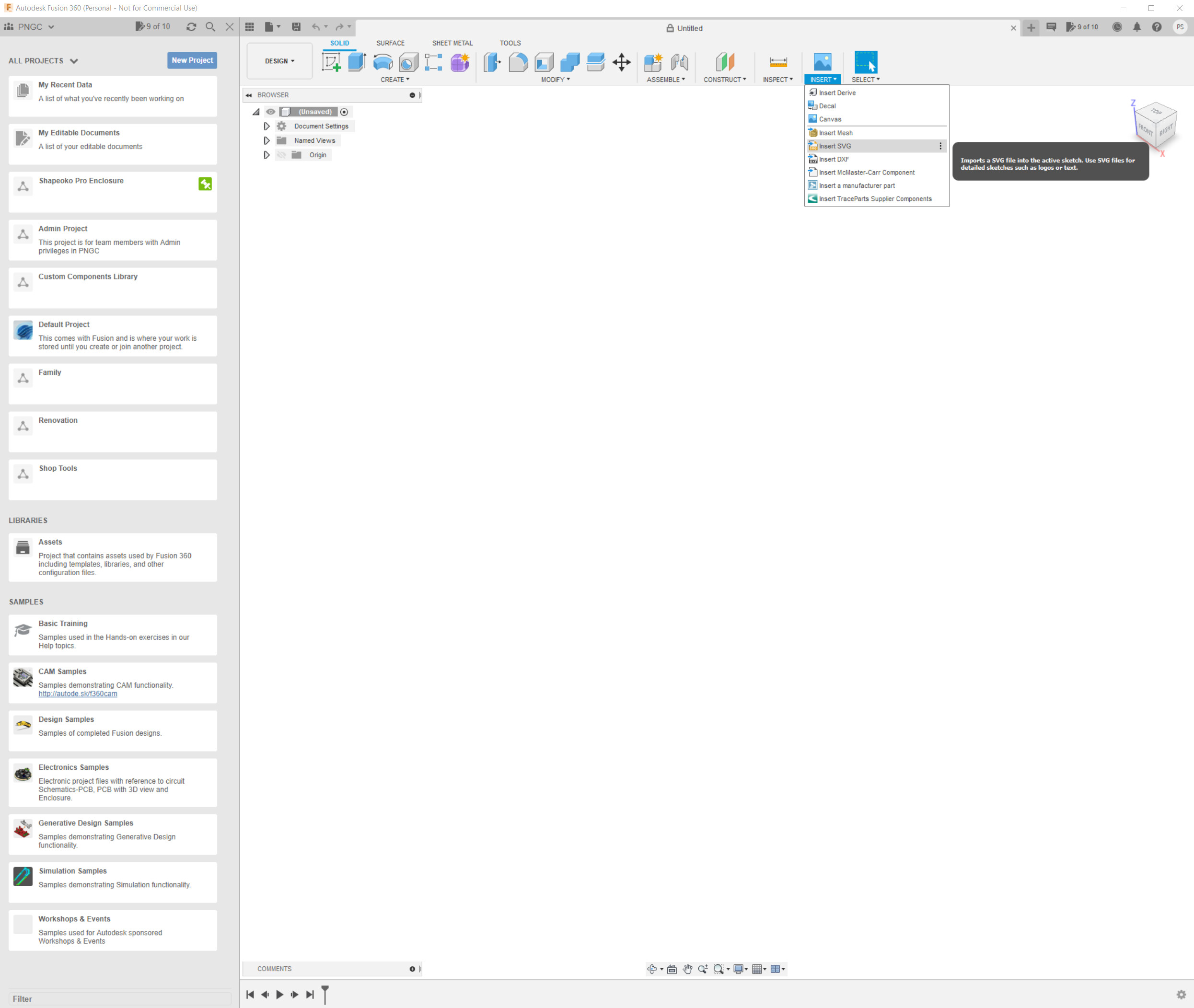

I was wondering if anybody can point me in the right direction of replicating a 2D template. I’m looking to cut a dash panel for a plane out of 6061-T6. I use carbide create for basic design, but I will be using fusion 360 for this one. I’ve done some research but haven’t been on a find anything with respect to 2D objects, most of the information is on 3-D modeling. Basically, I’m wanting to take existing dash panel and copy the outline since it has a curved profile. I didn’t know the best way to take the existing design and model it in fusion 360. I appreciate any help as far as software, or techniques. It’s not something I want to spend a bunch of money on since I don’t do this often, but I would like to know how to do it for the future as well. Thanks!
I’ve never done it yet but if it was me I’d try setting it flat on a surface of a color that would provide much contrast to the item (ie. kind of like a green screen) and take a picture of it. Properly lining up for the picture is important to minimize any keystone effects. Then I’d take the picture into a software like “Inkscape” and use the “Path > Trace Bitmap” tool in order to get a vector graphic of the panel you are trying to reproduce.
Once this is done you can save it as a .svg file and import this directly into Fusion 360.
(Edit: Carbide Create also has the trace image option/feature so maybe that’s another route once you have the picture but mentioned the Fusion 360 route since that’s what you mentioned in the original post)

3D scanning with a camera (photogrammetry) probably won’t get you the accuracy you need for this piece. Since it appears to be a flat piece of sheet metal, the approach I would take is to take a photo of the panel as flat as possible to avoid distortion, with a ruler next to it as a calibration guide for size.
Then import the image into graphics software and manually trace the shapes using the vector tools. Inkscape or Illustrator, for example could be used for this, however Fusion 360 is also capable, and would save an import step. You can use the various sketch tools: line, arc, spline, etc. to do this. Here’s just one of many YouTube videos on the subject. Fusion also make it really easy to scale to sketch to the correct size.

Thanks, that’s very helpful. I will probably go that route. I shot a photo over my self-healing mat, so that should give me scale. Tracing directly in fusion 360 probably gives me the easiest result.
It’s still just amazes me that with all the technology in something like an iPhone, you basically have to manually do a task like this.
Thanks for the detailed reply, I definitely used some of your suggestions. I did re-shoot my photos with a larger zoom lens, which did help with the lens distortion. I ended up shooting it on a self healing ruler mat, using the 50 mm Zoom lens on my iPhone. I turned on the grids and shot straight down. That allowed me to line up the grids on the phone with the grids on the mat, the phone also provides a indicator when it’s level.
From there I imported it into fusion 360 as a canvas. I didn’t realize the function was in there, but I found the calibrate tool under the canvas. That allowed me to set two points from the dimensions on the mat and calibrate those to the correct size for a perfect scale. I just use the vector tools and fusion 360 which work pretty well. I was able to trace it with a really high degree of accuracy and it looks really good. Most importantly, once I figured out the process it only took a few minutes to trace.
