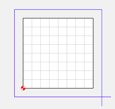

I need to cut out square geometries without chatter or stalls on aluminum (5052). I’ve tried to use contour and adaptive, but even while adjusting the settings, I still get the same issue because I’m not starting off the entry with clearance but with fresh material engagement. What’s the best strategy when it comes to cutting aluminum including any factor to help remove chatter or stall? (I’m using 2 6mm 3 flute squared end mill)

If you want the tool to lead-in, lead-out, create some offset geometry using the cutter radius + the stock to leave. Cut the vector in one corner, and drag the 2 end away from the stock.
Use a contour path with no offset to follow the curve.

The trick is creating a separate offset for each pass, based on the original size of your stock.
You could use another contour or cutout path to rough the stock down to 0.010, then use the broken offset path as the last finish pass. On 5052, I might try roughing down to 0.010", then doing 2 clean up passes at 0.005"
