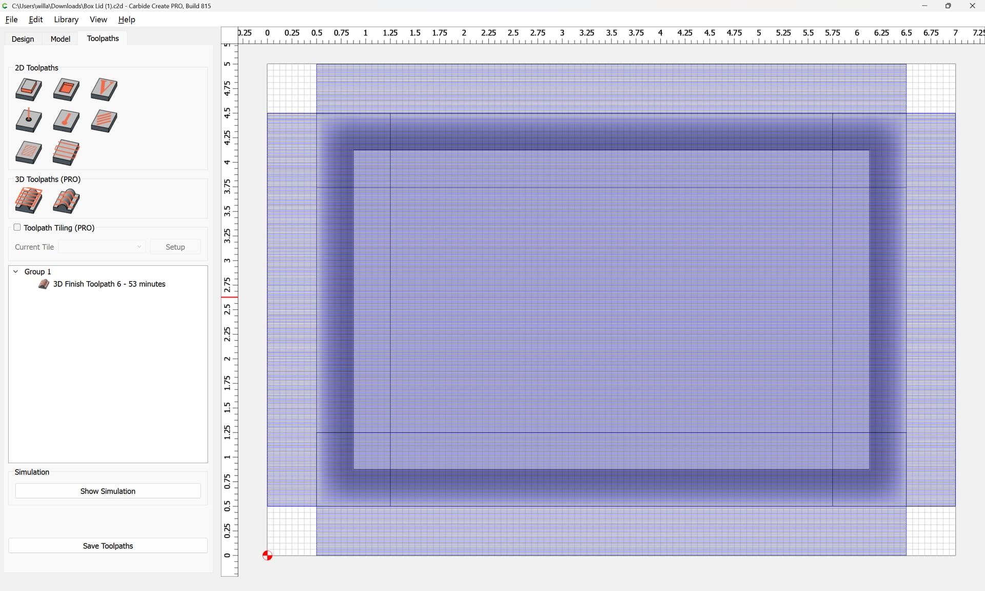

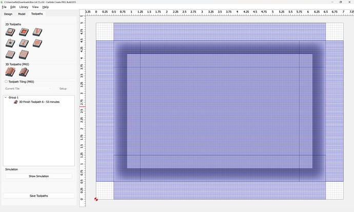

That file only has a 3D Finishing toolpath:
You’re going to have a rough time if you try to cut w/o a 3D Roughing toolpath first.
Please see:
https://carbide3d.com/hub/courses/create-pro/3d-toolpaths/
You said “you shouldn’t need multiple 3D roughing Toolpaths for a single model” so I took this as not to use the roughing Toolpaths…
So how do I do this properly ? I am not understanding how to set these toolpaths up
Your original file had 2 3D Roughing toolpaths — I was suggesting removing 1, and the screen grabs I posted reflected that.
Misread… by “don’t need multiple” he meant “only need 1” :wink:
so only one of the Toolpath rectangles need to be selected ? If so why was I told to make two rectangular toolpaths as above ?
Also for the roughing what size and kind of end mill should I be using ?
Were the settings for the 1/8" ball nose for finishing or roughing ?
You had multiple toolpaths cutting the same thing. One rough toolpath should remove all the material & get you close enough for finishing.
For roughing, the largest endmill your machine will handle & that will get enough material cleared depending on the level of detail.
Same rule of thumb for finishing, use the largest ball mill that will get into the detail you need.
The larger the ball mill, the smaller the scallops and you can use larger stepovers to reduce cutting time. :wink:
