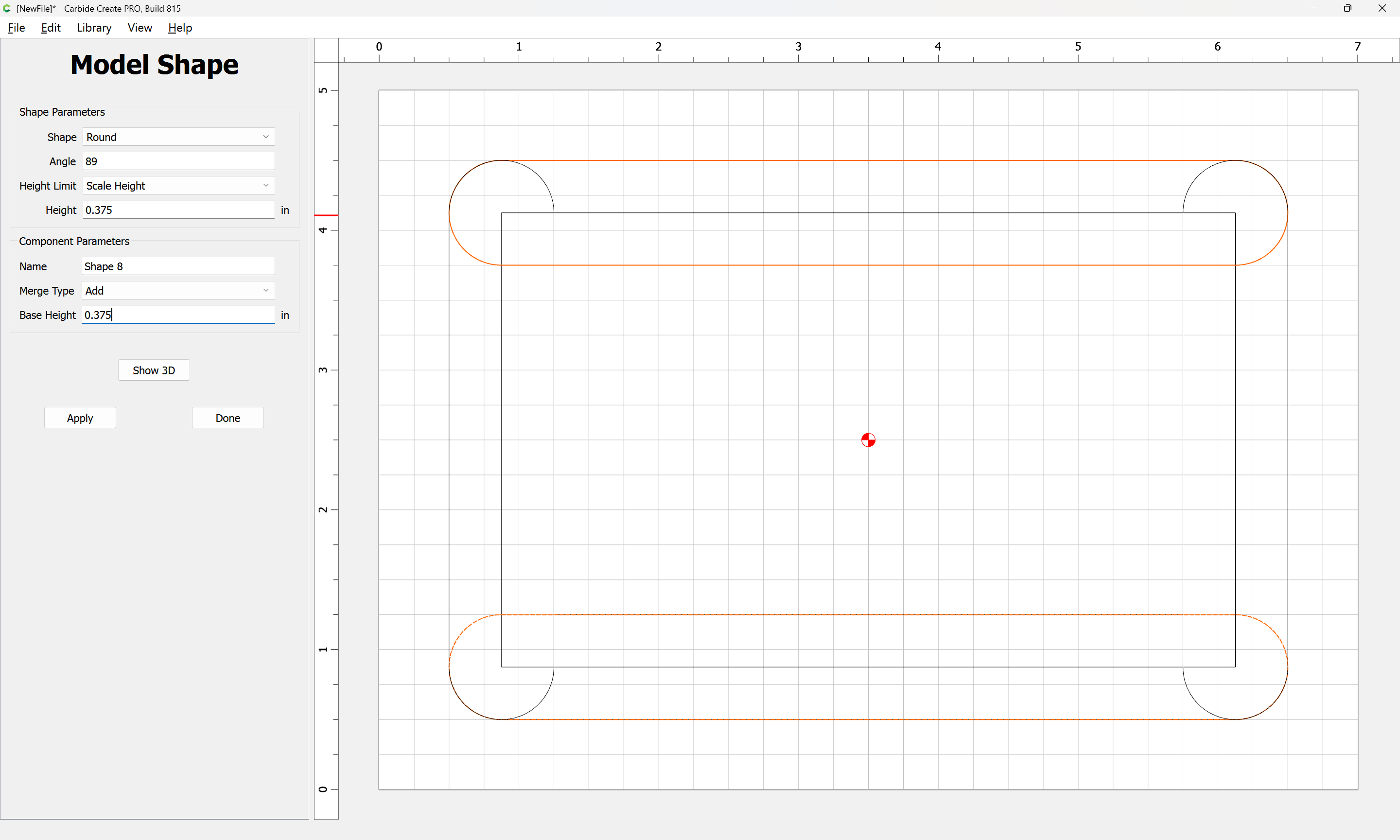

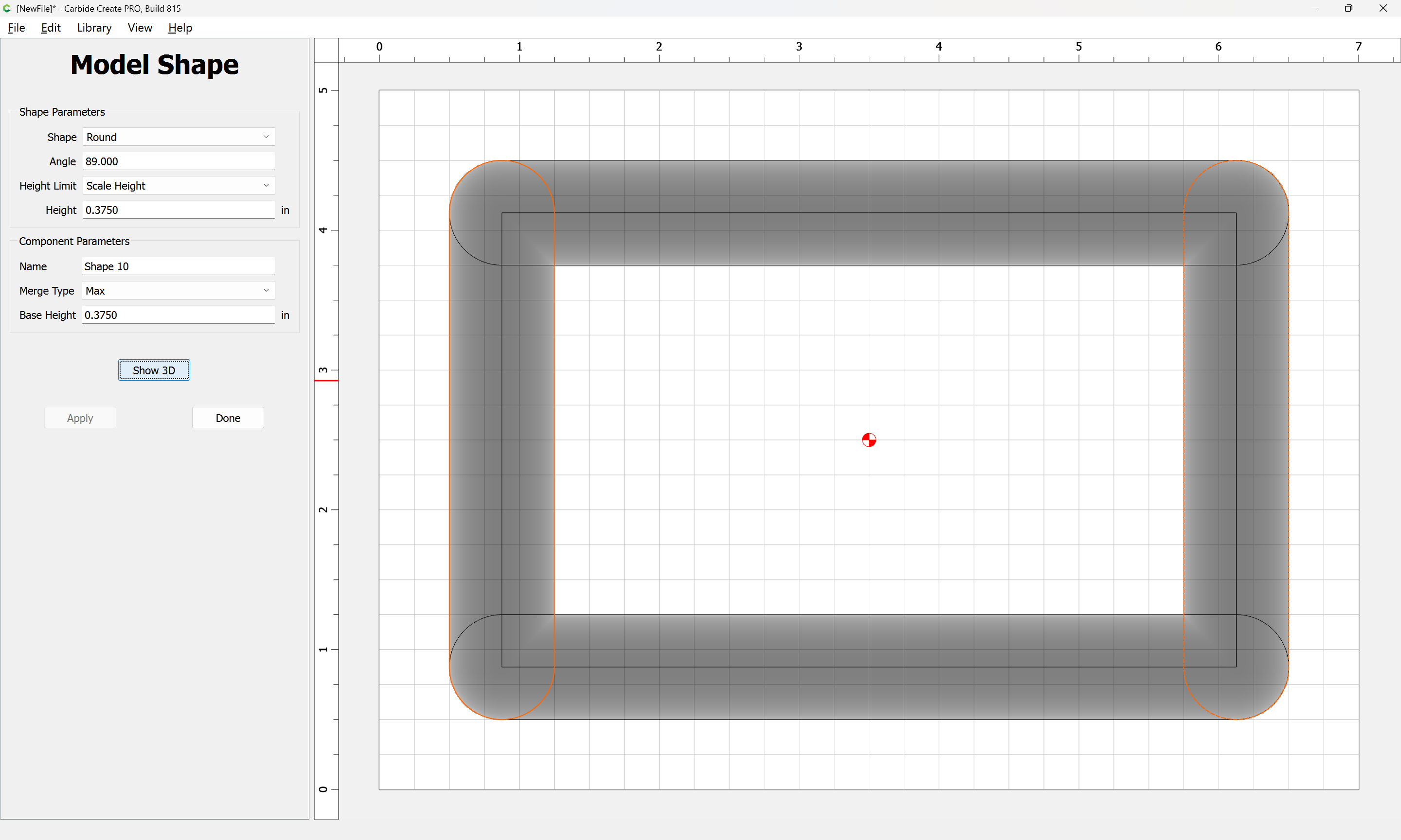

Given the image:
and

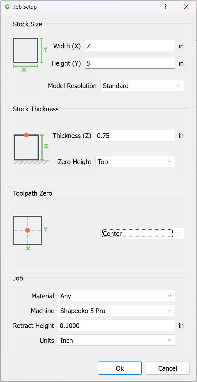

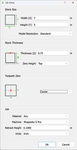

we launch Carbide Create Pro and set up the job:

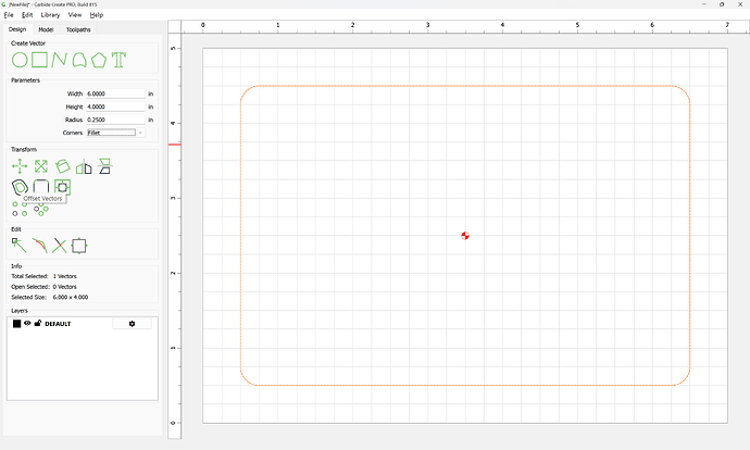

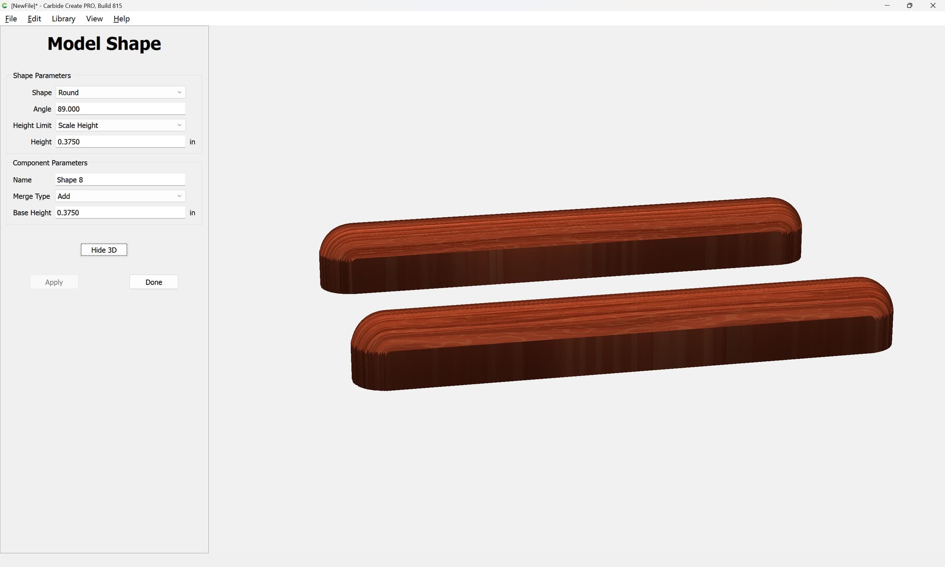

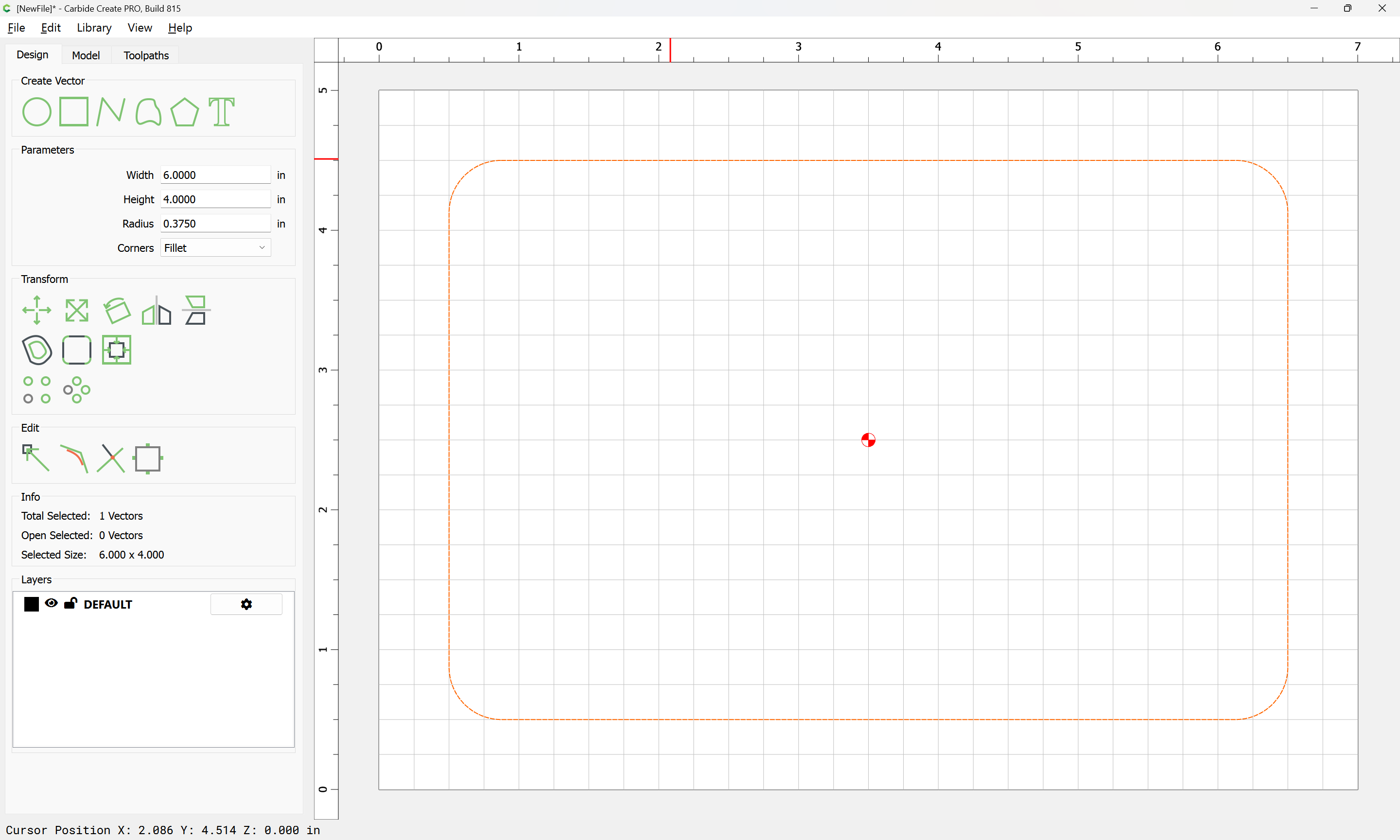

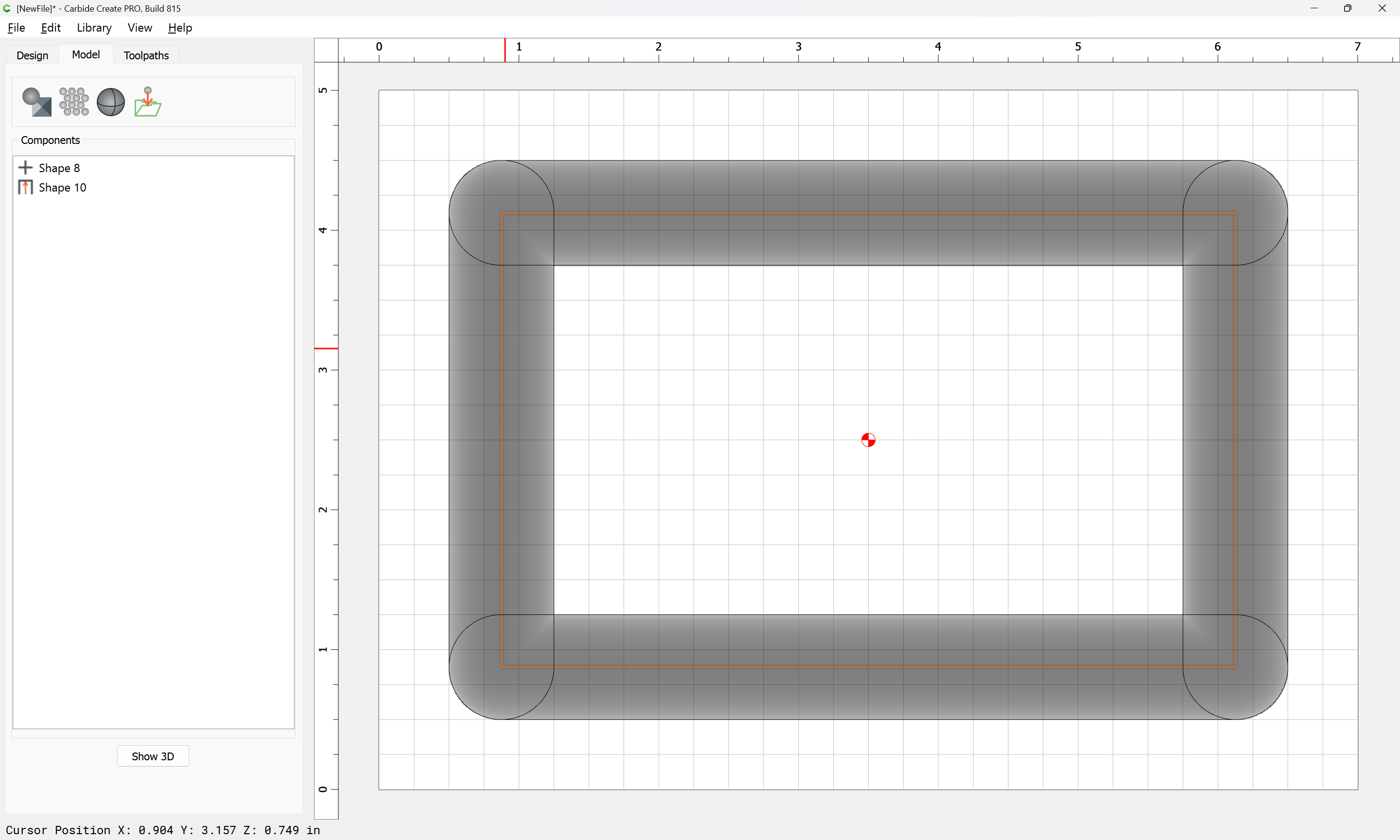

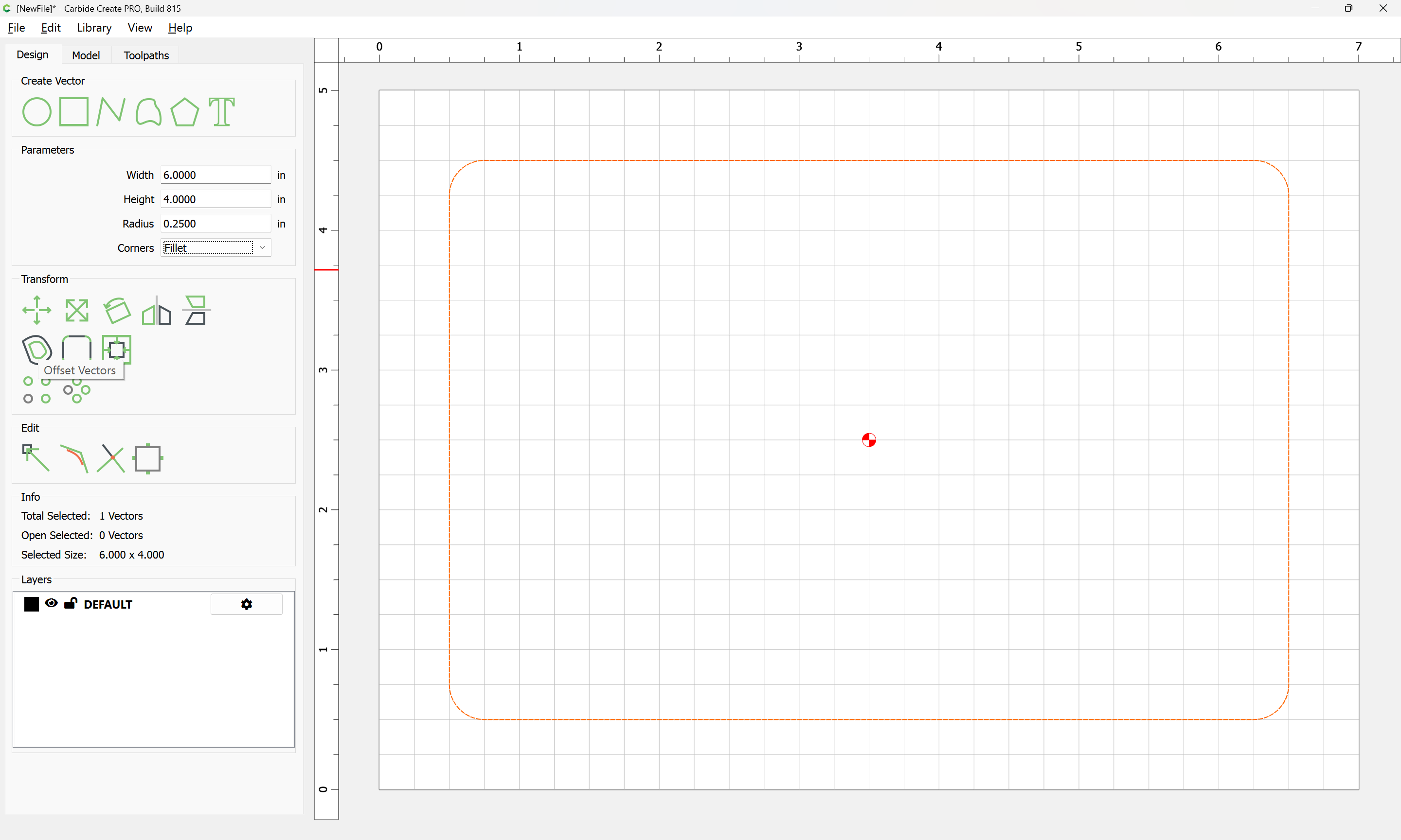

Draw a rectangle for the part:
and set the corners to match the rounding:

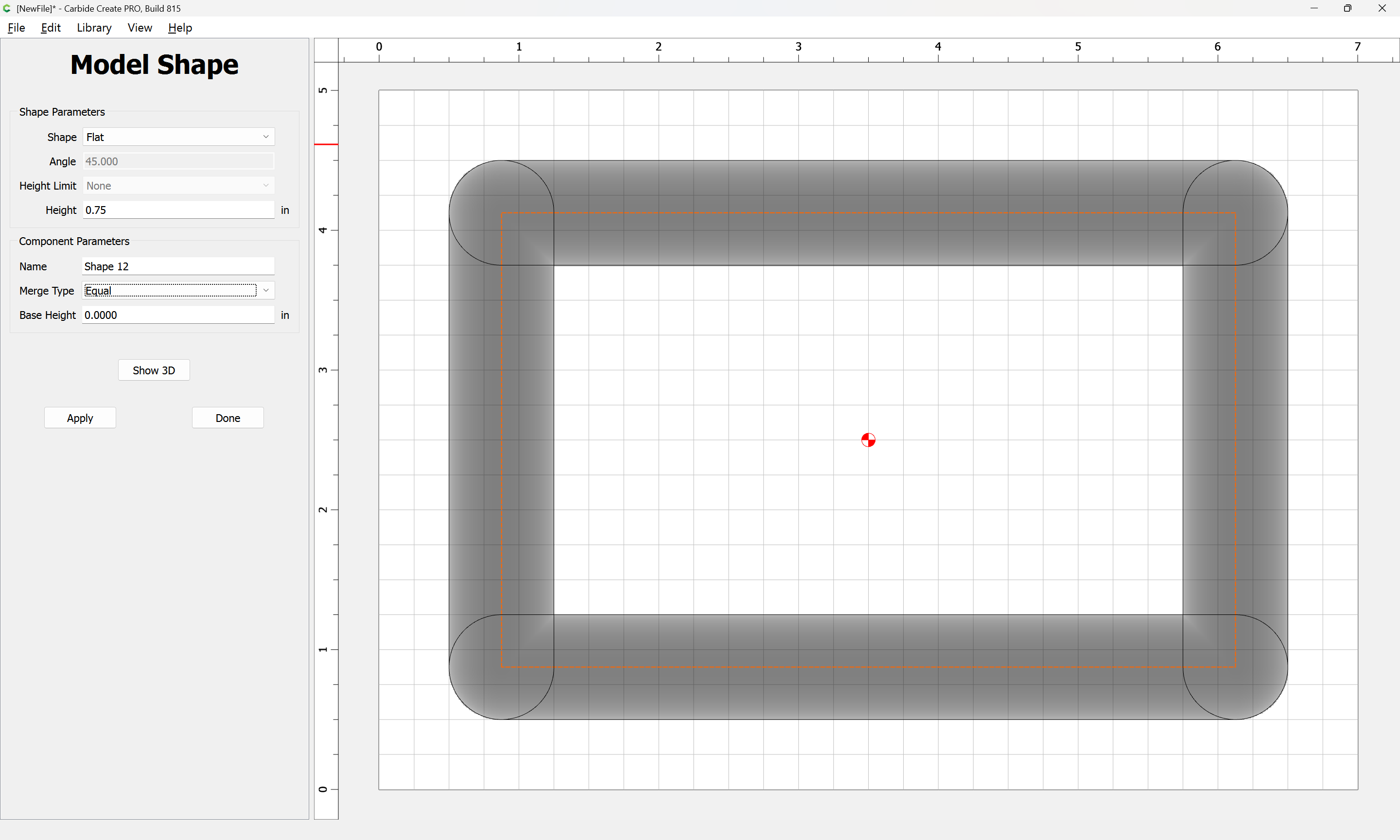

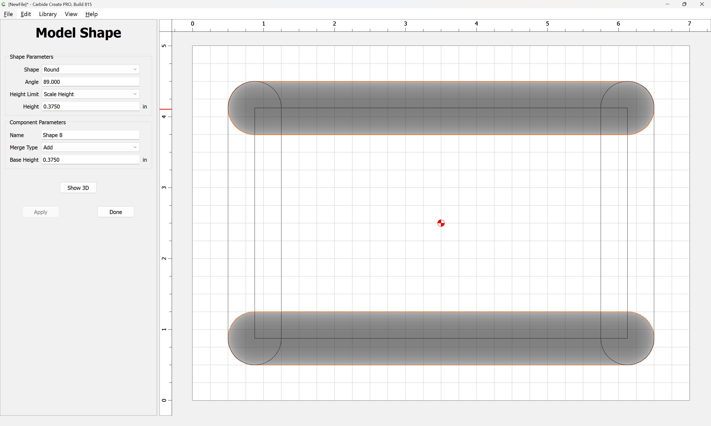

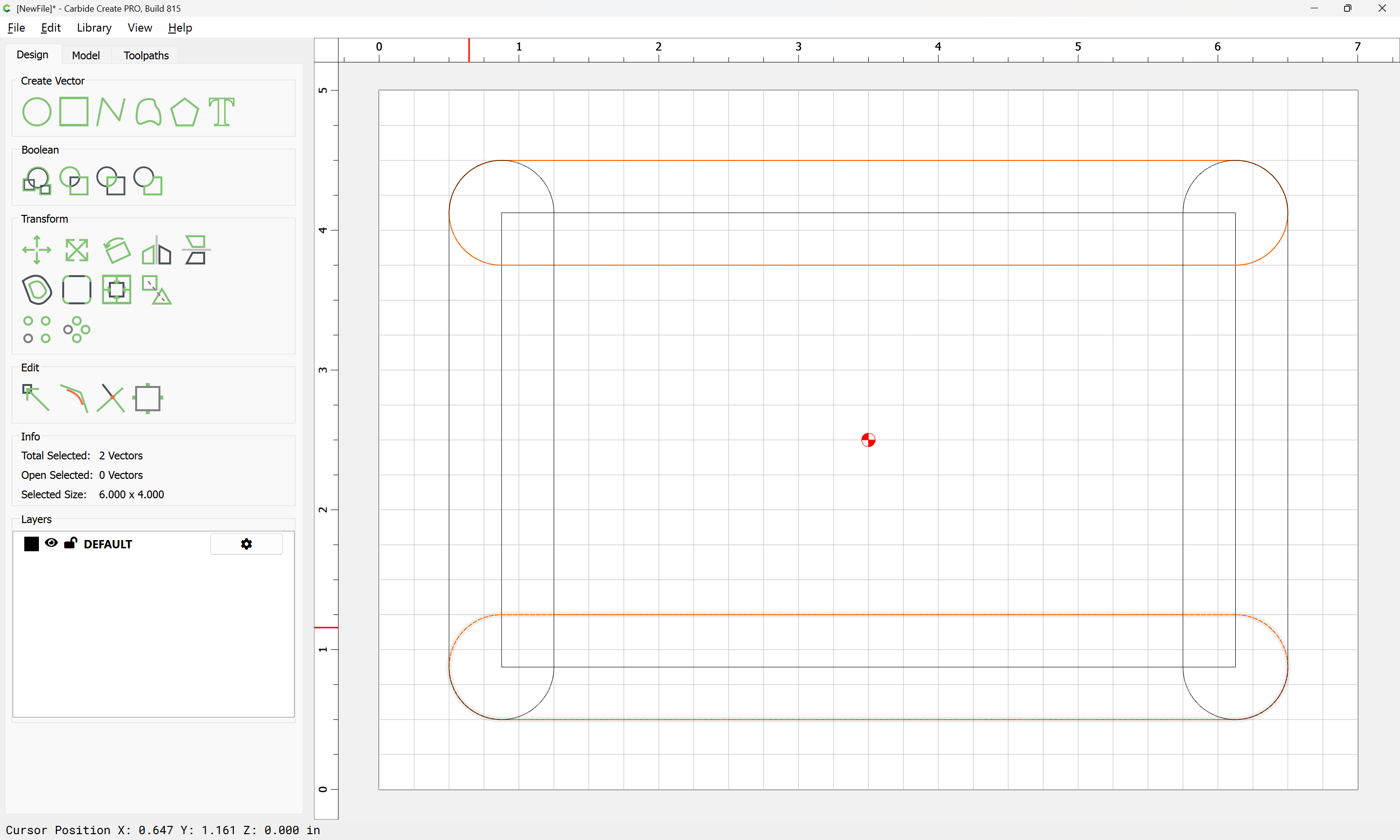

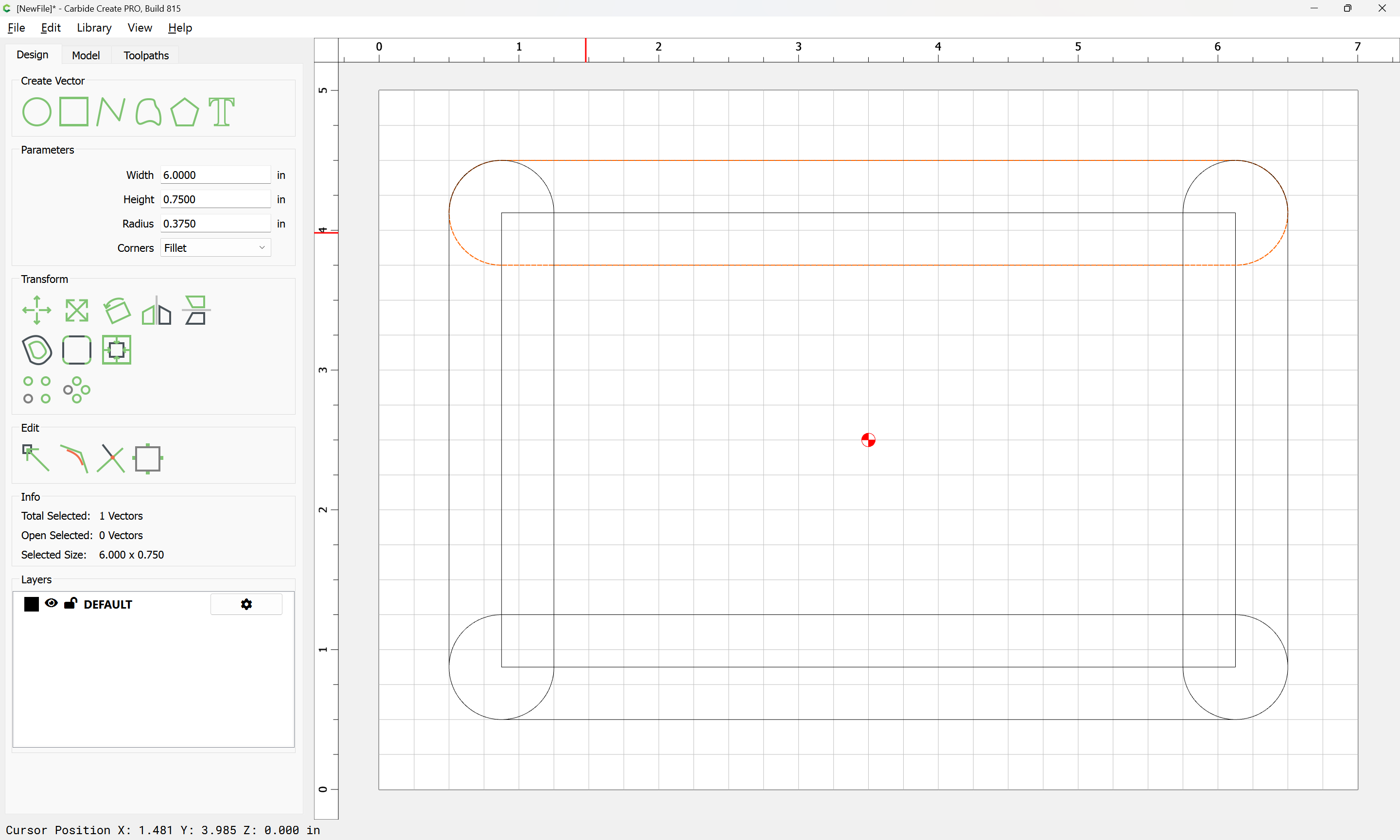

Note that because this design has essentially joined elements, it will be necessary to model in pieces:
Apply

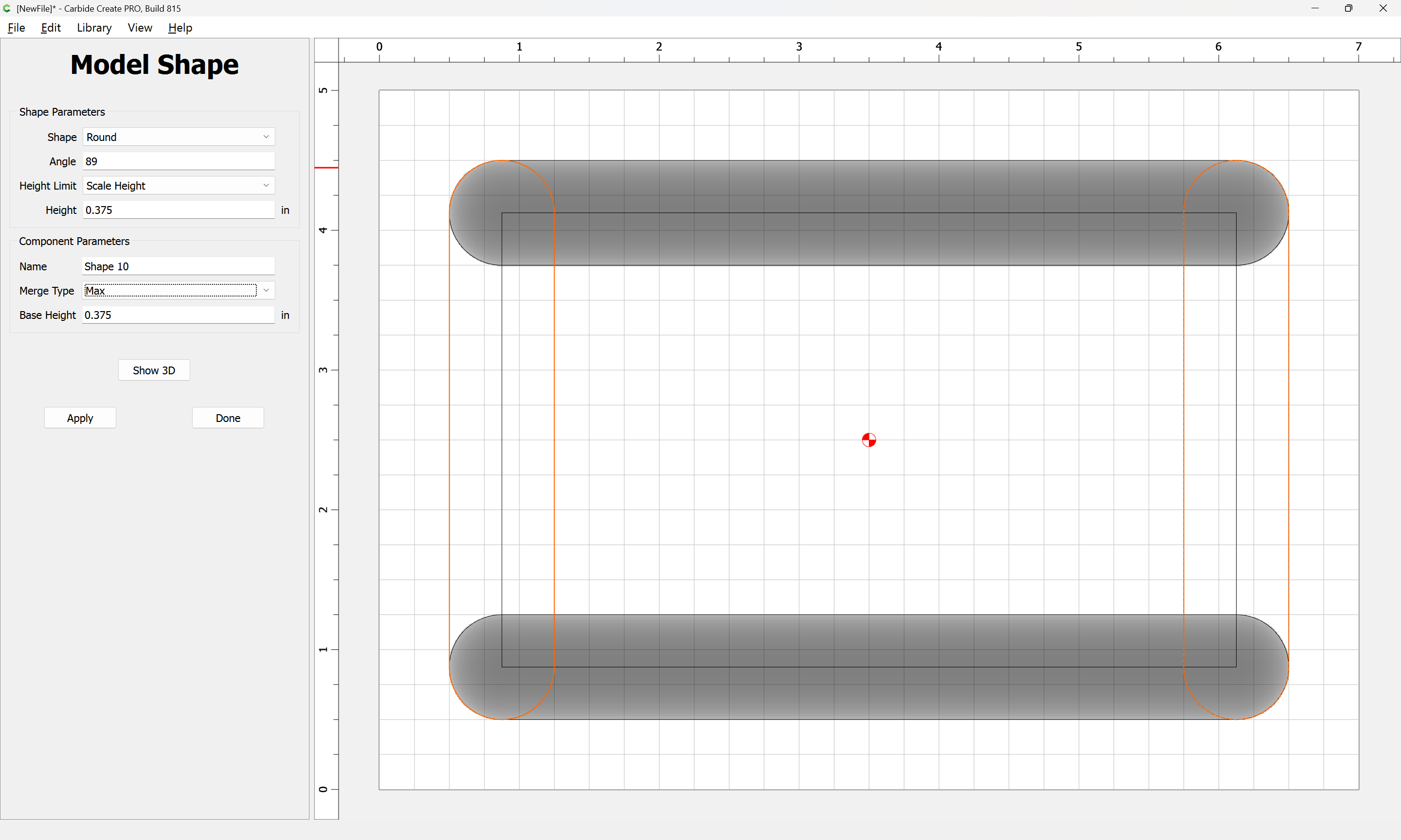

Repeat for the sides:

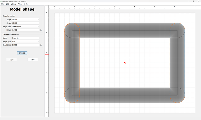

changing the Merge type to “Max”:
Apply

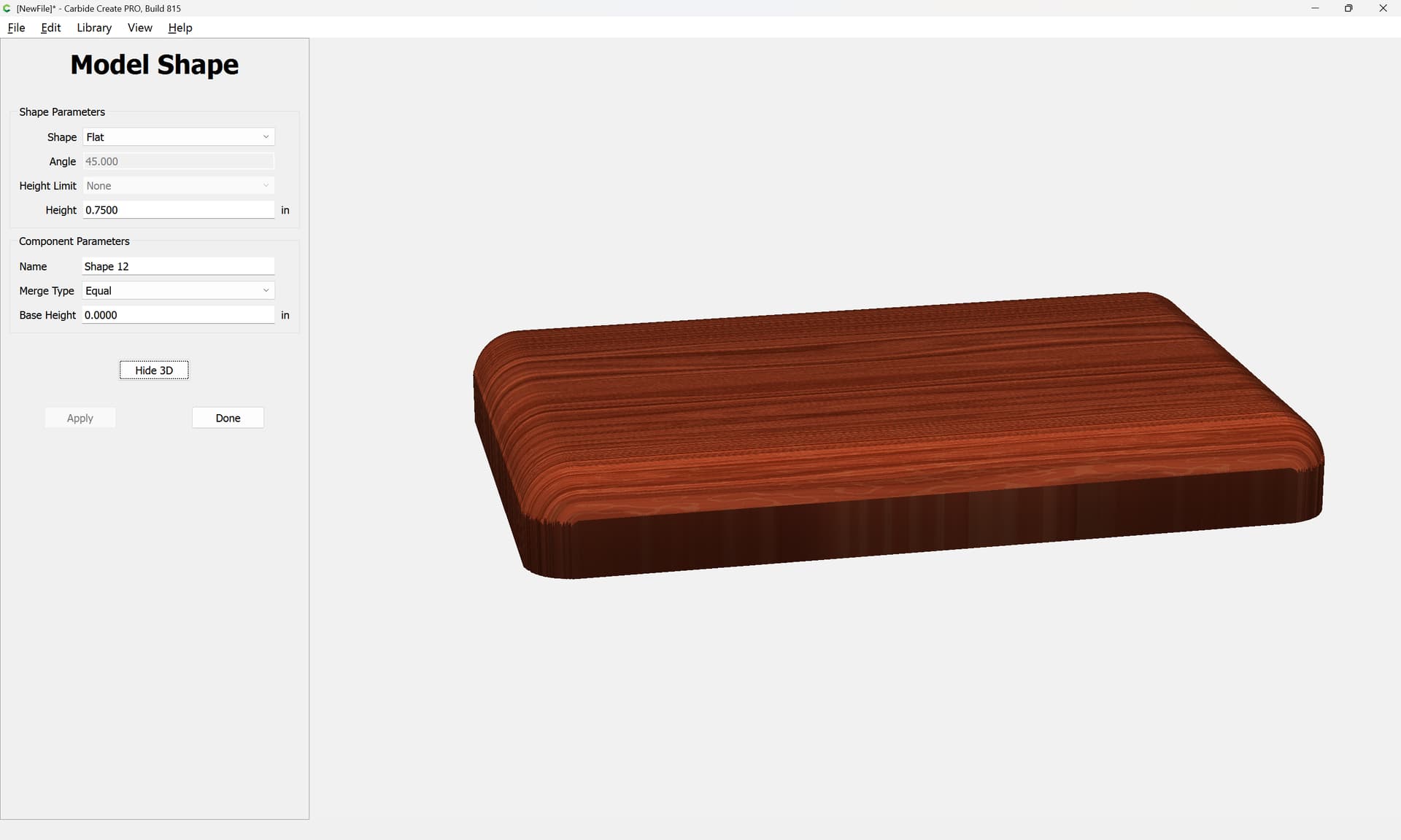

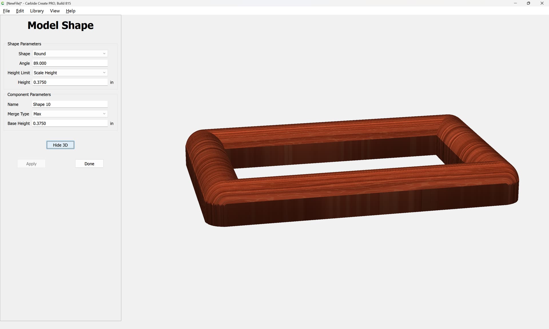

Show 3D:

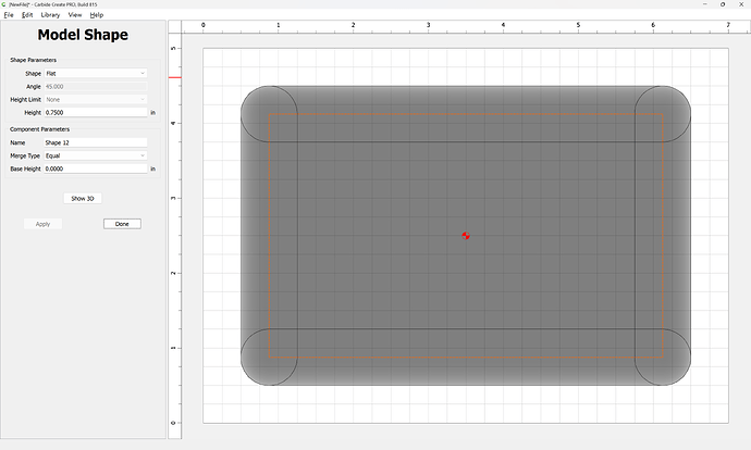

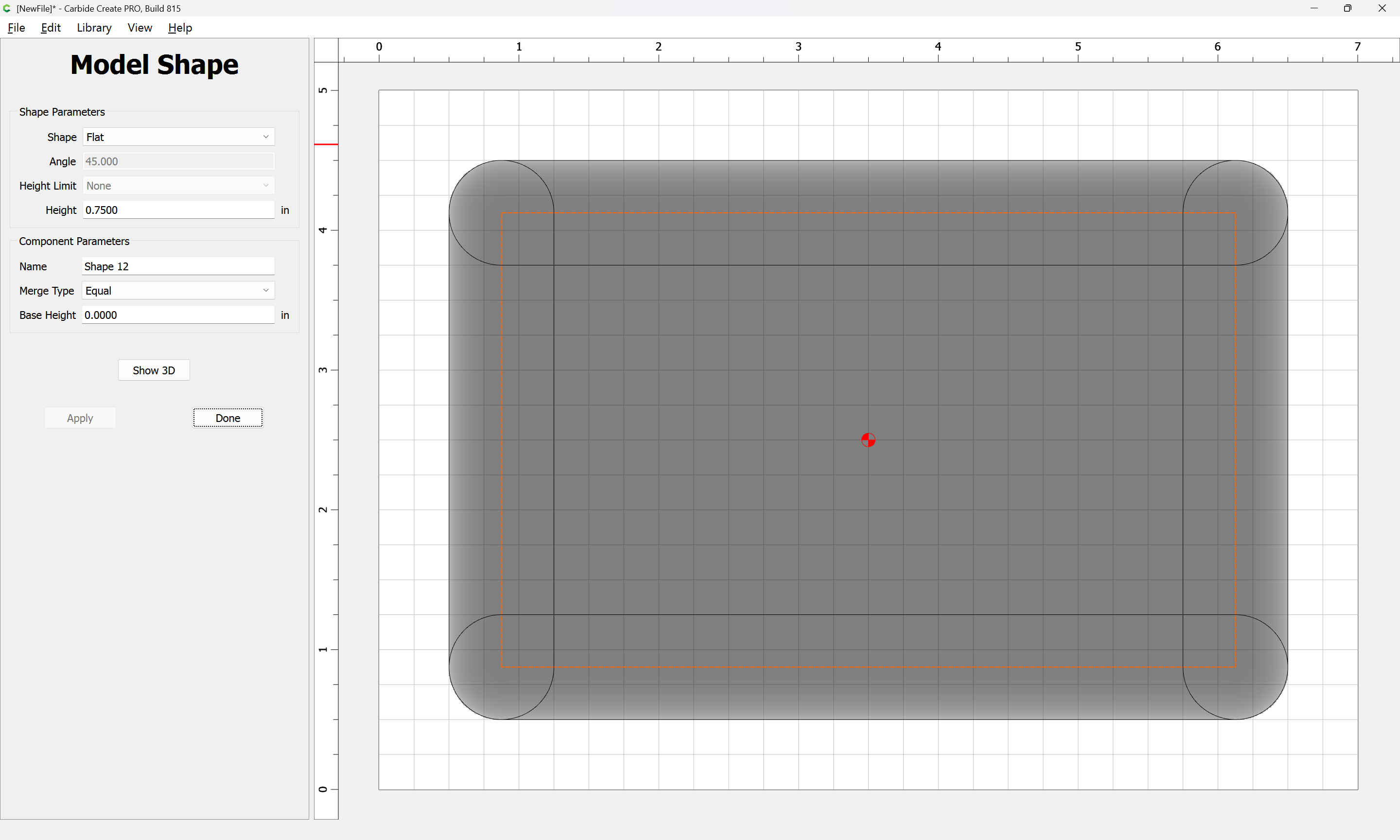

Select the first inset:
and model it as Equal to the desired height:
Apply
Show 3D:
wow, thank you this is close to what I am looking for. Two questions
  1. how would I make the rounding so it extended to the bottom (I basically want to make it look like quarter round.
  2. how do I apply the rounding but have the corners be square so that each corner comes to a point like as if you mitered 3/4" quarter round moulding together at each corner. The reason for this is the box will be square. so this way the lid matches the box.

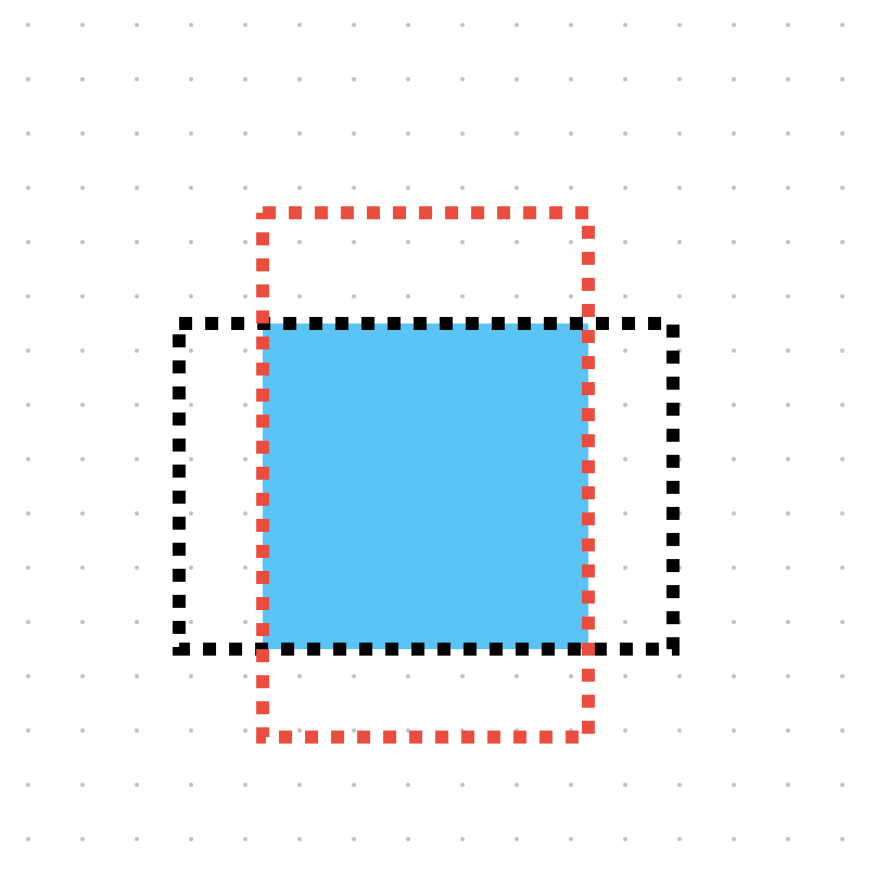

To make the corners “square” as you mention above you will need to start the toolpath before the side you rounding over and have the toolpath go past the corner. In essence draw two more toolpaths, basically making a rectangle of the top and bottom of the square, then make another rectangle for the right and left sides of the square. This way the roundover does not change path on the exact corner (90 deg) resulting in a complete roundover of the 90”s.
If you want the roundover from the top to the bottom (one continuous curve) of the stock you have to have a roundover for the dimension of your top “OR” you have to machine the stock to match the roundover profile.
The square is your stock, 2 toolpaths. However, depending on the type/grain of wood you use you might get tear out. Which is why I usually do this with a trim router and use a climb cut on the corners or waste board to prevent tear out or chip out.
One rectangle black and one red to illustrate my ramblings above.
  1. Leave off the Base Height.
  2. I don’t believe that that sort of squared off geometry could be done directly in Carbide Create Pro — either the shape is correct, or one has to model larger and either cut off or force equal. Export the 3D model as a PNG, then edit the pixel image to square things off, or use a 3D CAD program such as Alibre.
