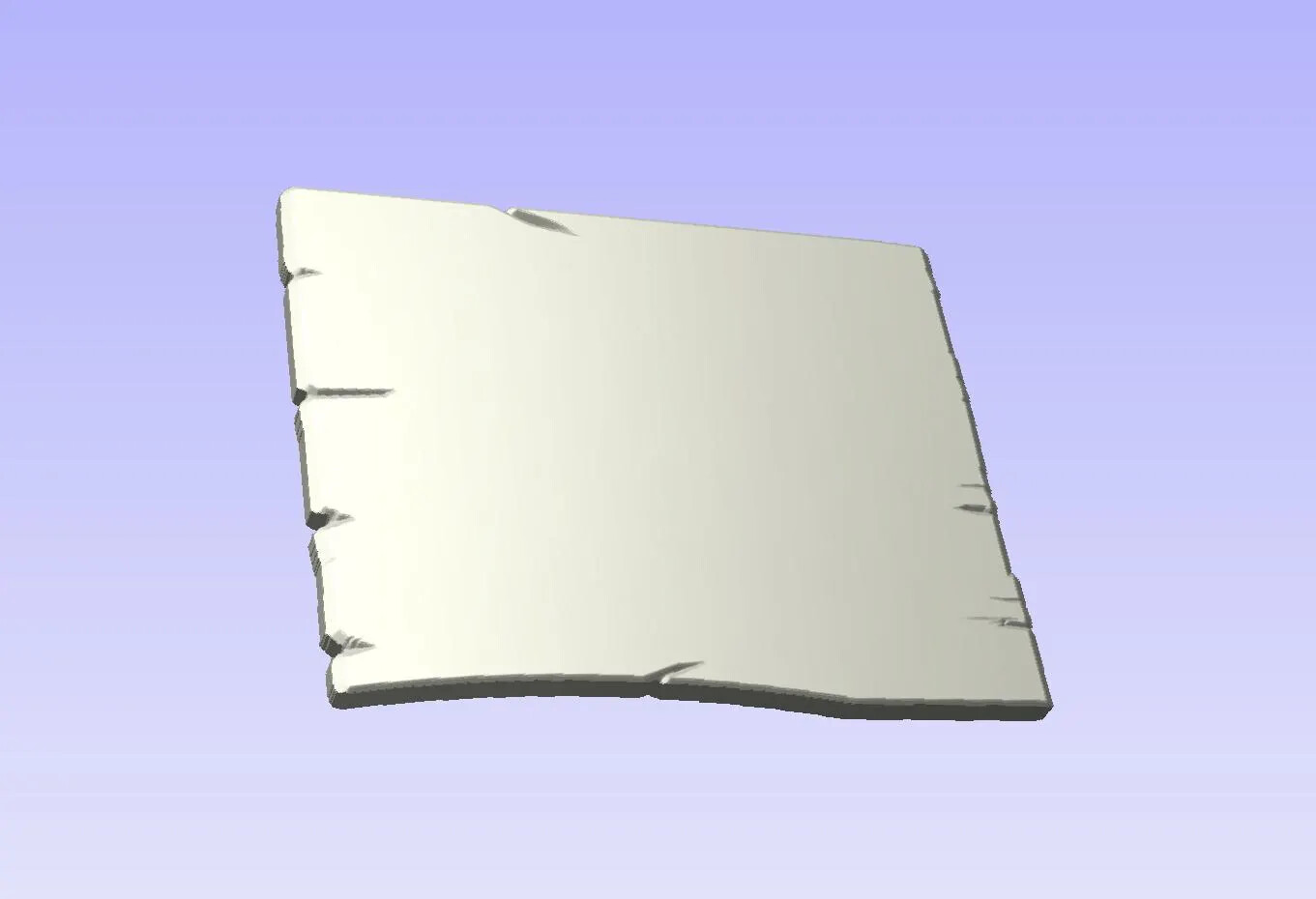

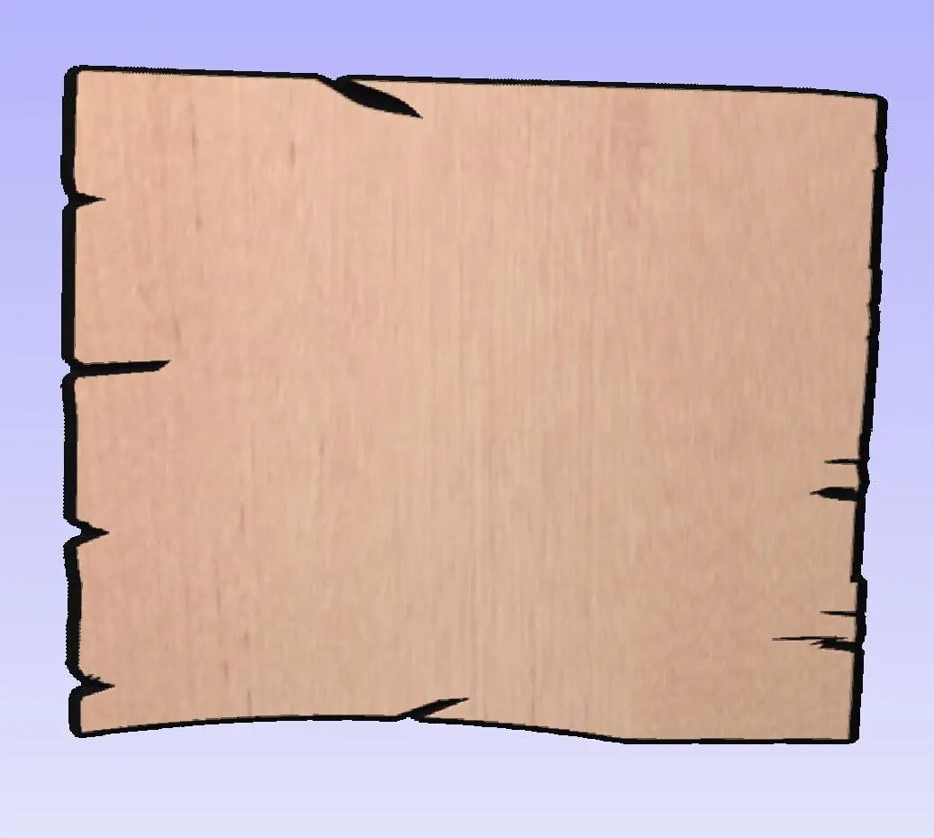

Here’s my secret sauce for a distressed champfered Edge.
