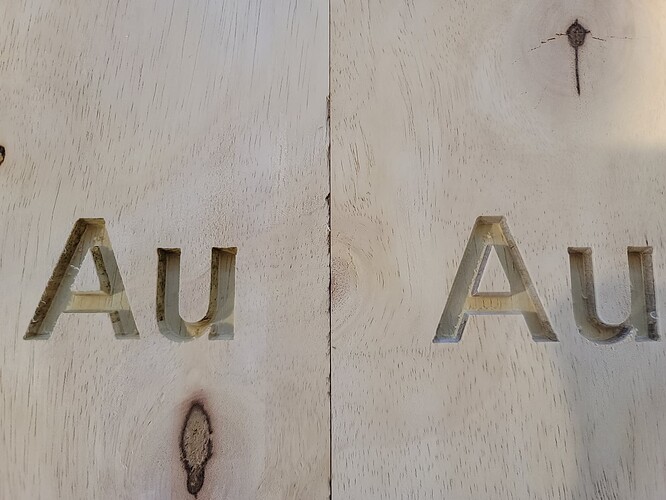

Hey, some help would be hugely appreciated. I’m trying to get started with inlays, and like everyone I guess, I was starting with coasters. I’m a chemistry nerd and so I’m doing atomic symbols. I’m starting with gold “Au” and so I did a practice and this is what came out.
It looks pretty good, except for the rounded corners.

I wanted to get rid of the rounded corners so I looked through the forum and found some good advice. I had roughly aligned and trammed my Shapeoko 4 Pro when I first set it up, so I aligned and trammed as precisely as I think I’m able with a dial indicator and it’s within a couple thousandths in both the X and Y directions. I heard about parts being loose so I checked the Z axis and there’s no play when the machine is on. I got McFly and do a surfacing pass prior to using the location probe, and I’m changing bits using the bit setter. I read that the wood could push the V bit to the side and the corners could actually be where they are supposed to be but the sides are not, so doing multiple passes could clear that up. I read that the bit may not be an actual 30 degrees and I watched the video and found the lines between angles are dead straight so I would assume my bit is right on at 30 degrees.
After all of this I tried again today and this is the result
I guess it’s encouraging that the machine is ridiculously repeatable, but I can’t get rid of the rounded corners. Any assistance would be greatly appreciated. Thank you.

The rounded corners are not symmetric (top of ‘u’), and they sometimes move from one side to the other (top of ‘A’ vs left of top of ‘u’). There’s also something going on with the bottom left area of the ‘u’.
This to me appears to be slop on the X direction. There’s no such machine as a ‘Shapeoko 4 Pro’ (it’s either one or the other, not both), but both are belt drive, so check the X belt and especially check the X motor pulley - 2 screws, both tight, one screw over the flat of the motor shaft.

So those pictures were the first attempt and near the last. The first was before I tightly trammed the Z axis or even adjusted the X and Y axes, and they did need to be adjusted. These two were the last two I did (in ply because I got tired of wasting hardwood, even if it’s basically scrap) after doing everything and they are remarkably consistently not what I want.

Also, the attempt on the right you can see the V bit didn’t go down as far as the 1/8" clearing pass. I wasn’t sure if the bit was blunted by use/the bitsetter so I placed a 0.01" feeler gauge blade on the bitsetter to see if that would change anything, so what you see in the picture was intentionally caused by me, even if it wasn’t the result I was hoping for.
I thought of that so I bought another two bits with the same result. Then I thought that, since the bit setter kind comes down fairly hard and it’s a pretty small surface area, maybe it blunts the bit on first use. So I ran another attempt except I put a 0.01 inch feeler gauge blade on the bitsetter when the V bit was setting it’s height. In the post above, the attempt on the right with the knot above the “u” you can kind of see that V bit didn’t go all the way down to the bottom by about - I would guess - 0.01 inches.
Not gonna lie, I was getting ready to tell myself how brilliant I was with using the feeler gauge, only to get basically the exact same result. So failed again and ego far more dented than the bit must be.

These 2 area look like cutter deflection. If you think about the direction the cutter is spinning & traveling, when it gets to these corners it’s pulling into the material.
[Insert obligatory plea for climb-cutting here] :smiley:
I would try to test this with a very soft material that doesn’t cause deflection. PVC, rigid foam, wax…
On your cleanup paths, I would set the depth of cut to 0.2" so you’re only making 1 full depth pass.
Does it look like your clean up paths are removing any material at all?
If the primary path is deflecting into the material due to conventional cutting direction, the cleanup paths might just be cutting air.

I also reduced the depth of the pocket to 0.1 inches because it was taking too long, and that helped the rounded corners a bit (which I would expect, not going as deep will access a smaller diameter of the bit) but did not resolve it. Here’s a picture in pine.
I ran the same thing in purple rigid foam insulation, and it’s tougher to tell in the picture, but they look about the same. I colored the top with a green sharpie for contrast but you can see the rounded portions in the corners (red circles) and that part of the “A” triangle being blunted (the stab marks are my uncoordinated ham fists trying to remove the fibrous remnants with a knife because they wouldn’t rub off with a toothbrush).
Additionally you can see in the “u” at about the 7 o’clock position (circled in blue in both pictures) that there’s another rounded segment in the pine and the foam, and I looked back at other attempts and that same rounded portion is in the same place in all of them. That seems to suggest its not my machine necessarily, it’s something to do with the instructions being given to the machine. Especially because these issues persisted after remaking the design in a different version of Carbide Create.

If it is consistently off, then the most likely culprit is a mis-match between V angle as used in the file and effective V angle when cutting — create a pattern of test cuts for triangles where you create a V tool w/ a slightly different V angle, so if you are trying to use a 60 degree V tool, create tools from 55–65 degrees and then cut them all with the same 60 degree tool at the same feeds and speeds.
Not necessarily. The part shape is still the same, and the cut direction (conventional) is still the same.
When the cutter moves into a corner the forces on the tool increase. When it cuts across the bottom of the hole in the ‘A’, then move up the right side it’s going from 0 resistance to ‘cutting into endgrain’ resistance.
Try this toolpath out. Same parameters as yours, but using Cavity Mill to rough, then 3 passes all climb cutting to profile the edges (Vee Carve), then Drive Curve to finish the wall & pick out the corners.
Everything is climb cut, so if it encounters forces that deflect the tool, it will deflect away from the material, rather than into it. Same size stock (4.5 x 4.5). 0.200 deep cuts. 0.050 stepdown.

I tried running it, it looks different, but I’m not sure how to interpret the difference…
The edges look a lot cleaner & straighter. A little chip on the top right of the ‘A’ ??
And some slop in the bottom of the pockets.?? A little manual cleanup.
Kinda looks like the Z zero was not precise for both bits. Is the Vee bit cutting a little deeper than the end mill?
Otherwise, no dogboned corners, and no dig in on the inner part of the ‘A’. Which is what we were looking to address. Repeated pleas to C3D for climb-cutting!!!
