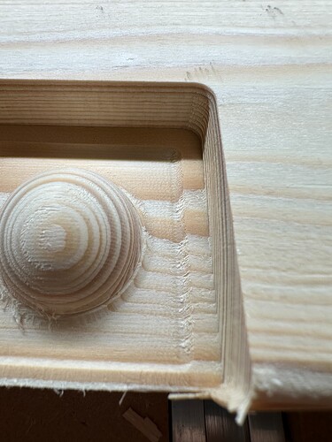

Hey everyone, newbie here. I have been having some issues with the surface finish of my cuts. I think it has to do with machine rigidity/acceleration being too fast. Typically the cuts will leave these swirl marks. They usually will only appear near where the tool changes cutting direction and smooths out until it needs to make another turn. This cut is with a 1/4in downcut spiral.
I’ve tried slowing down the feedrate and step over. This parallel finishing cut I had at 12000 RPM, 55 in/m FR, a .013in step over, and a 1/4 ball nose spiral, but it still seems pretty chattery near the edge of the toolpath.

Tram your spindle and then surface your wasteboard right after that plus the geometry of a downcut will do this.
I did run through the tramming process a couple times, however I only used 123 blocks and a try square. If this was a tramming issue, wouldn’t there be ridges for the full length of the cut? These marks are usually only at the start and end of a pass, unless the pass is a short one. Thanks for your reply.

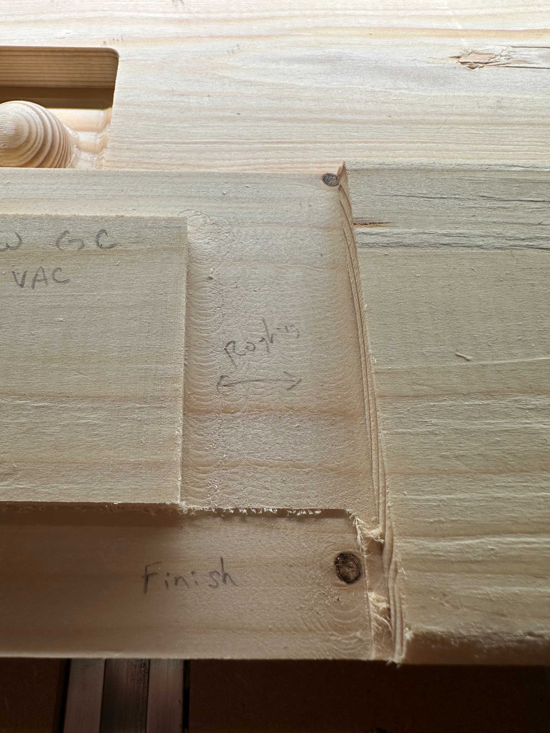

I will give that a shot, thanks! For the cut in my second photo, I ran a roughing pass and then a finishing pass that removed .02in of material. I haven’t gone smaller than that for finishing passes yet.

Note that a finishing pass should be at least chipload dimension in thickness, otherwise it will just rub.

This bit isn’t radiused btw although i do have several and you can see the similar mark at the dwell point (I didn’t want to hit my workholding and this is the backside)

For the tools, all have been 1/4in, I’ve been getting the swirls from the first photo with the Nomad Tools #201, Whiteside RU2100 (spiral upcut), and Whiteside RD2100(spiral downcut). The marks from the second photo are with a Whiteside RU2075RN (round nose spiral).

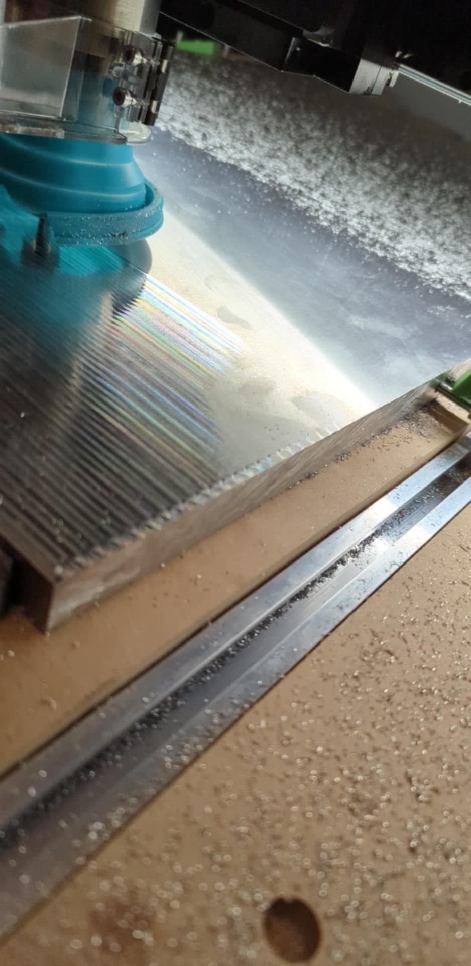

It’s good to see that the machine at least has the capability to do what you are doing. I want to machine aluminum and brass eventually, but I’m worried these problems will just be exacerbated if not fixed.

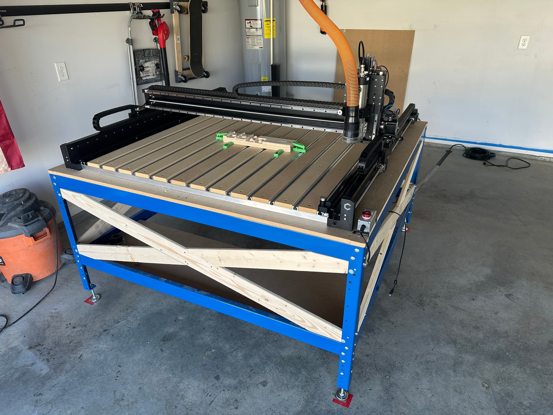

What is you machine sitting on? The table I built for my 2x4 had a slight rise in one area that caused the machine to “teeter” slightly as the gantry moved from front to back. I also had to reinforce my table as the whole table would wobble when the spindle would change direction. Padding under the machine is a good idea to dampen sound and vibration.

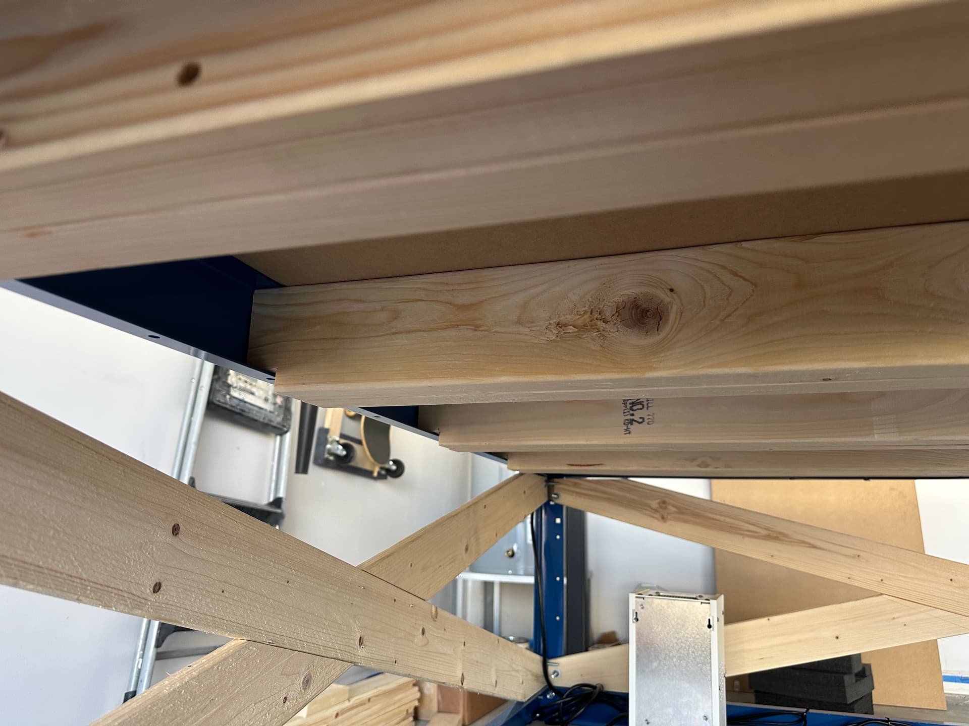

I’ve got it on a Kreg table. I made sure to level and square it as I built it. I routered the edge of the mdf sheets on top so that it would sit flat against the 2x4s underneath. I also reinforced it with those cross struts and it helped a lot with table wobble as the machine ran.
It’s a long shot but maybe try moving your spindle mount to the upper most position. This will move the spindle down in the mount closer to center. This will not stop the table from shaking but let’s see what it does for tool marks.

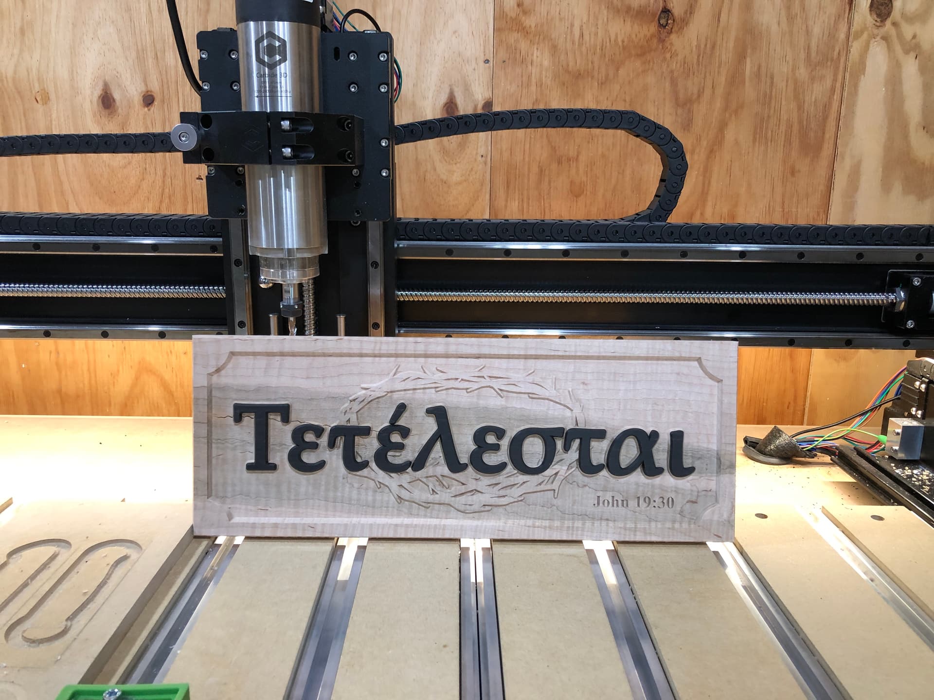

My set-up look like this with no chatter in the maple.
