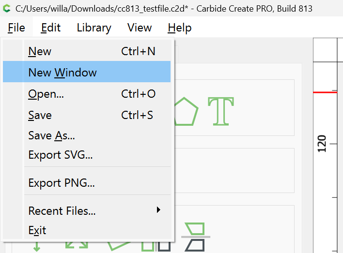

v8 allows multiple windows:
Interesting, I missed this in the write up for V8 or I read so long ago I forgot. This means we can copy and paste from file to file?
Yes, it should work to copy-paste from one file to another.
Awesome, thank you. It will be the weekend before I can try it out. I’ll post my results.
NOTE: You can open more than one instance of Carbide Create by double clicking on the *C2C file. NOT by opening another from inside of Carbide Create.
There’s a new menu entry:
