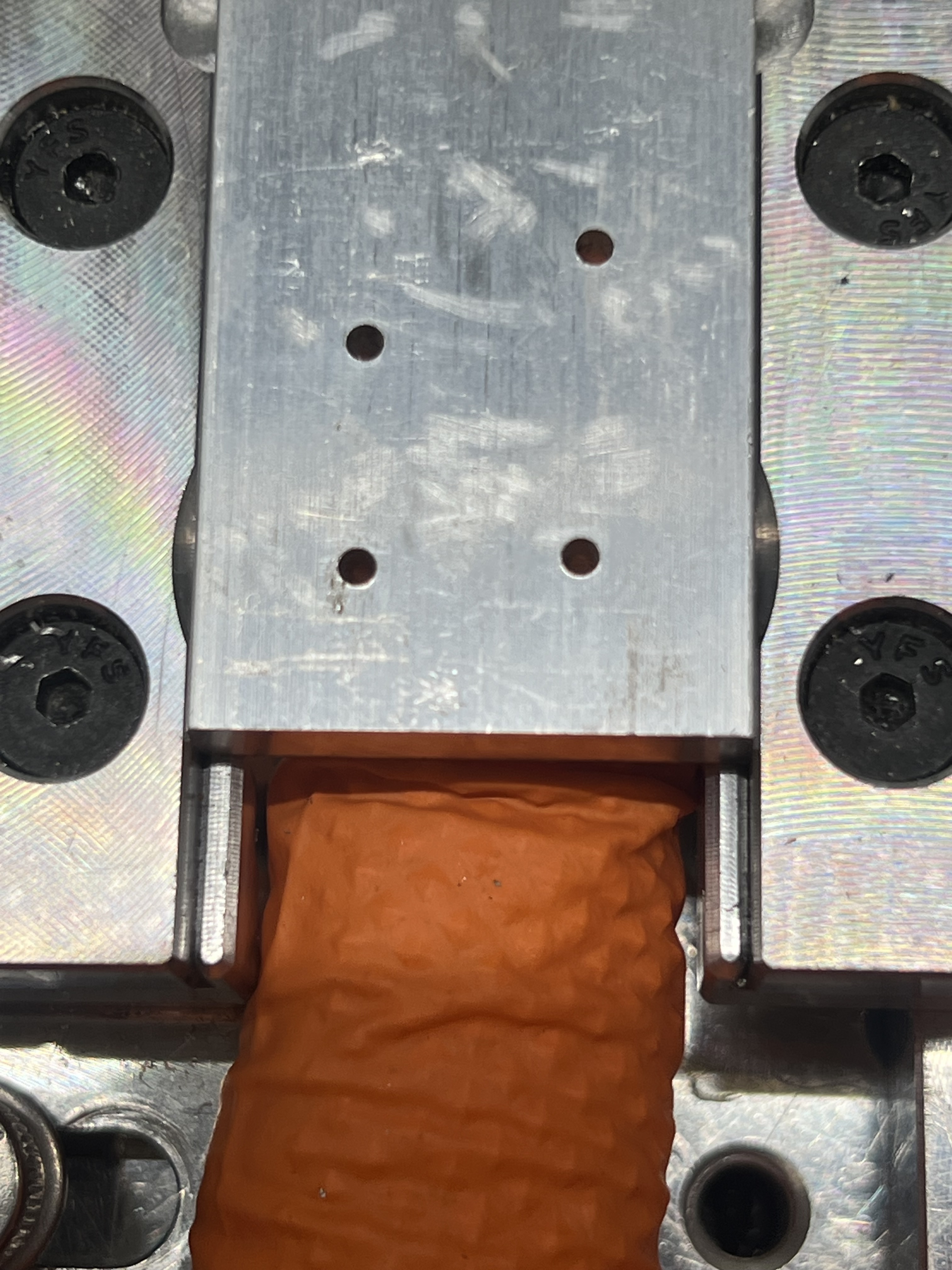

Seems I’m still very talented in breaking small drills, specifically in aluminum :sweat_smile:
The 1/4” aluminum drills perfectly about 3/4s of the way through but inevitably grabs and snaps.
My guess is that I just need to get the drilling strategy right, after about a 3 to 1 depth on drill diameter I suspect it cannot evacuate chips effectively.
I’ve tried straight full depth as well as 2mm pecks with full retracts, no luck on either. The operation and the hole look great until they snap though :melting_face:

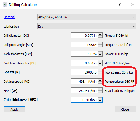

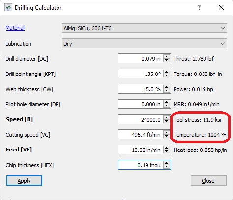

Ouch… That’s a 0.0002" chipload (just a quick note, I still do drills by per flute. Most you will see is total). I would hope that you don’t need that little chipload to prevent the deflection. I think the 0.01" retract is mostly what’s saving it as that limits the engagement time and therefore the resulting max angle at depth. Although, you will also have less force from the smaller diameter.
If it were me I’d try to get that up to at least a 0.0005". You probably don’t need the full retract either. Although, I’d only change one parameter at a time. Could probably also gain a bit of margin by removing the ring and choking the tool. Although, that will be more minimal in this case UNLESS you grab the “flute”.

What you’re running on:
At 0.0005":
The temp is fairly obvious why it matters. Most decent carbide will take 80-100 ksi to fail that way.
One thing you might want to watch separately is thrust. If you find working and failing points on your machine that may be your limit. In other words that you can only take so much thrust before you deflect enough to catch an edge (assuming I’m right about the reason).

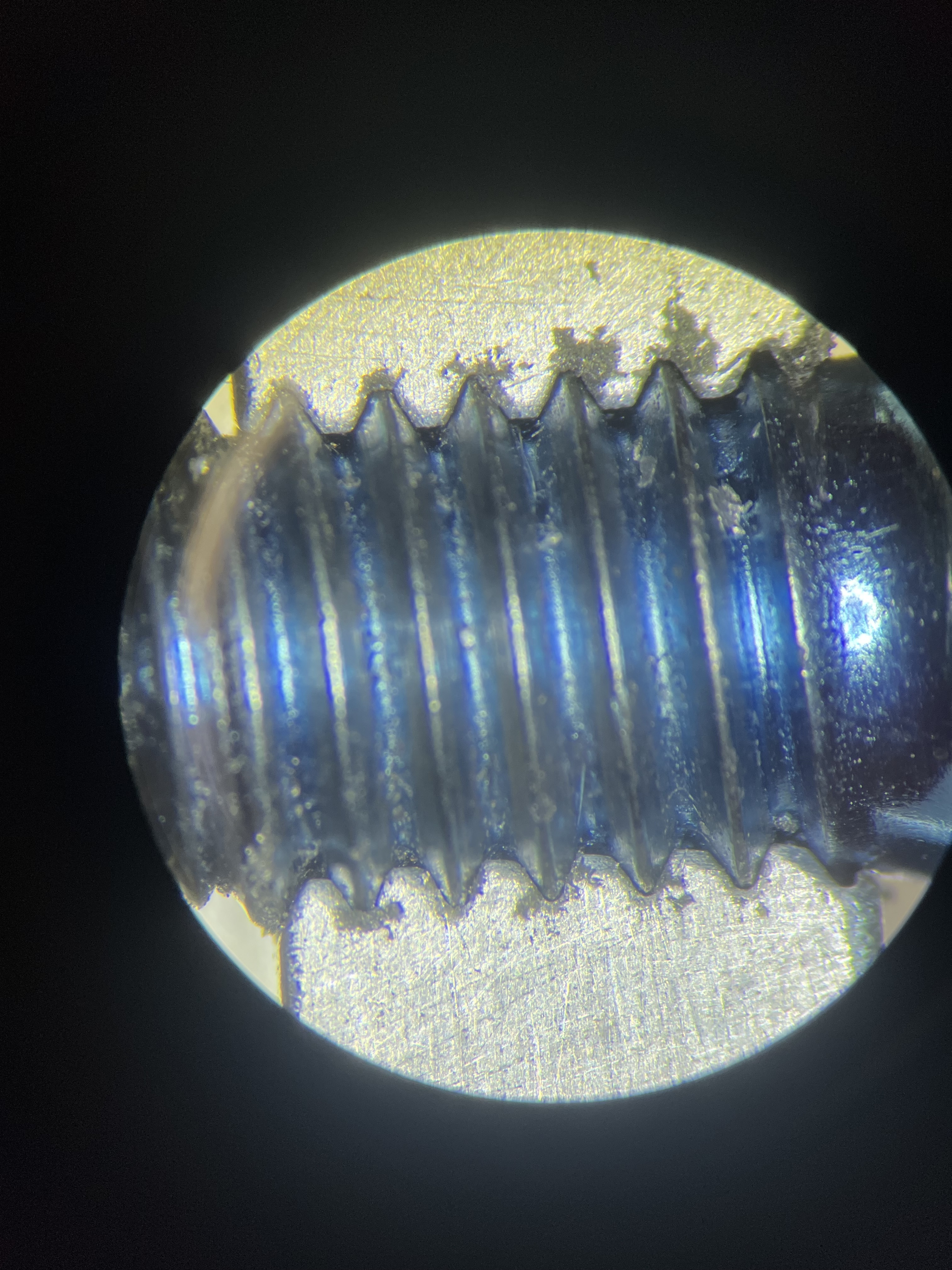

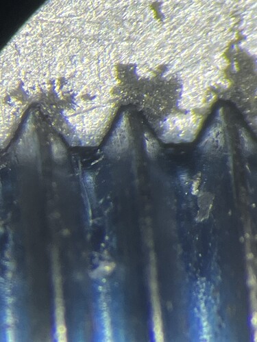

Pretty neat, I ran the classic cross section when single point threading. This fit is just barely able to be tighten by fingers and you can clearly see why. I’m guessing if this were a full bore with nowhere for the swarf to go, it would just lock up.
Neat.

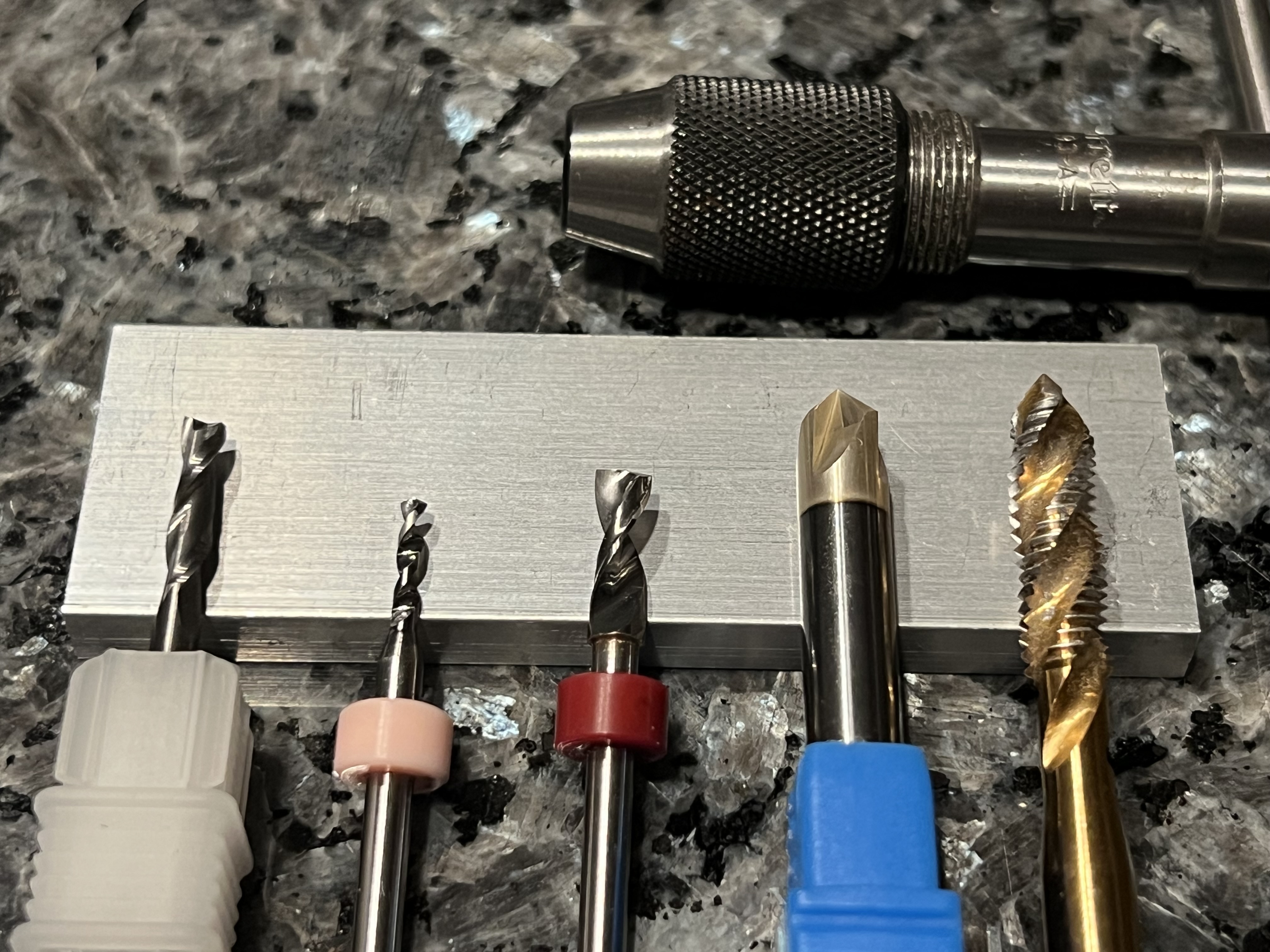

Single point threading - very cool. Can I ask what tool you were using?
Here you go, a few suppliers mentioned:
These things are very capable and the cutting forces are relatively low so it’s not a terrifying operation. Big fan :slightly_smiling_face:
Per TDA’s suggestions, I was able to at least double the drill speeds reliably. Though I’m still running into some odd behavior with deeper peck cycles, so I’ll be tramming my Nomad in the coming days.
I expect it is actually very well trammed based on the results of my general milling operations, but it doesn’t hurt to check.
I’ll report back when I have something interesting to share.
So my tram in X is off by less than a thou. Not terrible.
My Y is not so good, out by about 5 thou across 4 inches.
I think this aligns with why my drills break with deeper peck distances as we reach the deeper sections of the hole.
I’m hopeful that when I get it dialed in I’ll be able to push a bit harder without deflecting enough to break tools :crossed_fingers:
