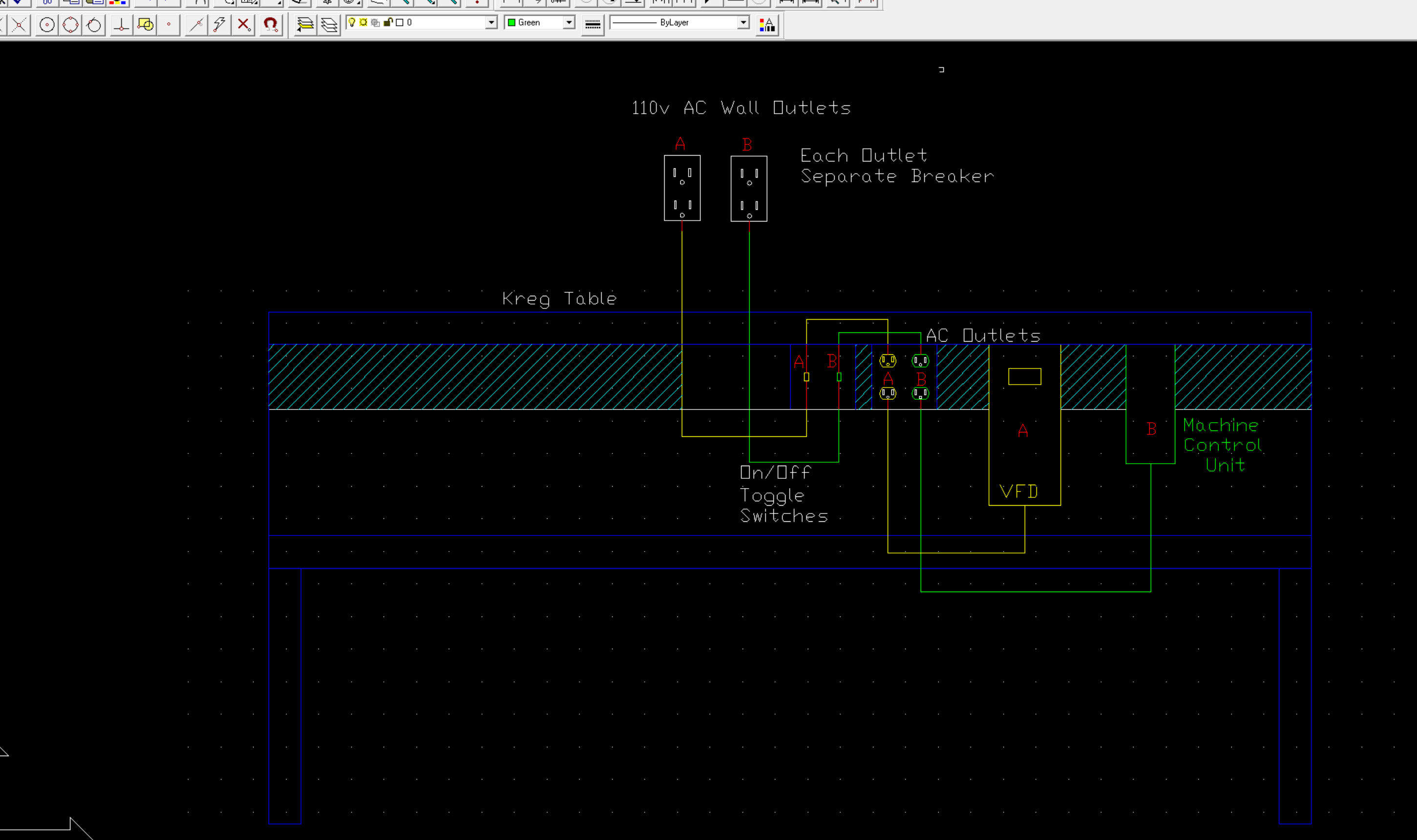

Good morning,
1st of all, I love this machine!
2nd, I am now getting ready to make my machine more permanent.
Wiring and positions of the Control Unit and VFD.
I am wanting to use toggles switches to turn on and off everything on the system,
INSTEAD of using the on/off switches on each unit (VFD and Control Unit).
I got to thinking, You would never do this to a Personal Computer. It can damage it over time doing this continuously.
However, the E-Stop Button, that is wired directly to the Control Unit does exactly this, removes power instantly.
I would think my wiring would be OK because the E-Stop does this, but I have to ask, I want to make sure.
My question:
Wiring the VFD and Control Unit this way, will it harm or damage these units?
I have attached a simple wiring diagram (.PNG) so you can see exactly how I am wanting to do this.
Happy Friday!!

The e-stop will not turn the VFD power off. Personally I power off at each controller at the end of my day and power up at them at the beginning of the day. Just as I would with my table saw or any other power tool.
You are free to choose how you want to handle that.

Has anyone here wired their machines this way?
Will it damage any of the electronics?
Attached here is the same .PNG I sent support. Just a simple wiring diagram.

Do your VFD and control box have physical power switches? How could having a switched power outlet be any different than using those switches? estop is an emergency thing, used while the machine is actively running a job with the spindle turning. I assume that you would wait until the end of a run to switch off the outlets with your external switches, so that would seem to me to not be any different than reaching around and using the physical switches built into the units…

Yes, but powering things on-and-off is what an e-stop does, so the discussion in that touches on, and should inform the setup of panels which you wish to make.

Not an electrician but compare your request to doing multi-component HiFi setups.
This how the question comes off. You want to plugin the the VFD and machine controllers to outlets controlled by switches. Then use those switches - NOT the switches on the devices - to turn them on and off. To work that way the device power switches must be left at ON at all times. These devices ought to have soft start circuits to not damage components from sudden voltage and current change. The drawing would bypass that it could shorten lifespan. Same turning it off is like equivalent of pulling the plug or tripping a breaker no graceful shutdown.

I have my 4x4 set up in such a way that it’s hard to reach the switches at the back of the machine. I’ve been using WiFi-enabled plugs to turn on my power and VFD for over a year now with no issues. Maybe I’ve been lucky?
My VFD is hard to reach as well but the breaker panel is convenient so I just trip the breaker.
There’s an older post about this which quotes the Manual. Doesn’t explain why:
“Always press the Spindle Enable button to disable the spindle and flip the power switch on the side of the VFD controller to turn it off when done cutting”

To use a quick disconnect/toggle switch for your cnc might not be a good idea.
If the switch is wired before the power supply like in your diagram, when you set your toggle switch to off, the power brick still has residual charge and will take a short moment to dissipate. That may result in the control board briefly receiving less power than it is set up for and may cause damage during the dissipation.
As to the spindle, in my experience with my spindle, when I turn the spindle off the driver ramps the pulse width down until the spindle is stopped. With an added toggle switch like in your diagram you would be bypassing that ramping phase and may turn your spindle into a mini generator feeding back into your spindle controller, again, not good.
The short of it, it might work for a while but possibly bad in the long term.
