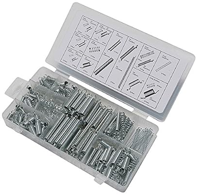

Can you toss a link on amz for the springs you used to double up?
The spindle came with a mount, I just chopped it down somewhat and then sanded, filed and painted it.
These are the springs I bought, but sure there are better out there.
