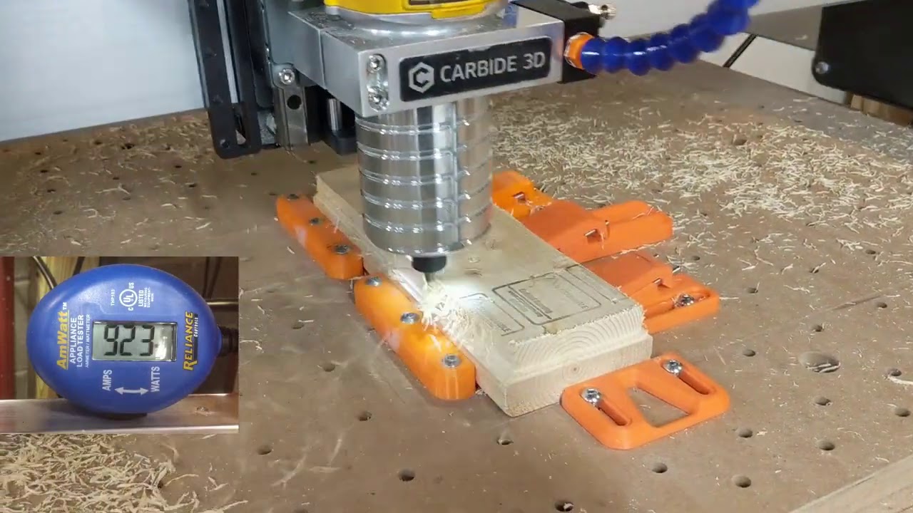

Alright, so I went and tried pushing it harder… didn’t go too well.
Here’s a video of 0.600" ADOC, 0.100" RDOC, 24k RPM, 500 in/min (.007 IPT):
I tried a bunch of different cuts before this and my limiting factor always seemed to be the x-axis stepper.
It kept letting go from being overloaded from the forces.

The spindle caused the x-axis stepper failure. The spindle was the limiting factor.
Might also blame spindle power as the RPM is bogging down and that’s going to mean more force required from the stepper?
Let’s wait and see if @gmack corrects me on that assumption :wink:
From a mechanics standpoint thought it makes sense for the X stepper to run out of torque first as there is only one of it and you’re in the middle of the machine so you get nearly 2x the torque from the Y steppers sharing the load.

It appears that the router was struggling since it dropped speed to 19,000 RPM at one point and was drawing up to 1200W. It’s probably not a good idea to exceed its “Rated Input” power (120V X 7A = 840W) for extended periods of time.
It also looks like you were probably pushing the 18lbf limit of the X-stepper motor (at normal speeds?) and that I need to fix my “Available Power” calculation.
Note that in my previous post I suggested an approach to separately safely push the machine and router without exceeding their standard operating envelopes. You just need to monitor power while watching and listening to the cut and pause/stop the feed rate increases when things start to deteriorate. Recording videos like you did is really helpful for documentation. I think that you (and others) would be doing a great service if you continue this endeavor.
