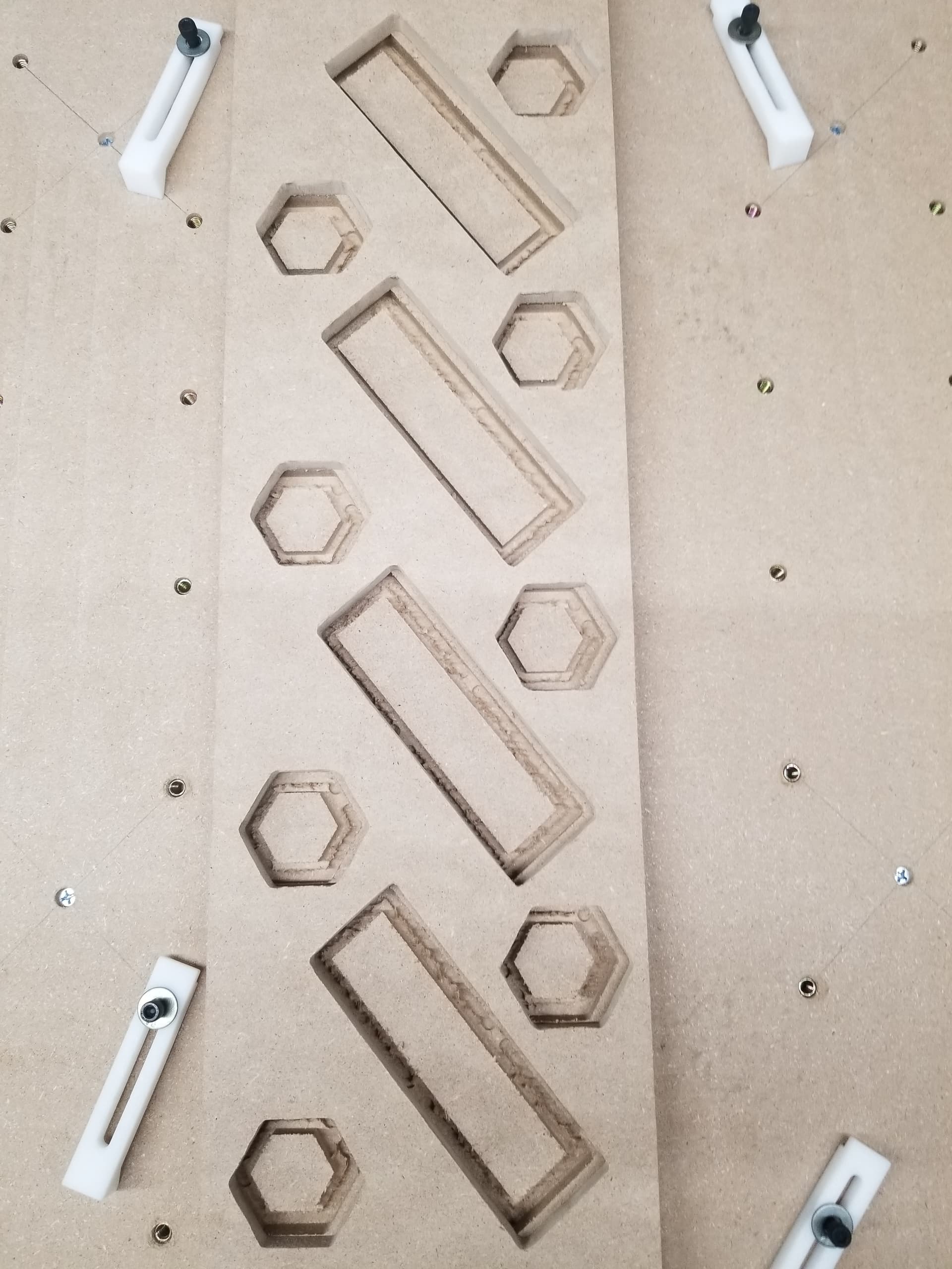

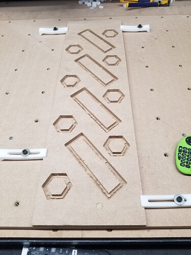

It ran the whole part, and didn’t power down or anything. However, I did notice that, this time, it didn’t cut all of my holes.
Any ideas what happened here? Kind of a waste of material, as I’d mirrored, and expected this to be exact. I guess not.
Could it have been because I put my BitZero on the lower left corner of both pieces?
Yes. That will only work if the material is exact in dimension and flip.
You want to always use the same corner/place for origin.
Both pieces were 28x8, started at the front left corner of stock. Or am I not following? Or are you meaning, I should have put the BitZero on the front right corner, for the mirrored piece?
Or do you mean, in Carbide Create? As I’m looking at Carbide Create, I see why it did what it did but, I am uncertain how to correct that.

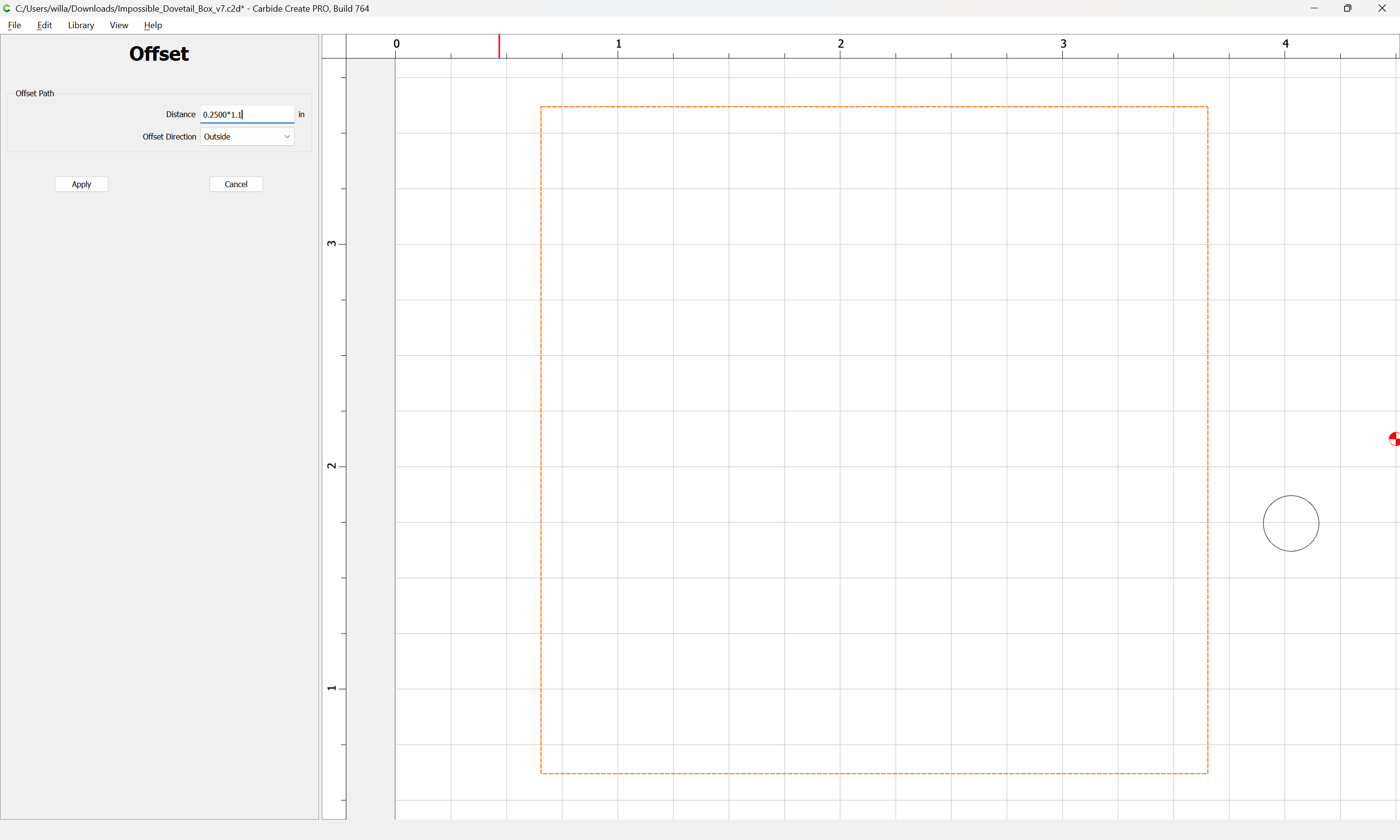

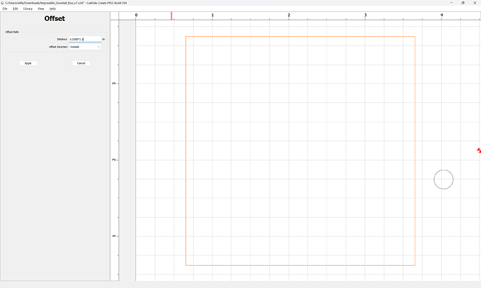

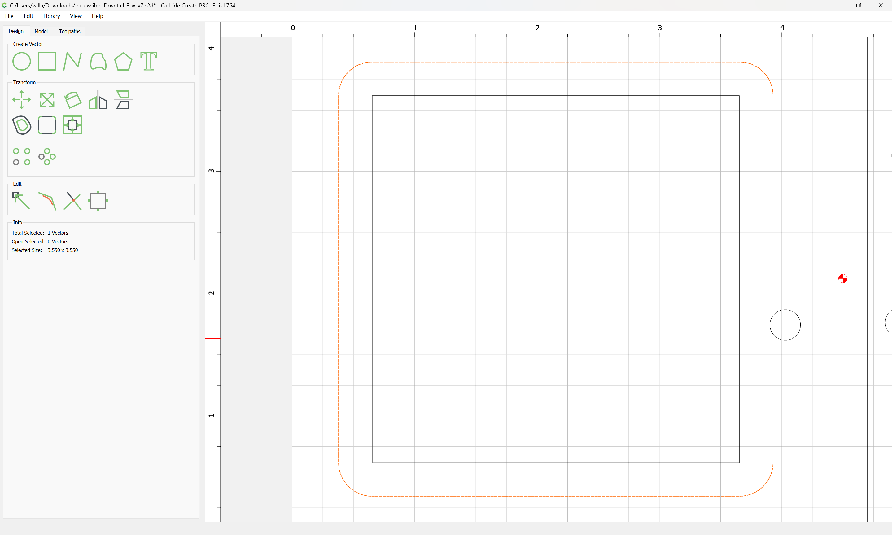

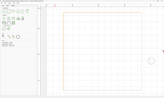

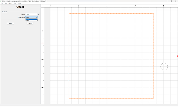

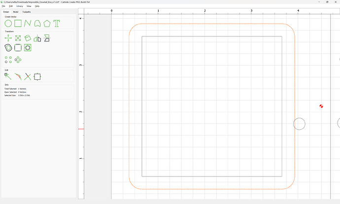

Where in Cabide Create, do I add the 10% for the Pocket?
You mean when offsetting?
Select geometry:
select “Offset Vectors”
set the direction to “Outside”
set the distance to
endmill diameter * 1.1
Apply

To offset that though you’d just select it and offset as shown above however much was necessary to make the narrowest region ~10% wider than the tool.
