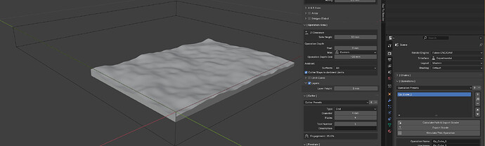

Here’s the model I’m trying to make:

Your suggestion has made me realise another thing I haven’t tested though. I’ve been using Blender 3D with the FabEx CNC addon, I should really try something else (i.e. fusion or freecad) in case there’s a bug in the addon which is adding something dodgy into the gcode. I don’t think it’s that because the problems (mostly) start at different points in the job but I should still test it.
