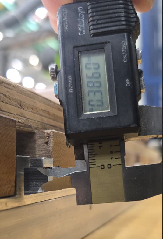

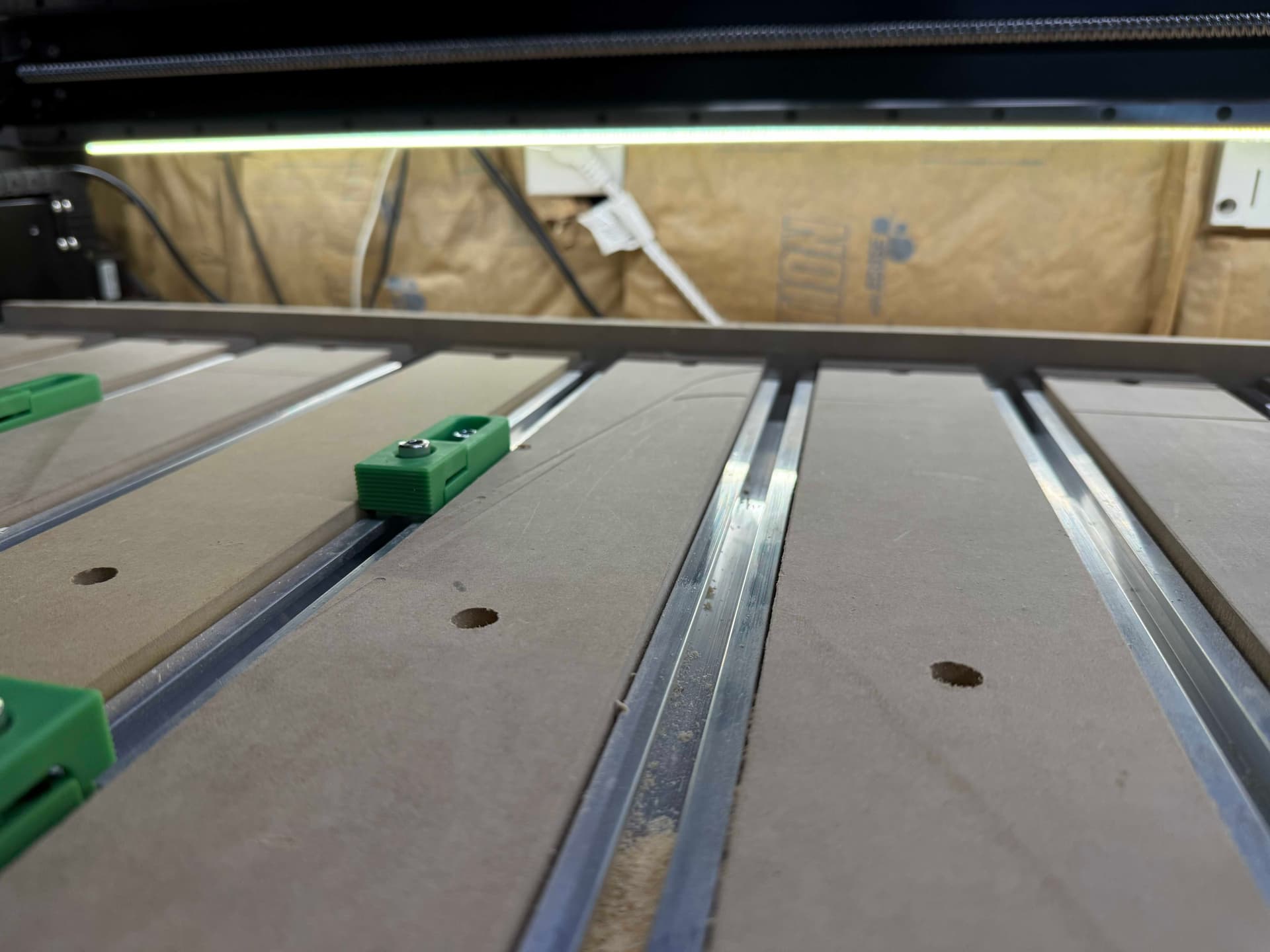

I believe I recently saw on the forum someone who had designed a 3D printable T-track extension to be able to clamp sheet material right out to the extent of the T-track. Perhaps you need something like that but maybe with just a solid lip-edge that catches & holds down the back edge of the plywood.

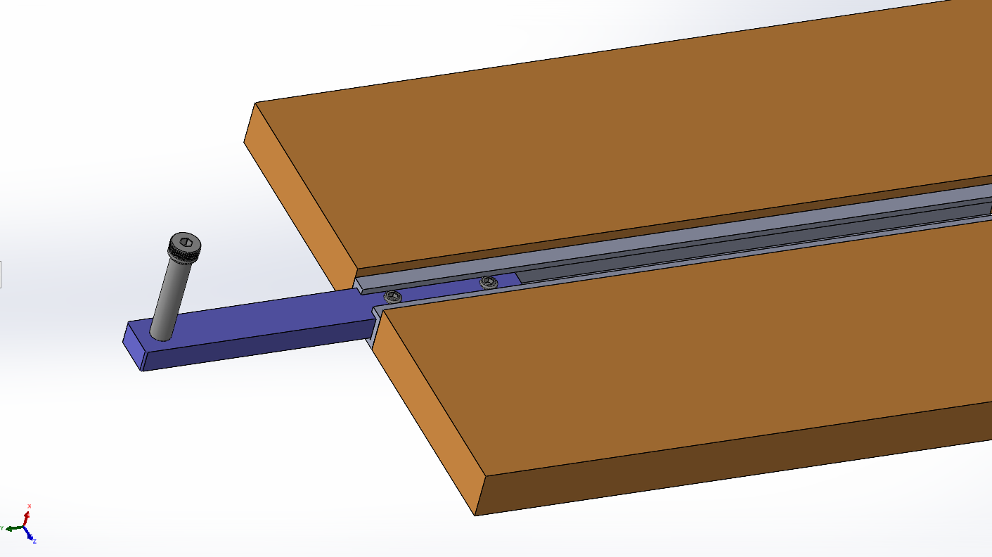

Well, I just happened to have some dimensions of the tracks for other stuff I was doing. . .

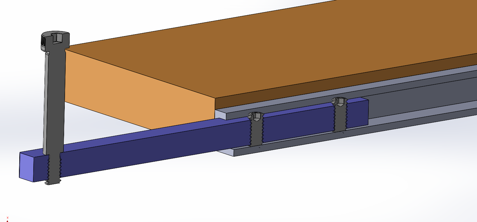

Get yourself a piece of aluminum and make an insert for the t-track, and put in a couple of either really short screws that sit below the slats, or a couple of set screws, and then either a shoulder bolt or female round threaded spacer for your material stop.

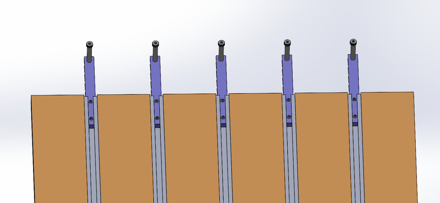

Then you get your board aligned where you want it, then put in your backstop assemblies with the screws tight enough they don’t move without a decent nudge. Get them all up against your “as close to perfect as you can get” cut plywood, then carefully remove the plywood and tighten the set screws. I recommend cup tip set screws. They will bite and hold really well, without the deeper divot a cone tip screw would make.
Now, if you don’t want to have the backstop for a job, you can just carefully unscrew the shoulder bolt and you can still feed the stock further back if needed. When you want it back, screw in the shoulder bolts and you’re ready to go.
I used 1/4-20 threaded screws for this demo, but you can do whatever.

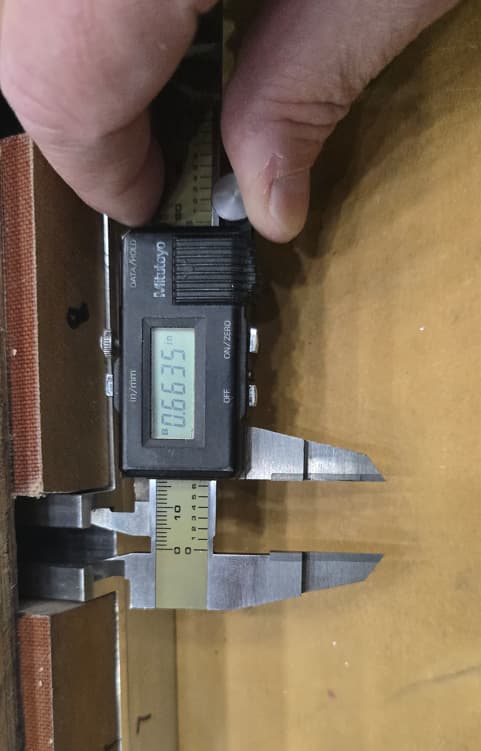

• And one clarification: you mentioned 3/8” aluminum stock, but when I measured the interior width of my T-track, I got something closer to 5/8”. Am I measuring wrong? Just want to be sure I order the right thickness.

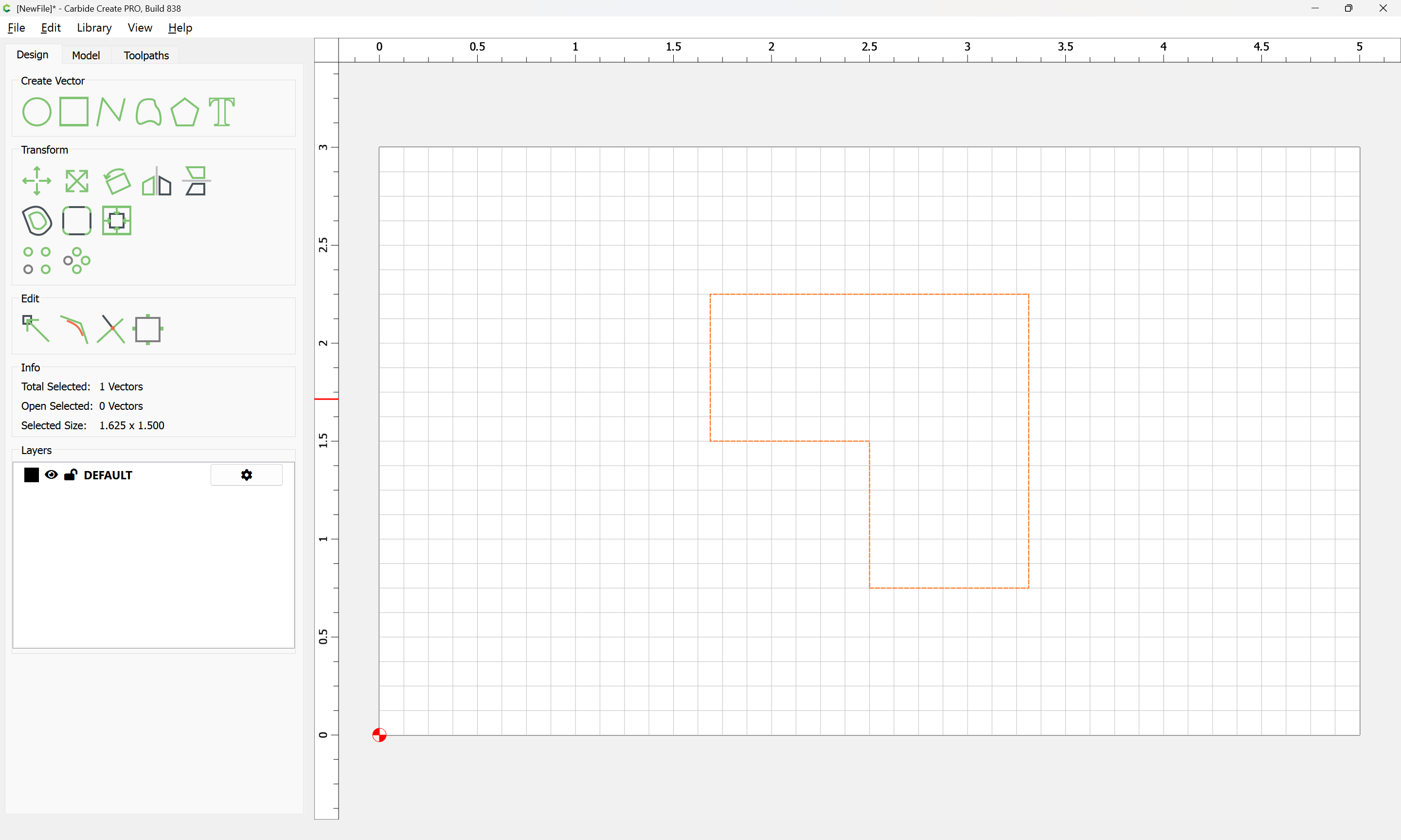

Probably the easiest thing to do would be to replace the MDF slats with slightly longer ones, then run a pocketing operation inset by the radius of the tool and sufficiently deep to work to register against — you’d have to remove a fair bit of material, and you’d probably want to buy a 4x8 sheet to make it affordable.
Alternately, why not just make an L-shaped bracket:
and glue it into place, then machine off a section inset by the radius of the tool?

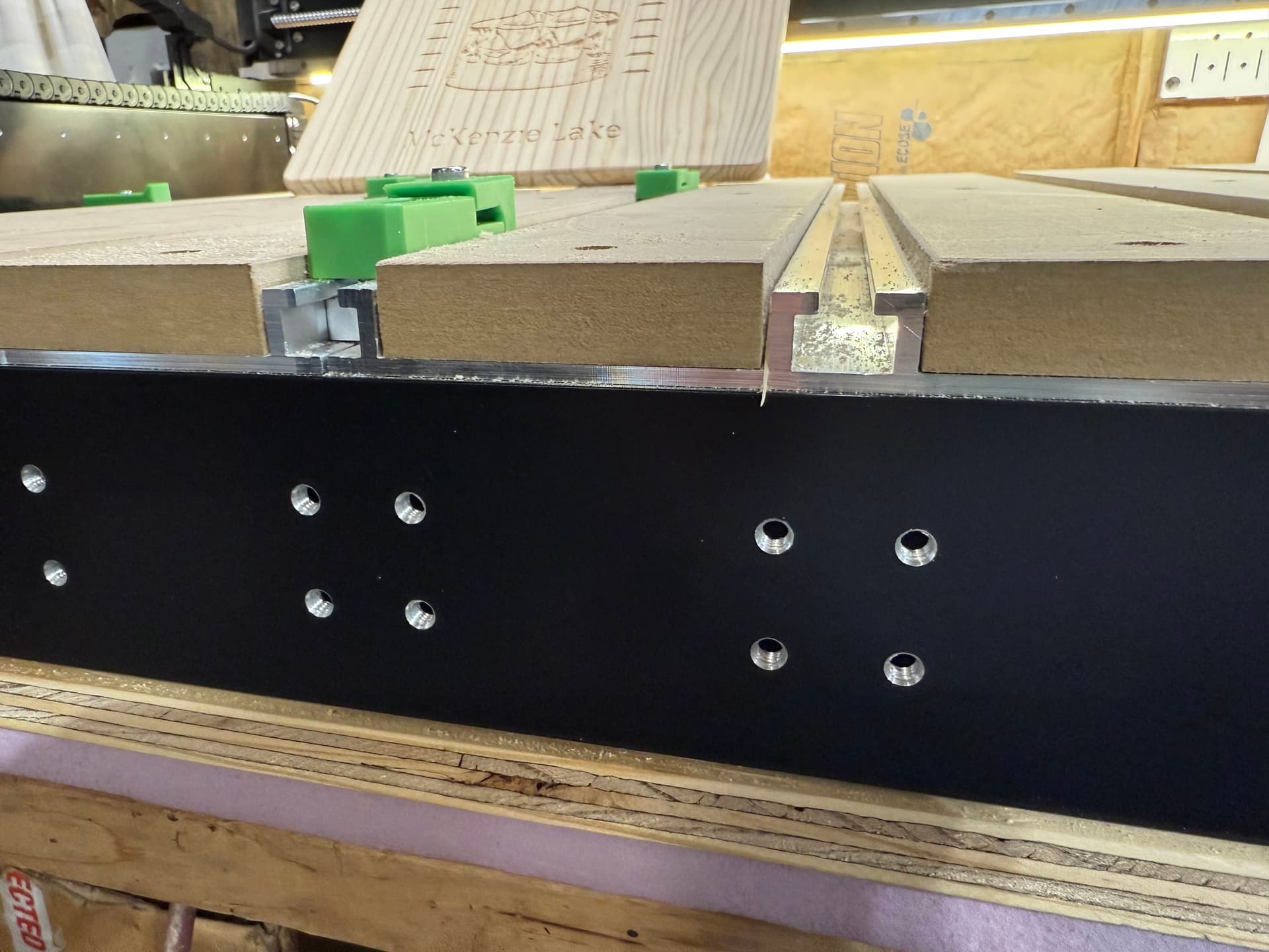

Another idea just occurred to me - Is there any way to utilize the threaded holes on the face of the back beam under the machine?
If so, how the heck to I find the correct hardware to match the threads?
Isn’t that M6, the same as is used for the Teez-nutz?
from:
https://carbide3d.com/blog/shapeoko-51-pro/
…we’ve added a bunch of M6x1 threaded holes that you can use to clamp your work vertically
Just drill a set of matching holes in some suitable material and bolt it in place?
Oh man! That is going to be the easiest way by far! Here is the post from @wmoy that has the hole spacing:
Now you can use a scrap piece of plywood and make a flat plate without the need for tapping or anything like that.
That solved it! I ended up using the threaded holes on the back beam — once I got the hole pattern set up, the fence went together really quickly. Ripped some scrap plywood I had on hand, and I had a pile of the M6 bolts from the Teez Nutz kit and they worked perfectly. The whole setup is simple, super secure, and honestly stronger than anything I expected. This is going to be ideal for the repeat cuts I’m doing.
