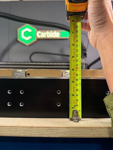

I would suggest that you specify the exact height difference (even the exact height above the table to clear the side rails) … it isn’t just an enclosure issue. I built my CNC table before I got the machine and received (from different folks) exact height (clearance) measurements from the table top. Reason was that my Router Table sits 2 feet away from the CNC Table and I made the CNC table height so that the infeed area of the router table will allow wood to clear the CNC machine side rails by an inch. This lets me not have to move the heavy router table when passing wood thru the router.
It is nice to know the exact heights since many of us do not have unlimited space around the CNC table.
Thanks.
The heights/dimensions of the machine on the specs page are correct based on the current 5.1 extrusions.
Good to know. I really hope someone actually measured the machine personally in the shop and publishes that number. I remember a year ago when I needed to build my table to an exact height I asked C3D for the actual heights to the side rail. Unfortunately the heights I received were incorrect, but fortunately Brad and Will measured their machines and I was very grateful they did since I was initially given too low a height — which would have been a problem for me.
So, maybe also provide dimensions to specific pieces of the machine from the table top might save someone a headache for planning purposes.

This is for you. Keep in mind we’ve surfaced the MDF a couple times since we started running it, so only consider the aluminum portions of the frame for reference.
