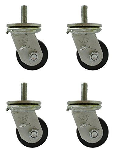

The feet are mounted through M12 holes in the legs, so you should be able to use any wheels with an M12 stud on them. But, be sure to use wheels that lock very securely to make sure you don’t get any wobble as the machine moves.
I echo @robgrz . Make sure you get good double locking casters or the machine will try to walk across your garage. :smiley: I like Rockler’s Total locking casters. But they have a 1/2" stem, so you would have to drill out the holes if you want to use that solution. Otherwise there are less expensive options on Amazon, I may try when I get my S5 to S5.1 conversion kit and legs.

This kind of casters broke in an instant:
And casters that just block the wheels IMO are still wobbly.

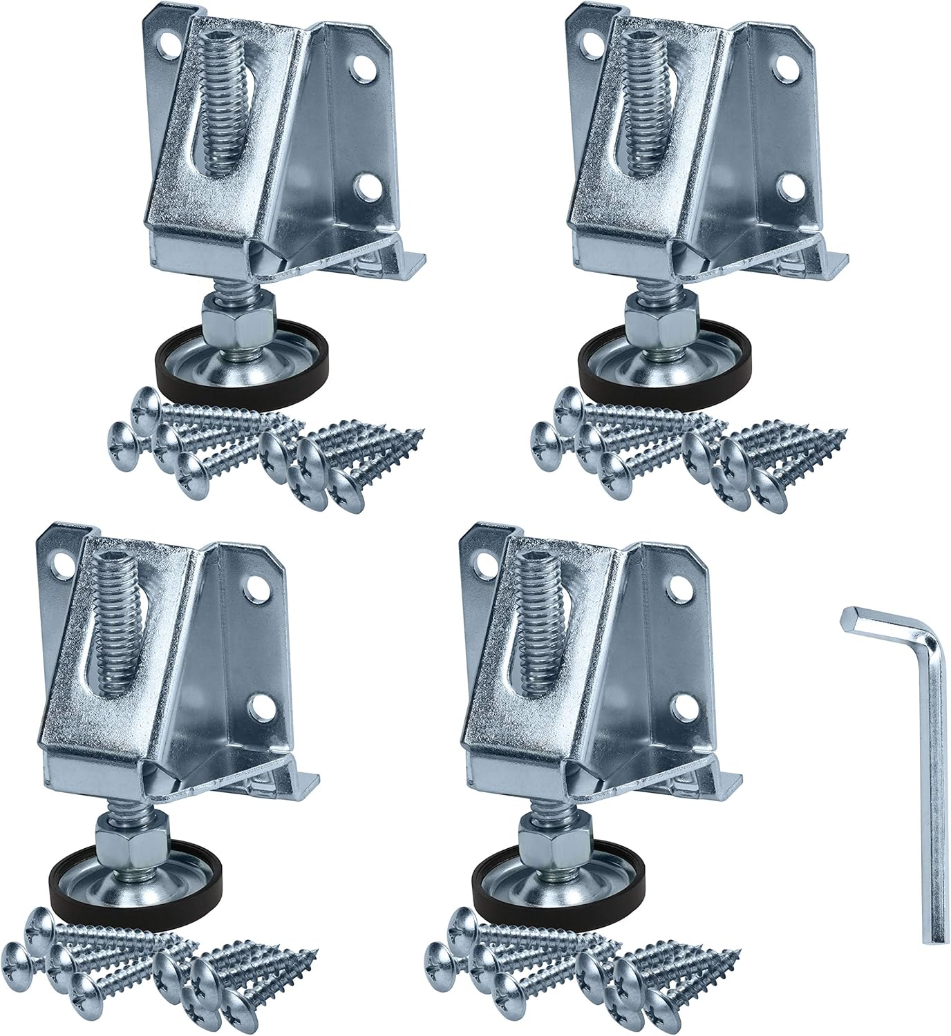

With the method described the table can be moved around a little, and mostly stands rock solid on the leveling feet.

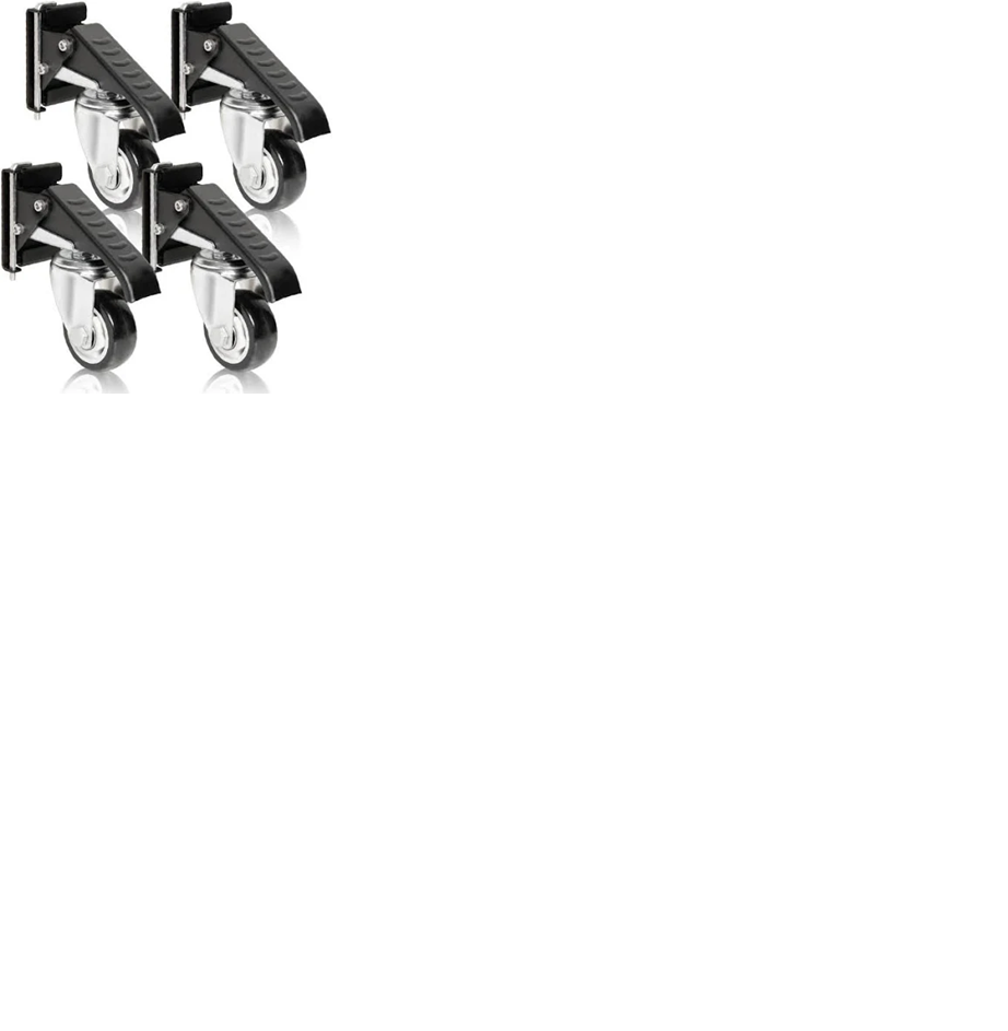

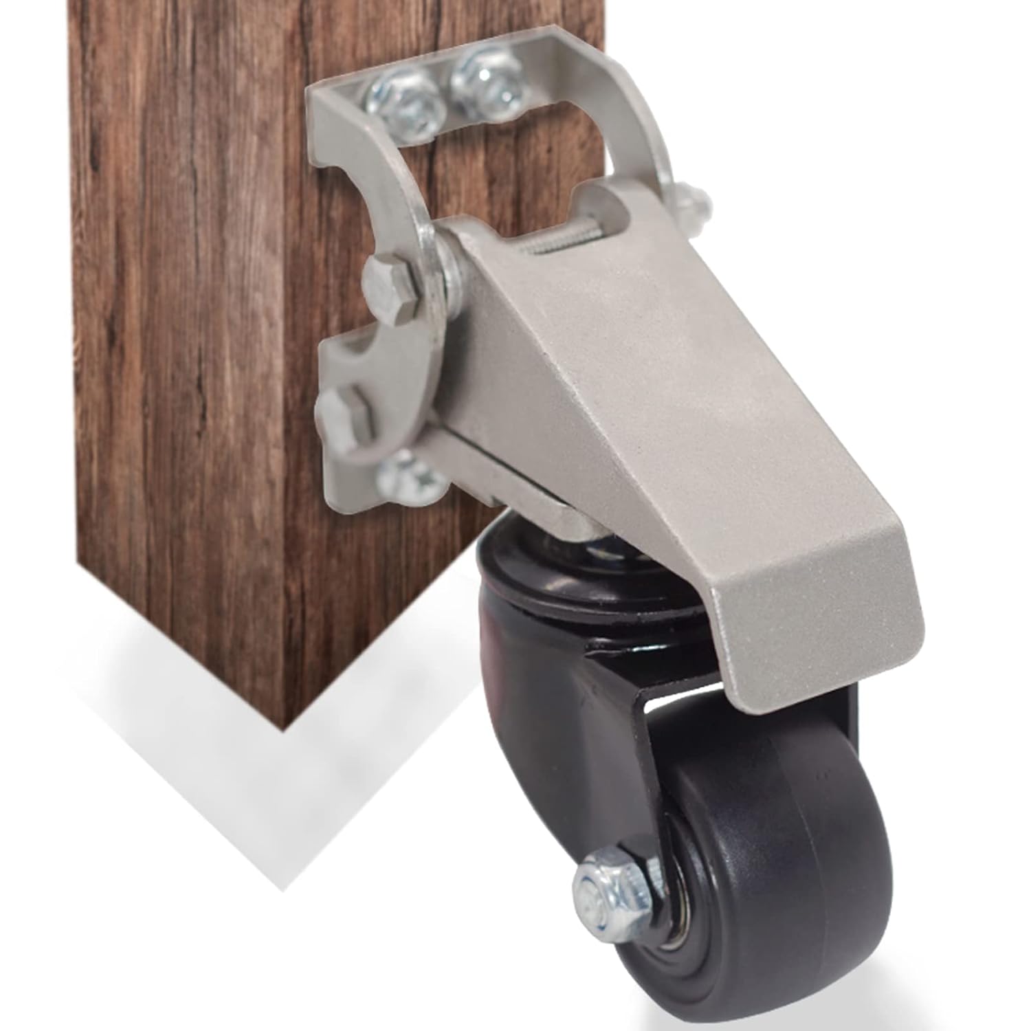

The last picture of the wheels are toe busters and ankle biters. They stick out and have a tendency to catch your feet. A better version are ones that have brackets that the wheels attach to. You buy brackets for everything you want to move and one set of wheels. When not deployed the table/bench sits on its own legs and it only takes a minute to attach the wheels. Then after moving you take them off.
The double locking casters work well but over time the overcover on the wheels deteriorates and peel off. Then the wheels wont lock anymore. I have taken to buying steel wheels for things that dont need to lock. The steel wheels never give me problems.

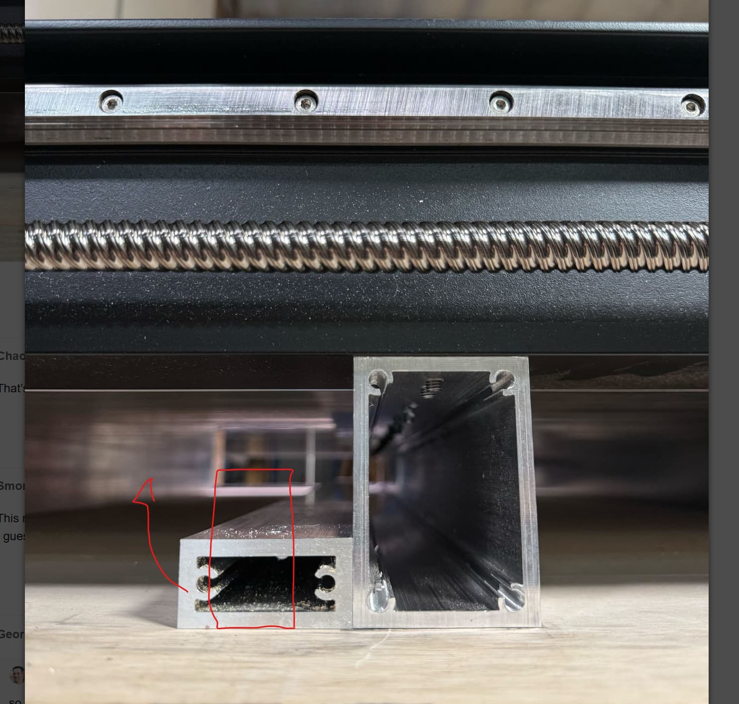

If you were to rotate the existing rectangle tube 90° that would add better rigidity to an existing machine without the kit (?).
Hmmm…looking at your pitch. If you rotated the bottom cross member (called a Nomad tube, I think) to the orientation you marked in red, wouldn’t there be less overall surface area in contact between the Nomad tubes and the Y-Axis tubes? And wouldn’t that mean less overall stiffness?
While you could do that (and if you’re out of warranty you can do whatever you want), it wasn’t a realistic solution for us. You wouldn’t get the surface area or stability needed to do vertical workholding, and there’s just not enough meat in there to properly outfit a machine like that with legs, if desired. This is a case of bigger = better.
I agree with Winston if you have the $$$ to spend, I say go for the kit. If not, I was just saying to use the tubes you have you could do this…
To increase a box beams stiffness you need to increase the beam’s depth, this is based on the tension and compression loads do not change. This is the most impactful change, as stiffness in the bending direction is proportional to the cube of its depth. Making a beam twice as deep increases its stiffness by a factor of eight. Which in this case with these tubes rotated 90° it would be significantly stiffer.
The decision is yours to make. I assume no responsibility for the change.

I like the thought to reuse what is available. When I upgrade to 5.1, I may use the old base tubes to run to what look like holes halfway down the legs. Or maybe I can reuse them to aid in vertical workholding.
Would rotating the current baseframe member 90 degrees upright require drilling and tapping holes in them to attach the aluminum extrusions to?
@4wm
I don’t believe so, if I remember correctly the current supports were only drilled/tapped on one side.
