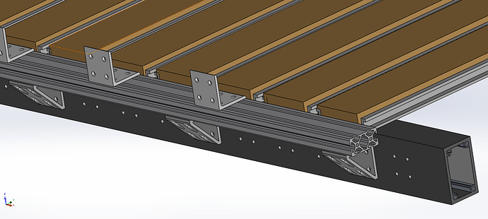

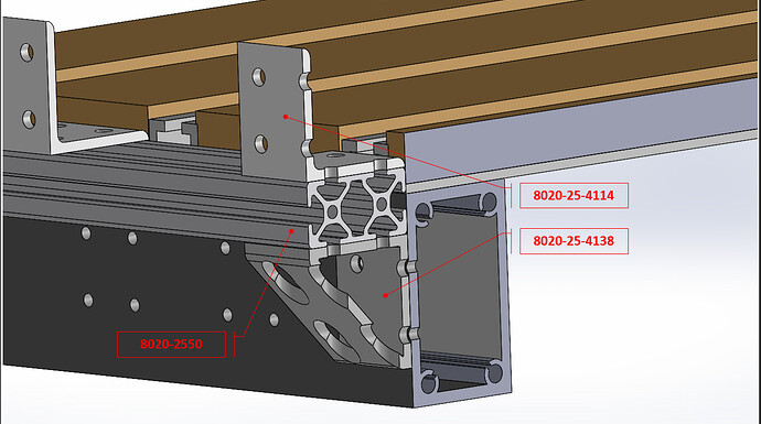

Do you have a diagram for the holes? I want to tie it down to the table on both front and back
No diagram, but they’re 25x25mm blocks of M6 holes, spaced every 75mm, centered on an 80mm tall extrusion.
How about those holes for legs?
Never fails, right after I buy something, it’s upgraded. :man_facepalming:
Looking forward to the official assembly video.

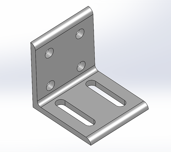

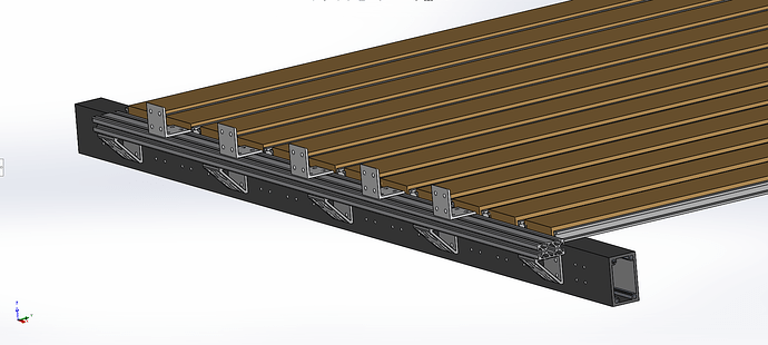

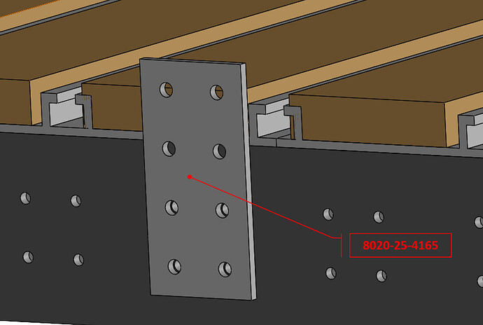

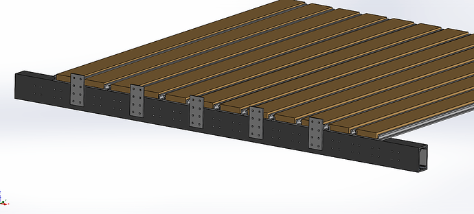

With the new extrusions and their 25mm hole spacing, that opens up using “25 Series” 80/20 extrusions and “25 Series” brackets and plates to mount to the front and rear extrusions.
So, if you need to repeatably have something flush up against the front, you could do something like this:
Or, if you need to have something hang over the front, you could so this:
I mean, you can always make your own brackets, but sometimes it’s just nice to be able to buy something that is ready to go. You can also get the brackets, and slot between the holes to give them a lot of adjustability.

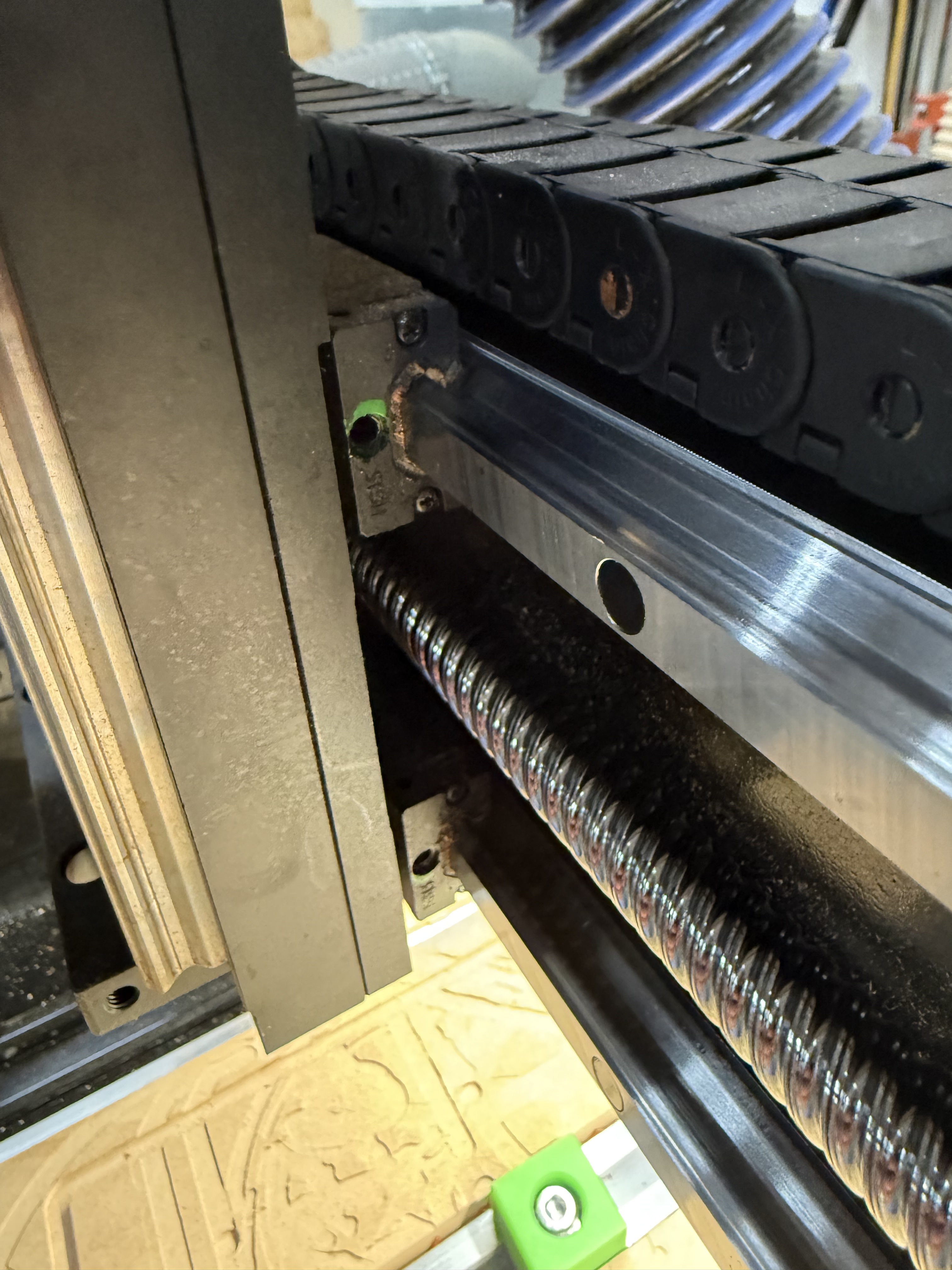

Does oil get to both sides from one side??
