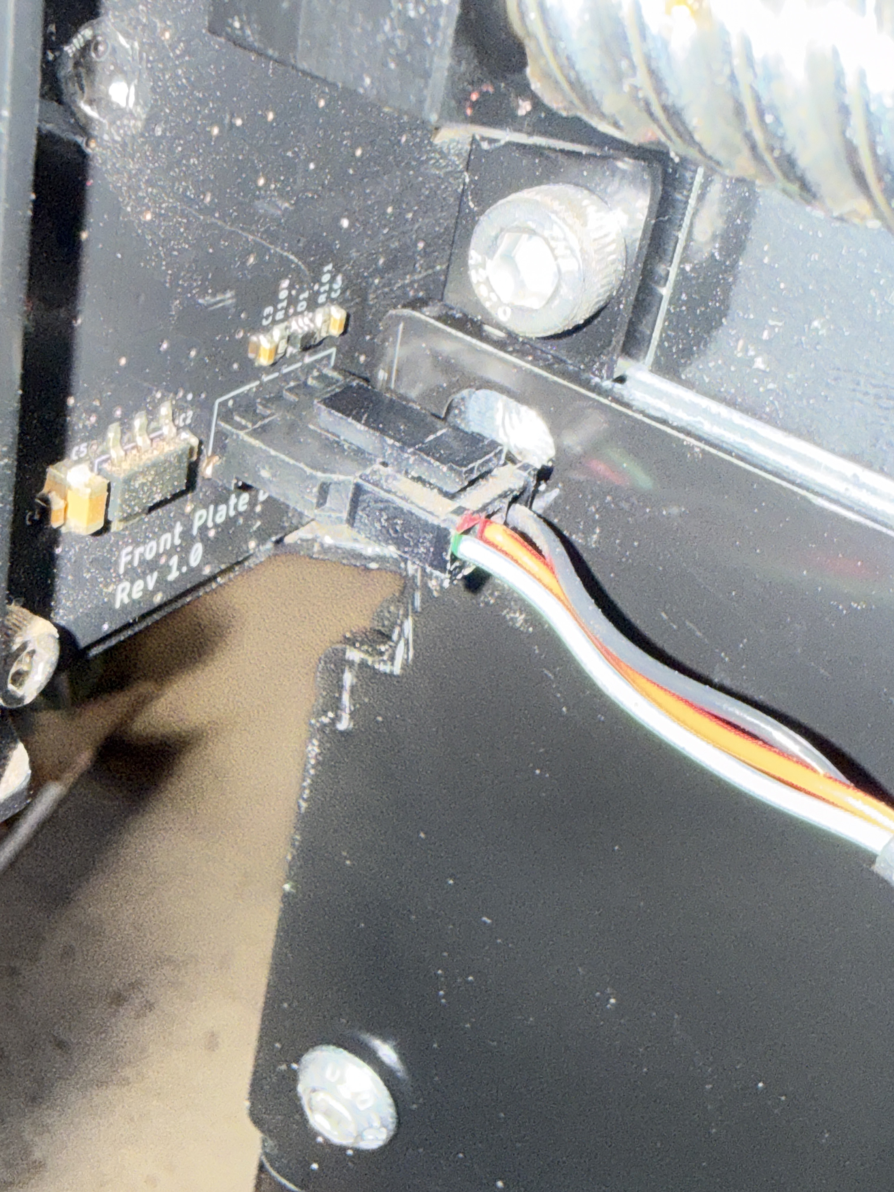

  1. I’ve seen it quite a bit in other stuff with bent sheet metal but you don’t allow for enough tolerance in your screw holes for things to be slightly misaligned due to variances in parts.
  2. Revision 1 of the front panel board has the connector right in line of the top left screw hole. Doesn’t impact stability or anything but may be a good idea to call out in the instructions.

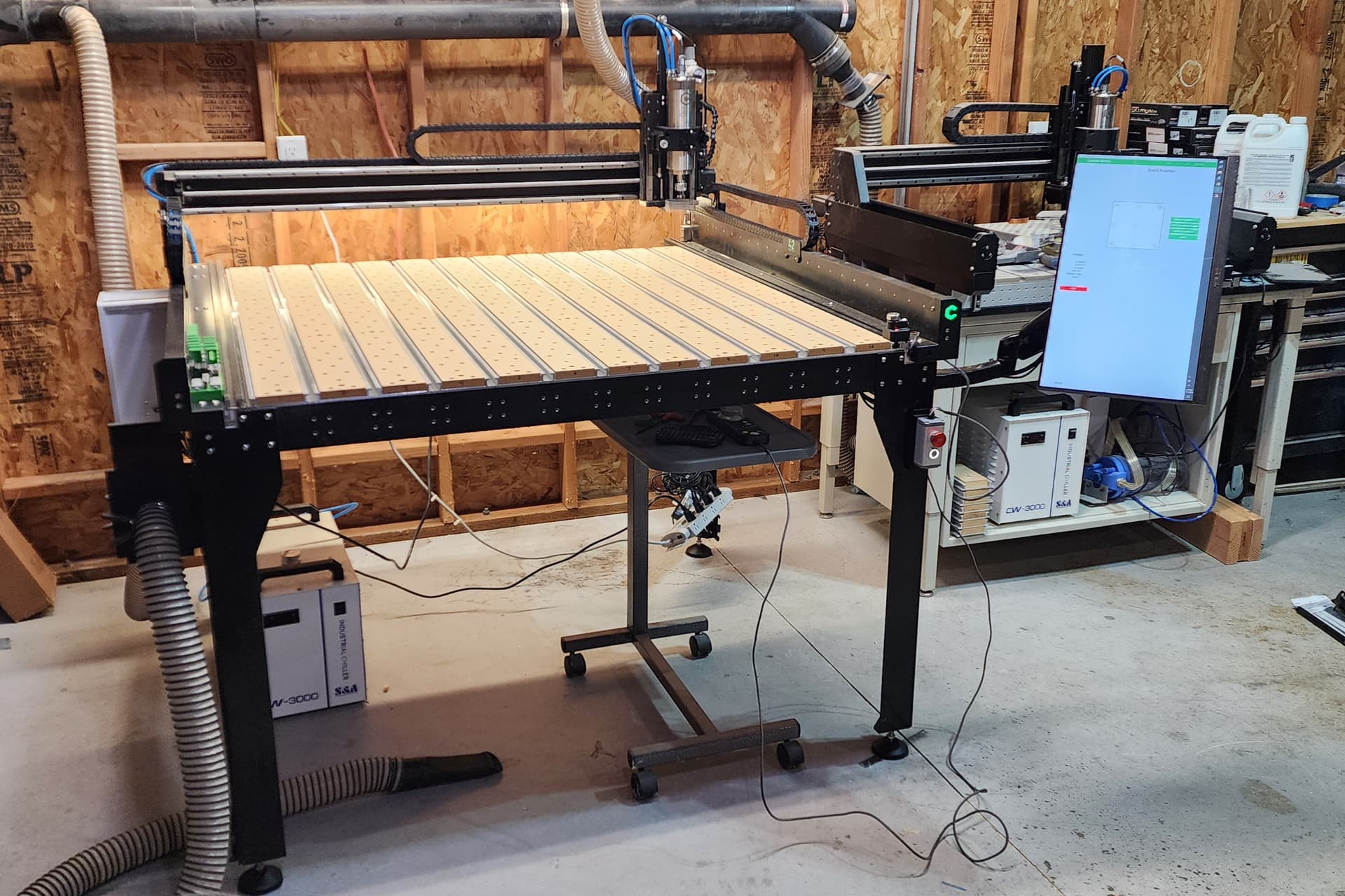

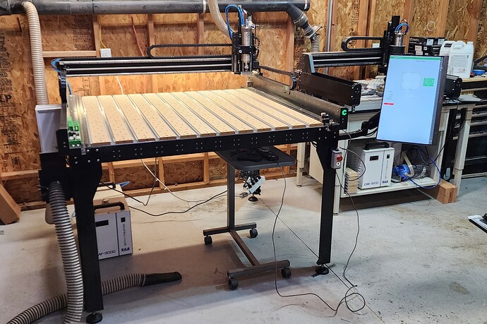

Got the 5.1 upgrade and leg kits installed and the machine re-calibrated. MAN… it’s beefy. Way more rigid than my initial release S5Pro on a Rockler Rock-Steady bench with 1.5" thick top and the bottom enclosed to prevent the bench from racking. I was worried about racking with the leg kit not being braced… I’m no longer worried. :smiley: Climbing around on the bed and dancing like I was on American Bandstand and Soul Train was about as stable as being on a stage. Although, sadly, my dancing was not improved. Ye olde scientific Meyers method of standing on the machine to test rigidity has been surpassed!
What I was REALLY impressed with was how straight the front extrusion is and how well I could dial the machine in. After a proper squaring of the machine and adjusting the Y homing switches, it only deviated 0.005" across the whole X travel with a dial indicator on the spindle. There was only 0.002" between the left and right sides with one dip of 0.005" close to the right side for around 6". The tolerance on the extrusion combined with powder coat thickness was 0.005" across 48". That makes the vertical machining feature really precise all things considered. That’s insane for something that I bolted together in my garage and literally danced on.
I like being able to clean under the machine easily. Even being more accessible makes maintiance easier. Also more storage for rolling things. I might break down the bench it used to be on to roll under it now. I also designed and 3D printed a 100mm VESA mount for my mini pc and mounted the arm for my touch screen. And yes, my first attempt to mount my power conditioning power strip was a failure. That will get fixed tomorrow.
My singular criticism of the leg kit is that I’d like more holes and/or slots for 4mm or 6mm bolts. That would let me do a better job of wire management and accessory mounting. I did some slight redesigns of my 3D printed accessories to work with the 5.1 extrusion and leg kit. The revisions are printing now.
