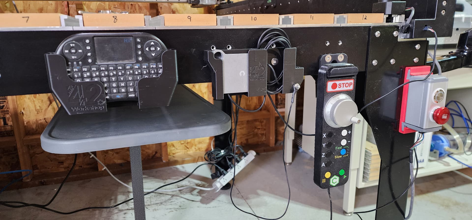

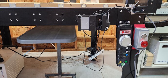

Slowly updating models to be compatible with the 5.1 front frame rail and the available holes on the legs. Also iterating on the Jog Pendant Hanger. A few revising to make things fit multiple places. Added a VESA 100mm pattern to the Rii Mini Kepad holder so I can place it behind my monitor. Since I got the Jog Pendant I don’t use it quite as much.

Let us know when you post the files to your Etsy. I will definitely be purchasing the hanger and the emergency stop Mount
Josh, thank you for the photos of your early prototype jog pendant. It is interesting to see how the case progressed from there to the production version. (And I would really like to upgrade to @WillAdams graphics-embedded, fuzzy case front…)
I will note, the changes you see on my prototype pendant vs the production version, are mine.
I broke the case and Winston was kind enough to send me the file to reprint. I don’t know if it 100% matches the final version. I added the colors because my beta didn’t have the buttons with printed markings. We have a production version for our Shapeokos at work (S4Pro and HDM V1) and I like the silk screened buttons better. I also added the logo just because. :wink: I understand why they don’t do multi-color printing because the failure rate is higher and colors can string and cause cosmetic blemishes. So don’t take the visual differences to be C3D’s. :slight_smile:

I like the jog pendent you have in your pic. I am used to using a jog pendent like this one, but a bit fancier of course on the big CNC mills that I ran in the machine shop. It was nice to be able to lean in closer to the part and tool as I was touching off and be able to incrementally move the tool one click at a time closer to my tool setting. I knew that when the increments were set to .001" movement per click, I could focus on the part and tool for touch off and feel the clicks knowing I was moving .001" at a time. Made for really fast touch offs and not worrying about crashing the tool into the part, or reaching so far away from the part.

I finally got my xBox controller to work and that was nice, but the feel of it is still a bit off for me. I hope the size of the pendent can fit in one hand comfortably from a size hold so it can be operated with one hand on a one or two finger hold.
Always nice to have something to better handle portable controls of a bigger machine like this then sitting there trying to look from afar with the mouse and clicking on the button on the screen to make movements. Then of course if the slightest movement happens and now off the button. That is why I worked on getting the xBox control working, which was a major pain in my arse because I had to find a good app program to interface with CM.
Now that’s it’s been almost a month, have you abandoned the Rii altogether? Or do you still find that you use it on occasion?
I still use it, just not for jogging. My mini pc has no keyboard, so the Rii gets used in that capacity.

I know this post is older but THANK YOU! I forgot to take a photo while at the shop of the front to model out some workholding and this saved me a round trip.
