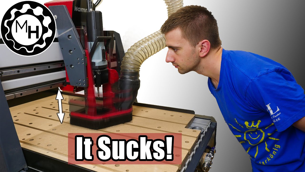

There are a number of similar options to the Mafell FM 1000 WS which I have, including some more affordable options — but mounting them and working up dust collection seems challenging.
The Makita is a trim router, the Mafell is a milling motor (specifically designed for lateral forces). I’d prefer the option of a Mafell mount to a Makita (although I understand the Makita is popular because of cost). The quick tool change on the Mafell is just the dog’s
Just out of interest which stockist are you looking at - I’ve only found Robosavy with that ever so painful $1 == £1.05
Marius Hornberger has a beautiful dust collection solution.
