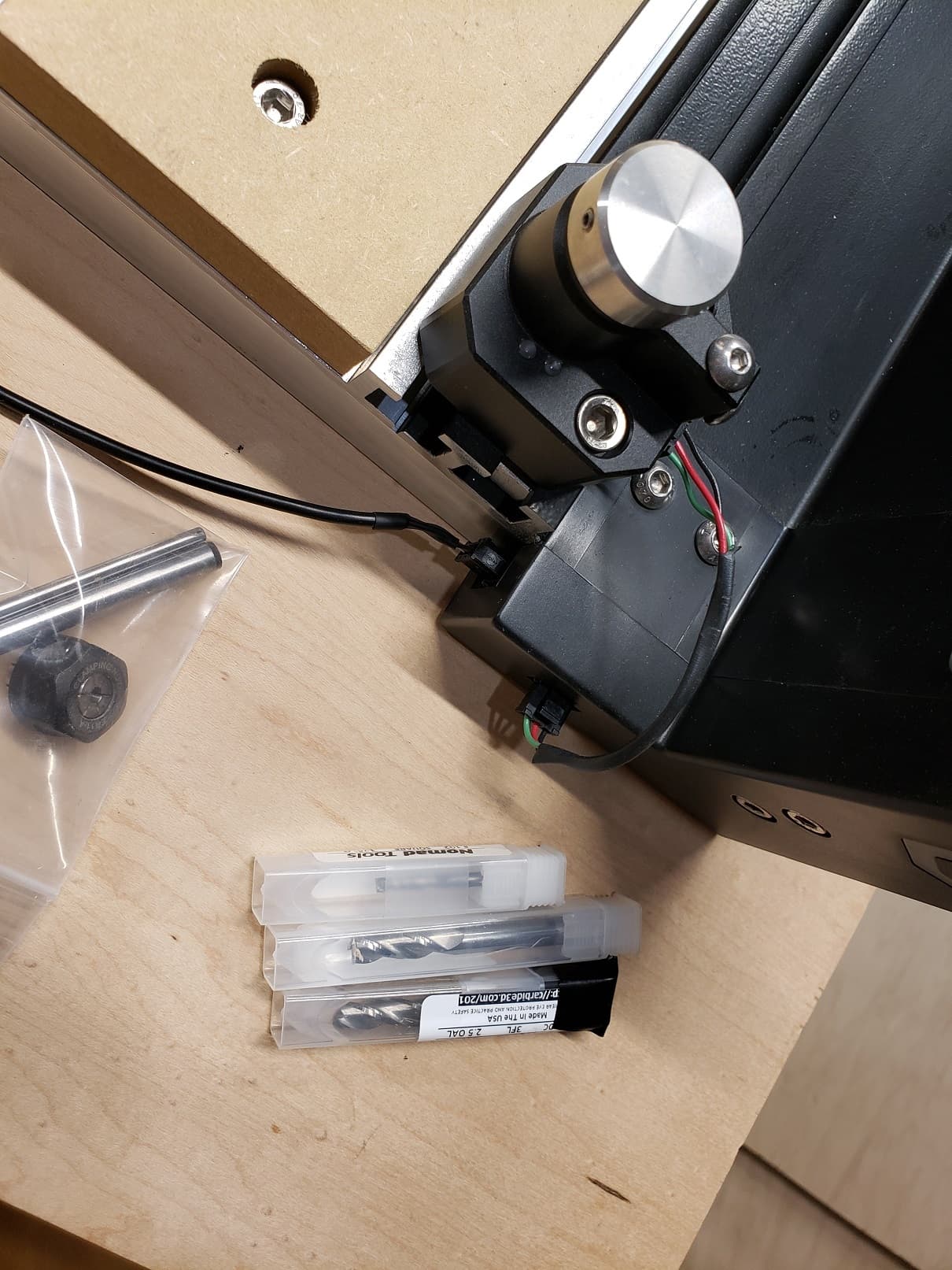

Well unfortunately you can add me to the list of bit setter issues with the same error message and the smoking if I plug in the bit zero. We just finished setting the machine up this morning and now it seems like it wont be making any projects anytime soon. I will also be reaching out to support but I am not hopeful of an easy or quick fix based on what I have read.

I am always pleased with the responsiveness from support when I needed it (which thankfully hasn’t been too often). Opened a ticket, we did some back and forth with pictures, they are sending me a new front plate. Hopefully that fixes it. It did smell of ozone when I took it off so I suspect that might be the issue. My machine shipped after the cut off for bad machines so not sure if maybe I just got a bad one.

Well Bob, there is light at the end of the tunnel. I changed out the wiring harness, front plate and extension cable and the bitsetter is working normally. I want to give a big shout out to the Support team for working through and resolving this issue … now it’s back to work I go. :slight_smile:

Yes, the entire wiring harness, front plate ext and the ext cable. Didn’t want to take any chances so I replaced all before testing. Not 100% sure what fixed it but I’m leaning towards the front plate.
