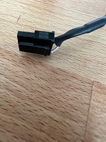

Hi, I wanted to know if anyone had issues with the bitzero for the shapeoko 5 Pro.
The first one I ordered arrive with 2 of wires disconnected at the connector. Carbide sent me a replacement which I got today and everything seems fine until I plug it in and as soon as I moved the plate, one of the wire came out. I have a full size 4x8 Avid CNC, and I use my Zxy finder plate everyday, a dozen time a day, with no issues. I have got to say, I am a little frustrated right now, the wiring on the shapeoko 5pro is amateur-ish at best. and the bitzero isnā€™t well design for the rigor of a ā€œproā€ CNC use. I am an industrial Designer, I have build many CNC machines, from 3d printers, to CNC mill and everything in between, and frankly I would never dare to sale a machine labeled as pro with such a wiring. Wire that thin should be sleeved, wrapped, and aviation type connectors should have been used in my humble opinion.
This is my second Shapeoko by the way, my first one was the Shapeoko 3, which worked great including the ZXY finder plate they had for it. I bought the Shapeoko 5 Pro based on my flawless experience with the 3.
I would love to hear other people experience and thoughts.I am including the pictures of the first and second bitzero. I canā€™t imagine I am the only one with this issueā€¦
Whatā€™s even more frustrating is that the exact same Bitzero designed for the Nomad actually has the right wiring. See picture:

Standard 3 pin molex connector, with what looks like 22 gauge wire. The heat shrink is added to keep the outer jacket from sliding around, rather than really protecting the wires. The wires themselves have been overcrimped, you can tell because they were crushed and the jacket crimp didnā€™t come out of the connector attached to the wire. It wasnā€™t a mechanical break from vibration or abuse, the wires were cut during crimping and very little tension is enough to break the remaining strands. Unfortunately if the crimp machine was set up and not inspected, a thousand of these wires could have been run off with nobody noticing. A proper organization building these cables for carbide3d would have a QC department checking the crimps before they were inserted into the connector, but if theyā€™re like where I worked, the QC department gets phased out in the name of lowering costs, and ā€˜QAā€™ gets implemented. Which means check your own work, except everyone believes they are perfect, or some newbie is on the line and doesnā€™t know what the ipc standards are. Itā€™s easy enough to recrimp the wires, if you have a manual crimper and a pin popper, and if youā€™re really keen you can add something like a cable gland that holds onto the wire at the housing and relieves tension. Sometimes itā€™s hard moving from a hobby design mentality to a commercial mentality, but I doubt anything in these units are a Class 3 level.
I agree with you it is definitely over-crimped. It looks like it was cut right at the base of the pin :disappointed:

I just assembled my 4x2 5 Pro (with a Bit Zero on order) and my only real issue was a proximity switch with similarly severed wires (and a general sense that the wiring harnesses felt too delicate.)
I did some research and it appears that a properly installed/crimped 3-pin 22-24 awg Molex microfit connector should be able to hold up to at least 5-8 lbs of pulling force, sufficient for the Bit Zero IMO ā€“ but clearly the QC on these harnesses is lacking.
Iā€™m thinking Iā€™ll probably invest in a decent crimping tool and a box of spare connectors, eventually replacing (and reinforcing/heat-shrinking) any of the connections that look suspect.
My x-rail stepper motor had the molex sheared off during shipping. Simple enough to fix, and the parts are cheap, but the tools arenā€™t. Iā€™m also pondering adding some wire loom to the exposed parts of the harness. It wouldnā€™t take much to snag a wire in a workshop.
